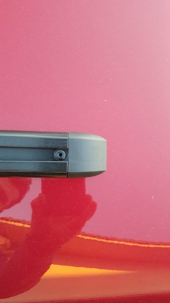

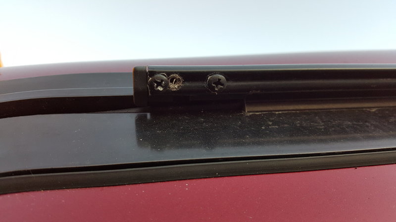

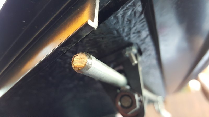

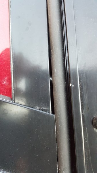

    I'm finding out now after I spent a bunch of money and waited 2 months (was told 2-3 weeks). I just went back to the dealer, she'll is off! They will see how Snugtop can fix all the problems with back door not seated right and some bad craftsmanship and jagged edges where they cut the rear door trim bad enough to cut yourself on. The end roof rack caps are also riveted on so I can't take them off unless I drill them out to put my roof rack. Now tell me who built this was using their brain20151231_163133.jpg 20151231_163122.jpg 20151231_163200.jpg 20151231_163218.jpg
    Just a few pointers for you guys not to miss when inspecting your "brand new shell"

    That's crap work, and for those prices, rape. Glad you stuck it back in their faces.

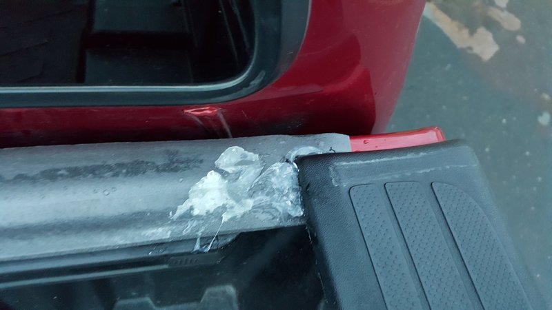

    At least if it was used and didnt pay $3,000 I'd put up with it and I'd have the patience to deal with it

    That doesn't look like it's in exactly the right spot.. Lift up that foam and you should see the culprit is a little channel right underneath where the silicone is. .. Also it looks like it is going to come through underneath the bed rail and between the foam. The foam is basically lifting the bed rail up to let more water slide through.

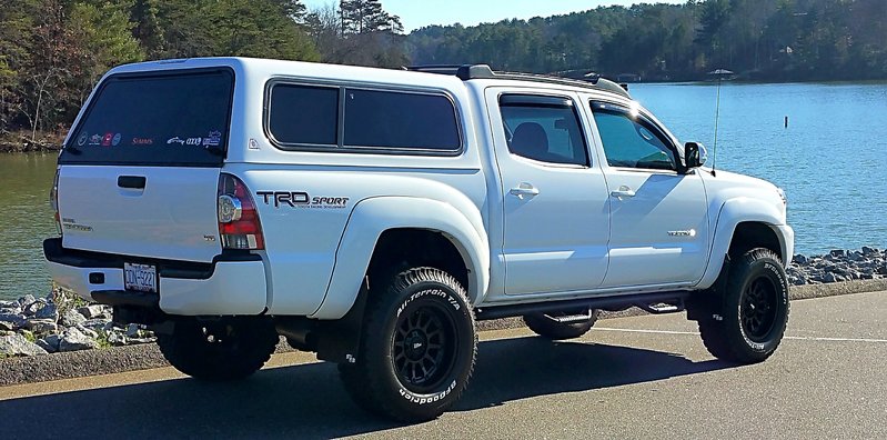

    Nice! Have to see it when it's on.

    Go buy some double bulb seal and use that. You can buy it online at Amazon and other retailers. Good stuff!

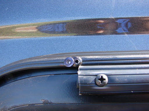

    Happened to me too. The labor involved in making the shells is shit. I bought my A.R.E. in 2012 and I made them replace the side windows because they both had bad defects. Deformed frames, double rivets. Both side windows were replaced, and then one of the replacements was replaced.
    Look at this double rivet on the outside of the frame. Shit labor and no oversight. Who does that?
    I talked to one of the managers at A.R.E. in Ohio, and they don't even make the frames, theirs were outsourced. :(

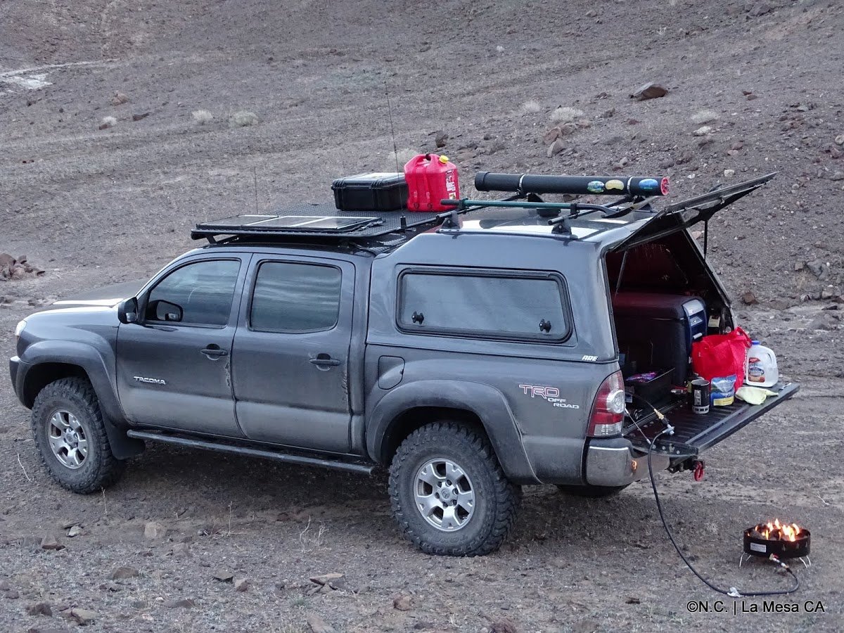

    Here is my shell. Love it. Will be four years old come this summer. One of the best truck mods.
