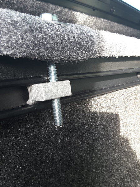

    Is this a top down picture or one from inside looking forward. I'm mechanically challenged and disoriented.
    I had the same thing on Leer 100xr. Leaking in front left corner. Dealer had it off twice and had all kinds of silicone, putty and tape. Didn't leak a lot but leaked every rain. They didn't want to try a third time so they refunded my money. Ordered an ARE from another dealer. Hopefully they will be able to get it sealed. Tents and truck caps shouldn't leak.
    Maybe you'll have some better ideas after today.
    I am going to fill that little track

    I'll suggest this to the installer if they don't get this new one right.

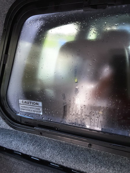

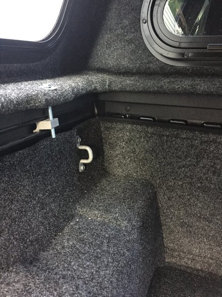

    It is sunny right now so I have gone out and had a good look at what is going on with the fit and noticed that the installer siliconed the front bulkhead pretty good but they have used foam tape to form the gasket which is now saturated with water and seeping into the box, I don'the know why they did not use a neoprene or rubber gasket that would not allow water through.
    The inside of the window is also wet and there is water sitting in the channel at the bottom of the window, don't know whether this is condensation or the window is leaking.
    The inside lip of the canopy on each side is also saturated with the driver's side being the worst at the rear of the truck.
    I am waiting for Cap-it to get back to me on what comes next...
    Here are a couple of pictures I sent them.

    It does look like there is condensation inside on the front window that might be the source of the leak but the side window looks like it is leaking from the window.
    I have had Leer and ARE before and I am not very pleased with the fit and finish of either brand. Although none of my previous caps leaked. I here people complaining about SnugTop too. For the money spent you would think they would have better quality control. Also you would think installers would know exactly what to do to install a cap on a Gen 2 Tacoma to prevent leaks.

    Thanks Cape Codder,
    This may help.
    Other than the tailgate and the depth of the box do you know whether the forward bulkhead and side rails (that the canopy rests on) are the same design/dimensions in the 3rd. and 2nd. gen?
    Trying to figure if something has changed between the two gens. that is magnifying the problem.

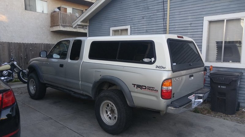

    Here's my SnugTop that I picked up from a member here for pretty cheap. I had a new lock put in. It leaks a little but I'll deal with that a little later. I happy with it. No need for a rear view mirror now, that's for sure.20160201_072507.jpg

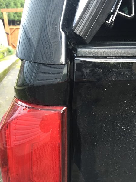

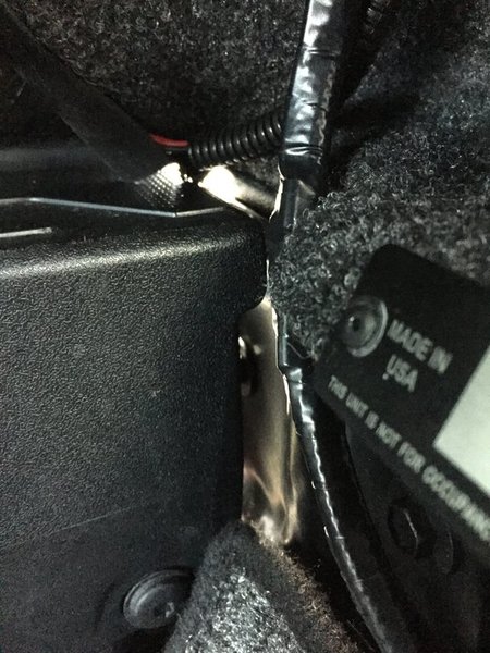

    Just came back from installer ,, he has said they went above what most do as far as sealing the front corners and around the box,, he did order me a new window and has is waiting for some more trim that they are currently out of to do some work on the tailgate ,, he says that's why the rails are becoming saturated .. It's coming through to the tailgate hereimage.jpgimage.jpg
    The pic I which I circled problem areas is from here

    I kinda did a similar thing by using 2 layers of cap tape at the cab end , one 1" wide on top of the bed rail to bring the top of it flush to the top of the front bedside and a second 2" wide layer of cap tape that spans the first and wraps down the front bedside edge similar to your pictured weatherstrip

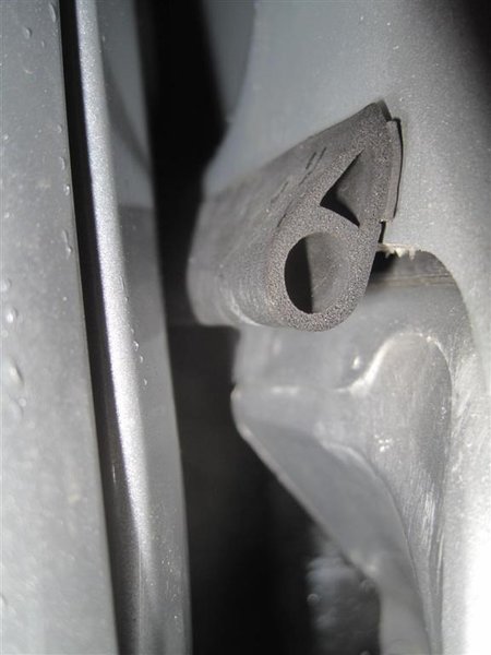

    UPDATE: Just went out and looked at the weatherstripping.
    My cap was replaced twice, under warranty.
    On 2011/12/10, while installing the replacement cap, the same installer added a different weatherstripping, as seen below.
    Apparently, most anything that will deflect/redirect the water below the front bottom edge of the cap, will do.
    This one has a (Sealing) Bulb rather than a flap, similar to what is used between the bottom of a cap and the bed rail.
    Another FWIW :notsure:
    Another, most anything that will make the water bypass the front cap / front bed mating surfaces
    Sorry, I can't answer that one. Haven't really seen a 3rd Gen Close Up
    Second Version of Weatherstripping
    WATER LEAKS SUCK! :frusty:
    Where it leaks out, may not be where it seeps in.
    Good Luck
    CC
