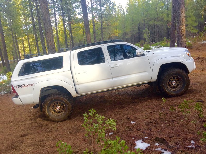

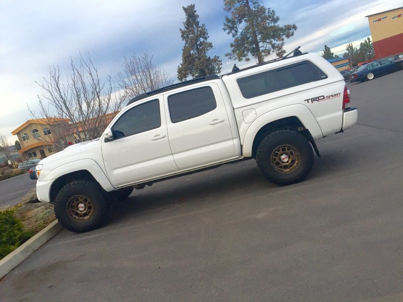

    My ARE Z-Series canopy showed up in 3weeks! So excited to have it on! Very happy with the fit and finish, I wish I would have done this sooner..

    I dig the bronze wheels with the white paint. Looks sharp.

    Thank you! I dig it too!

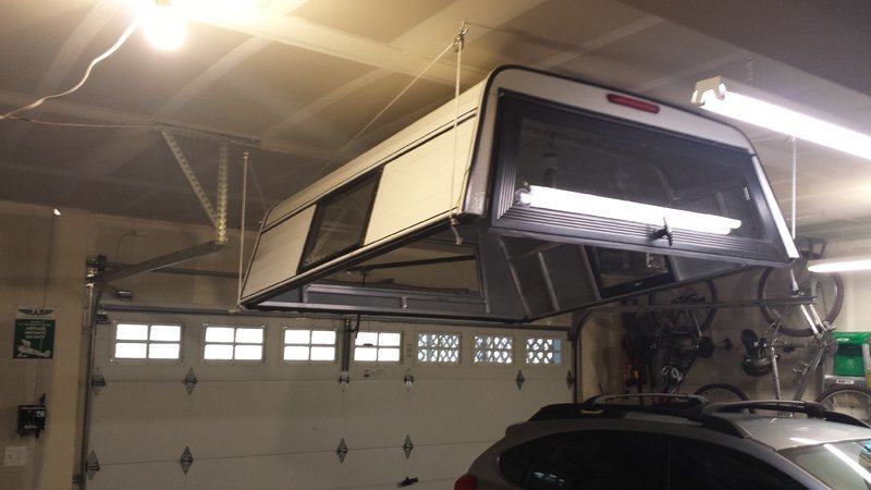

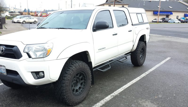

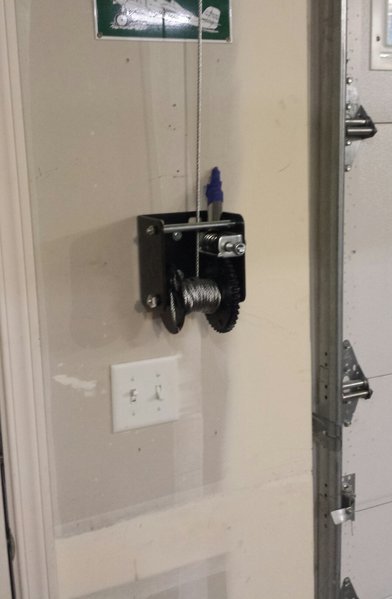

    $300 craigslist special. I only use it occasionally to haul dive gear, so I didnt feel the need to drop 2 grand for a nice shell. Made a sweet setup in my garage with a harbor freight winch to hoist it on or off in a few seconds.

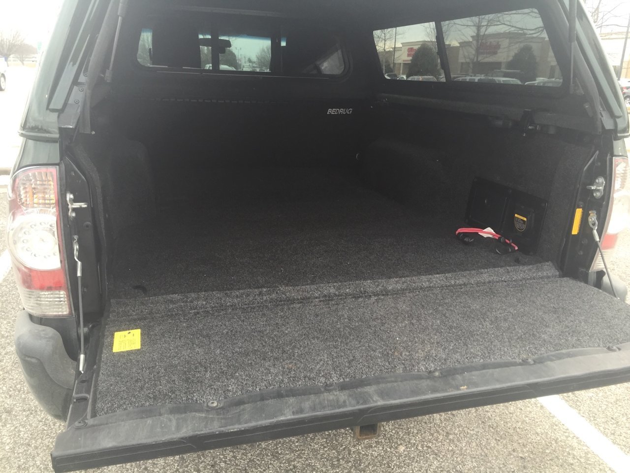

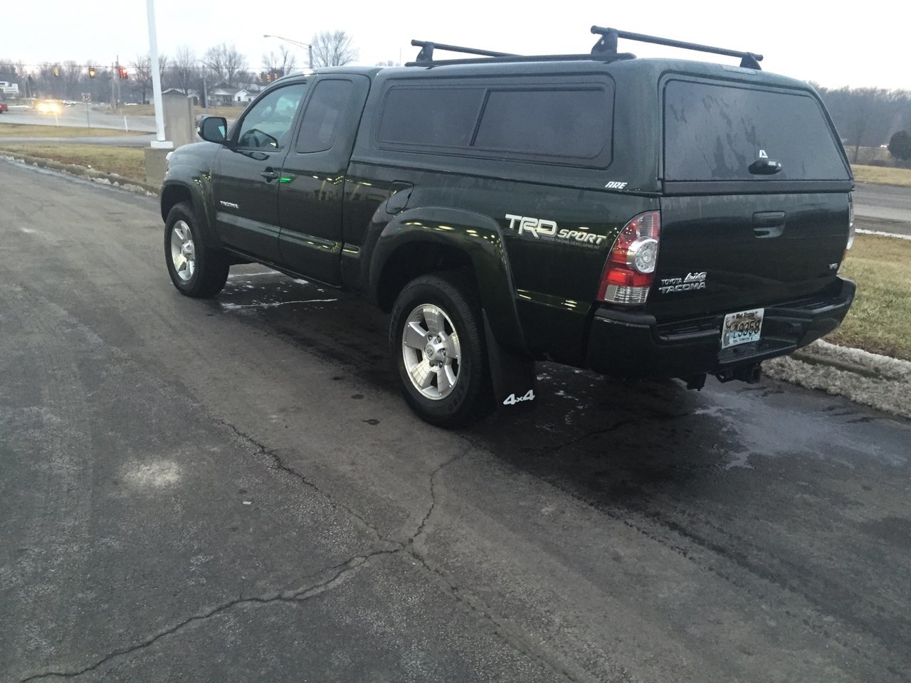

    Just had this topper installed yesterday. b108961be977e0f5aad0555372641140_b152b60f3711d3ab2264563e1ab7032ac50f6a64.jpgb3895df77eeb5626dfb01d6ad433b5dc_7c57111c8c805c490a84f8eadc008e5d9697c83e.jpg

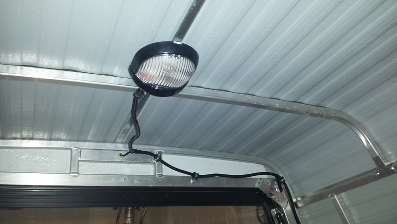

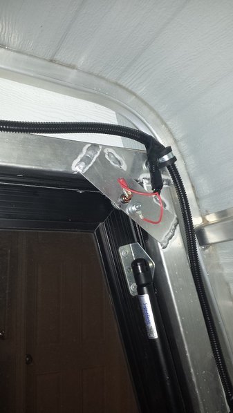

    Following up on my pictures a few posts up. I added an interior light that I picked up from an RV dealer for $10. It is activated when you open the glass by a courtesy light switch I got off Amazon. I wired it directly to the battery with a 5A inline fuse. To help avoid a dead battery in case of some malfunction with the switch, I swapped out the incandescent bulb for a warm-temp LED 1156 bulb that draws less than a watt. I normally don't keep the canopy on for more than a day or two anyway, so crisis averted. The interior light and brake light are connected to the truck using a 4-pin trailer plug. Figured this might help some people out who are looking to save part of the $200 that some dealers want for an interior light. Total cost to set this up was about $20, with the use of some scrap hardware and wire loom I had laying around.
    Sounds a little lame, but I was thinking about wiring in an 'alarm' of some sort. Like I said above, I usually only use my canopy to store dive gear for a day or hauling stuff for the honey-do list. Maybe wiring in a cheap car horn/turn signal relay to be powered by the light circuit would chase someone off from a parking lot should they pop the glass open.
