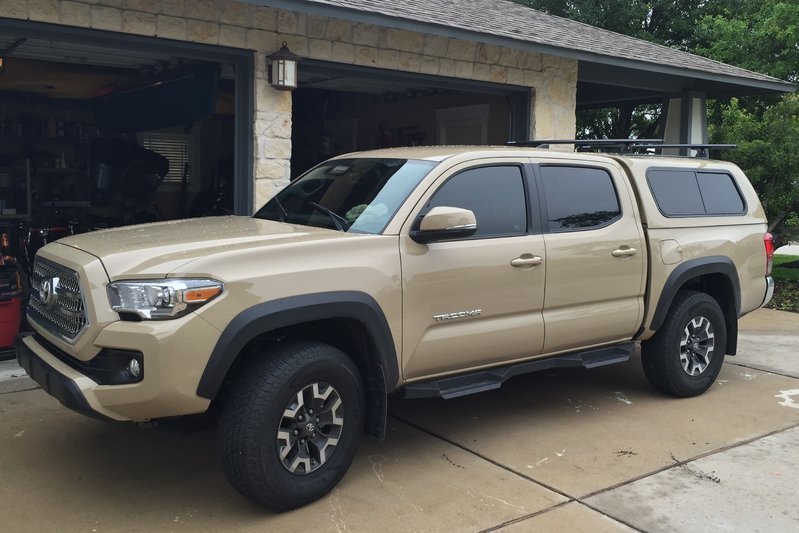

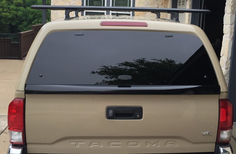

    Just got my rack installed on my camper shell. I went with the 59" Vortex Rhino Rack, and it's VERY similar to the Yakima Whispbar but much cheaper. You can also get it in all black which I believe looks better. If you have a shell with no rails, this kit DOES include the rails also. The rails may have to be cut down in order to fit, depending on your bed/ cap length.
    http://www.ebay.com/itm/Rhino-Rack-...ash=item1c60c5e537:g:ggYAAOSwnLdWsBMh&vxp=mtr
    The kit on ebay comes with the rails, but I already had a set installed on the Snugtop. I went with 59" bars, and they are perfect, with a couple of caveats. If you're going to install on Yakima tracks, you'll need to buy new nuts, Yakima Anchor Plate A - Set of 8 which cost about $8. Also, the rails on the cap are only 37" apart, which is a little narrower than the bars allow the feet to be placed.. I drilled a hole about 1" inward on each slot on the bottom of the rack bars. I then used an angle grinder to extend the slots. All of this modified area is covered by the rack feet, so it will still look perfect. This modification sounds involved, but with a drill and angle grinder it took all of 5 minutes. Rack is dead quiet, and is the perfect width if you don't want to hit your head.

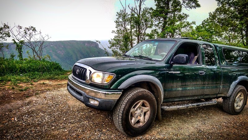

    Took the shell along for a fun run down NC105 on the Linville Gorge in North Carolina.

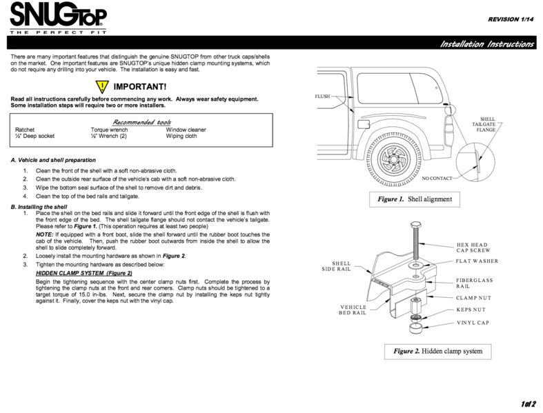

    Today I was adjusting my leer cap on the truck. I used a ratchet strap tied on both of resr corner and I tightened it to close the gap between the door and the sides of the shell. Then while I was putting back the clamps in place, I was wondering if there is a maximum torque to respect when tightening the clamps to avoid breaking something.... Of course I put more torque on it because I want the shell to stay in place but I don't want to cause damage... Any thoughts?

    Snugtop instructions say 15 in-lbs for this style of clamp:

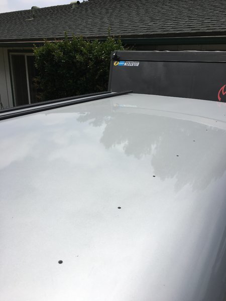

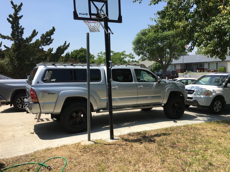

    Poked holes in it. :sawzall:

    Hey, looking nice! I've got a prinsu cab rack, but am about to install a yakima rack & tracks on the camper shell. You're making me think I should have got a matching prinsu rack instead...
    Anyway, any chance you could measure how far from center you installed your tracks & how close to the front/end you ran your track? Looking for ideas. Thanks!
