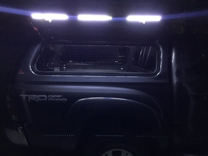

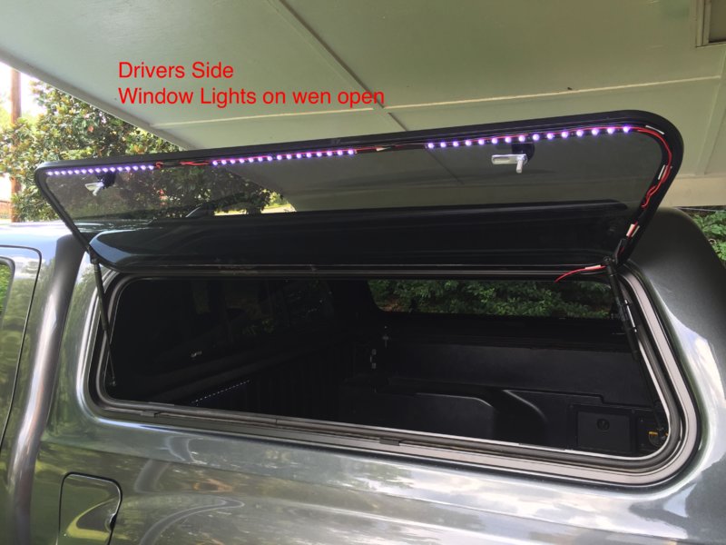

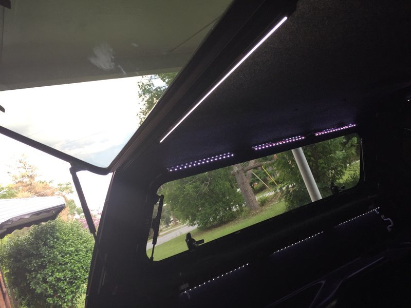

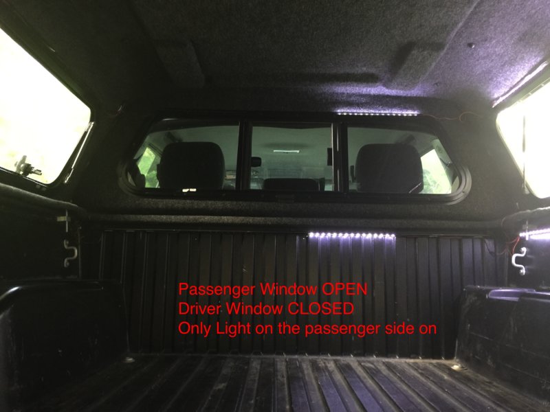

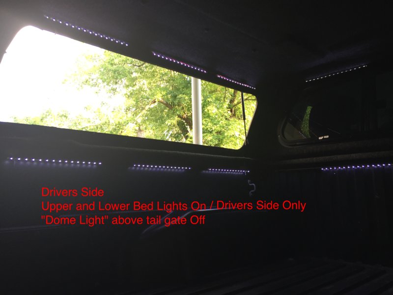

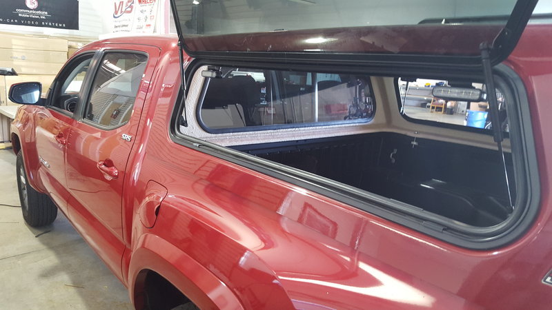

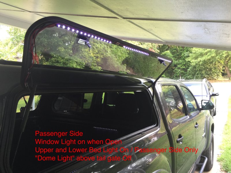

    Ok, so while the neighborhood is out blowing stuff up, I have been working on my lights for my shell. (I have no life LOL)
    Here are the day time images, and I still have to clean up the wiring a bit.
    (I should have said SIDE windows here)
    Now I just need some time to clean up the wiring a bit, and all done. I will post some pictures after it gets dark.

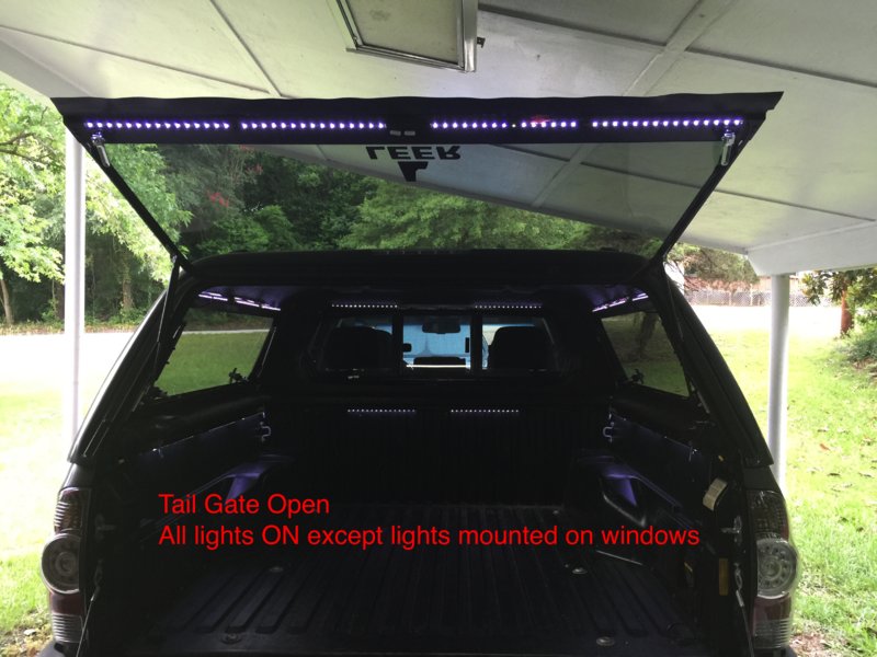

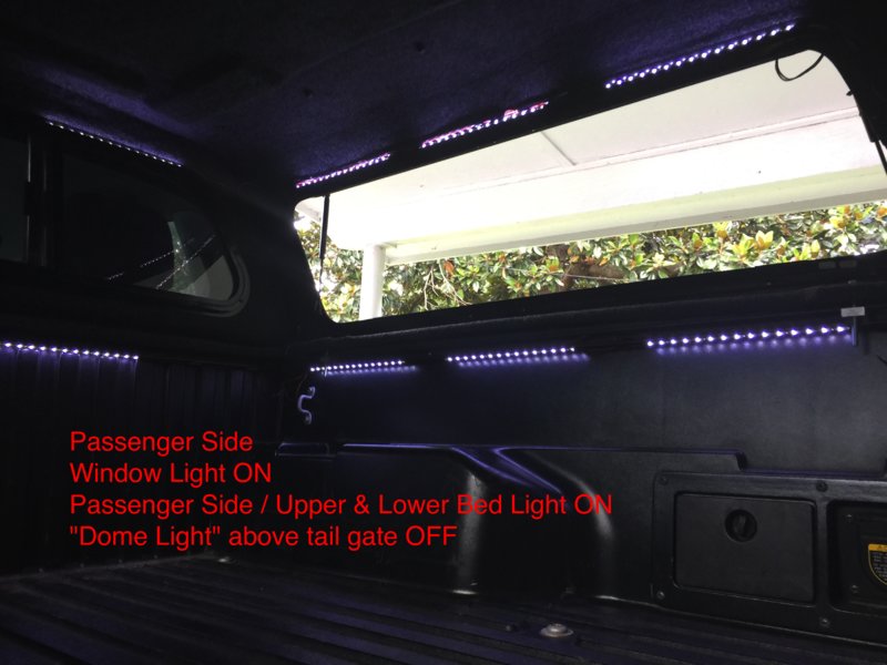

    I ended up using 26 lights, 4-25 foot spools of wire (2-red, 2-black), 4 diodes and a little solder, and a number of connectors. Total spent ~$50.

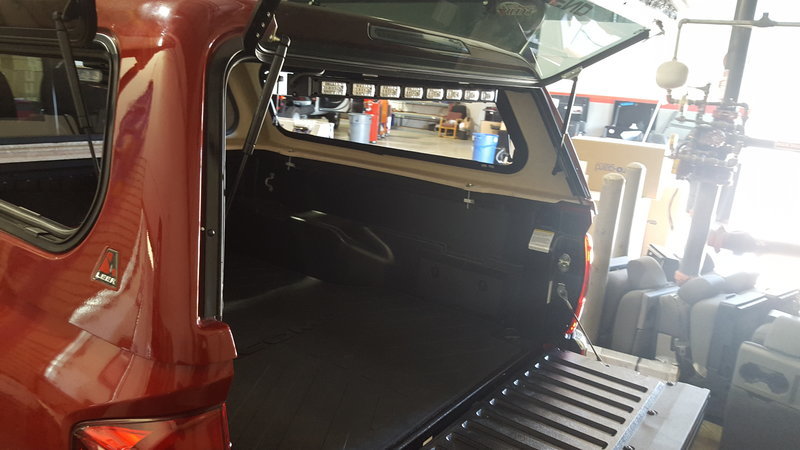

    20160629_203012.jpg My new leer 10020160628_201040(0).jpg 20160701_172703.jpg

    Great idea with the cargo rings :thumbsup:

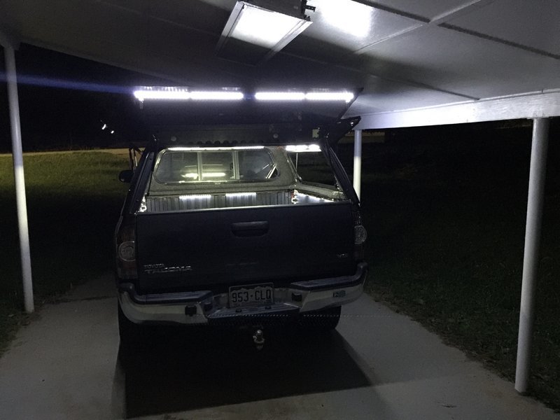

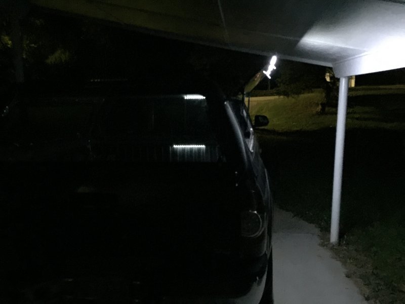

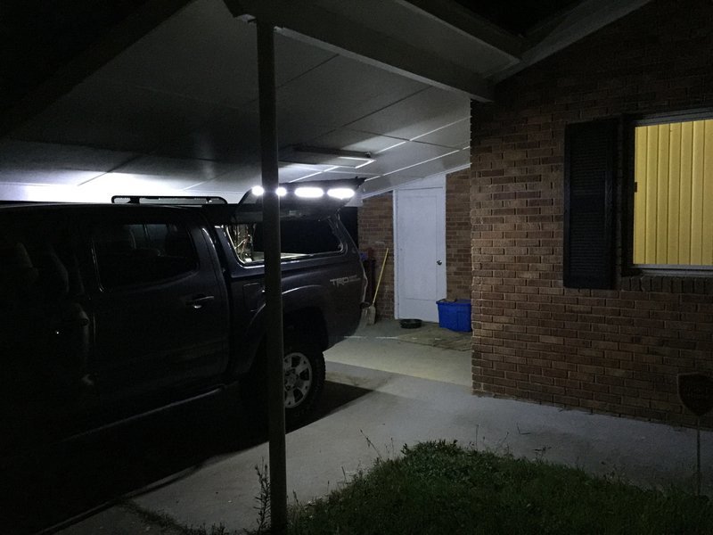

    Massive amount of light! So glad I did this :bananadance:

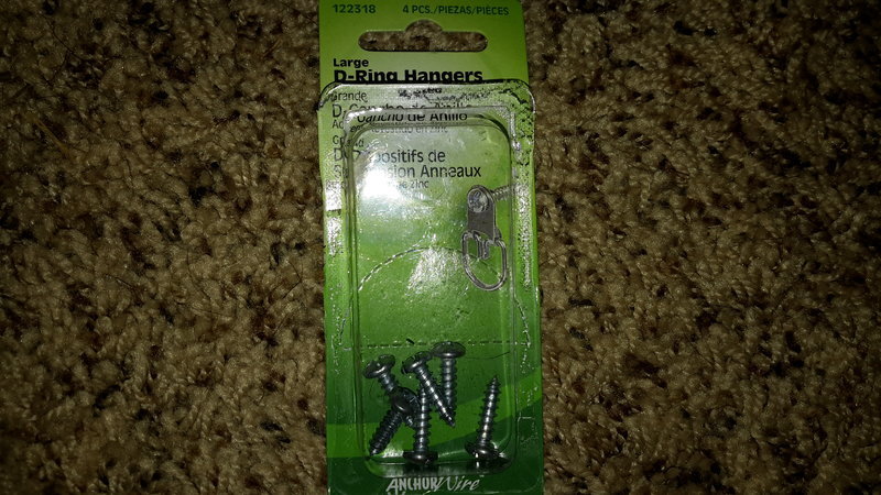

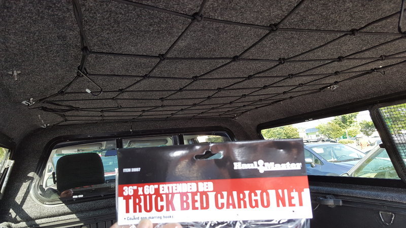

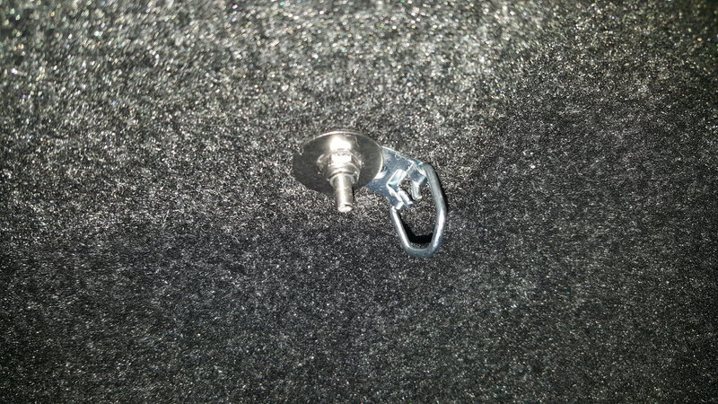

    Thanks, these are the ones I used if anyone is interested. They are in the picture hanging section, and needed to be reamed out slightly to accommodate the bolts.

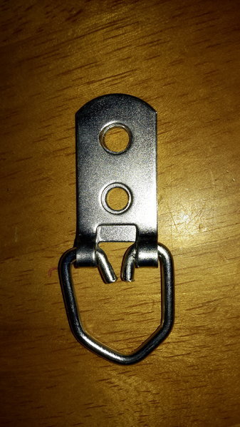

    Those look like they would work , if they clear the washer, or you could put it outside the washer rather than underneath. the ones I found have two mounting holes, making the tab longer, you use the outer hole. I found them at a truevalue.

    I plan to use the net for my sleeping bag and other light stuff. It's better to not cram a recently used sleeping bag into a stuff sack as it needs to dry out, the net seems like a perfect place for it to air and dry out.

    Found them on Amazon: https://www.amazon.com/gp/product/B017P1FPC4/ref=oh_aui_detailpage_o01_s00?ie=UTF8&psc=1
    The sticky side holds very well so far. They come in 10 packs, so if you get free shipping they are less than a $1 a piece. I will say that the wires are very thin and delicate to work with, not sure what gauge they are. I used to 18 gauge wire to connect them all, which is probably overkill, but it is what I had available. Really, I should have just purchased some lighter, double strand wire. Hiding the bulk of the wiring is proving difficult.
    [edit]
    If you do get them, they are bunched up in package. Lay them out to flatten them out again before installing. If you let them sit on a flat surface for an hour or so, they get mostly flat, but if you put them on right out of the package they will want to curl.
    Kemosabe[QUOTED] and jamiec like this.

    If anyone is wondering, or even if your not ;) , 26 of these LED strips plus the stock dome light pulls 2.08 amps according to my multi-meter.
