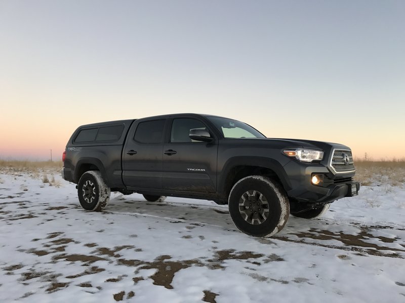

    Purchased a Leer 100XR. Very happy with it so far. Got it from A&A Toppers in Denver, Colorado.

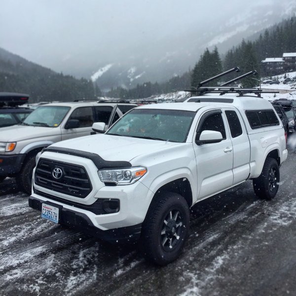

    I had to get my front window replaced in my Snugtop because it was leaking. Also check the track bolts. Snugtop did a terrible job of sealing the tracks to the roof. It sucks to do, but I completely removed both tracks and found that there was hardly any silicone around the bolts, where the leaks were coming from. Get a good sealant, I used this stuff as i recall (plus the white will match your truck better than mine!):
    https://www.amazon.com/3M-Adhesive-...e=UTF8&qid=1481040730&sr=8-3&keywords=3m+5200
    Is that photo up at Crystal? Great looking ride!

    Any leak issue with yours?? I'm waiting on my 100XR to come in. Looks great BTW!!!

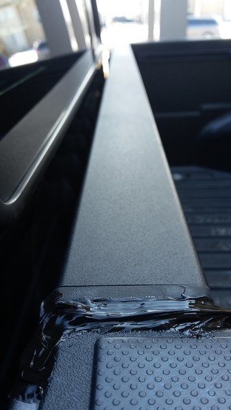

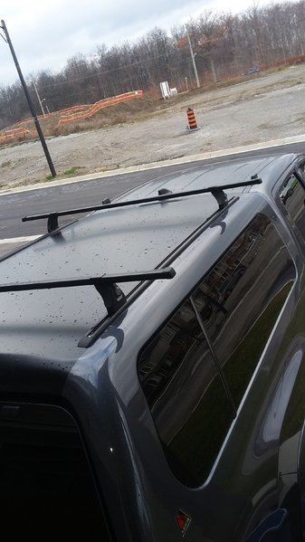

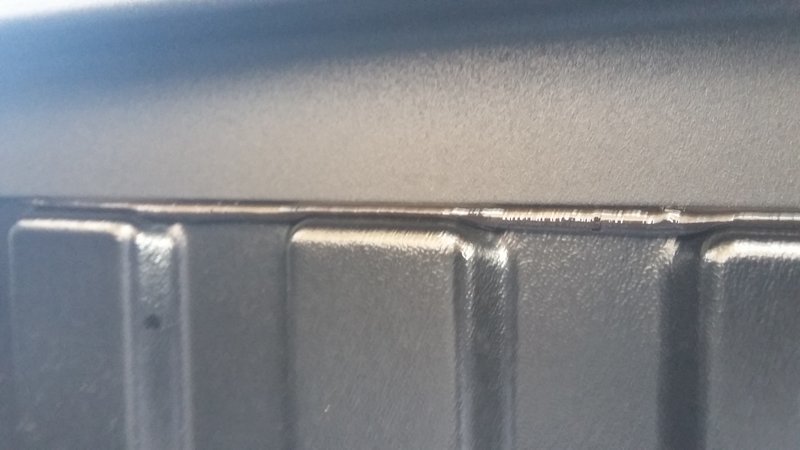

    I sealed my 3rg gen when the cap was off.
    Took the third rail off against the back window sealed under it and then both corners real well, the only thing i didnt do was lift the 2 side bed guard plastic things that run the length of the box ontop of the side bed walls and seal under there, water tends to run under the length of it. ive camped a few times so far so dry20160307_112733.jpg 20160307_110943.jpg 20160308_181218.jpg
    Also plug those wholes in the bottom of the bed floor by the cab window. lots of water comes in there when driving

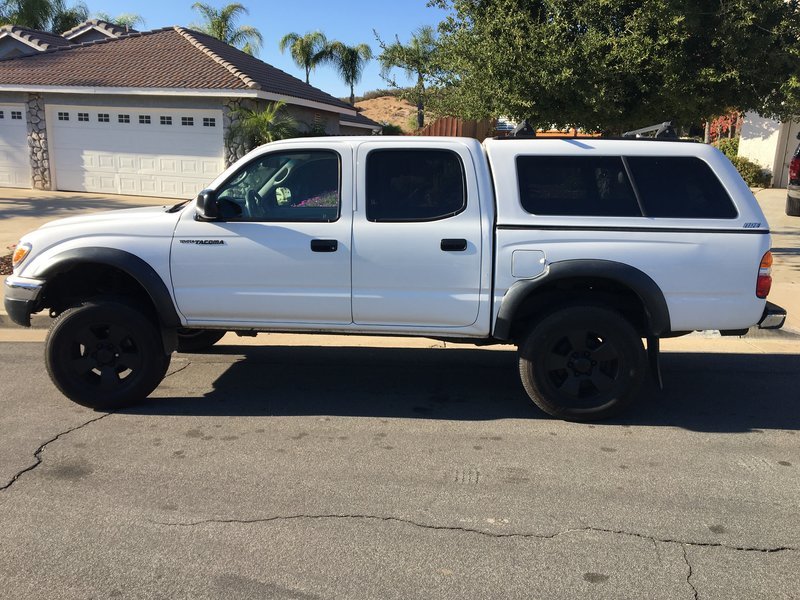

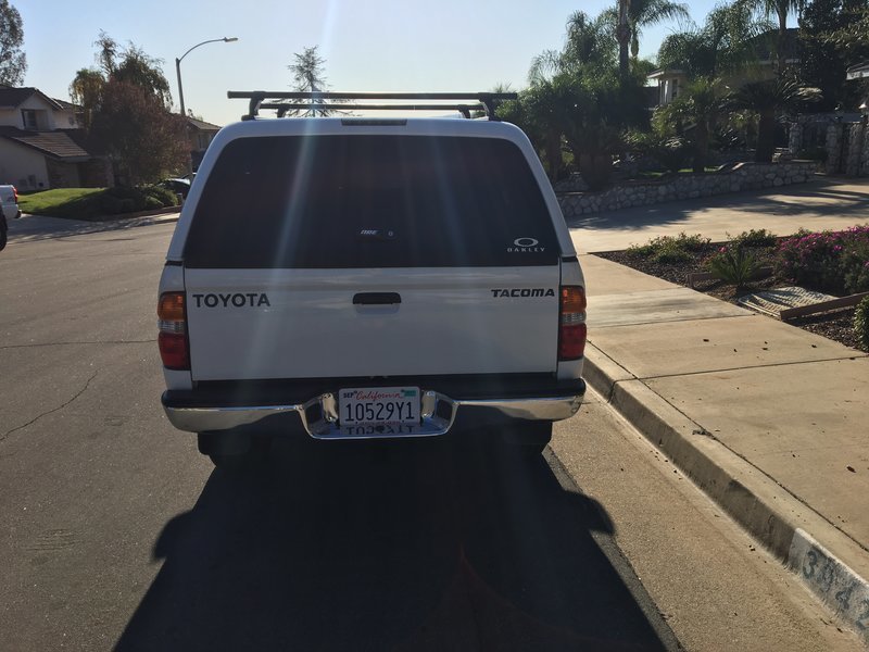

    Finally got my shell. Took me a good while to find it on CL. Paid more than I wanted ($900) but it was exactly what I was looking for. Roof rack already installed, it's fully carpet lined on the inside, and pop out side windows. Only problem is there is a slight gap where the shell meets the bed in one area. I might double up the weatherstripping to help seal it.

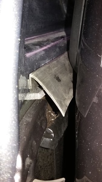

    Your first two pictures look exactly like what my installer did. What is that in the third picture and where did you find it?

    I asked the installer to add a piece of weather strip between the cab and cap. looks like a little flap attached with 3m. it might help a bit of water not getting in
