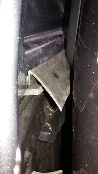

    Dennis, first let me say welcome to TacomaWorld. Now, to really seal it, I removed the plastic bedside caps and added multiple rows of "bulb seal" to help make a water and dust proof barrier. You can also consider some "helicopter tape" to protect the tailgate paint where the rear window rubber wipe will rub against your paint. I used a strip all the way across my tailgate but wish I had also added a couple of inches to the left and right rear bed sides as the wipe on mine is a bit wider than the wind and does seem to walk around a bit.
    Post some pictures when you get it on.

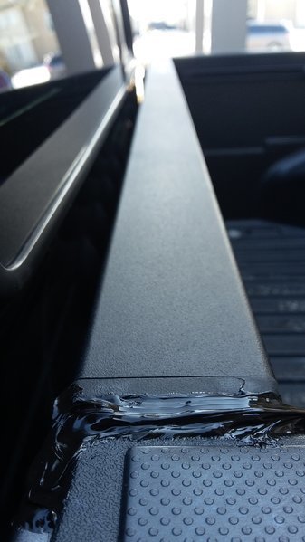

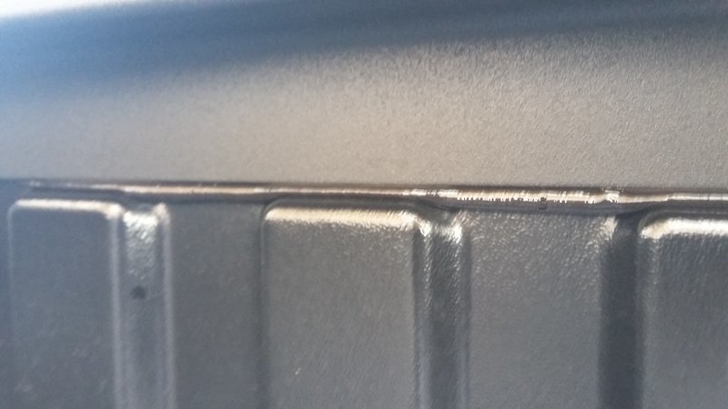

    I used black duct tape for the small holes. Then I cut some door/window sill adhesive that I found at Lowes and placed into the holes in the cubbies on the sides of the bed liner to keep the dust out of them as well. Lastly, I bought and installed a tailgate seal (Ultimate Tailgate Seal with Taper Seal 10ft) for the tailgate. I documented this over on my website.
    http://smithcreate.com/2016/11/24/dust-proofing-tacoma-bed/

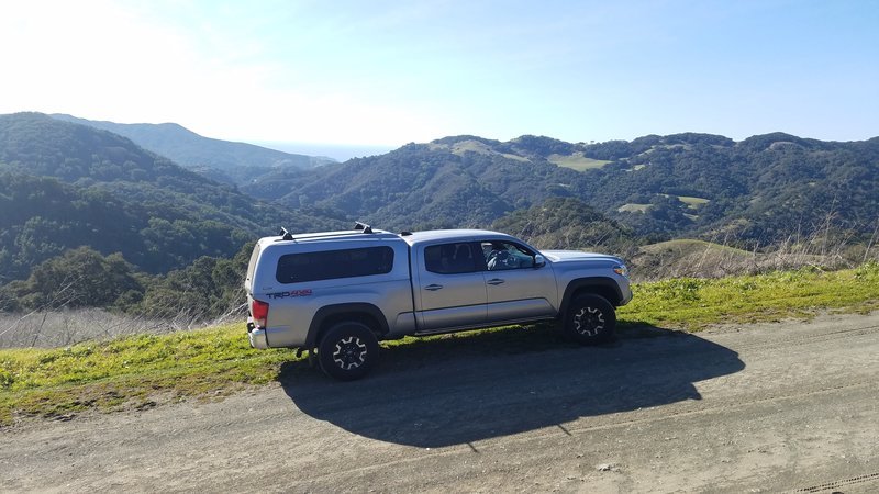

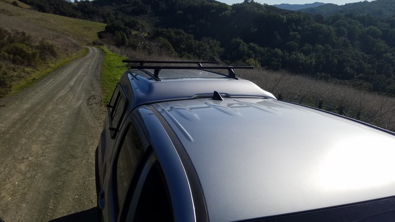

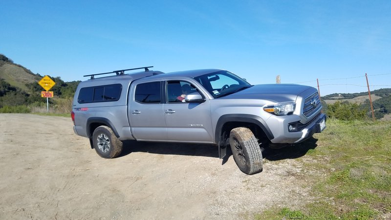

    Snugtop Hi-liner Sport w/ yakima racks, sliding windoors and keyless lock.20161227_124657.jpg 20161227_125407.jpg 20161227_124902.jpg

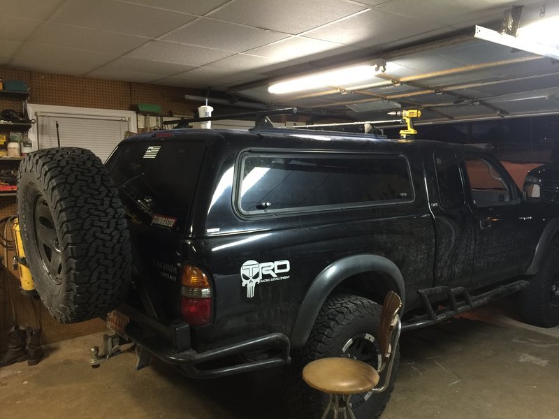

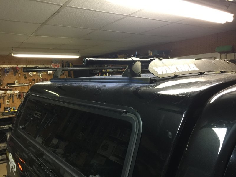

    Add a roof rack system I got for 150 off a 4Runner and it mounted up perfectly
