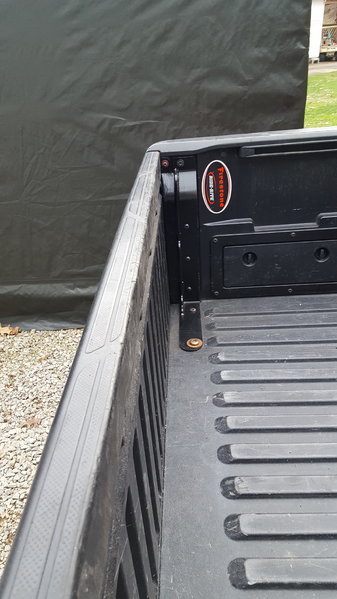

    I have a set of BENTRODDER bed stiffeners. Great quality and price.

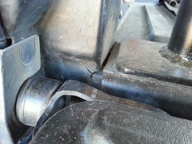

    It's true! I seent it!
    A buddy of mines bed corners with some cracking.

    Does he know what actually caused it?

    It's caused by having bed racks, bed caps, tire carriers, etc... and offroading/trailing your truck. The bed flexes alot and when you have something tying the two bedsides together they can freely flex independently causing the cracks.

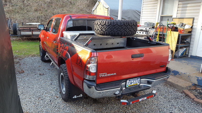

    I started getting a gap between the right bedside and the tailgate when I had my toolbox and tire carrier mounted. I ordered BENTRODDERS bed stiffeners and installed them before getting my cap.

    I do know that, but I meant this particular case.

    You can see the bed rack that bed has installed in the picture. My guess is between that and offroading contributed to the bed cracking.

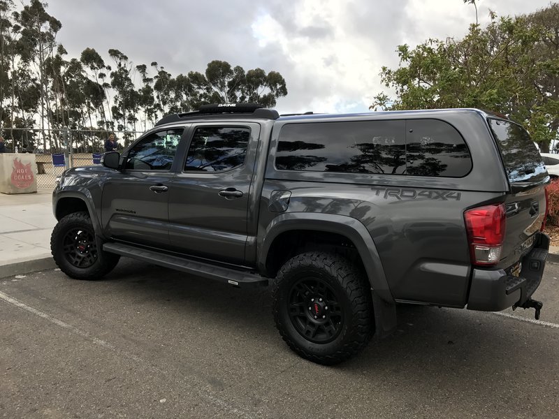

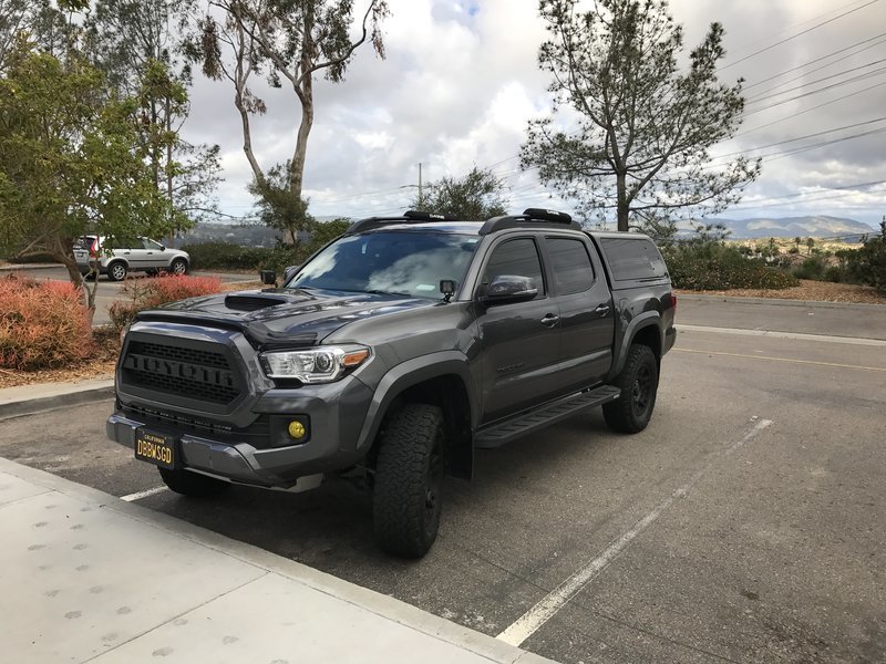

    SnugTop Super Sport... I like it so far. Just had it installed today.
