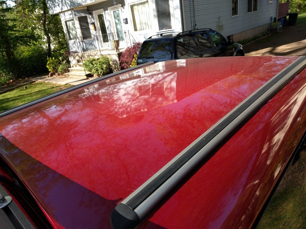

    It's my first cap so I don't have much to compare it with but I can say I like the way the latch feels for opening/closing and the mechanical parts to open the vents feel solid.
    I'm not 100% sold on having a cap but it's growing on me even with the red. I don't have any other pics right now but I'll get some more tomorrow.

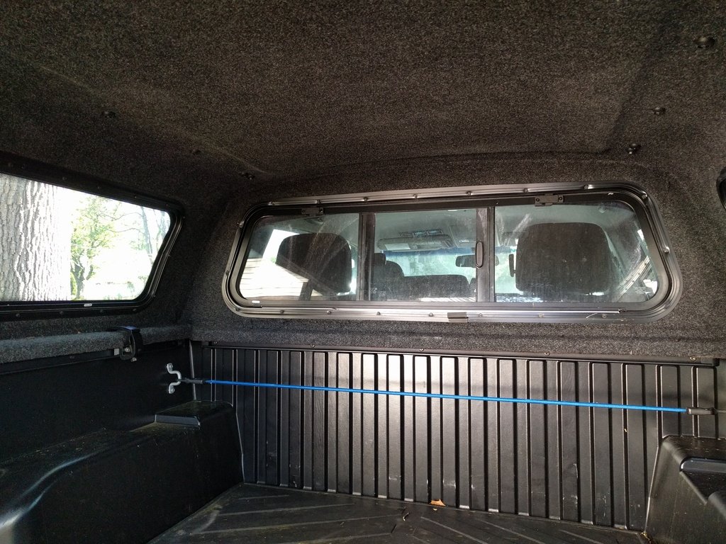

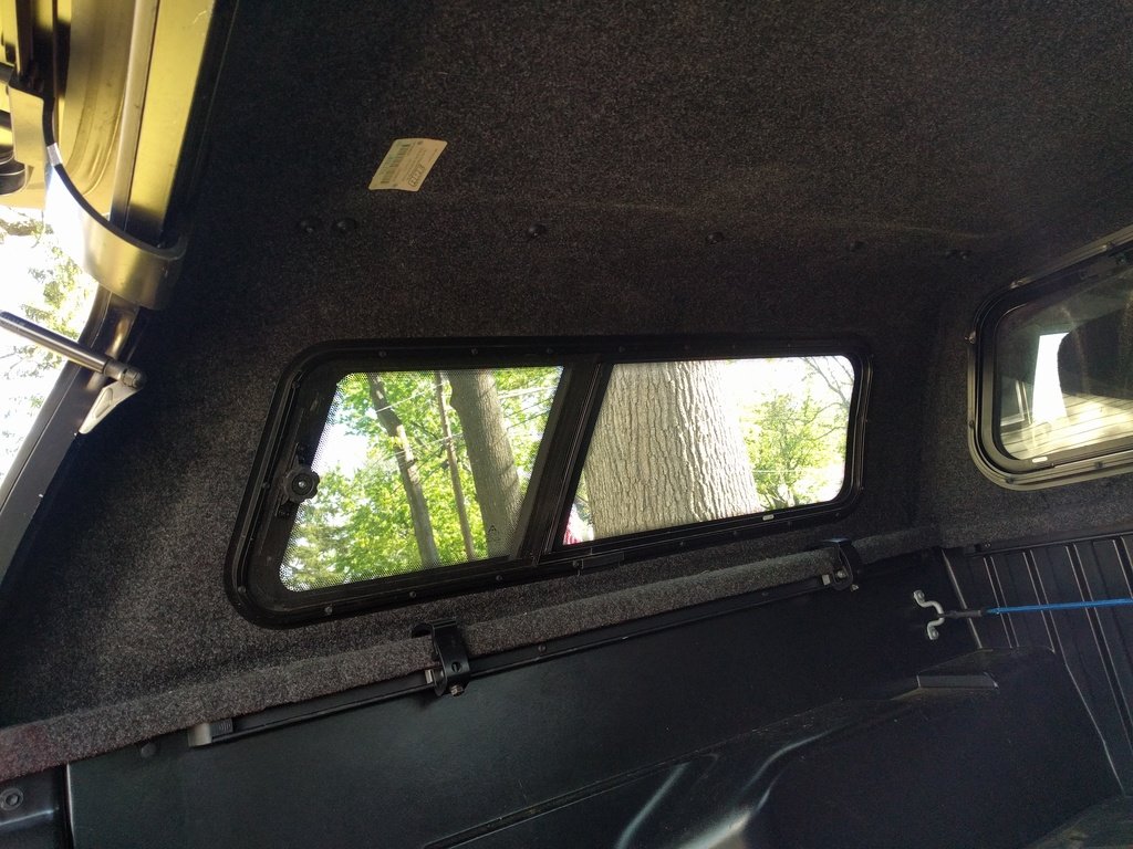

    Here's a couple more pics of the tracks and inside.
    The only thing I need other than color matching it would be the brake light. Any suggestions on where to pick one up?

    That's a beautiful shell! I'm guessing those are inserts or something in the tracks to keep it covered unless you have towers mounted. As for the bike light. When I did the wiring for my cap, all was working. Then a few days later I noticed the 3rd brake light wasn't working. My friend and I tested the wires and power and all was working on that end, so we narrowed it down to the brake light.

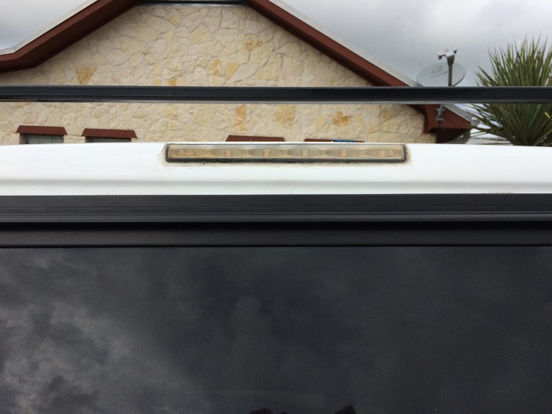

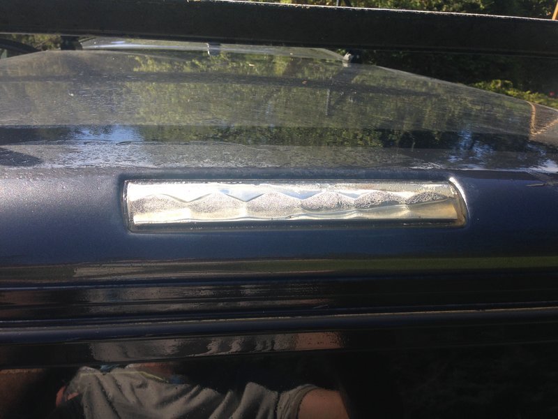

    Anybody else bave this happen ?

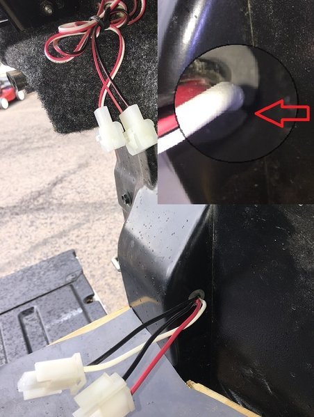

    My Snugtop Sport Hi-Liner was installed back a couple months ago and I have some upgrades planned including some light electrical work. I noticed they didn't bother to pass the wires through a rubber grommet so I installed one once I noticed the wire insulation was already showing minor wear on the hole drilled through metal. The arrow in the photo shows where I had to slice through the grommet to feed the wires through because I had no interest in removing the wires from the connectors. There are four wires here and I used a 1/4 inch O.D. grommet.
    It's no wonder people have their third break-light go out on toppers when installs are done with such little regard for good practices.

    This happened to my leer 100R. It was in this condition when i got it. I just bought a replacement that was the same model in red and i wired it up and sealed it in with silicone.

    Did you figure out how the water was getting into the light ?
    How is the brake light attached , I haven't even looked yet

    I think the water gets into the light right around the edges where the backing of the light connects to the lens. They're held on using 3M automotive double sided tape. The hardest part about replacing the light is removing the old one. Mine was so stuck on there that it was wanting to peel the paint off along with it. This wasnt a problem because i was already planning on repainting it, but its something to watch out for if your shell is already color matched
