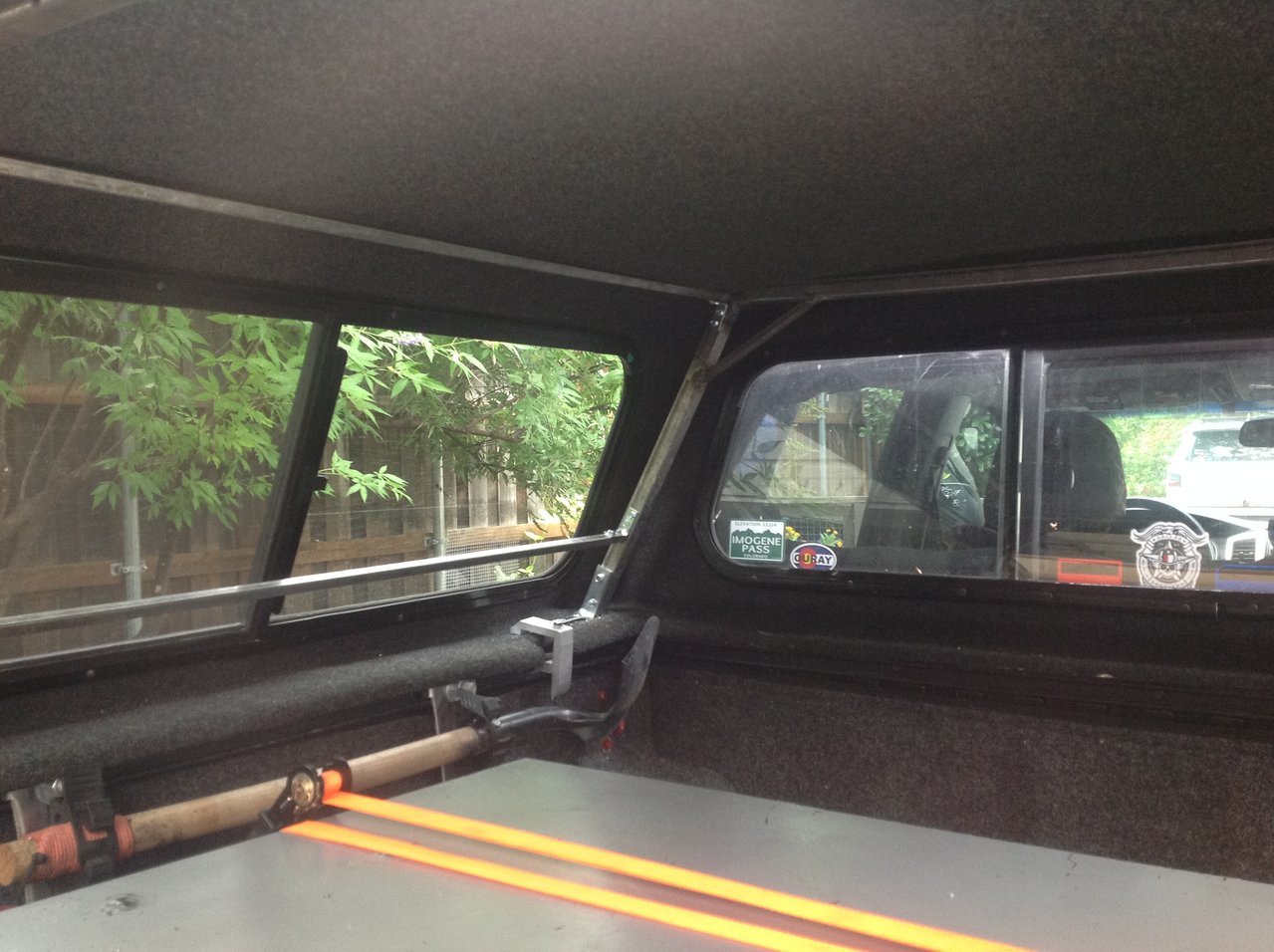

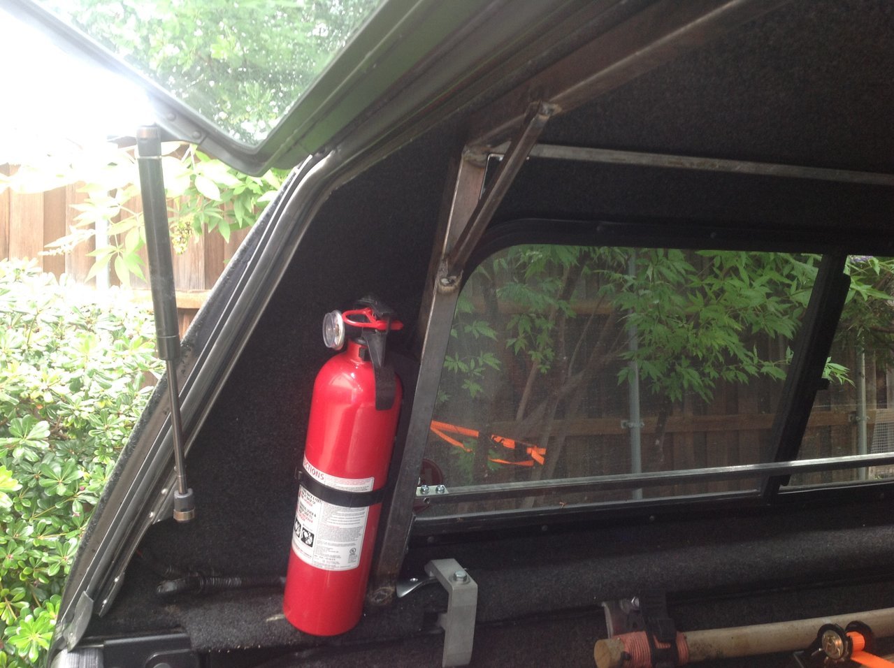

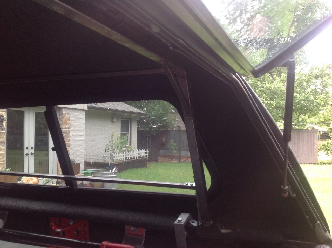

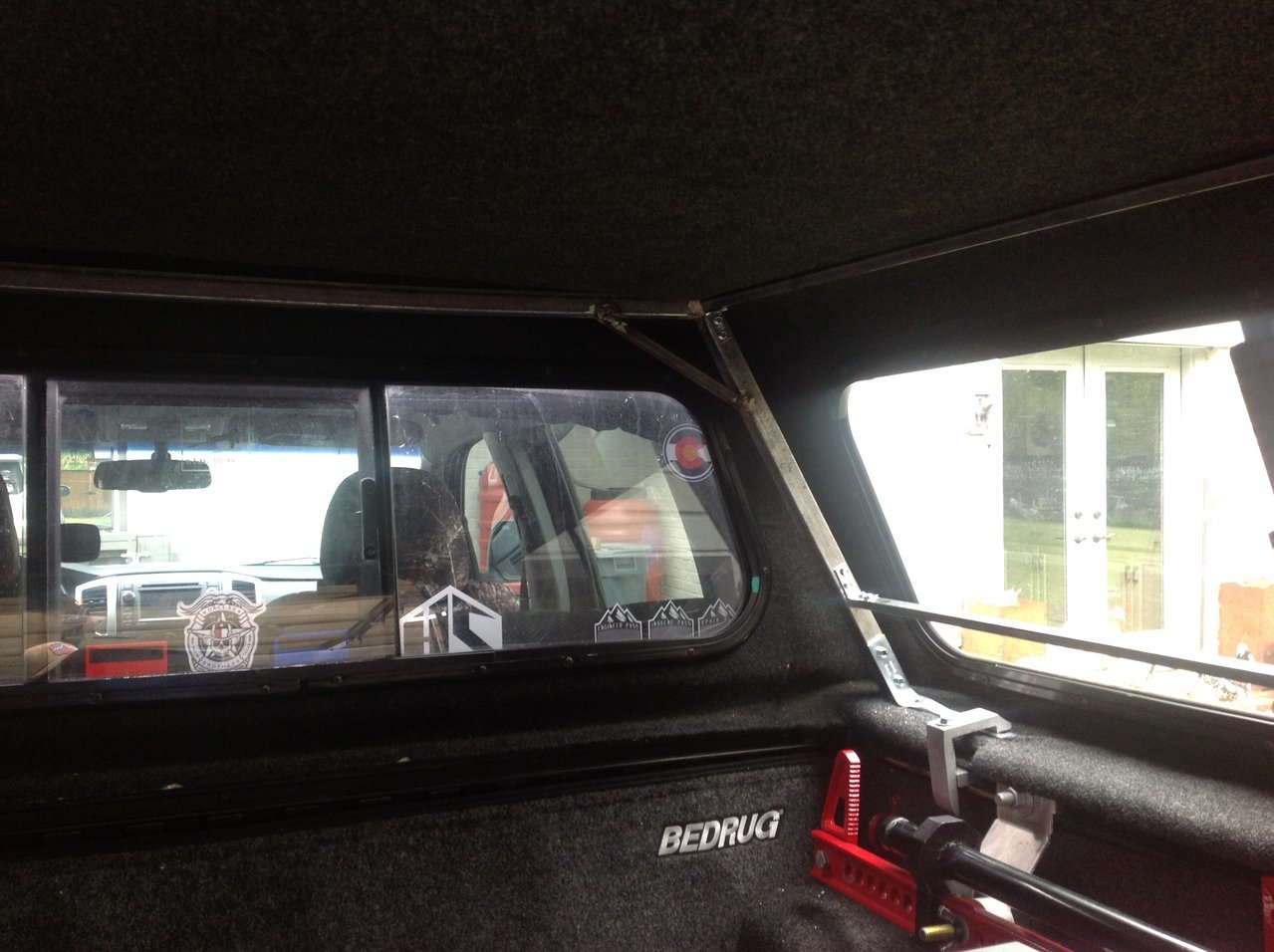

    Fully "caged" my shell in preparation for my new CVT Mt. St. Helens hardshell tent. Going to make a DIY shell rack out of unistrut like @ERMB's, to mount it to. I just got this shell at a good price and wanted to reinforce it since I couldn't afford one with the reinforced top and roof rack tracks. Figured this interior cage would be more than enough. Didn't weld the side bars so I could remove it if I needed to.image.jpgimage.jpgimage.jpgimage.jpg

    That's pretty damn slick! Love how you have the fire extinguisher on there too.

    Thank you! It took me about 8 hrs. That was getting everything designed, measured, mocked up and welded. Now the weight of my tent and my wife and I inside of it, will be dispersed downward onto the bed rails. I'm gonna do some stuff to the 1/2" steel side rails (these were just to help keep stuff rigid and square) so I can mount stuff. Thinking about a molle panel with hinges at the bottom so I can drop them down to access the windows in case I wanna open them. Or may go cheap and just get some expanded metal, could serve as the same purpose.

    Just ordered 2 rigid molle panels from greyman-tactical, like the one pictured. One for each side. It will be 15" X 25.75" and will attach to the 1/2" steel sq tube cross bars. Thinking of permanently attaching them, or attaching a hinge at the bottom to allow them to flip down. Either way, I will still have easy access to the slide window if needed. Gonna head to my local army surplus store to pick up a variety of molle straps and some more pouches. They will likely just hold first aid, small tools and possibly some smaller camp gear. My CVT hardshell shipped today. Last thing to do is my uni strut roof rack on the topper and possibly a Prinsu for the truck cab.

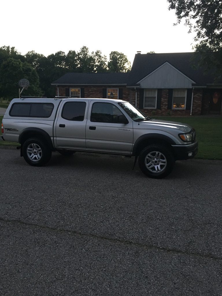

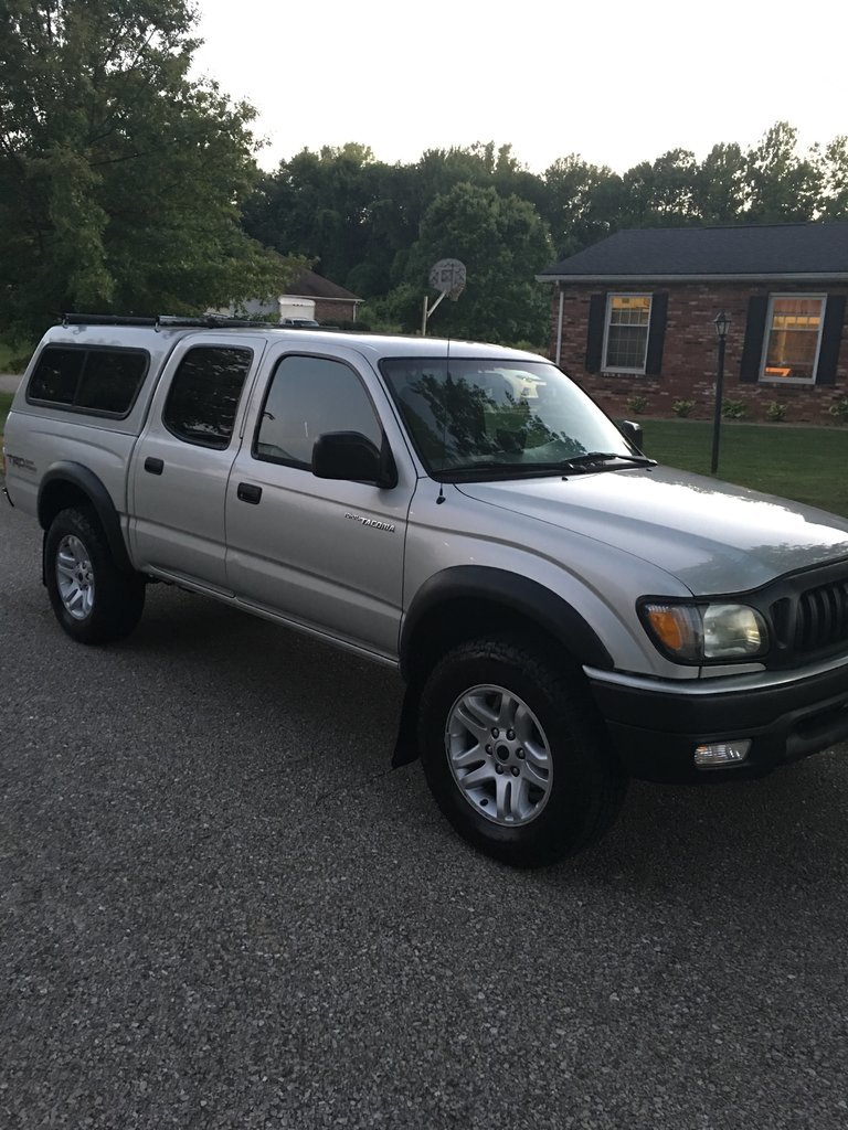

    I have always wanted a shell. Finally found it! And on Facebook marketplace of all places--Only an hour away for $150.
    Although I'm not sure what is going on with the steel pipes on top. But windows and hydraulics are good. My wife still teasing me for looking like an old guy. I disagree with her

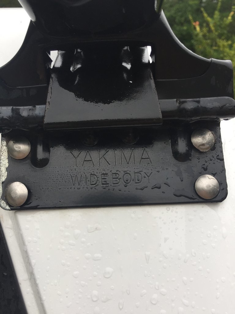

    Quick question, I just picked up an ARE DCLB Z series with Yakima bars...what accessories/racks can I use in the tracks? I'm hoping to do a prinsu if possible.

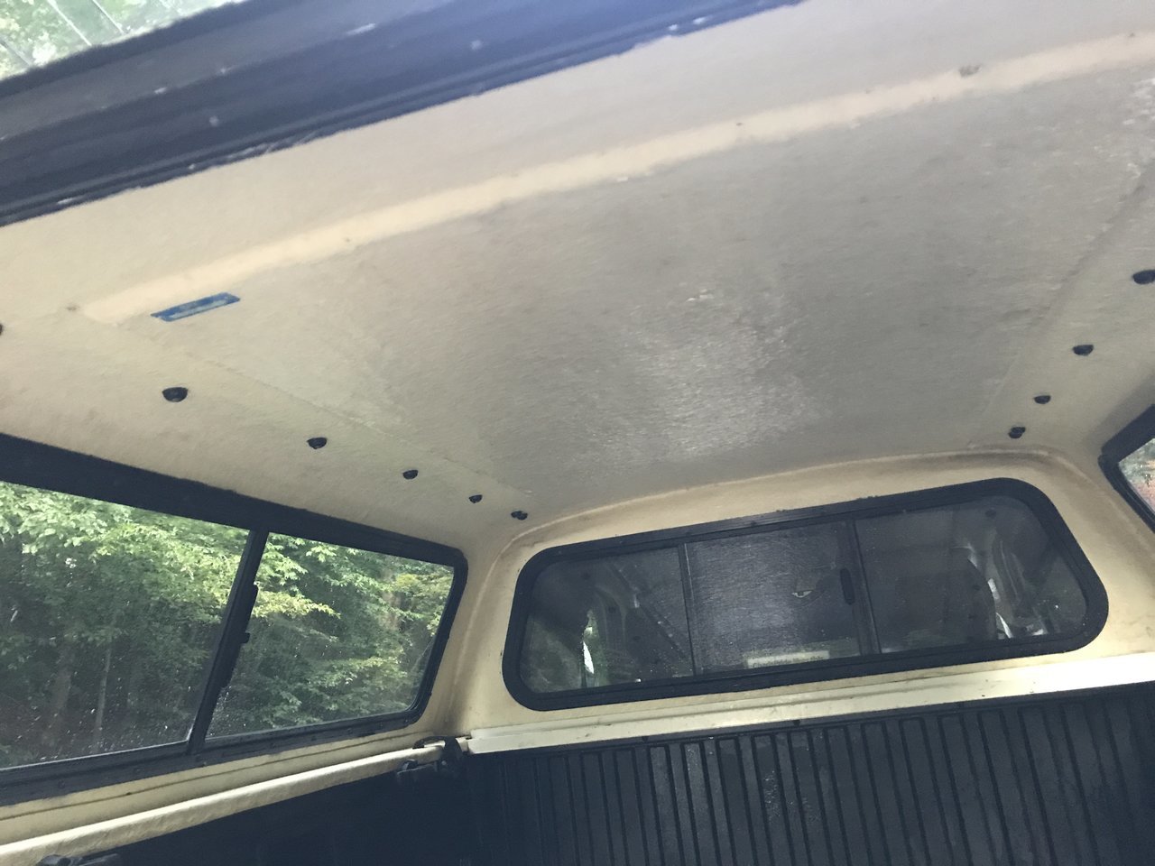

    Scrubbed the inside of the new to me shell with some good ol soapy water and a brush. Worked great! Gonna follow up with some paint to make sleeping back there nicer.
