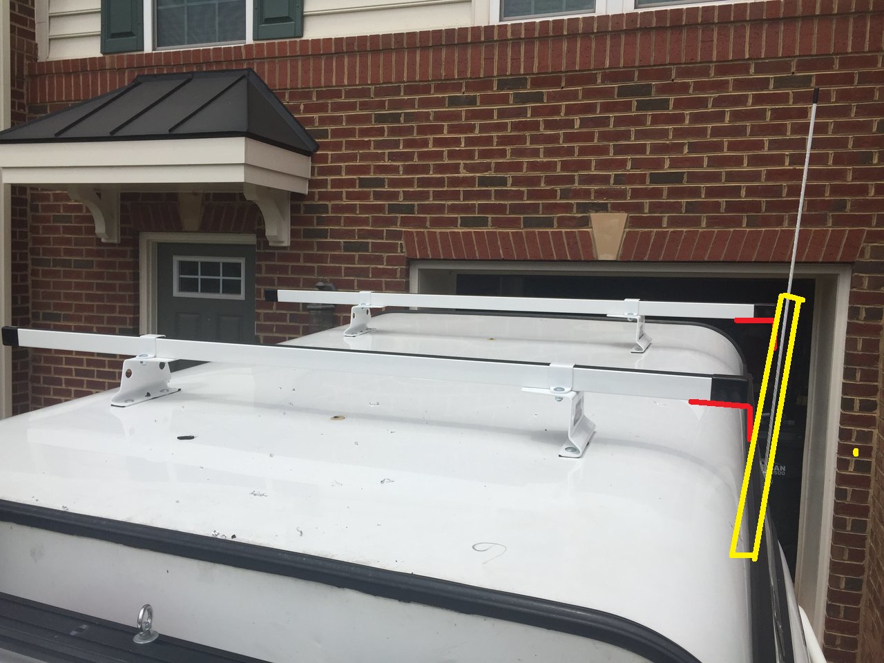

    Really like this rig a lot. Would love to use your idea of shell load bars on my LEER but I would need to support my awning and that would require ingenuity beyond me.

    Thanks! Do you have a contractor cap? My tent has rails that can mount an awning

    I was planning on putting the awning L brackets inside the cross bars.

    You know that is exactly what I need to do. Thank you for that. Can you tell me where you got the load bars and price if you don't mind. I had planned to get a Prinsu for my cap to match my roof rack and I was waiting for a group buy but that is no longer a possibility. One more thing, you have a contractor cap that's rated for a higher static load than my standard LEER. Would I need to put a small plate under the feet of the bracket to spread the load more evenly? I will usually be loading 3-4 sheets of plywood on there. Sorry for the long post, its just that this seems like the direction that I need to go to for me to fully utilize my shell. Thanks in advance.

    Have you seen the rails that are on the fiberglass shells to help spread the load?

    ^^ Yes, I was planning on getting a set of either Thule or Yakima or off-brand, until I saw this set-up. Should probably just get a set of those. I was just concerned that the feet of the load bars appears wider than the rails would be.

    To be honest, I don't think those bars would work too well on a fiberglass cap. On davids, he has an aluminum skeleton on the inside, and the feet are bolted through that which spreads all the weight. On a fiberglass cap, I'd be worried about them just ripping out.

    Sorry, didn't see this. I ordered from rackwarehouse.com
    I think its the Van Tech M1010. I think i paid 120 shipped. They are rated for 500lbs. There is a metal plate that comes with it, for support under the cap. The bars are 59" wide

    ^^ That is great news.. So in your opinion should I get a set of tracks to mount this on? In a previous life I was a Loadmaster on a cargo aircraft and we were always paying close attention to PSI stress points on the aircraft floor, So I'm cautious.

    I would listen to @EatSleepTacos. The fiberglass shells are difficult. I have an internal skeleton on mine. So I just drilled through. You may need to get tracks and a different type of rack, which may be more expensive
