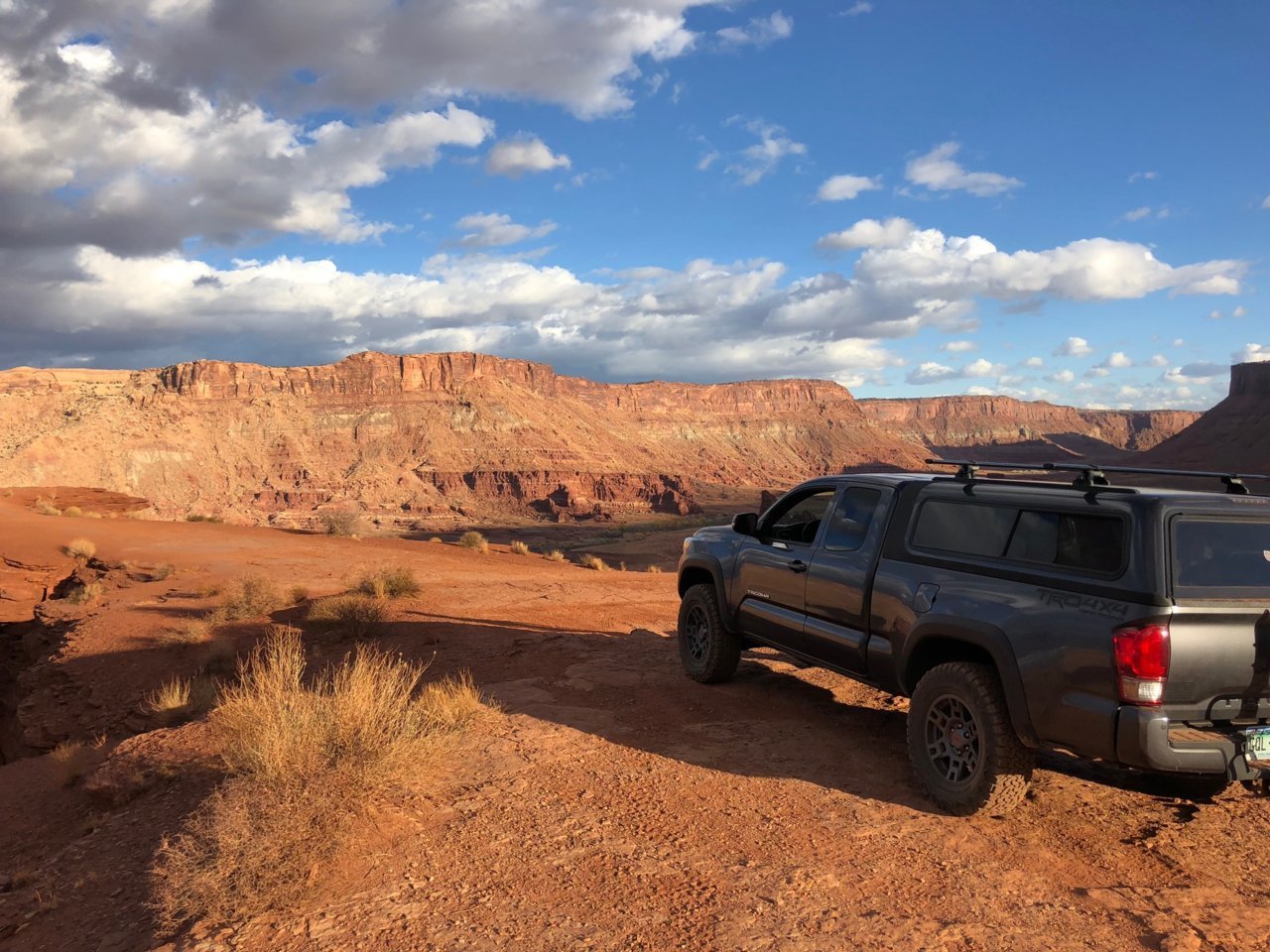

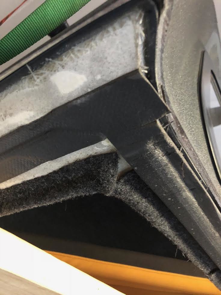

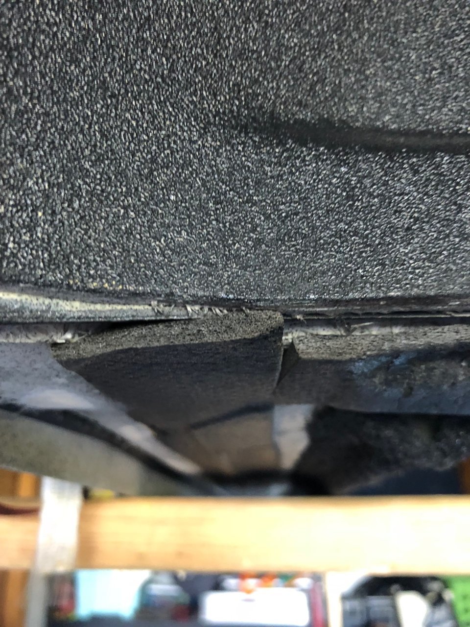

    I pulled my cap off for the summer and noticed the flimsy gasket/seal that was applied... I had been getting frustrated because no matter how tightly I made the clamps it would still slide back a few inches within a week or two.... I'm thinking about replacing the gasket with a bulb type. What do y'all recommend? I have the ARE overland... anybody else have this kind of seal installed? I had taken it back twice to better seal for leaks, I'm not too impressed with what they put on there.
    I included a pretty pic in Moab with it on the truck too :)

    Thanks for the info - it just seems so flimsy and is already torn off on one corner from sliding around. I would've assumed that a more substantial gasket would be used to keep it from trying slide all over

    I’d take it upon myself to use a much better product, like a true gasket. That stuff is trash.

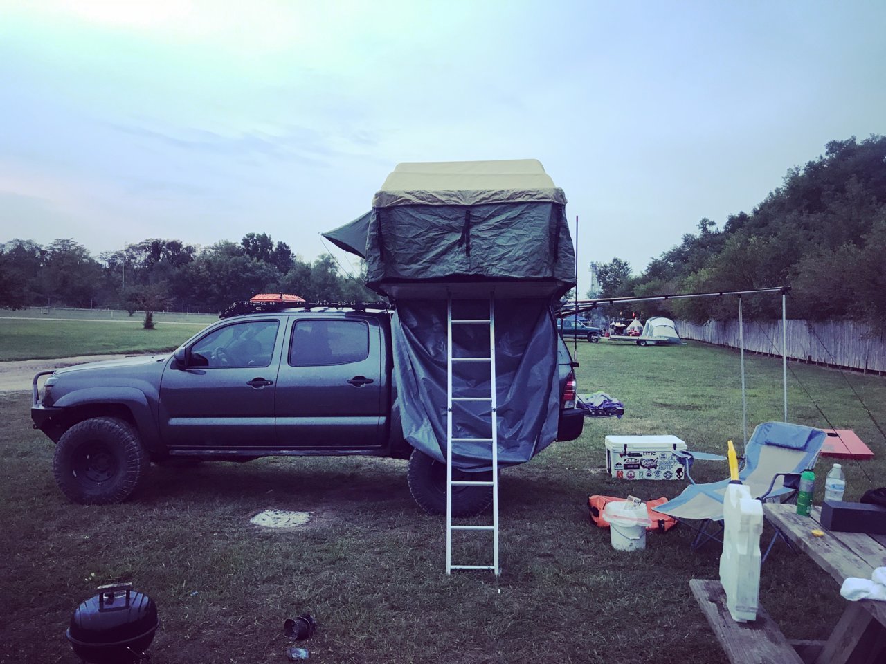

    Any of you guys mount your RTT on your stock shell?

    Yep!

    Awesome! No concerns for "durability" with the weight on top?

    Nope. Proper rack to evenly distribute the weight and I have no concerns. I wouldn't stand in it and jump up and down. I think you get the point lol
