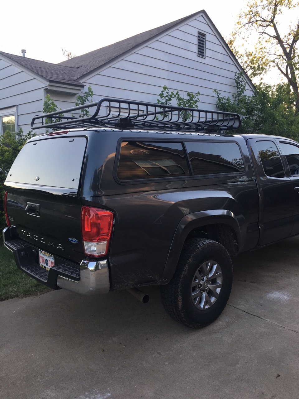

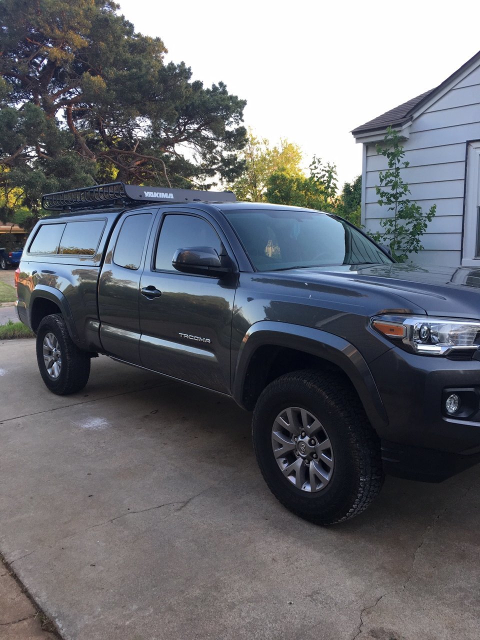

    My humble craigslist finds...

    Sadly, not much.
    Great find!
    What is the load capacity of that basket? 300#'s?

    I don’t think the load capacity is quite that high. I wouldn’t want to go past 200 or so, depending on layout/spread. But it is a pretty stout rig though.

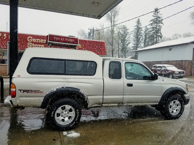

    Just picked up this used Raven Glasstite. Some room for activities this thing!

    What’s all that white stuff?

    Just a late April snow storm. ️❄️⛄

    I hear ya. I ended up mounting a cargo rack on top of the shell. In the event I can’t get it in the bed, it’s getting strapped to the rack. Beverly hillbillies got nutn on me. :cheers:

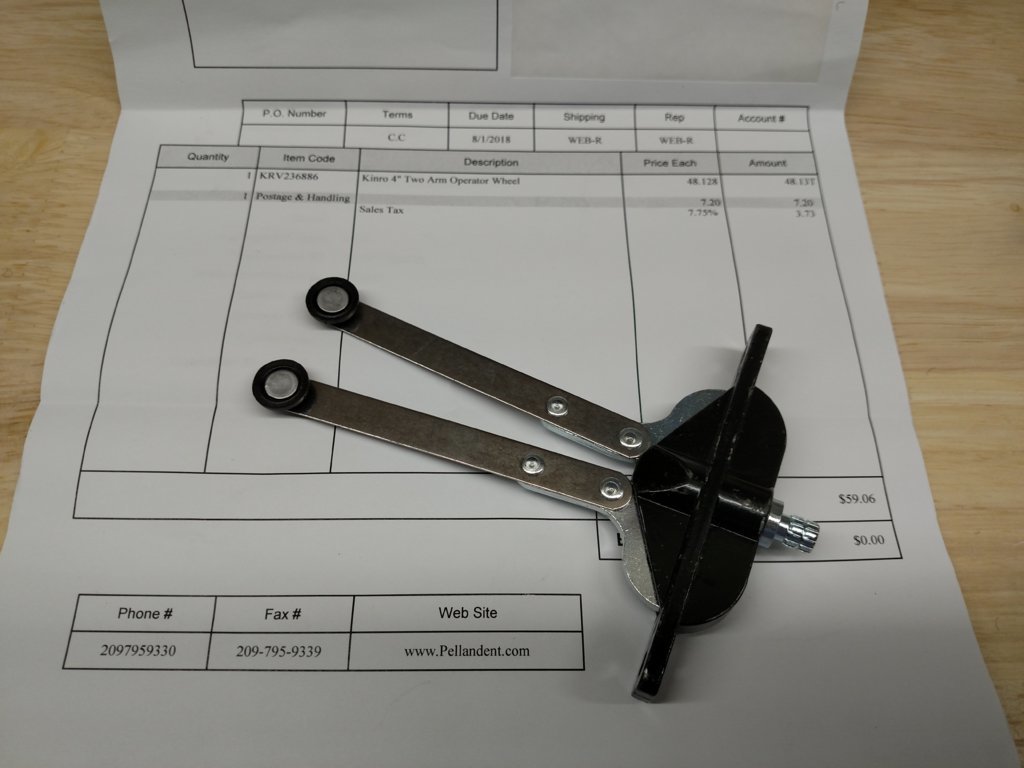

    Here's the part. Not cheap. But not much of a choice. They come in many different sizes, and it was really a pain to try to measure my existing ones in place, but this is an exact fit. Once you get your knob and screen off, drill out the rivets, and I forget the details, but you can basically slide the mechanism forward and it comes right out. I believe I found some screws and lick nut to substitute for rivets.

    You sir, are the man. Seems easy enough to swap them out if need be! Will definitely keep this mind!

    Glad to help! When I pulled the old one out, it was clear the gear and cogs were just binding up at one end of their motion. I had already tried spraying a bunch of white lithium in there to no avail. And I knew that would just end up attracting dust and turn into a gummy mess over time. I wish the crank handles were metal. I tried sourcing some alternatives, but that was fruitless.

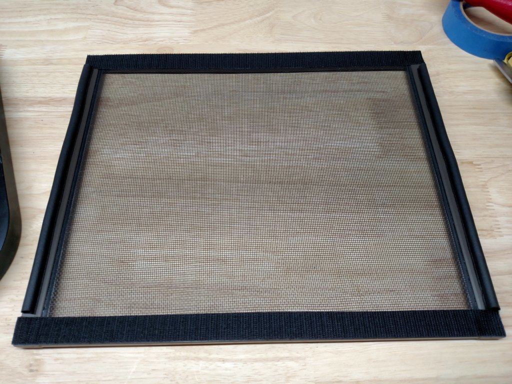

    I also made a removable screen for the front slider to improve ventilation, especially when camping and sleeping inside.

    I just got a screen kit, adhesive Velcro, and neoprene D-profile weatherstrip from Lowe's. The mount surfaces are not all in the same plane, so the Velcro attached at top and bottom, and the D-seal filled the deeper gaps at the sides. If you have a removable slider you can pull out and put on your bench, it's pretty easy to fab something.
    I did this really fast in prep for an upcoming trip. If I had longer to fiddle, I likely would have tried a more traditional screen catch system, but some of the off-the-shelf stuff I got was just not going to work without further modification. The Velcro adhesive may become a shit show after a couple seasons of high heat, but if you don't intend to remove it much, or at all, it might be OK over time. I sold the cap later that summer, and it was still fine at that time.
