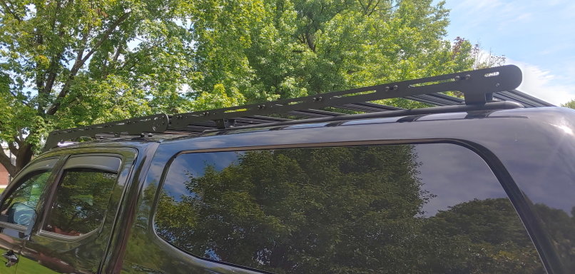

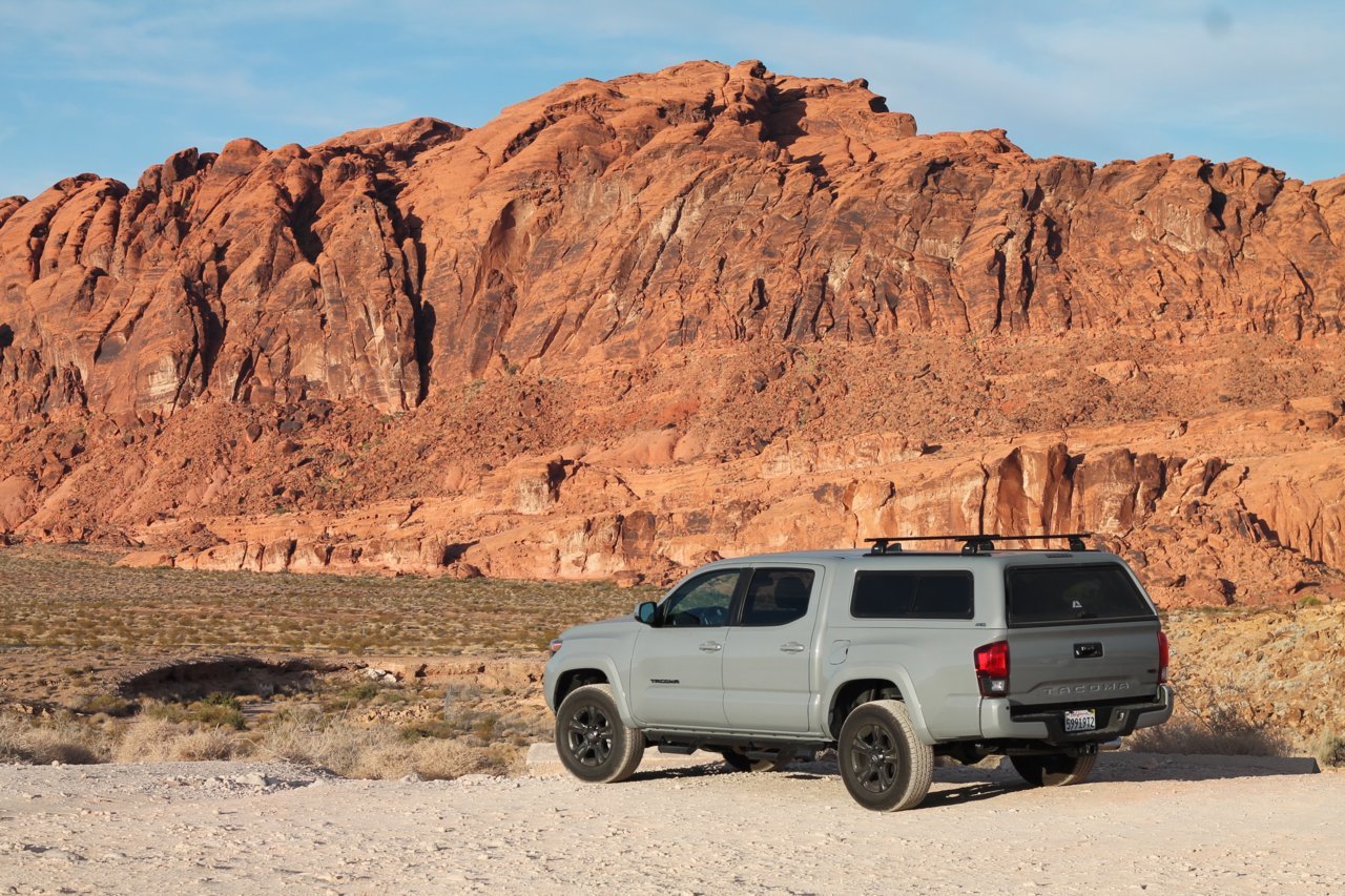

    Added top rack on the topper:

    Looks good. What roof tracks and rack are you running?

    cab and top racks are from Prinsu Design Studio. Their site: https://prinsudesignstudio.com/
    The track rails came with the topper but it's from Thule which can be sold at any Leer dealers.
    If Thule rack comes with your topper, ask your dealer/shop to swap the track rails around.
    Information and the reason about the rails here: https://www.tacomaworld.com/threads/prinsu-leer-topper-install.596882/page-2#post-23431721

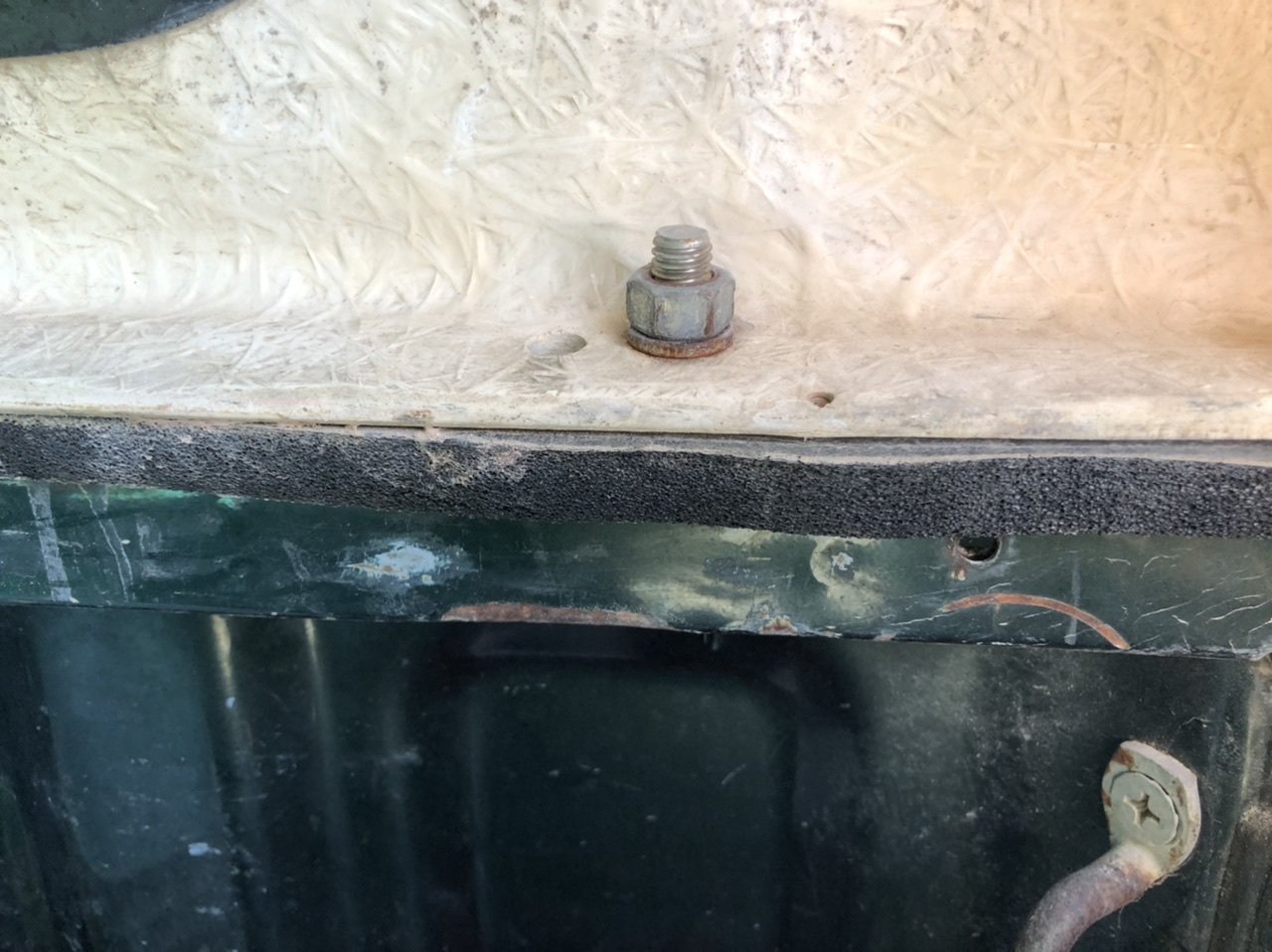

    Any pics of your bolt mod?
    I’d hate for my shell to shift, i was worried about those c clamps while vibrating my way down a washboard road.

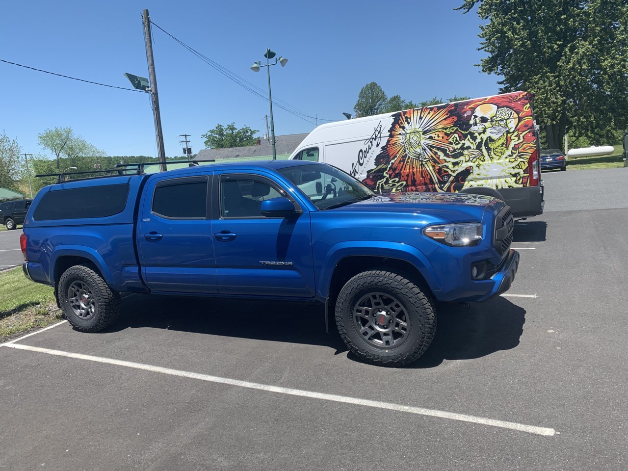

    Pic just because

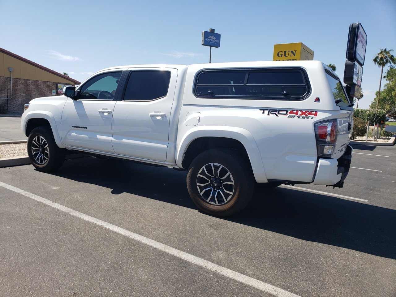

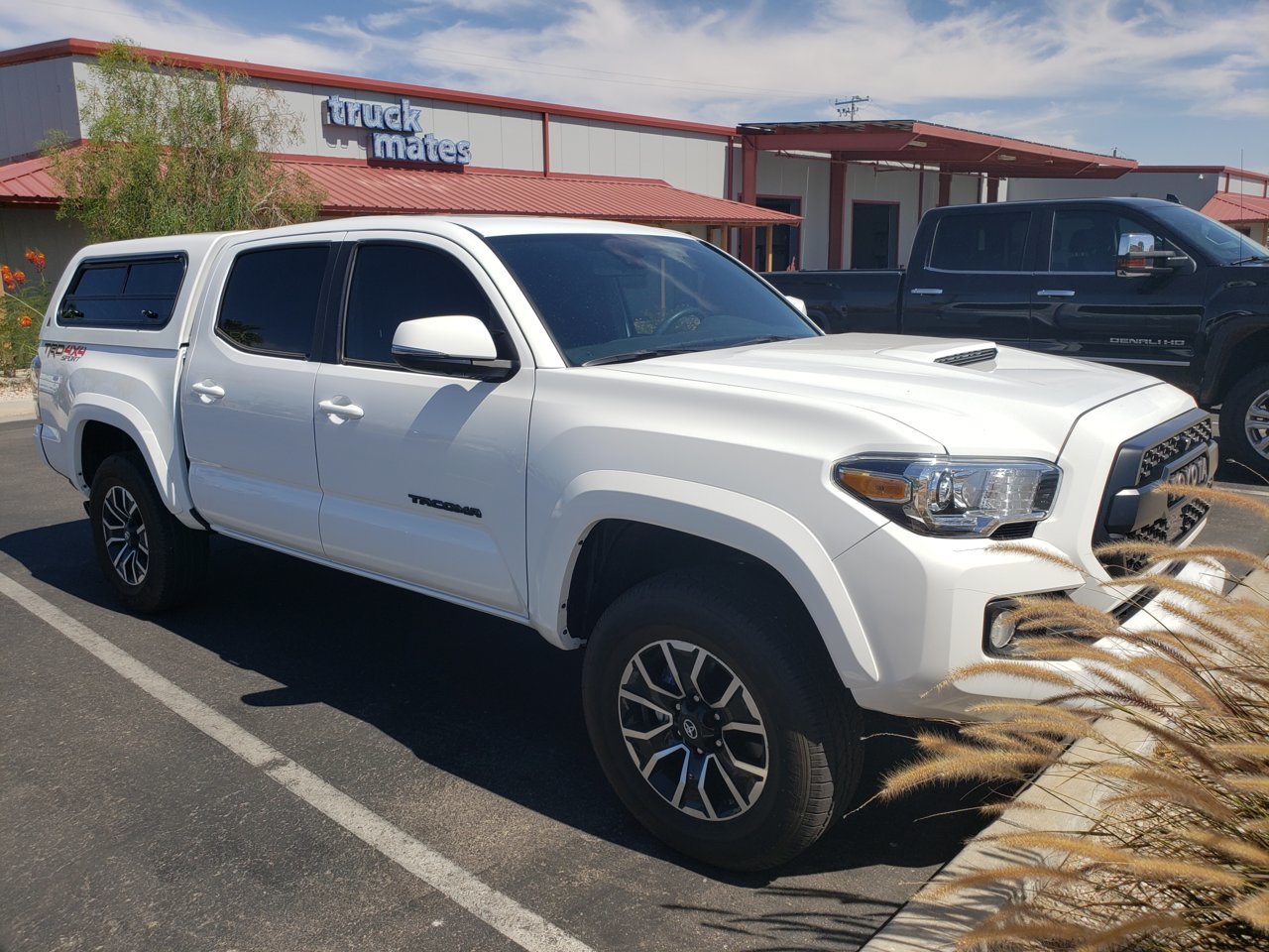

    Just installed my Leer. Went with windoors for use/access.

    Nice! Is it normal of that design to overhang the bed that much? I assume it's to help keep rain out?

    Yes... Was the first thing I noticed too but its by design. In time Im sure I will get used to seeing it. Im going to remove the TRD Sport bed stickers as well and that will really help the overhang blend in better.

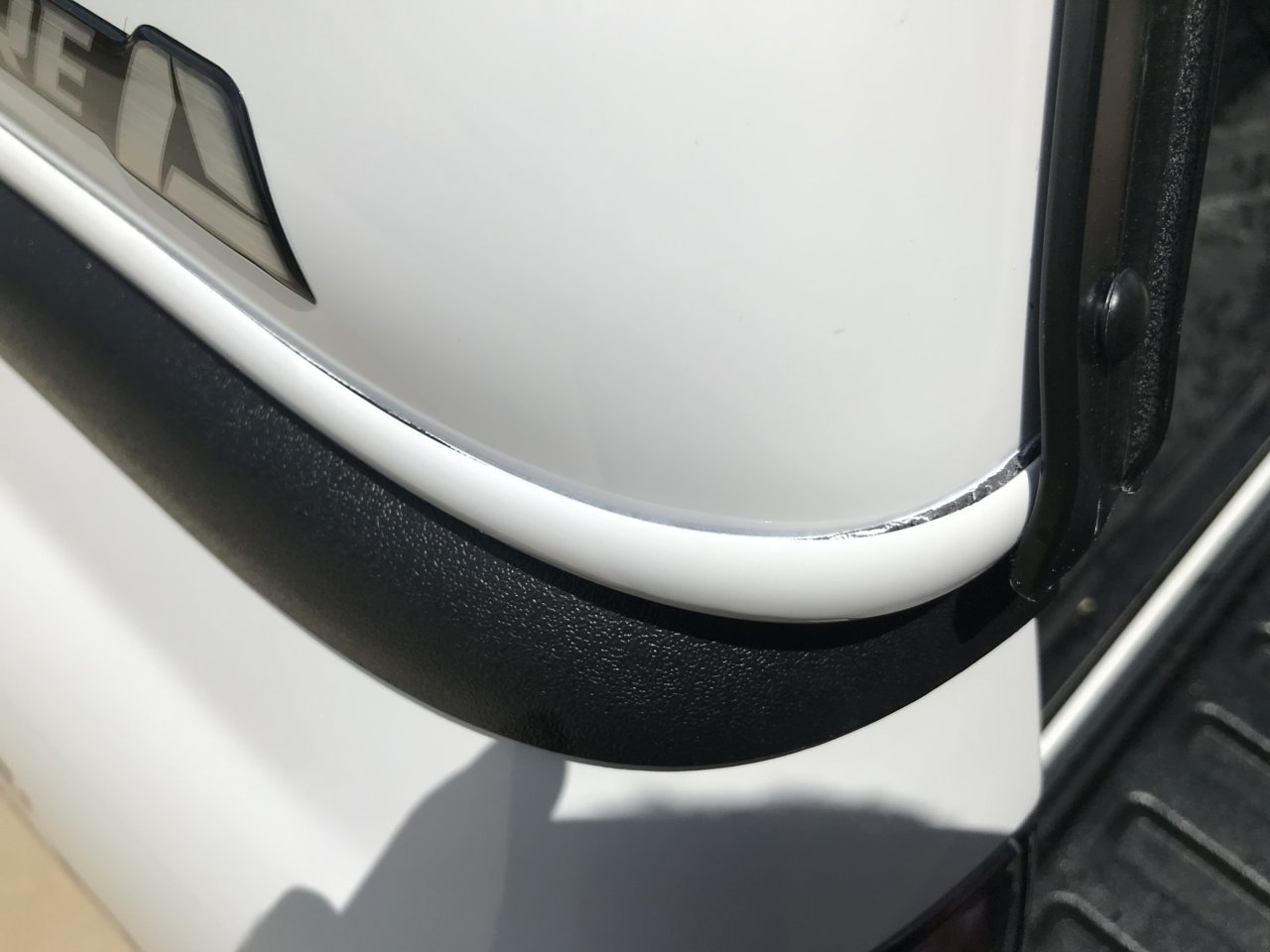

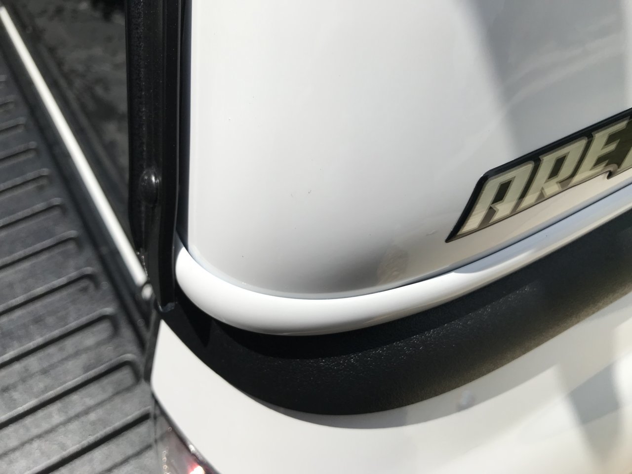

    I know the ARE caps can eventually have issues with the bottom edge trim separating but did anyone else have theirs look like this brand new? Its only on the drivers side rear corner.

    Mine does not look like that. If it's new I would get that fixed by the dealer.

    1/2” hole and 7/16” hardware.

    Thanks, I'm going to have to bolt that down. Those C clamps make me nervous

    mark where you want it with a sharpie then use a long 2x4 to support the weight across the bed rails. Slide the topper over enough to drill the hole in the camper, possibly from below. Side back over and set it down. Mark the bedrail then reposition the topper again to drill the bedrail. Do a 3/8 hole or so first and then a stepper bit to reach 1/2”.
    Be mindful of what’s below the bedrail. My 1st gen has some perforated support and you may need to drill both sections and use a longer bolt depending on where you put the holes.
    If you’ll look at my pic again you’ll see 2 holes. The first one pinched/boat tailed my bedside just enough that the tail gate would drag a little on the latch. Apparently had been that way with the clamps and I didn’t notice. So I used one of those extending ratchet bed securing things to open it up 1/4” for a new hole.
