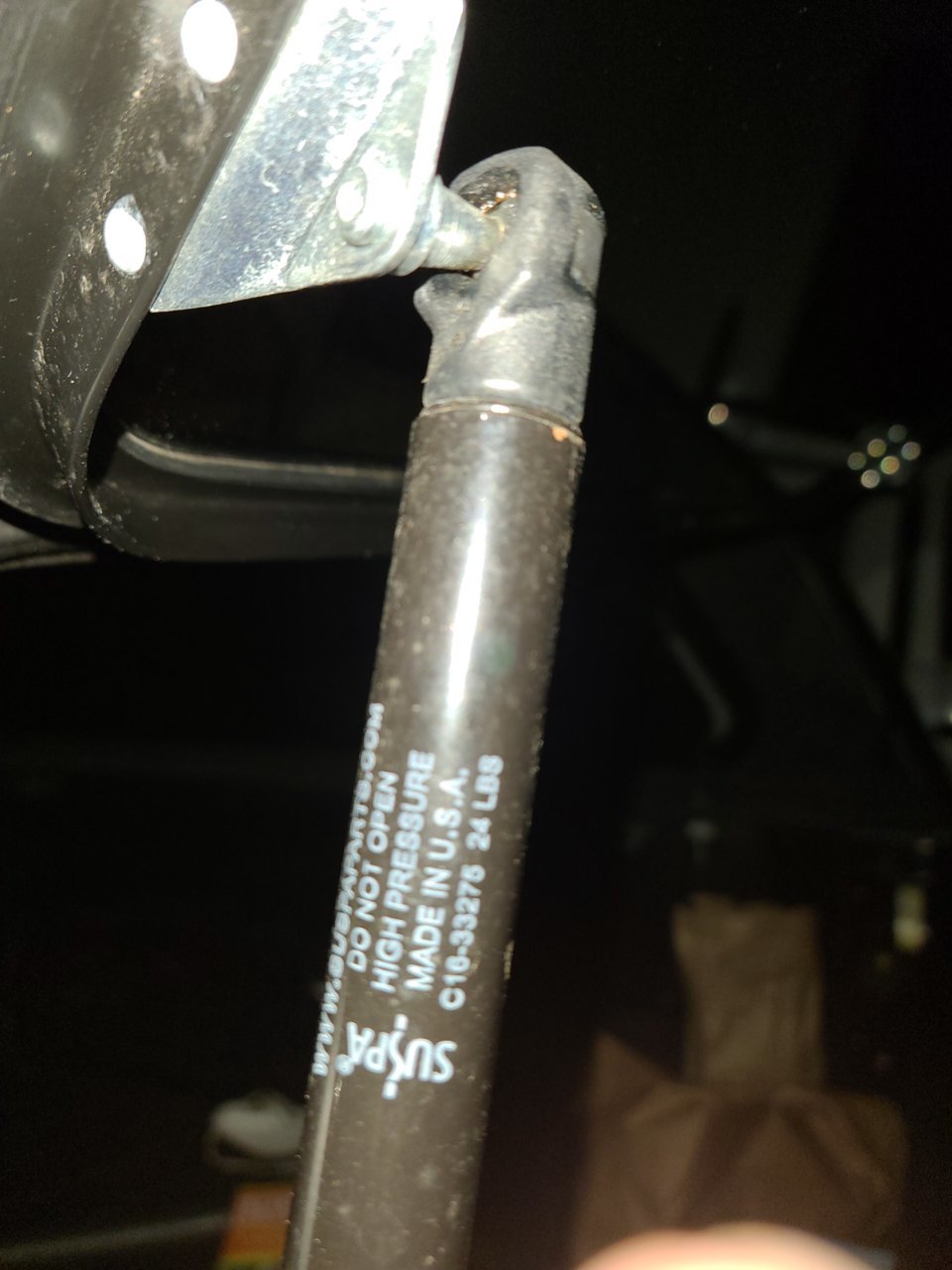

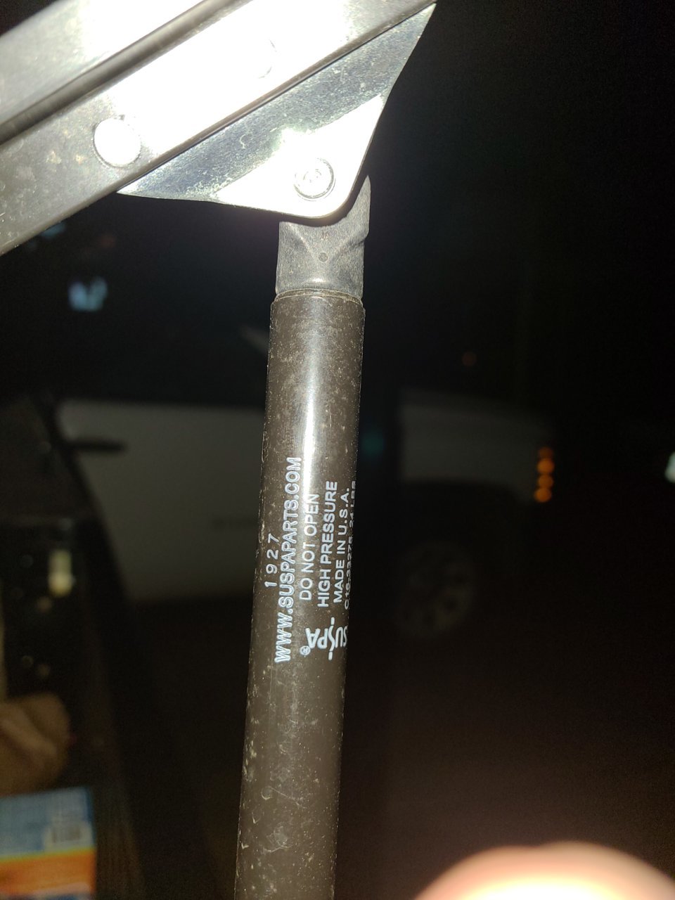

    Stock for now.. maybe
    Mine is a framed back window. If you have a frame less I think the use 30lbs or something because the frameless window is heavier
    Edit- these are what came factory on my Leer. About a year old
    Edit- in case you can't read my pictures well it says 24lbs

    Pop the strut off and measure the ball ends. Most likely 10mm. Then climb in the back, close the hatch, and measure the distance ball to ball. This will be the minimum compressed length you can use. Open it up then measure ball to ball and this will be the maximum of the current strut. If you find a longer extended length that still comes in shorter than the minimum compressed then it will still work. It will just open further.
    The biggest hurdle is figuring out your lift rating if it is not marked unless someone chimes in. Google the ball size first. Then narrow it down with lengths compressed/extended, and lift rating.

    Thanks for the info on the struts. On order. For my Leer 180 I went with the 10mm ball fittings, 35# lift, and 17" length.
    Edit add: Got them in and installed. They fit & function fine.

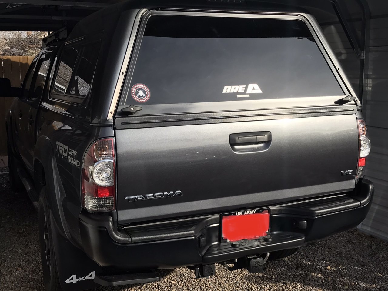

    I’ve tracked my mpg before and after A.R.E. MX topper and had no decrease in gas mileage. I was expecting it, but nope—no difference. What did decrease my mpg’s was adding my Prinsu rack later. To keep prying eyes out of my topper I added 20% more tint on the windows. And to help rear sag when towing, I added a Toytec AAL.
    My topper does not have a rack on top. It’s that Prinsu rack on top of cab that has decreased my mpg by about 2mpg. Best mpg’s is at 65mph. I’m set up for camping adventures and tow a NuCamp T@G XL teardrop camper.

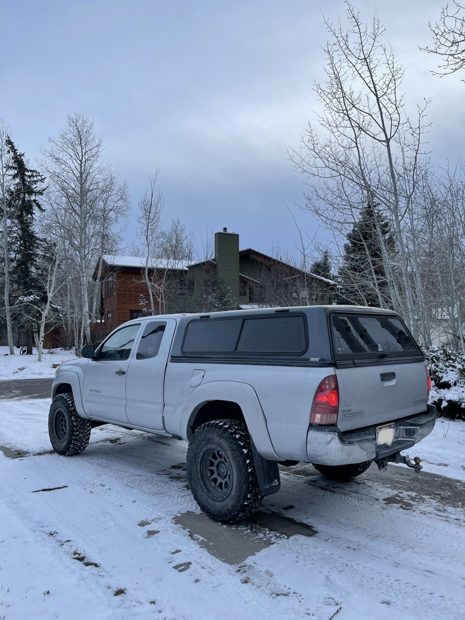

    bought used for $250 hence the mismatch colors, might not repaint it

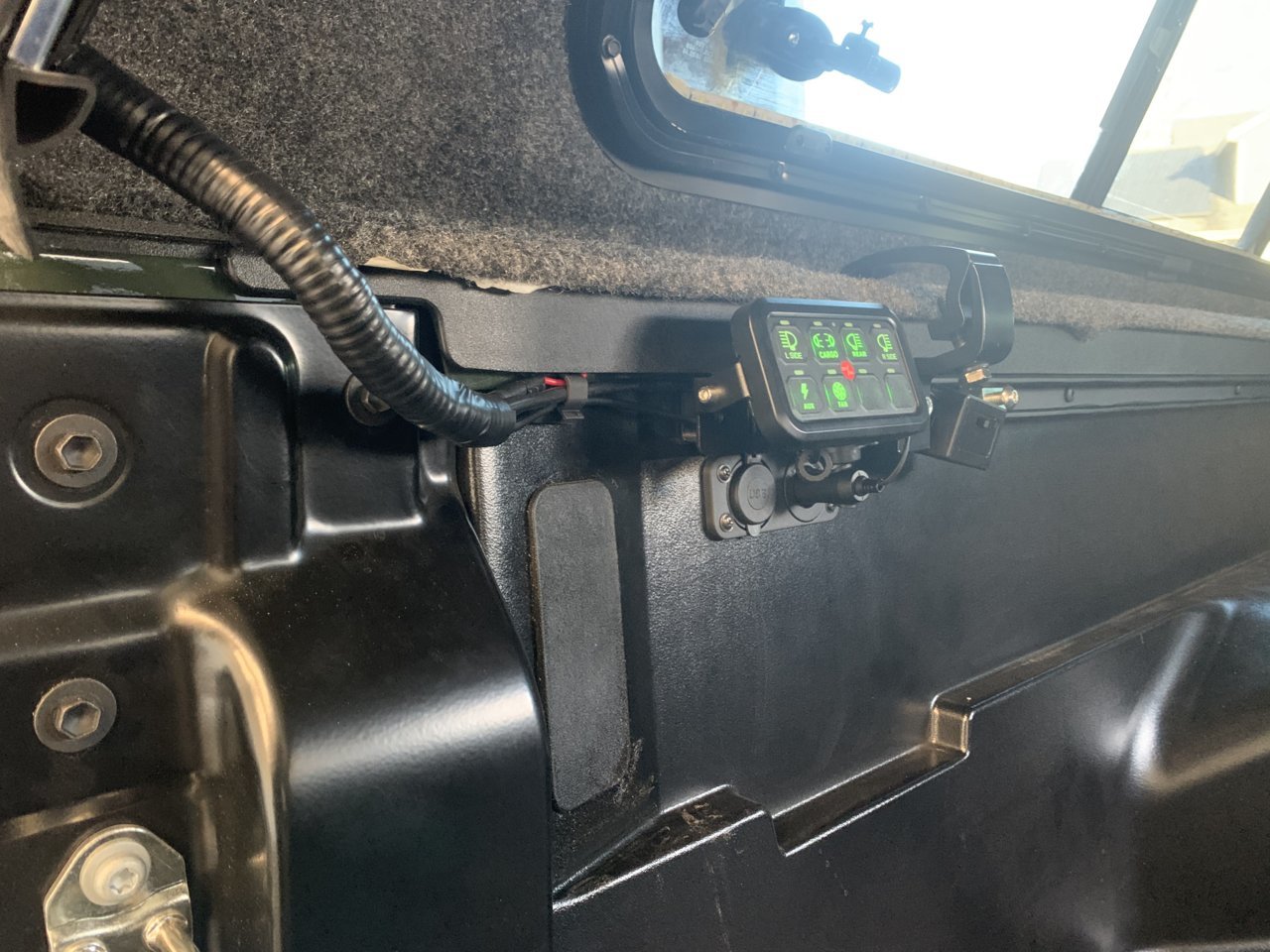

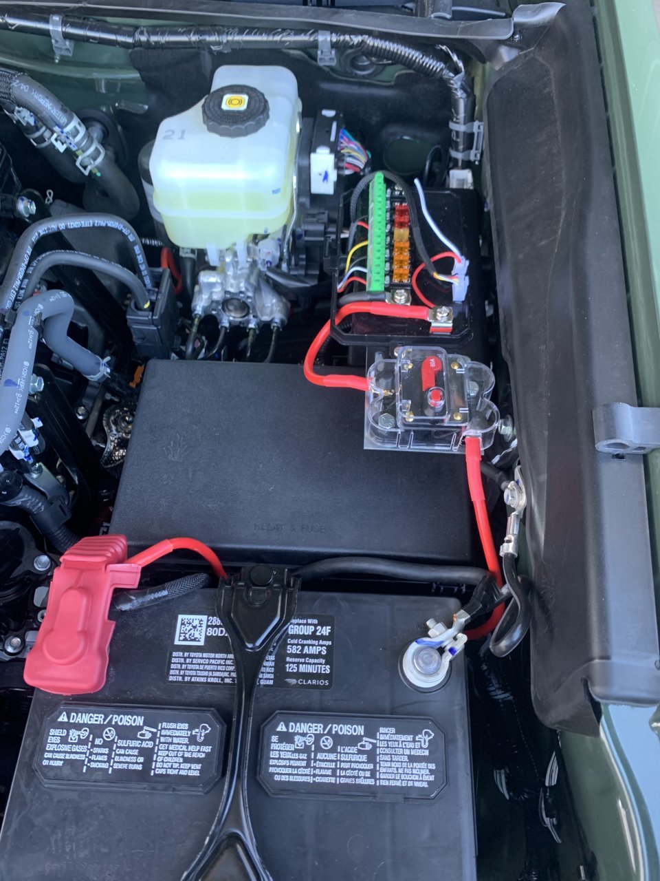

    Parts used
    Lights:
    White LED Strip Lights, GuoTong... https://www.amazon.com/dp/B075LB9HK2?ref=ppx_pop_mob_ap_share
    switch panel:
    8 Gang Switch Panel, AKD Part... https://www.amazon.com/dp/B07SWJHVY5?ref=ppx_pop_mob_ap_share
    USB / 12v port added:
    Quick Charge 3.0 Cigarette... https://www.amazon.com/dp/B089M9GGWS?ref=ppx_pop_mob_ap_share
    Wire used for the usb / 12v:
    Striveday 18 AWG 2 conductor wire... https://www.amazon.com/dp/B07Y332K8T?ref=ppx_pop_mob_ap_share
    Wire used fir the lights:
    Striveday 18 AWG 4 conductor wire... https://www.amazon.com/dp/B07Y34QCDX?ref=ppx_pop_mob_ap_share
    Wire used for the the switch panel extension:
    Striveday 22 AWG 4 conductor wire... https://www.amazon.com/dp/B07Y34HJH9?ref=ppx_pop_mob_ap_share
    How I did it:
    Mounted the fuse panel in the engine bay. Took the 18gauge 2 strand wire and plugged them both into a positive terminal. Took the 18 gauge 4 strand and plugged all them into a positive terminal. Wrapped all of those together and ran them through the engine bay and down the frame rail to the bed. Drilled a hole in the bed rail where the switch panel is. Tan all this positive wires out that hole.
    Cut the switch panel wires (since they weren’t long enough to reach from bed to engine bay). Re connected them / extended them with the 22 gauge wire I listed above. Ran that along the same route I did the other wires, plugged it into the plug in for the switch panel.
    Mounted all the lights, switch panel, and usb dock. Connected each one to their respective positive terminal wire running from the engine bay. Wired in the ground wires and ran them all to a ground point under the bed (to avoid running those all the way to the fuse panel in the engine bay)
    My switch panel has left lights, right lights, inside lights, rear lights, usb, and a 12v button. Which is why there are 6x 18 gauge wires running from the fuse panel to the bed. Buying the wire listed above makes it simple and keeps the wires nice and organized / shielded / easier to run under the truck.
    sorry for such a vague write up. I don’t have the most time on my hands to snap pictures and do a detailed description.
    edit: here’s a few pics from my completed panel / fuse block (these were both provided in the switch panel link above)
    Also: by no means am i an electrician. Could I have done mine differently to be safer? Maybe. Idk. Lol. This is the third time I’ve wired a truck in this exact manner and haven’t had any issues. But again, I’m not responsible if your truck burns to the ground.

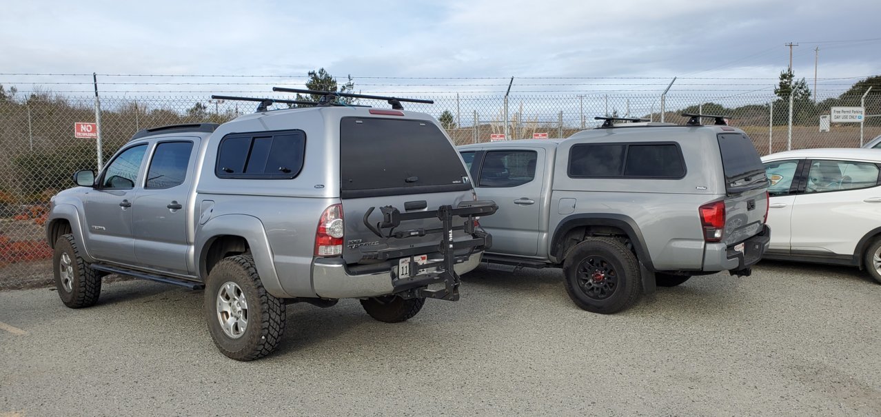

    Snugtop Sport Hi-Liner
