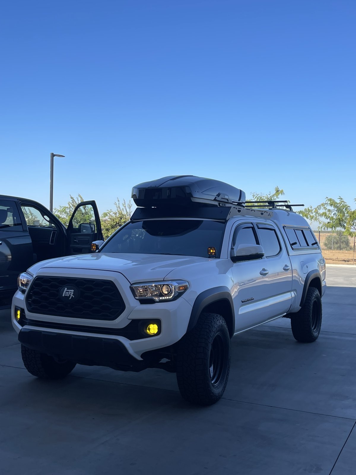

    Are Mx, with thule rack, Sherpa front rack the rack in the front balances it out. Thought it looked good yesterday leaving the station

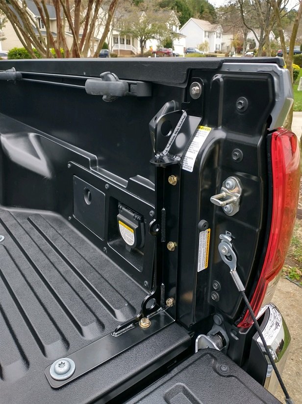

    Hey guys . I know this may be a little off the subject. I have a question for you guys . Has anyone had any issues with the weight of the shell causing problems with the bed ? I had read a while back that having a rack and or a shell on our trucks that it was causing the bed to wear out the composite bed where it meets the frame and make the bed loose .Also all the weight of the shell basically sits on the sheet metal that sits on the sides of the composite bed. I am thing of putting a shell on my truck but am hesitant due to this issue . Any and all info welcomed .

    Yes.
    pickup truck
    Bed stiffeners. I put them on when I put my ARE CX-HD on. I've had several hundred pounds on the rack. no problems.

    I installed Total Chaos bed stiffeners before I had my ARE Classic cap installed. It's a relatively cheap/easy mod, lots of different brands, both external and internal versions. I would do it before you put the cap on if possible.

    Oh yeah . I like those . It supports it all the way up . Definitely will locate those . How about the front part of the side of the bed will that need anything?

    I'm not aware of any that are made for the front.

    Went with the Total Chaos bed stiffeners as well. Easy install.. I installed after the cap was on but I don’t think it makes a difference.

    I used Cali raised rear bed stiffeners before I put my cap on. They seem to be good and the bed has done well.
    As for the front I did nothing and it still seems ok with the canopy, prinsu and roof top tent. There is this option which I considered

    I did look into the bed stiffeners and will be getting them .I will definitely consider the fishbone front bed stiffeners. Thank you so much guys for all the different ideas ! Lots of good info right here ! :thumbsup:

    Heavy cap, no bed stiffeners, 0 problems for 6 plus years.
