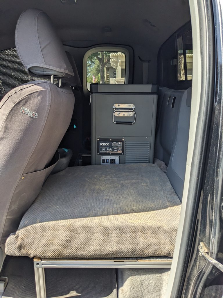

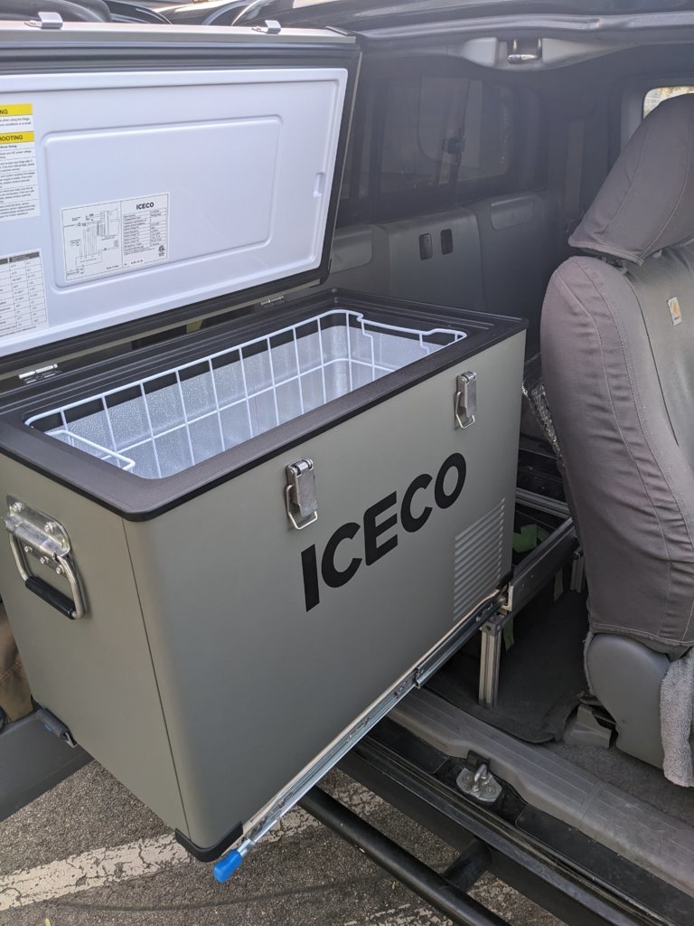

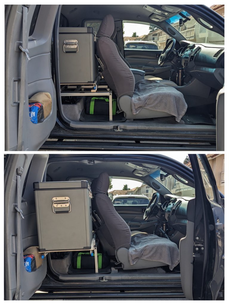

    My setup. Simple but comfortable enough. Mostly me and my dog, sometimes the lady also comes along. Heading out for a 4-5 day camp trip next week up in the Sierras. Truck has 216k on it.
    Bed platform is primarily setup as a single, and is half width of overall truck bed. I have some extensions I made clipped in so I can run my bigger (wider) sleeping pad. I had the pad so figured I'd accommodate it as well for when my lady comes along for the journey.
    Just picked up the fridge on a labor day sale and got it setup behind passenger seat. I have it on a cross slide, so I can push it fully to rear when it's stowed in truck. When you want to slide it out, you need to slide it forward a few inches on the cross slide first, then pull fridge out on drawer slides. This is to clear door frame, but maximize foot space for passenger when driving. I will probably add a secondary slideout off the fridge one that becomes a side table directly next to fridge. Fridge can still be opened from inside truck, just easier to access pulled out when at camp, track, grocery store, etc. Trial run on this fridge setup this weekend. Mostly made from scrap material I had (fridge is new). Rear sleeping setup is not new and has a lot of use.

    Thanks dude! It was actually a somewhat easy evolution as I already had the platform built as a dog platform (pulled access cab seats a long while ago).
    Rummaged through some parts at work, milled and drilled some shit, and we have what you see above.

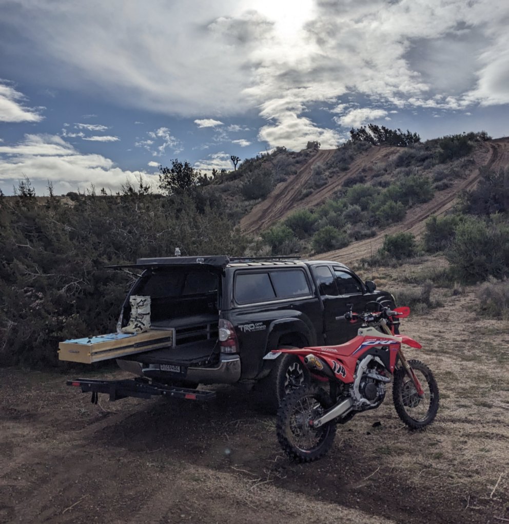

    Well I think I'm going down the slippery slope of designing/building my own. I am working on a concept now. Goal is a really lightweight but simple setup for camp/mtb/moto.
    I'm really happy with my current setup, and bed/platform. I just wish I had a tad more headroom when sitting upright on the bed/bench. Started pricing contractor shells and the slippery slope began...I figured I can design/build a better and lighter/more durable version for less cost (material cost, I'm not counting my time for design/build). Overhead area is good for softgood storage (pillows, sleeping bags/blankets, gear, etc). I don't want a pop top and a tent. If I can change easily inside, I'm good. I don't need to be able to stand up. I want to add power and a fan, potential ac unit. Try and manage inside temp somewhat so I have a good spot to stash the dog on trips if I'm riding and he needs to sit the ride out. The van is great for that, but a van is always limited in where it can get you.
    Current setup has my frame weight at under 40lbs. Panels will be 18mm foam laminate with fiberglass outer skin. These will be really lightweight, provide good insulation, and provided good structure once bonded to the frame skeleton.
    Pictures of progress shown. The cutouts on sides will flip up with gas struts. On those flip up panels I will put sliding windows. Sliding window on front wall, and I haven't picked a rear window yet. Then I'll sort hinges, gaskets, trim. Once I'm happy with that, I will send out drawings to quote getting the skins cut/shipped. I can cut/bend all the frame stuff myself at work. I'll keep you all posted as I think others may have interest in something like this if total build weight proves to work out to what I'm projecting.
    Once I'm happy with my construction approach I will probably build something off a flatbed down the line. Dreaming...
