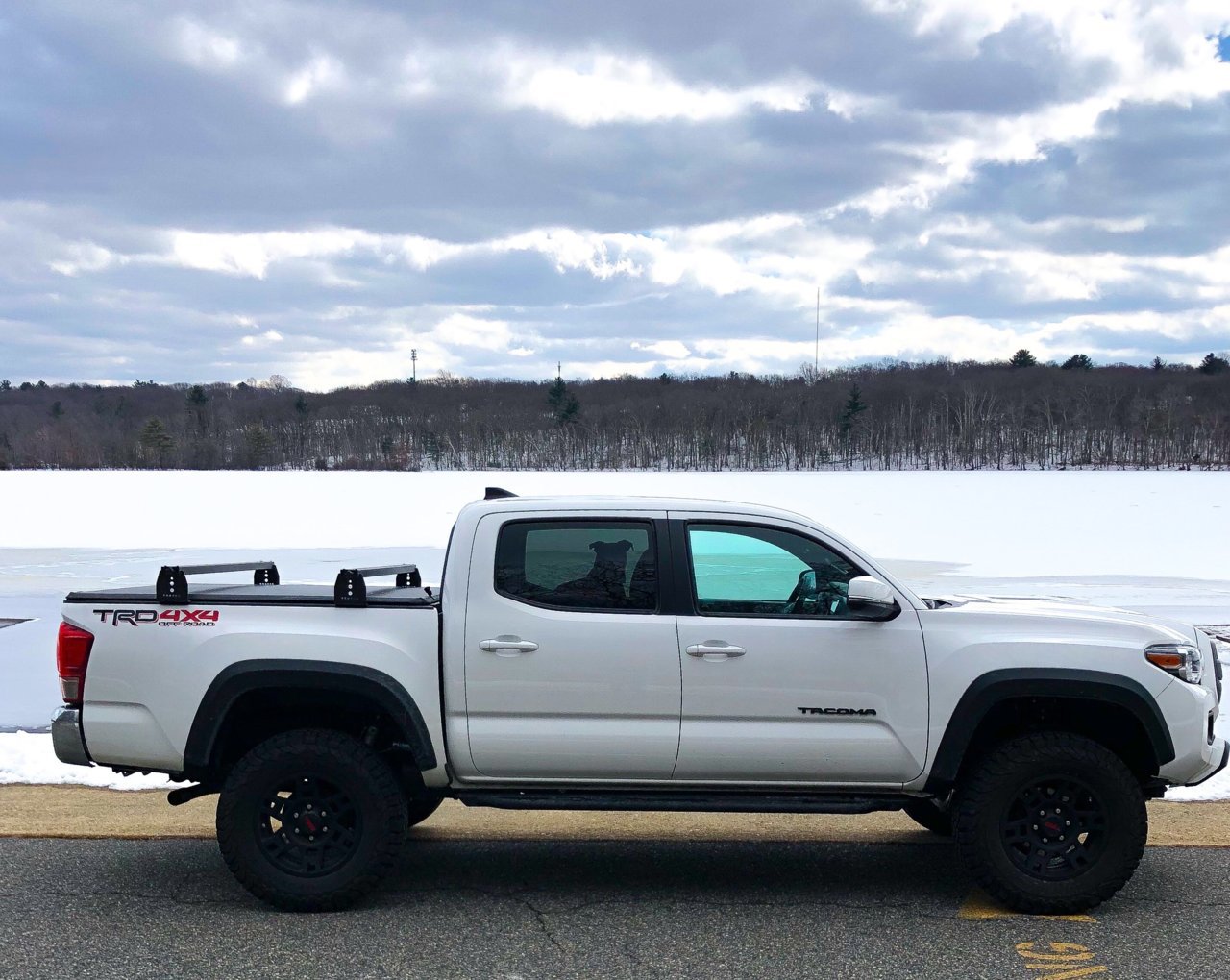

    Put on some new wheels and tires a few months back and went from the stock OR size (265/70/16) to a 275/70/17. Just dawned on me I should probably get a new spare as well. Found the right tire I'll use, but now I'm debating if I buy a fifth wheel to match or go with a cheap steel rim? What does everyone do when they upgrade their tires and how do you have them mounted?

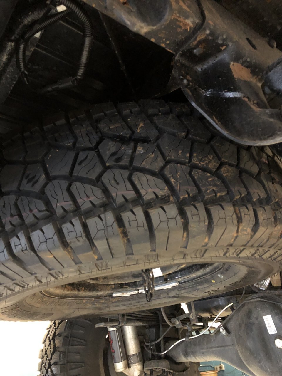

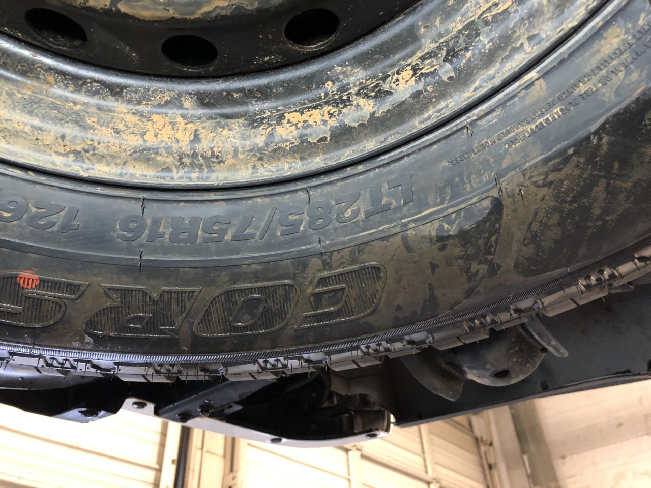

    I run a matching size spare tire 285/75/16 on the factory steel wheel . it does fit under the truck but I had to bend the front stays.
    I also had to shift the exhaust/tail pipe a little to the right .
