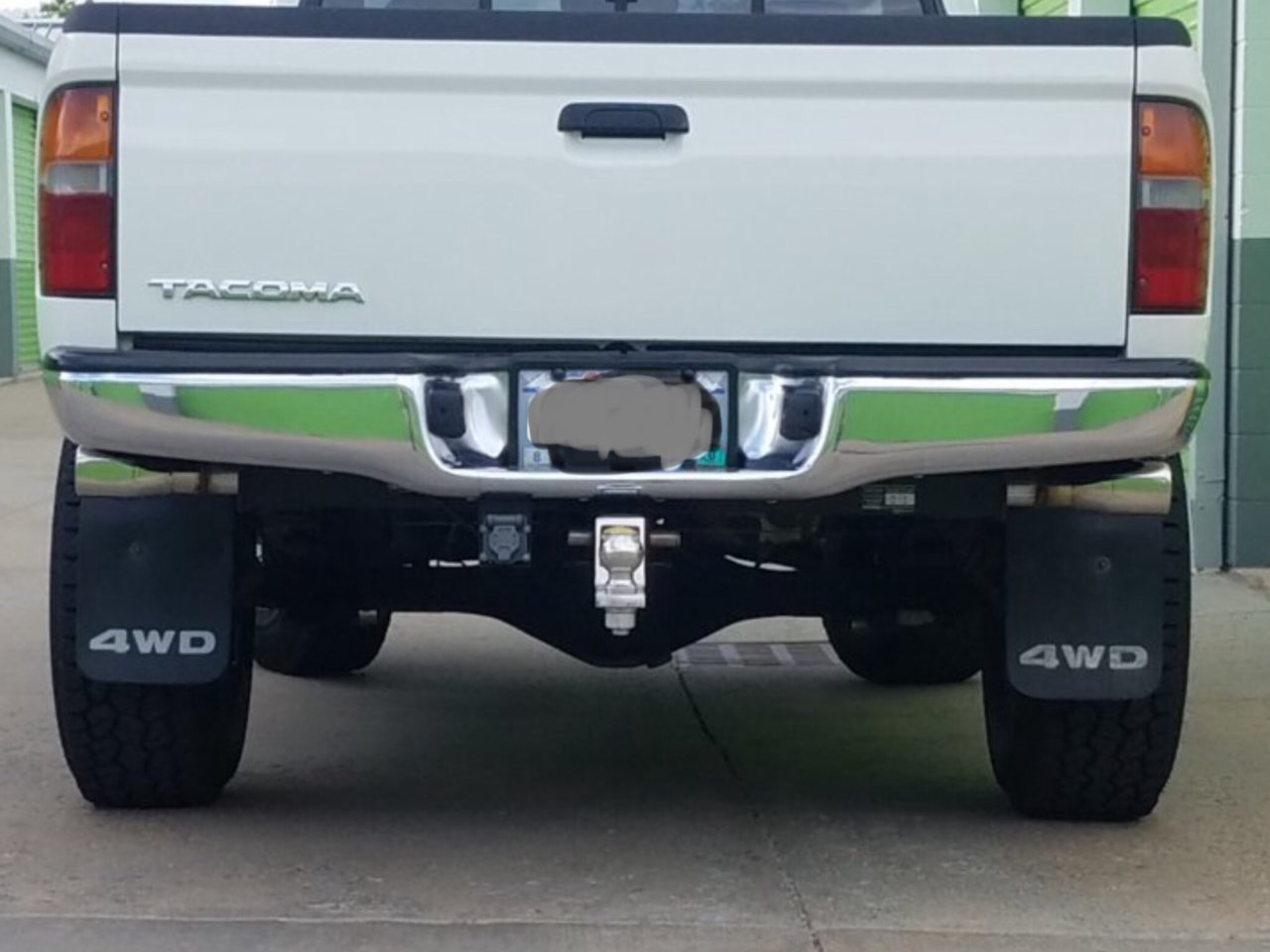

    Yes, that was my Dyno difference before and after.
    Doug Thorley,
    Then added dual exhaust from cat back 2.25” tubing per side which added a little more
