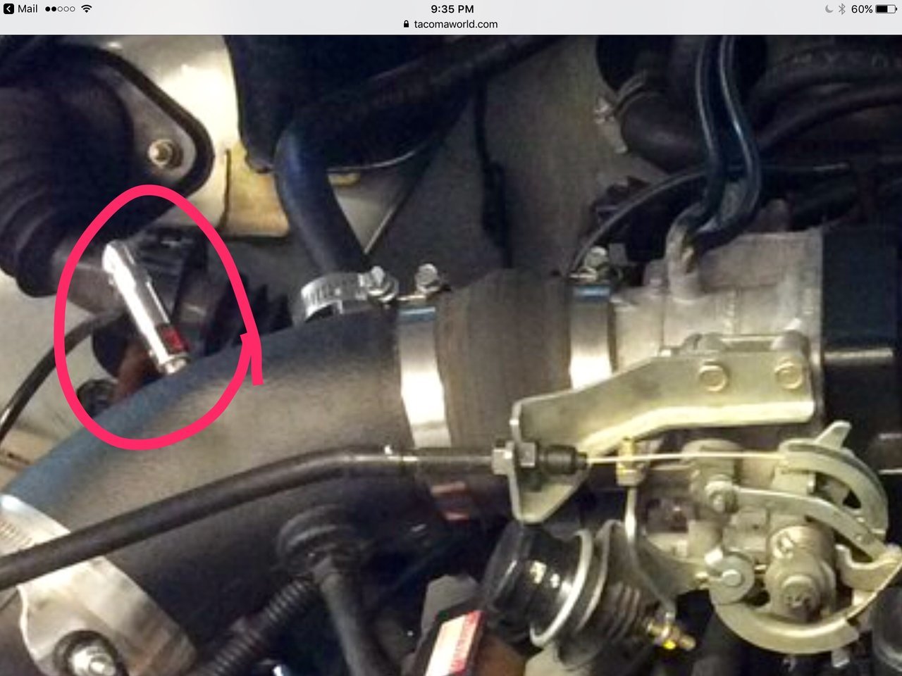

    hello, just a couple of questions, so im running my 98 3.4 all stock with a 2nd gen charger, dam thing gets really hot, so im going to throw in a stage 1 or 2 snow performance
    so installing, i just tap into the intake tube? it doesnt squirt right into the throttle body?

    V6 5sp,RegCab,TVS1320 Supercharger, 56mm pulley, methanol injected Haltech ECU, AC Tvs1320 supercharger,(MUST DO) every 125,000- 150,000 needs rebuild Projector headlights HID 5 speed manual Amsoil for all drive train Smaller 56mm custom pulley, (MUST DO) 2004 DESNO fuel injectors, zero ping ping, 2004 side door mirrors Dick Cepek Rims, Michelin tires LTX, ATM Pathfinders Dynopro ATM ( that last 100,000 miles) Now running Dynopro ATM mud and snow tires KN cold air intake Cat back dual exhaust with ss exhaust tip, Raised exhaust tail pipe to 2" below body line Optima*dry cell battery,red top Alpine sirius radio, 200 watt amp, focal is165 split door pod speakers Focal door speakers Subwoffer behind seat Viper alarm, Electric Locks Dark tinted windows, bucket seats corbeau lg1 Tacoma Rubber floor mats TRD fender extenders, Bilstien shocks, King shocks JBA UCA trailer iv hitch, electric brake control, Drilled slotted brakes, High carbon steel (MUST DO) EBS green stuff 7000 series pads(MUST DO) TRD engine oil cap TRD stick shift, Marlin crawl shift kit. Rear sliding window 2002 4Runner functional hood scoop cut into Tacoma hood, 4Runner dual overhead map light Gentex Auto dim + Compass + Temp, garage,rearview mirror Snow Methonal kit stage 2 Custom 3 core aluminum radiator Linex bed liner Haltech stand alone ECU, Intake supercharger gauge. Stainless steel brake lines, Custom leather wrapped steering wheel, Haltech stand-alone ECU,
    Hello, all you need is the progressive snow kit 495.00, you can look at my photos to where my pump and nozzle is installed in my build photos, I used the windshield tank for the boost juice, you tap into the Intake tube. You probably will use the smallest spray nozzle and will have to setup the start spray
    around 4-5 pounds of boost on the adjustable controller, you should use a AIR FUEL GUAGE to
    setup the system to make sure your tuning it correctly. Boost juice is 49 percent methanol.
    91 octane is fine, the methonal kit if you use the boost juice will raise octane to 110-115 octane.
    Also installed a low fluid level guage and a light that shows when the system is spraying

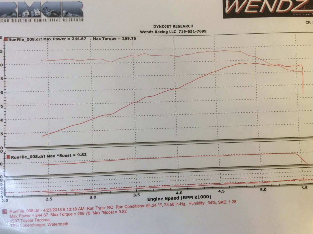

    This is about what u can expect at with the system 6000 feet with perfect AFR
    About 245 hp at rear wheel and 270 torque at rear wheel at only 2300 rpms(nice torque numbers at a low rpm)

    Do you know how much HP you gained just from the meth kit by itself?

    I don't really know but I do know is I can run a 2 inch pulley with perfect AFR and before I was not able to even consider it so that added a boost and a half which would probably be 20 hp I'm guessing
