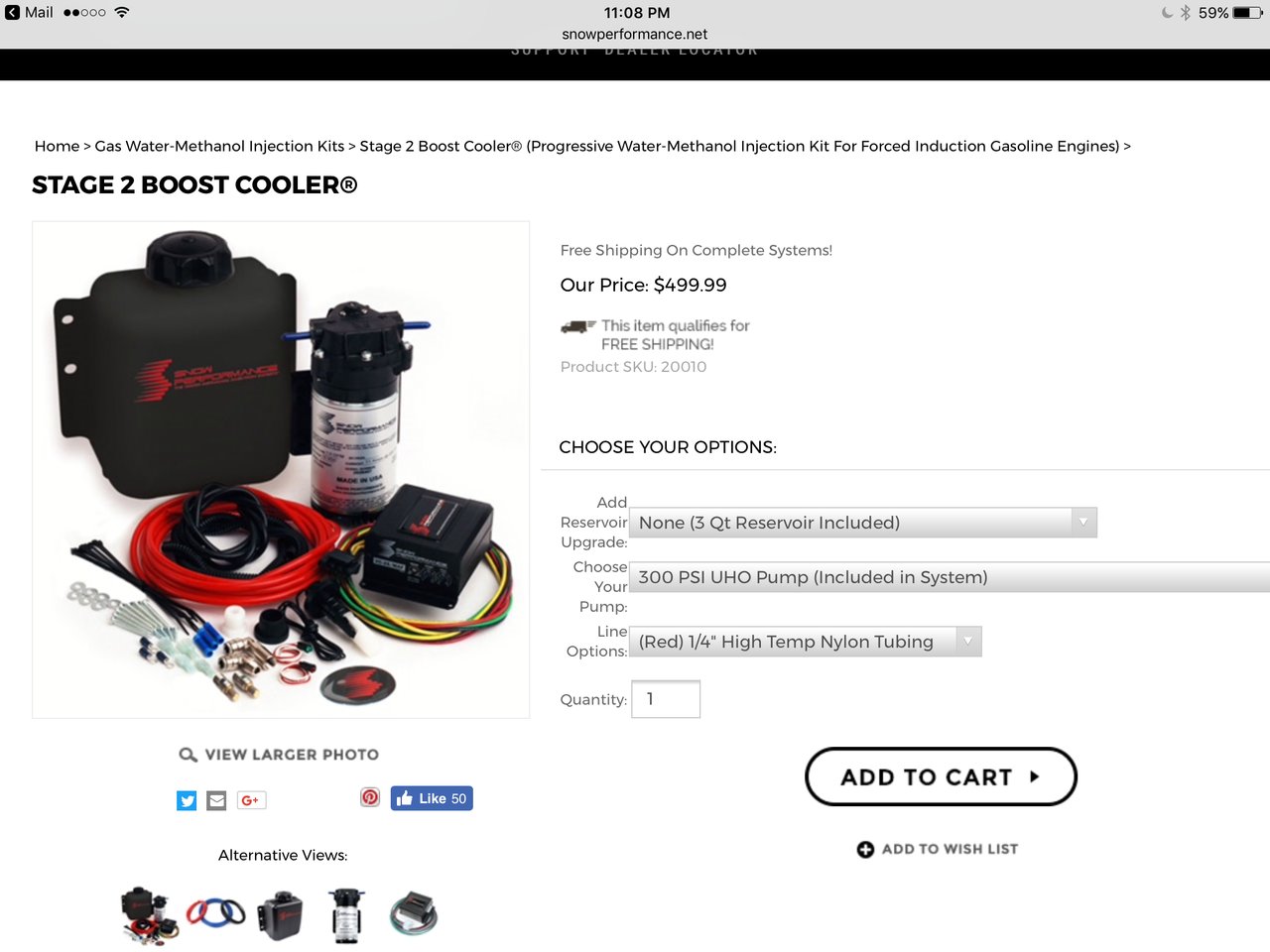

    As long as you get a progressive unit you will be just fine,
    Stage 2 progressive snow kit is what I have.

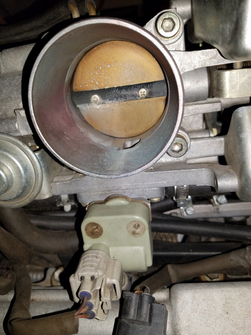

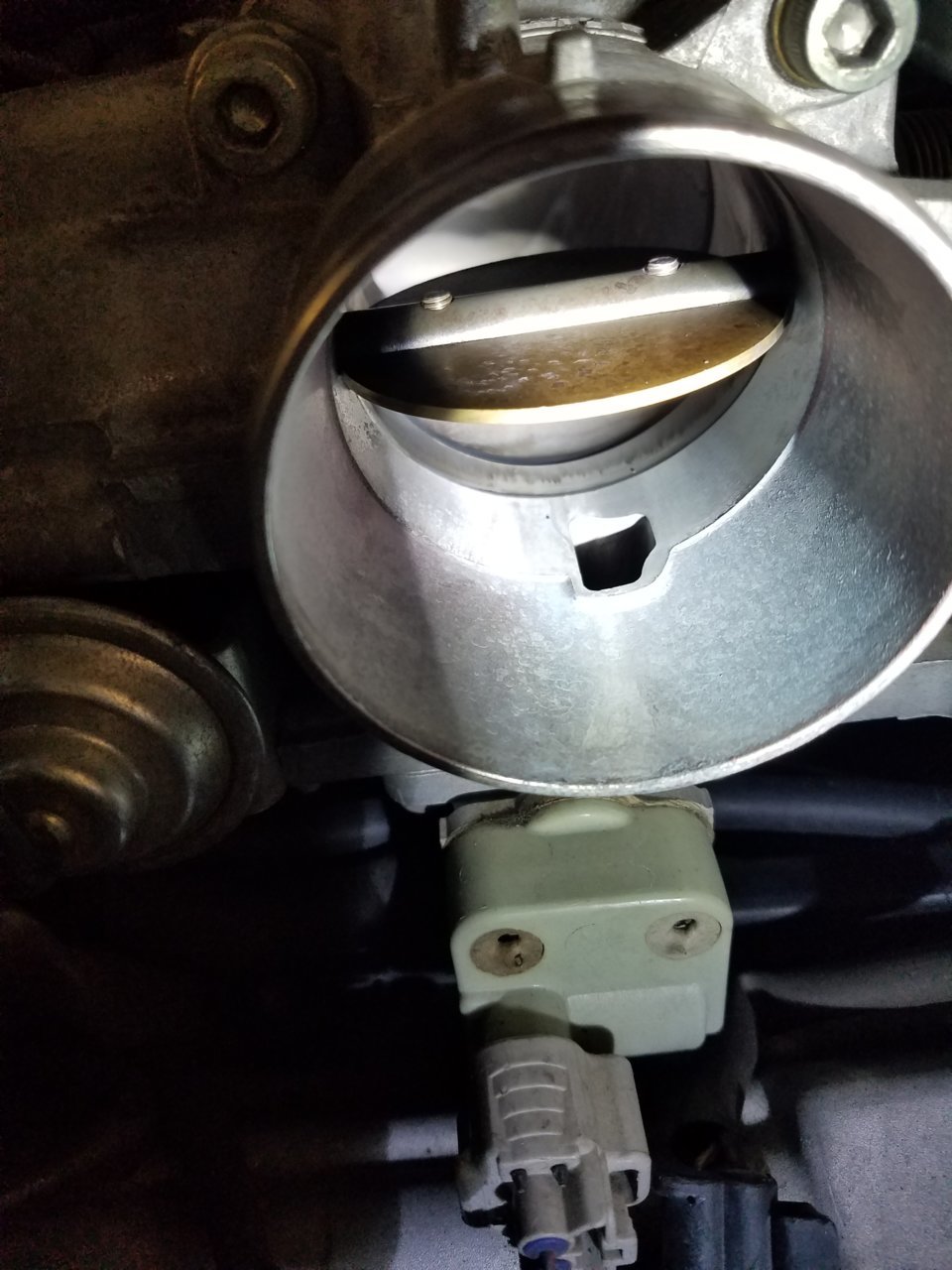

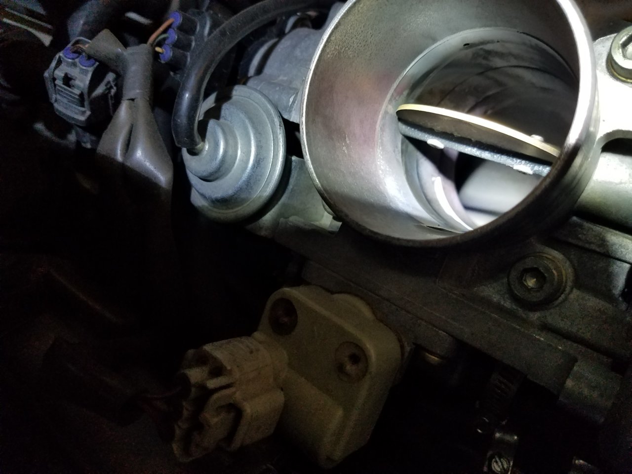

    V6 5sp,RegCab,TVS1320 Supercharger, 56mm pulley, methanol injected Haltech ECU, AC Tvs1320 supercharger,(MUST DO) every 125,000- 150,000 needs rebuild Projector headlights HID 5 speed manual Amsoil for all drive train Smaller 56mm custom pulley, (MUST DO) 2004 DESNO fuel injectors, zero ping ping, 2004 side door mirrors Dick Cepek Rims, Michelin tires LTX, ATM Pathfinders Dynopro ATM ( that last 100,000 miles) Now running Dynopro ATM mud and snow tires KN cold air intake Cat back dual exhaust with ss exhaust tip, Raised exhaust tail pipe to 2" below body line Optima*dry cell battery,red top Alpine sirius radio, 200 watt amp, focal is165 split door pod speakers Focal door speakers Subwoffer behind seat Viper alarm, Electric Locks Dark tinted windows, bucket seats corbeau lg1 Tacoma Rubber floor mats TRD fender extenders, Bilstien shocks, King shocks JBA UCA trailer iv hitch, electric brake control, Drilled slotted brakes, High carbon steel (MUST DO) EBS green stuff 7000 series pads(MUST DO) TRD engine oil cap TRD stick shift, Marlin crawl shift kit. Rear sliding window 2002 4Runner functional hood scoop cut into Tacoma hood, 4Runner dual overhead map light Gentex Auto dim + Compass + Temp, garage,rearview mirror Snow Methonal kit stage 2 Custom 3 core aluminum radiator Linex bed liner Haltech stand alone ECU, Intake supercharger gauge. Stainless steel brake lines, Custom leather wrapped steering wheel, Haltech stand-alone ECU,
    Decided to clean my throttle body since it’s been 100,000 since my last cleaning.
    Well guess what, the added benefit of a methonal kit is the methonal keeps your throttle body spic and span with zero carbon or gunk,
    NO more throttle body cleaning for me anymore
    One more positive benefit from this kit, wish I could see how clean the valve are now.
    here is a photo of my throttle body and was cleaned last over 100,000 miles ago.

    The methanol spray by its self WILL keep the throttle body totally clean

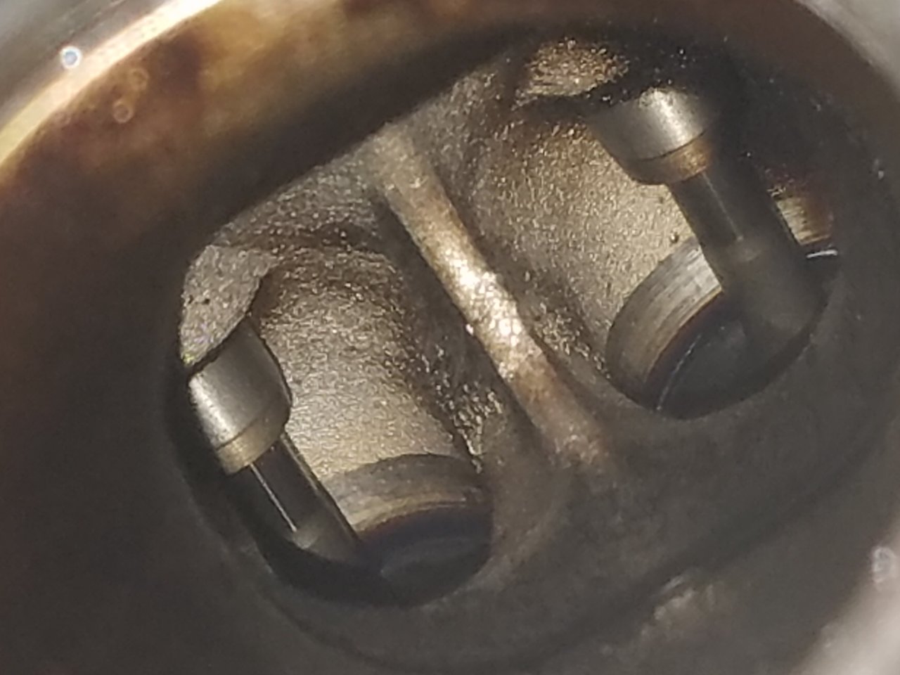

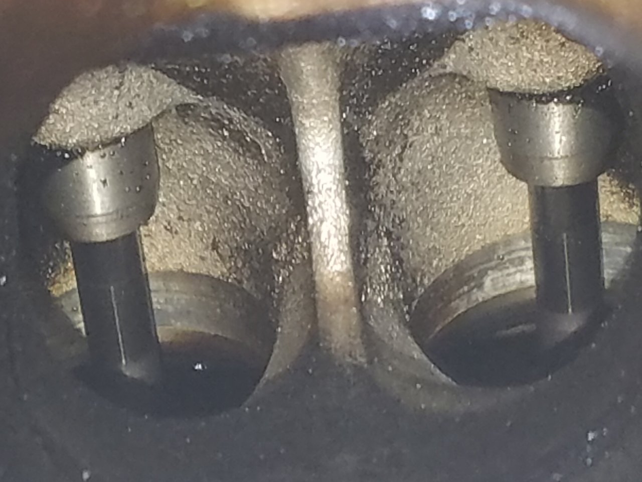

    Got to love the methonal advantages,
    Beside removing all the carbon from the throttle body it also cleans the valves from all carbon too.
    Had the supercharger off for some work to it and all the valves are super clean of any carbon.

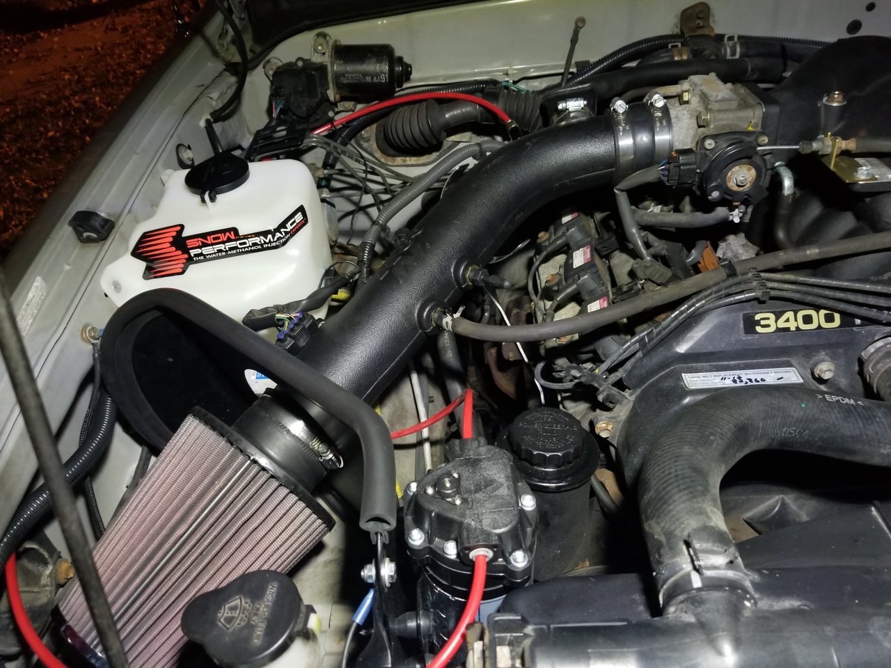

    Added the methanol kit following @1997tacomav6 build. So far so good. Running #1 nozzle. Still get slight ping. Will exchange it for the #2 nozzle and run it like this for some time.
    Dalandser, Brice, cruiserguy and 2 others like this.

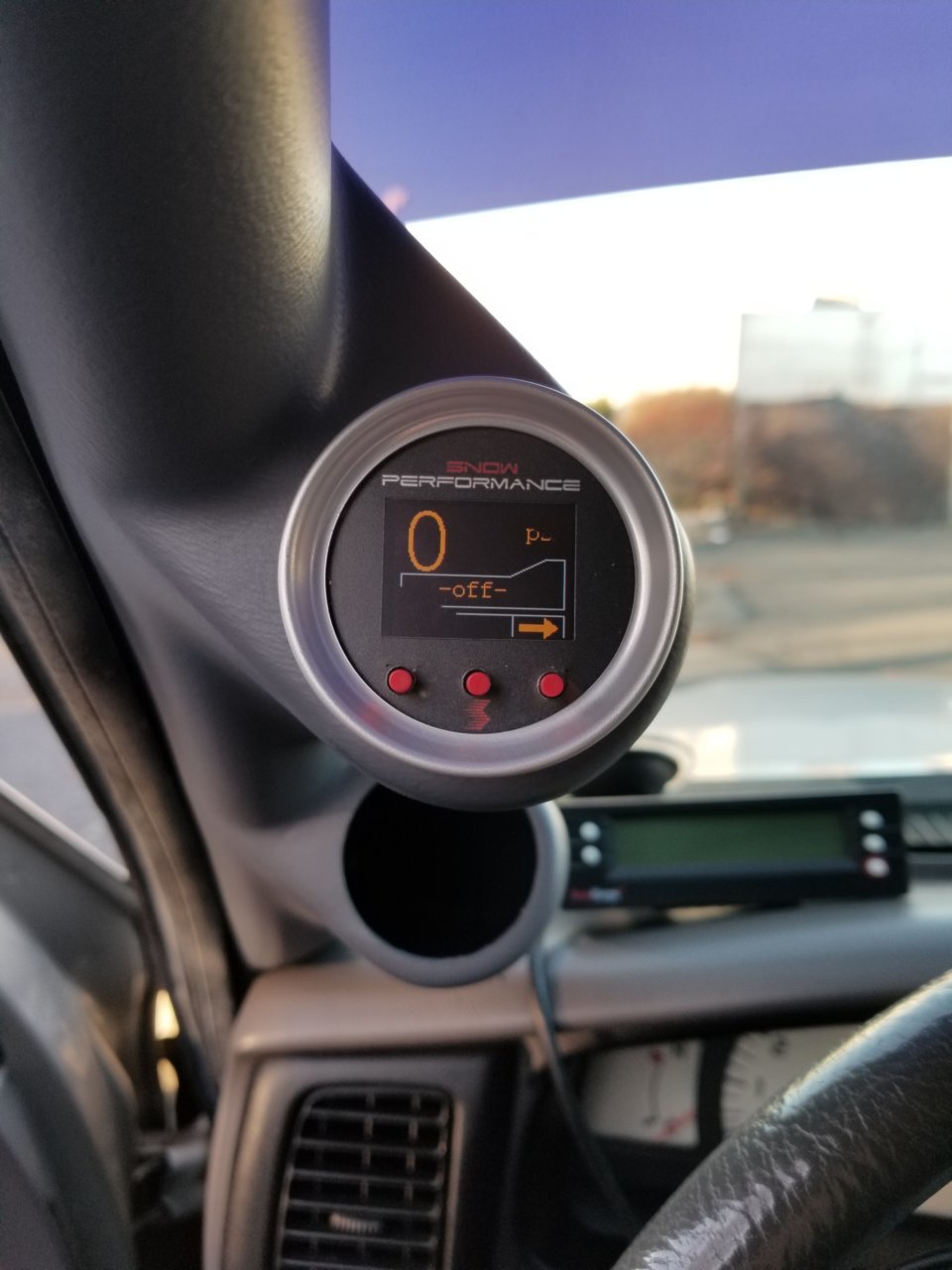

    What AFR GUAGE did you install.
    I have to get one sooner than later,
    I just am not hip on having two gauges on my side post.
    But might have too.
    Ideally I wanted a single guage with the combo setup with a mechanical boost needle and digital AFR output, BUT could not find one
    Grund72 and 04yota[QUOTED] like this.
  14. Nov 18, 2018 at 6:25 PM
    #54
    04yota
    04yota Well-Known Member
    Mar 12, 2014
    #125177
    1,220
    Angelo
    Central New Jersey
    04 ext cab supercharged 5speed
    I bought the aem gauge. I also did not wanted to get more than 1 pod on the pillar, but had no choice. This is also one of the reasons why I went with the controller for the meth kit. I'll only have 2 gauges plus the scangauge
    1997tacomav6[QUOTED] likes this.

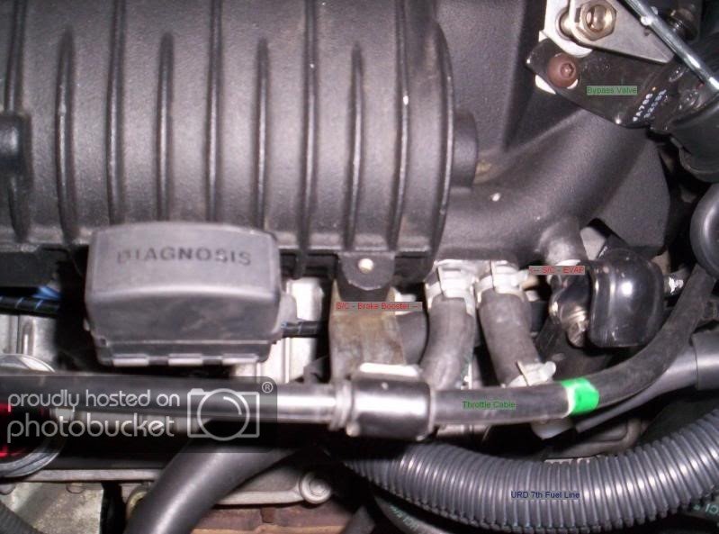

    All u Sc charged 5VZ guys can chime in with some advice. Been hitting a few threads lookin for advice and am moving forward with more ideas to resolve issues... right now I'm about to go meth/water with some other changes. Need advice: I've got the 2003 SC Tacoma I'm trying to to work out with a tune and get rid of the typical TRD SC BS on the 5VZ 3.4. You all seem to have your heads head wrapped around all this SC/5VZ stuff and need some quick thumbs up or thumbs down advice. Got the Supra 318cc injectors, x2 colder plugs, cooler thermostat, JBA headers, new AEM AFR gauge installed (Sunday) and URD FTC1-017D piggyback in there for tuning (just started tuning). having some issues that need to go way. I'm learning alot about this all and now about about meth/water injection. Even though I have the larger injectors, I'm just about to pull the trigger and get the Devils Own 2 bar kit and install that along with a new 2.2" URD pulley sitting here on my desk at the moment for the SC... and then try to tune everything with the FTC1 to make it work. Should give me a little more boost with the pulley and meth without going crazy... should fix any AFR issues by using the FTC1... should be able to balance the added fuel from the 318cc injectors along with M/W with the FTC1... yes? I'm pretty new at this but learning a lot lately. I'm on the right track here?
