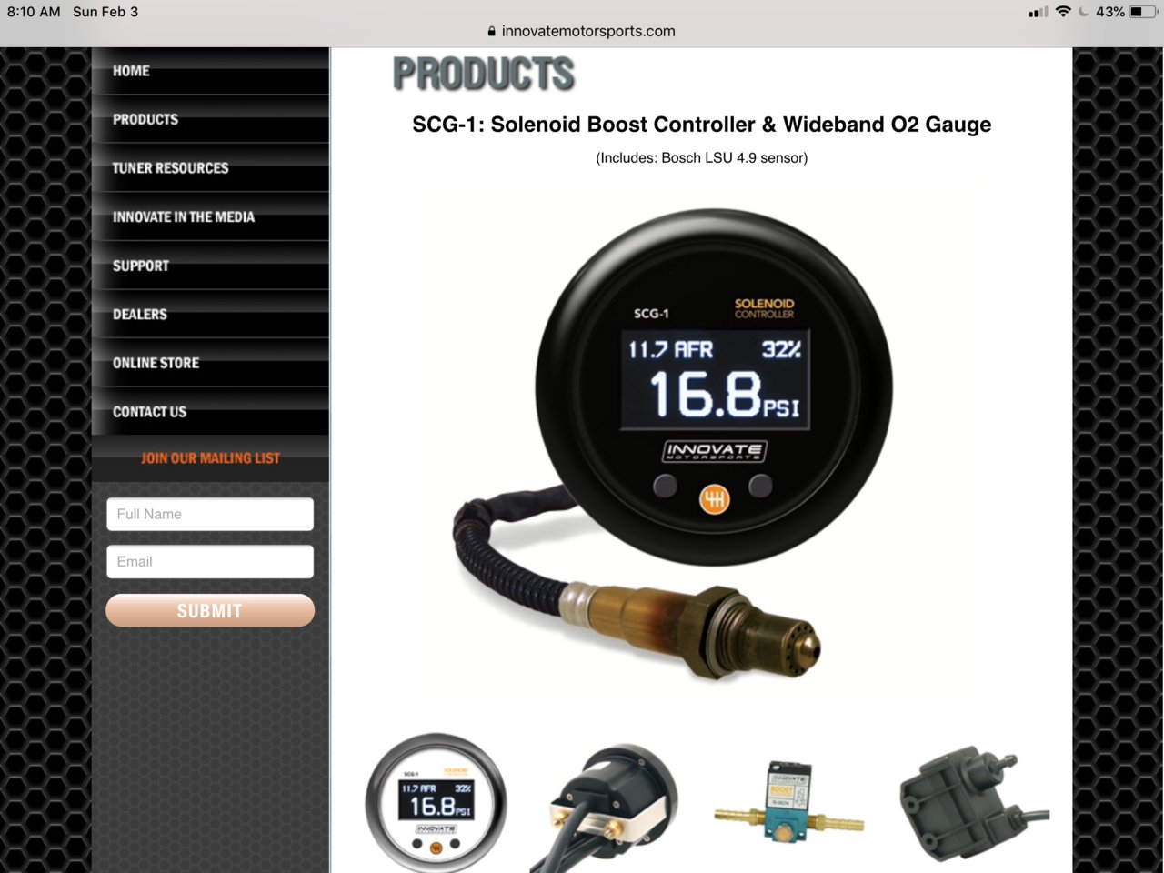

    Failsafe AFR / BOOST gauge arrived. Buying it was the easy part.
    Now to get it installed.
    I’m pretty excited about this failsafe function on this guage with the methonal kit
    because if the methonal nozzle is clogged or ran empty or the pump not putting out
    enough pressure or some other issue the gauge will actually cut the boost from the supercharger so
    your engine will never be in danger of running lean or to rich. This type failsafe guage is probably
    a must have if running a methonal kit for engine protection.

    Looks like something I can wire into my s/c bypass setup to turn the boost "off". I've had vacuum leaks or the vacuum reservoir is not sufficient as my manually switched bypass starts to loose vacuum fairly quickly... Or maybe it's the orientation of my solenoid's ports (resistance to flow).
    How does that kit sense water flow?
