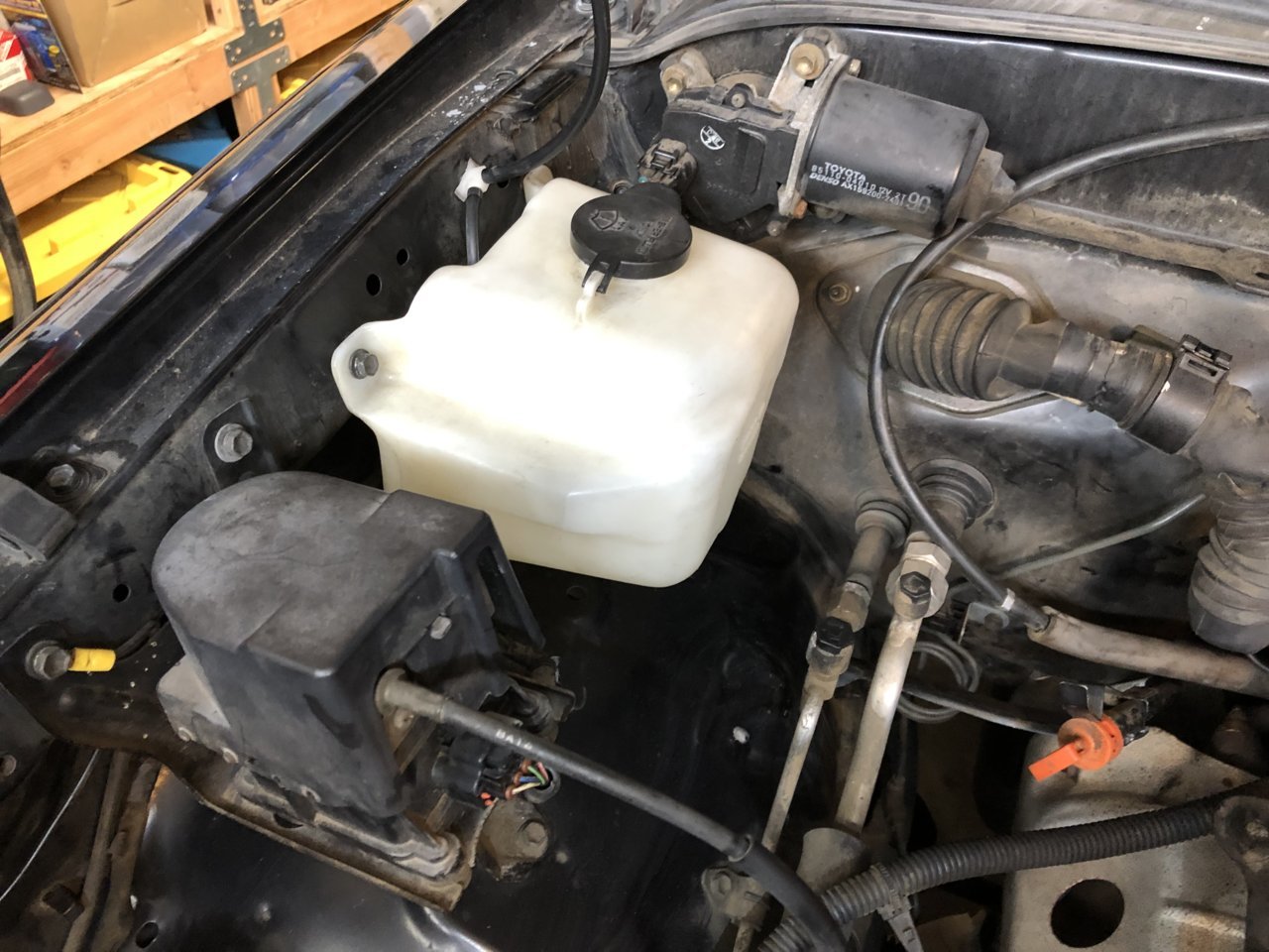

    I’m using that tank for my meth injection. But I’m using it farther back because I have cruise control in the stock spot.
    I drilled out the bung for the temperature sensor from the AEM reservoir, and I replaced the pump hole with a fitting that accepts the stock quick connect from the AEM unit.

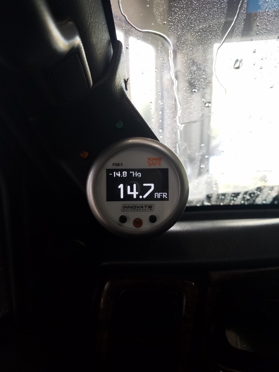

    Finally got my Innovate SCG-1 Gauge installed.
    This is the coolest gauge!!!!
    First of all it’s actually a boost gauge and an AFR Gauge in one, so one pillar pod is all you need.
    This gauge has the option to set as a boost gauge only or an AFR Gauge only.
    You also have the option of have both gauges showing at the same time with the larger display as your choice of being the AFR or the boost.
    You can toggle either gauge at any time to have either boost or AFR as your leading gauge.
    It also shows the vacuum as part of the boost gauge.
    It also has a button setting that shows the top boost pressure you have run. This clears each time
    you turn the motor off.
    It also has a warning display that says “02 CUT”
    This display pops up on the top right corner whenever the AFR is out of its safe zone running lean.
    The gauge also let’s you set the AFR warnings limits.
    So let’s say you set the warning “02 cut” at 13.5 and the AFR (under boost) goes over the lean number of 13.5 or higher it will give you the warning “02 CUT” display so you know something is wrong with your setup, (running lean)
    The gauge works fantastic!
    The failsafe will not actually cut the boost because our trucks are an older design, for a newer truck
    the gauge when it goes into the “02 CUT” (lean area) it would actually stop the boost from going higher.
    It also has a light is the guage that tells you when to shift, but that part was not connected.
    So now I will always know what’s going on with my AFR and boost at all times.
    GQ7227, Area51Runner and mechanicjon like this.

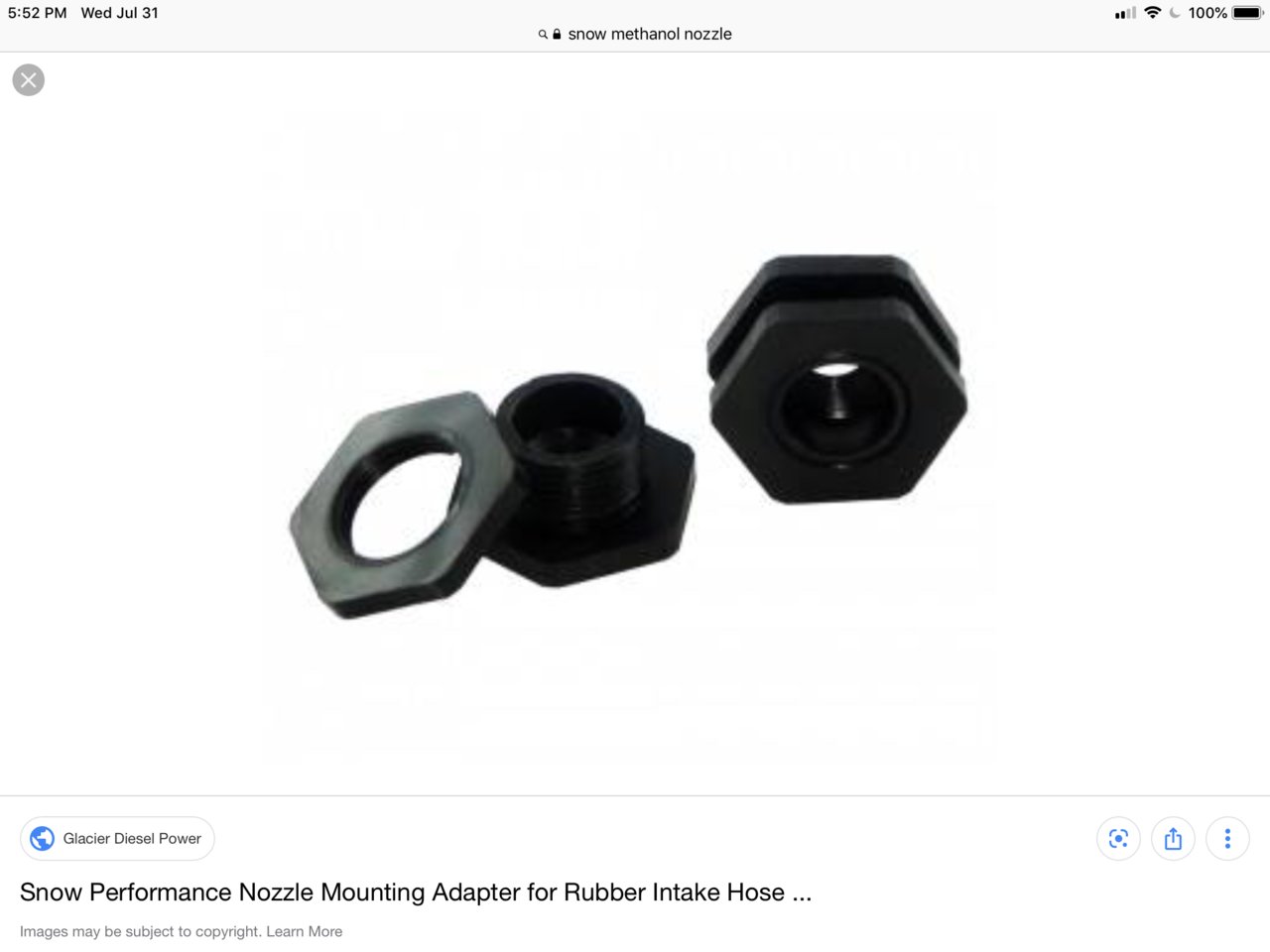

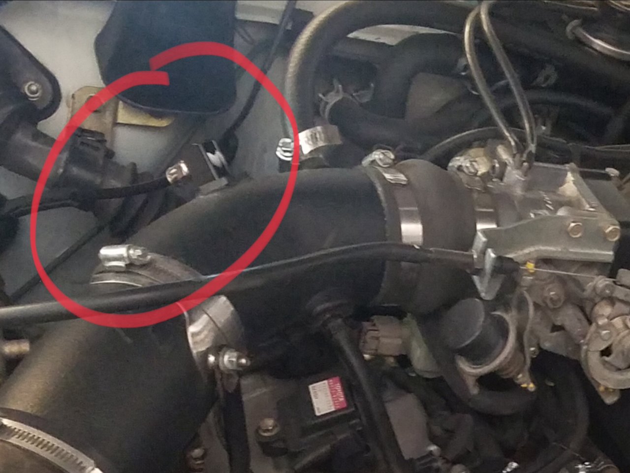

    I wouldn't put it at the 7th injector location, it sees vacuum and even with a devils own solenoid water/meth would get sucked out, slowly draining the tank out over time without boosting at all. I observed this when running a dual nozzle setup (one pre-TB, one at the 7th location solenoid activated at hight boost and rpm).
    I choose the OEM intake pipe underside about 7 inches upstream of the TB. There are kits that sandwich over the rubber/plastic OE pipes that have threading for the nozzles inside of them.
    I need to re-do me setup, I miss water/meth. Want a simple reliable kit, preferably single nozzle with good tunability (progressive with fuel injector pulse width feed to give the water meth pump a more 3d progressive tune).
    Oh also not happy having tapped the OEM tank, will be installing an aftermarket tank and have OEM just for the windshield wipers as intended. I guess hitting the trails showed me I want that tank good to go and with more regular/cheaper fluid.

    I used the washer tank, is cleaner setup,
    It depends on what nozzle you end up using if your running a 2” pulley or stock.
    A stock pulley will not need a lot of methonal, nozzle 2,
    A 2” pulley will need more nozzle 3 or 4 size
    A 2 nozzle depending if your driving it hard a windshield gallon can last 1000-1500 miles.
    A 3 or 4 nozzle can last 300-500 miles per gallon depending.
    I just use the windshield tank because it’s a clean install and easy.
