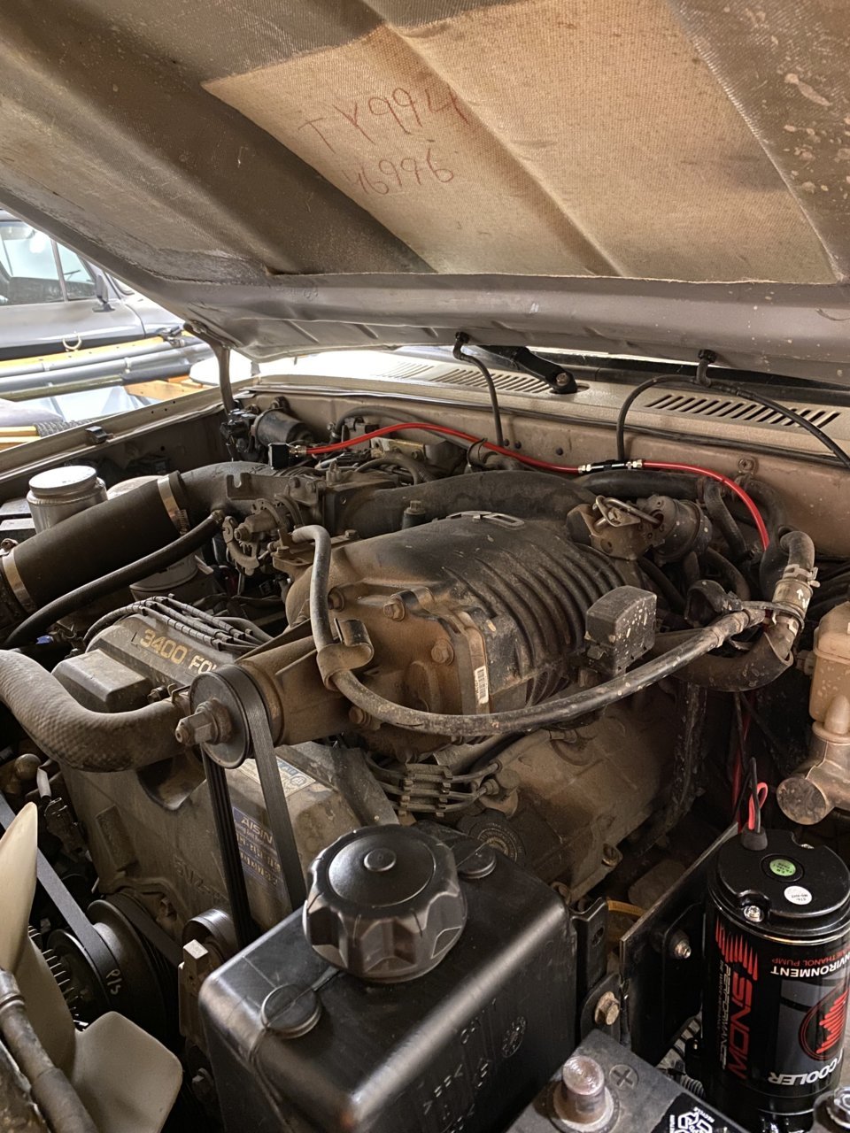

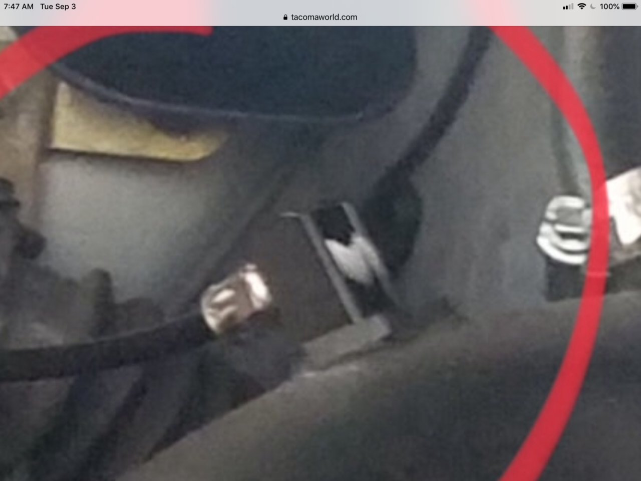

    Still working on this. The wiring has been a complete PITA. I had to run a 8ga wire to the bed because it’s so far from the battery. I learned that ring terminals and crimpers for 8 gauge wire is near impossible to find locally.
    1997tacomav6 likes this.

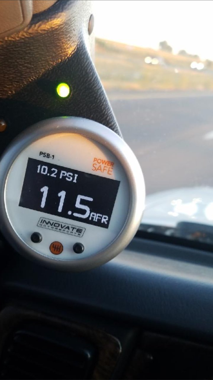

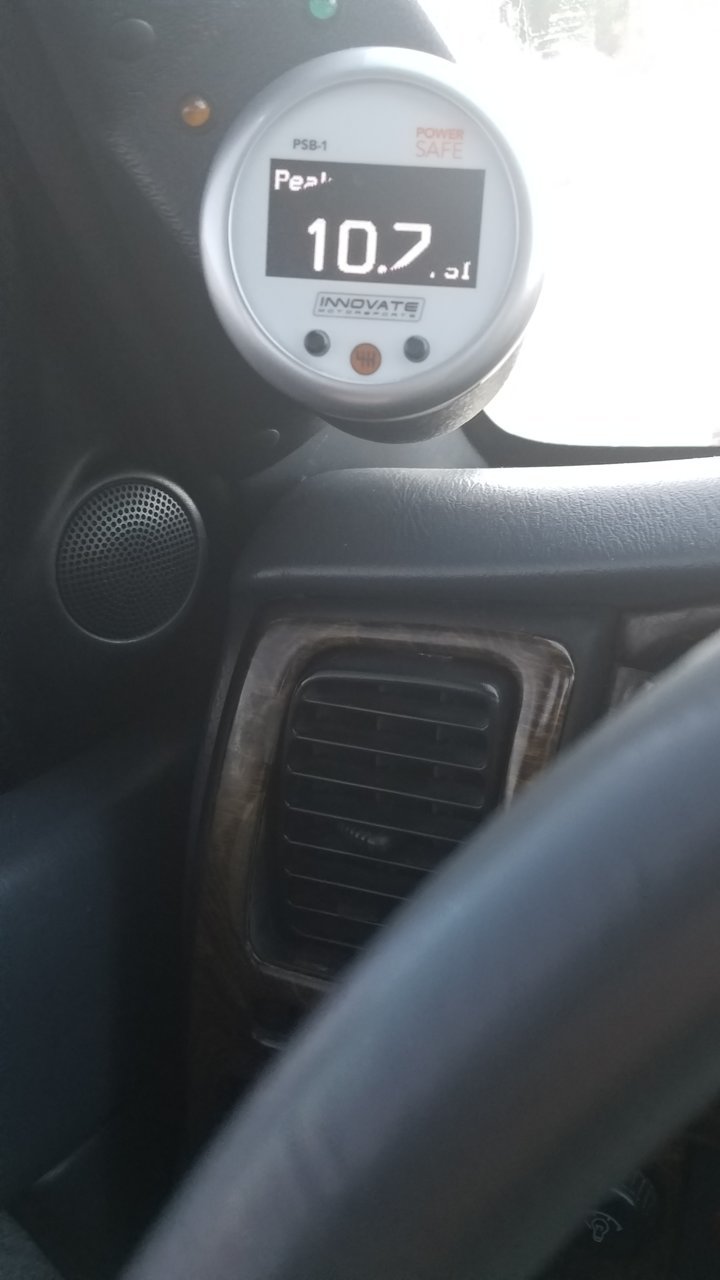

    Wanted to update my last 2.5 years and 65,000 some miles with this kit.
    The kit and system has worked perfectly.
    I’m running at 6000 feet and 10.7 peak pounds of boost.
    Essentially I have zero heat soak issues in the summer anymore.
    When the kit was installed the nozzle was a size #1 which is the smallest available
    and spray point was at 3.5+4 pounds up.
    The #1 nozzel does get plugged up because it’s so small.
    I decided to put the #2 nozzle in and it worked better.
    As the miles added up the AFR was getting leaner so I went up to another size 3 nozzel
    then a 4 nozzel and 5 nozzel over the next two years.
    Finally got to a point were I needed a 6 nozzel to keep the AFR perfect under full boost.
    So with the 6 nozzle my fuel trims were at 14 to 29, so that’s means there’s a problem.
    I replaced the fuel pump even tho it tested perfectly at idle at 43 pounds of pressure.
    Then I bought a new aftermarket MAF and installed these items.
    Truck ran better but still not correctly.
    I tried three different MAF with different fuel trim results and ended just buying a OEM MAF that gave me perfect trim numbers.
    THAT was the ticket with the new fuel pump.
    Now the truck is back to a number 2 nozzel and the spray point starts at 6-7 pounds instead of 3.5-4 pounds of boost.
    The health of your fuel pump and the OEM MAF are a critical part of this setup.
    Apparently both of these parts were not working at 100 percent.
    Truck is running at its peak again

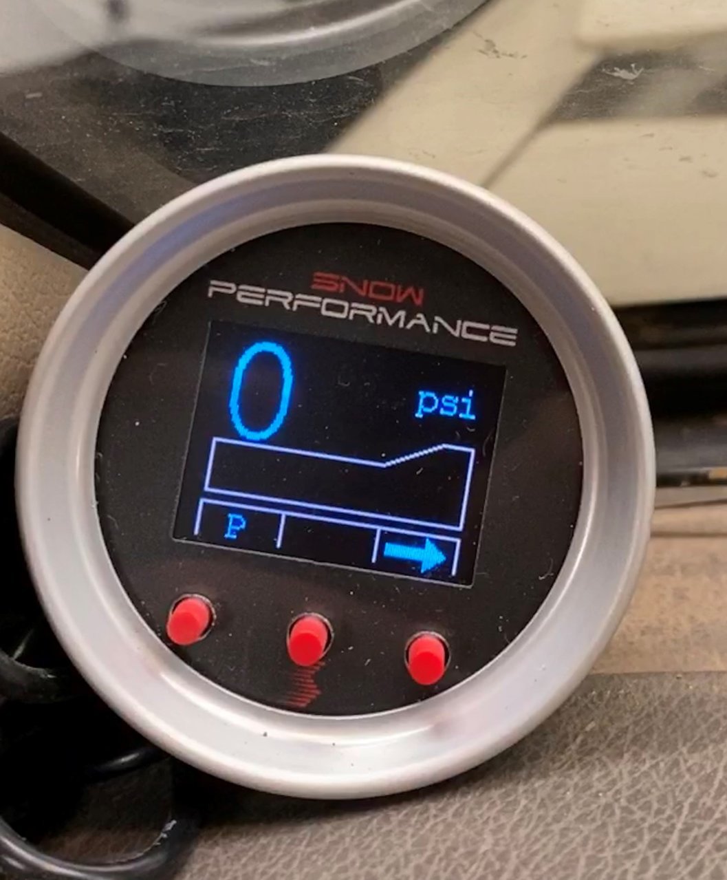

    Update on my end. I’m running a #1 Devils Own nozzle and using 25% meth to water starting at 3psi when the SplitSec enrichment kicks in. This cools to IATs and hopefully adds just enough fuel to keep STFT close to zero under part throttle boost.
    I have a progressive controller but don’t really use it. So I should be flowing roughly the same amount at any boost level. Since I can pull timing and add fuel via the 7th I only have the Devils Own kit to add cooling.

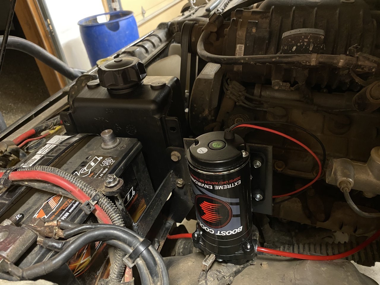

    Just finished my install of the Snow Performance kit on my crawler. My crawler has been having issues under load with what feels like a mis-fire. Only happens when the engine is warm. At first, I figured I had O2 sensor problems as the CAT was gutted by the previous owner and was missing the pre-cat o2 sensor. I had the exhaust redone and it made no difference in performance but I got rid of all my CEL's. After browsing this thread I bit on the Meth injection idea. Will post results later after I take the Crawler out this weekend.

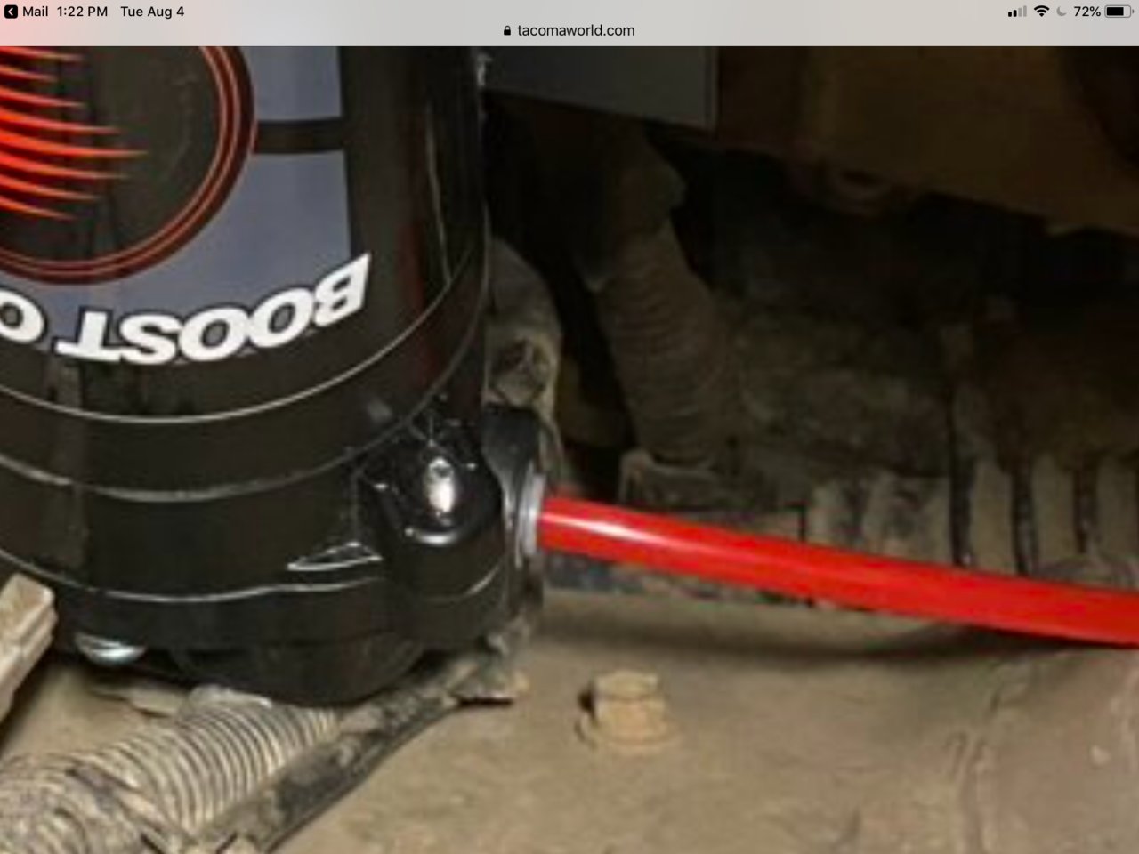

    Just curious, how do the red lines attach and come apart from the pump.
    My line look the same and I wanted to change them out but could not figure out how they come apart from the pump, the nozzle is a quick disconnect and is different then the pump lines
  20. Aug 5, 2020 at 7:46 AM
    #120
    taco52
    taco52 Well-Known Member
    Apr 24, 2011
    #55481
    596
    01 SR5 v6 5speed 4x4
    They are push quick connect fittings. We used air lines fittings similar to this when i performed maintenance on the press machines at a laundromat. I believe if you push the fitting in. it will release the clamping action and you can carefully remove it. If thats not the case, i have no idea how to remove the lines. Might call Snow Performance.
