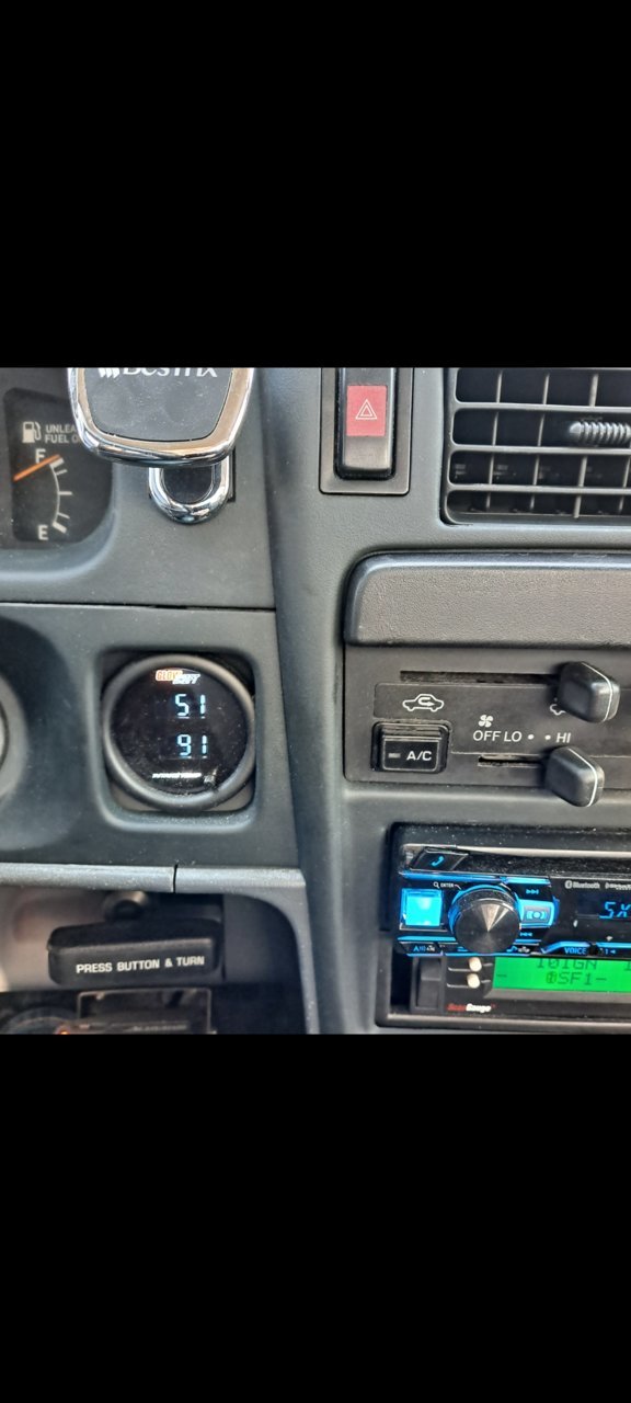

    You can install a dual temp sensor, one before the supercharger and one on the outlet side going into the intake to know your actual temps and see whats happening when your feeling like your power is down
    Here are my 2 temp readings, right before the supercharger throttle body and leaving the supercharger into the top intake
