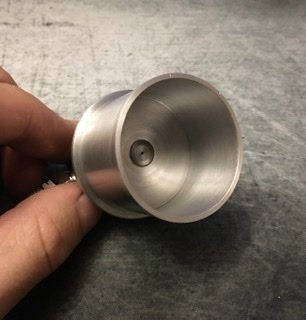

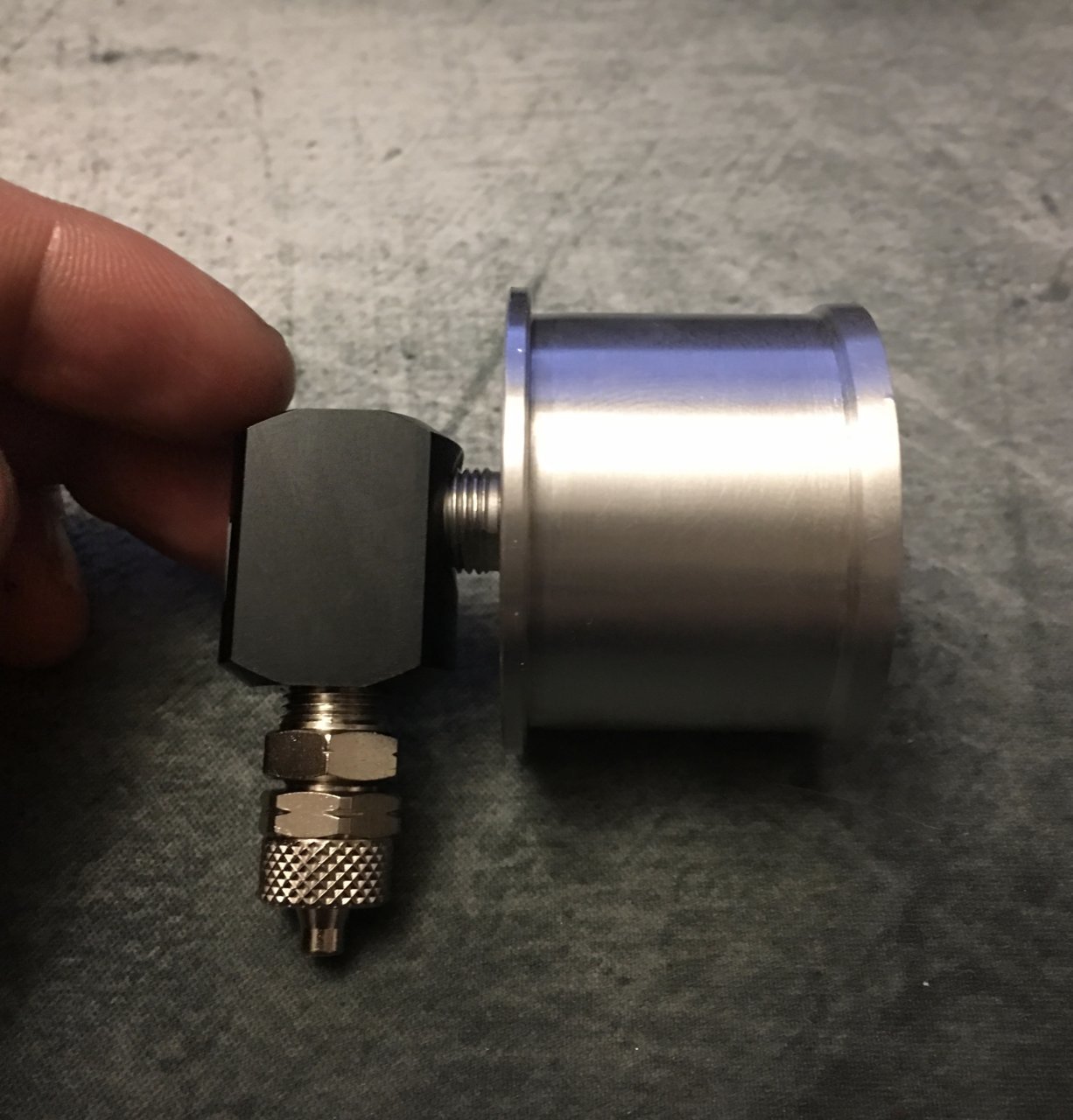

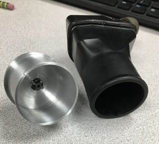

    Slow day at work today, so I made my nozzle adapter. Replaces this baffled connector for the valve cover vent return to the intake pipe.
    I wanted to counterbore the top but not much room with this low profile 90degree nozzle holder my kit came from. Might get it assembled in the truck this weekend and test it. Hopefully there isn't too much interference with the spray pattern

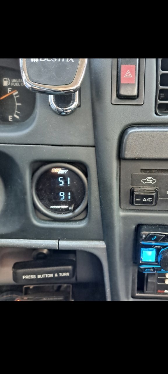

    It was pretty impressive to show Dave the output supercharger temps (I have a dual gauge installed for the input and output temperatures for the supercharger) coming out of the supercharger at 10 pounds
    of boost WOT with the methonal spraying and the temperatures only increased maybe 10 degrees.
    Normally if not methonal injectored this number would be an increase of at least 75-100 degrees.

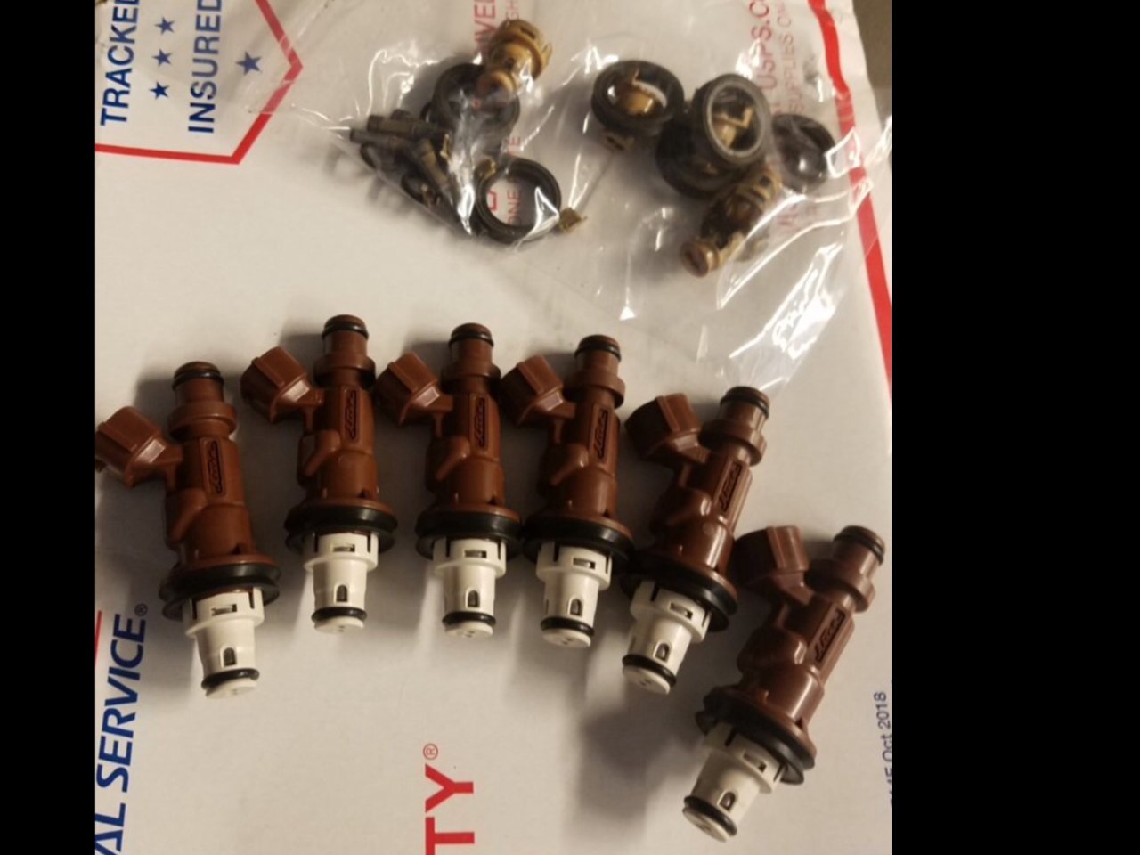

    Motor west in California was 125.00 and 3 day turnaround around, with new washers and seals, just a heads up.
    Old parts above

    My OCD made this take way too long. But the harness looks good. And I can confidently un-install this kit in under 1hour if needed.
    Snow ECM Location. I deleted my air bag years ago
    Pump Location passenger rear cubby
    tank is in the bed, and heres the nozzle setup. Im making a new adapter though. This one interferes with the spray pattern

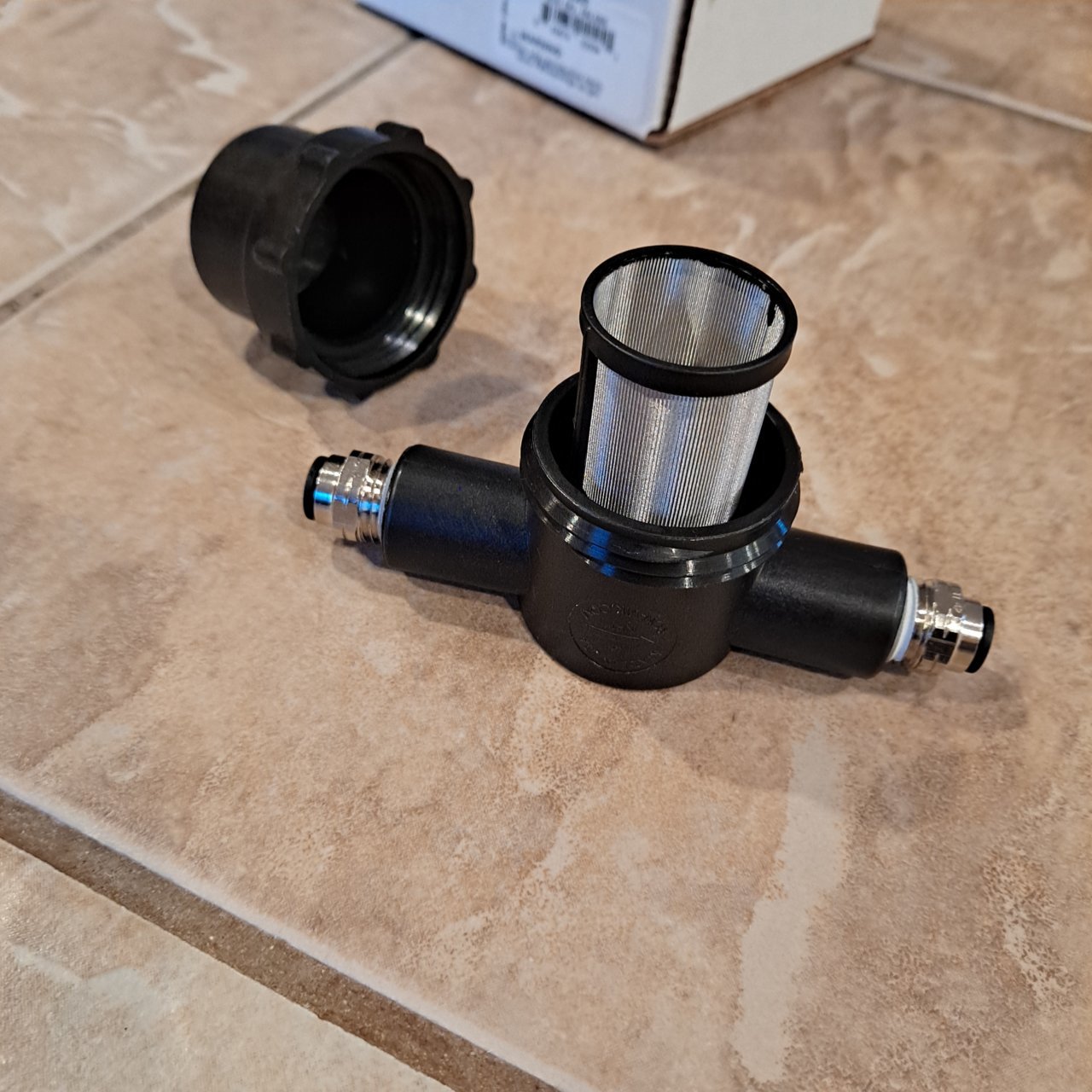

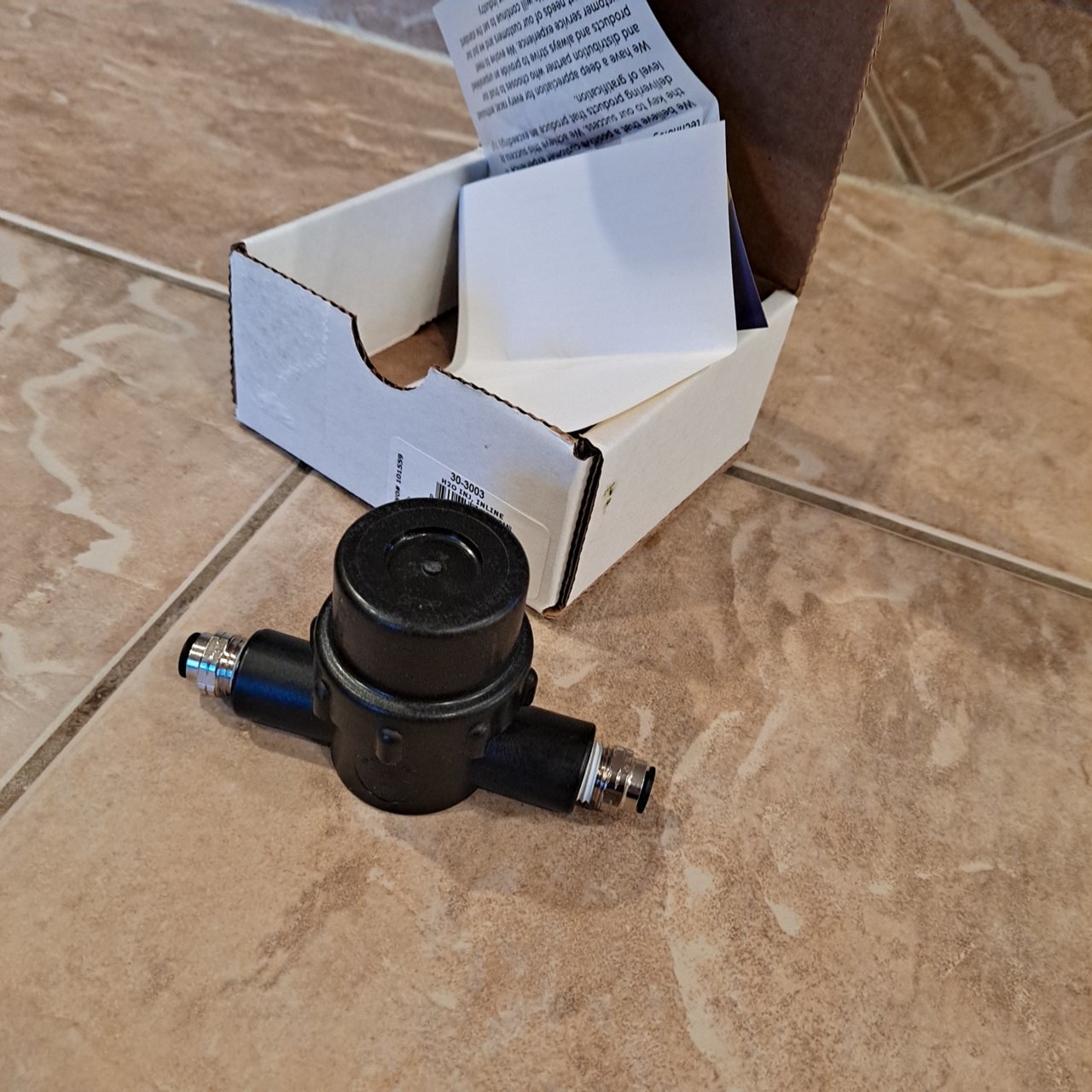

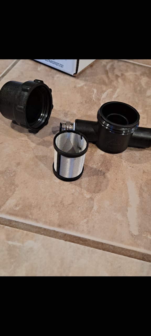

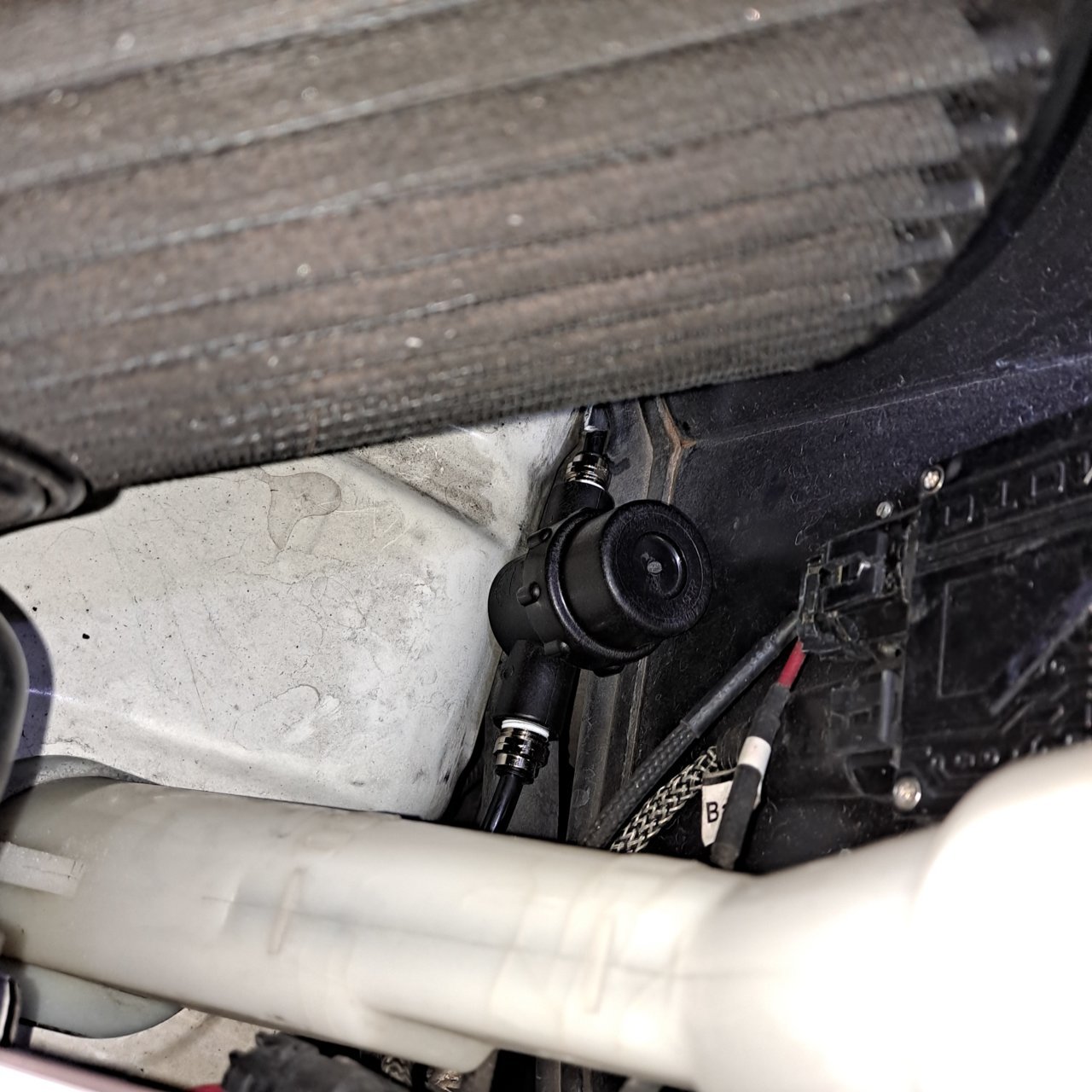

    Here is an inexpensive high volume inline filter you probably should consider for your methanol in-between the pump and tank
    Just installed it. 2 minutes to do.
    25.00 AEM METHONAL FILTER
    I've been having my nozzle and nozzle filter getting plugged up about every 25k.
    This should take care of that and looks super easy to clean
