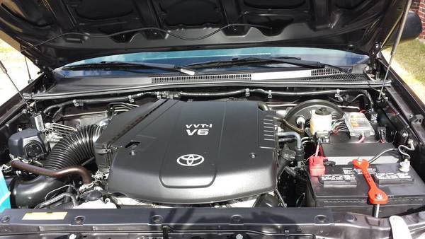

    Figure I show off my newly cleaned engine bay :D

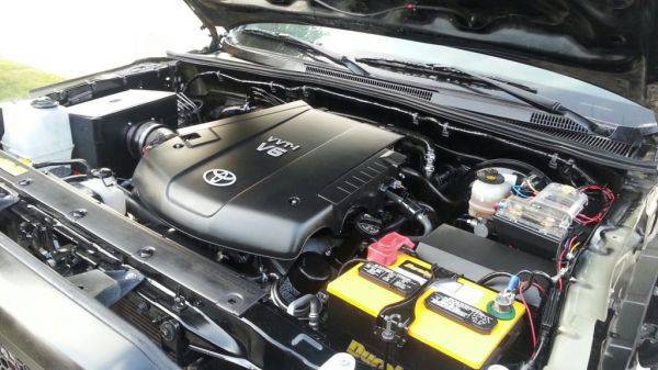

    Beautiful!

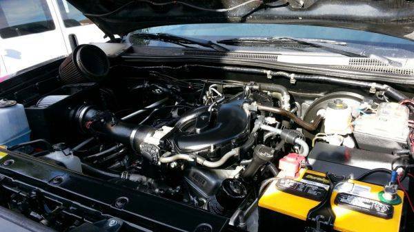

    What I do, I use regular water hose with a cheap garden water gun. The only think I cover is the alternator (I've done this without covering it). I rinse the whole engine bay (cold engine) to get the dust, dirt, etc., off.
    Then I spray it with the Gunk engine degreaser, let it sit for about 15 mins, then rise it all off really good.
    Finally after letting it air dry, I spray the CD2 engine detailer and after 20 min I run the engine for about 15 mins. The final result looks something like this:
    I just cleaned it yesterday. :cool:

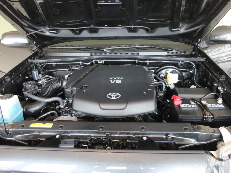

    at the dealer when I was taking her homeDSC00166_149a5cd1900415c390733570c0319c23dd12efa1.jpg
