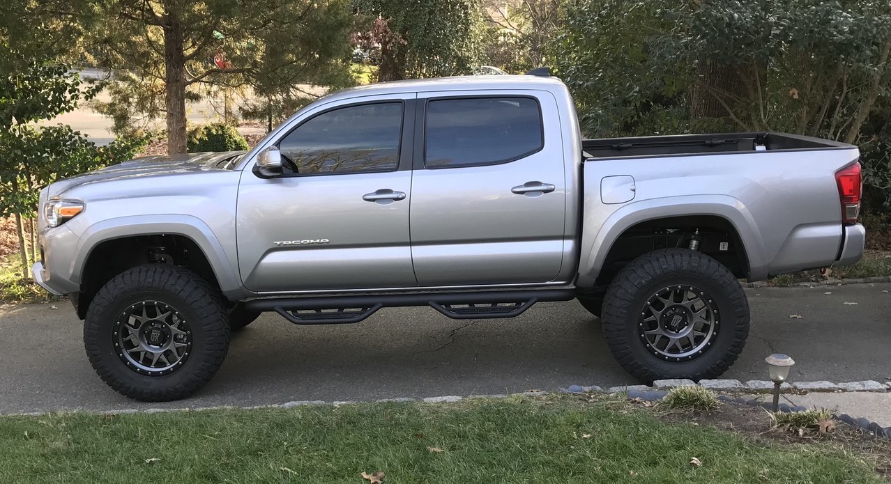

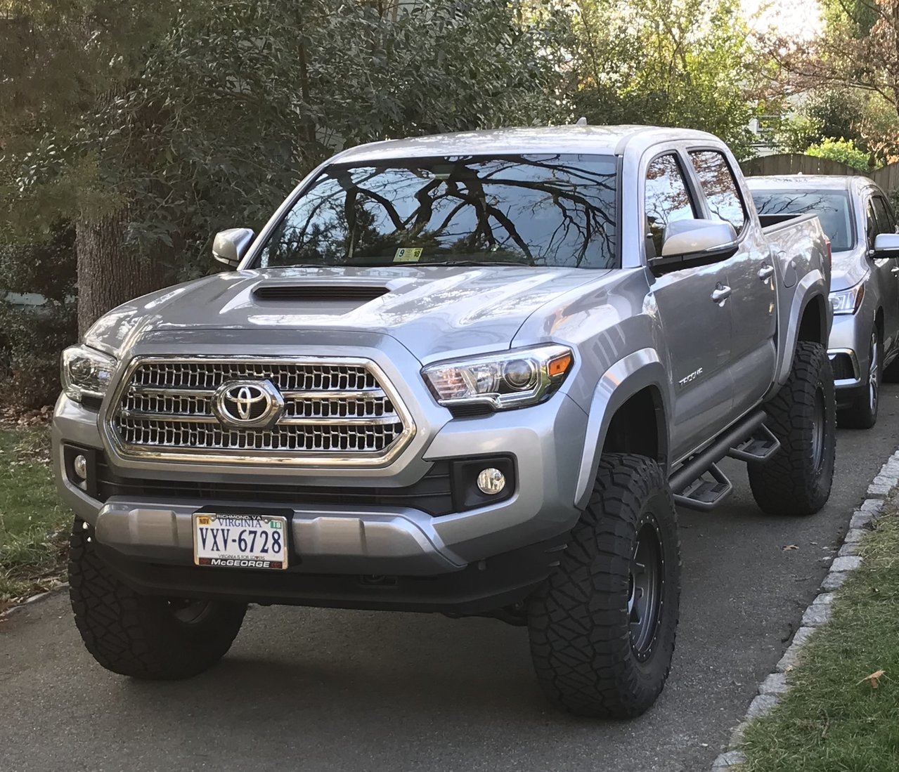

    Here’s my mall crawler.
    25EBEACB-F043-45FF-B7B3-944EAF4EC062.jpg A69ECAD9-26BC-4DC9-A6FB-9EE622D9F4D1.jpg 133F7344-C18C-4429-9E2E-598A226D63BD.jpg

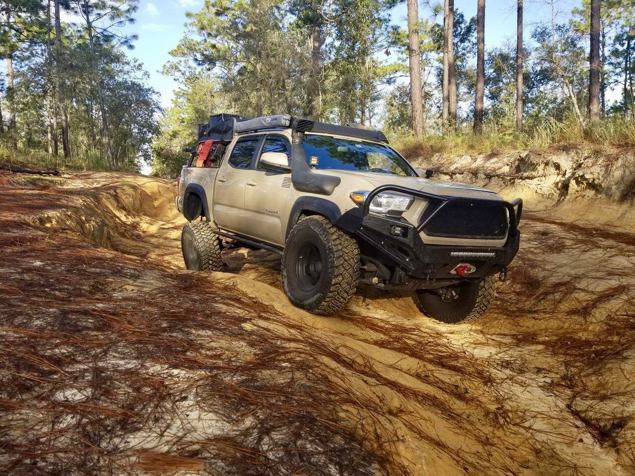

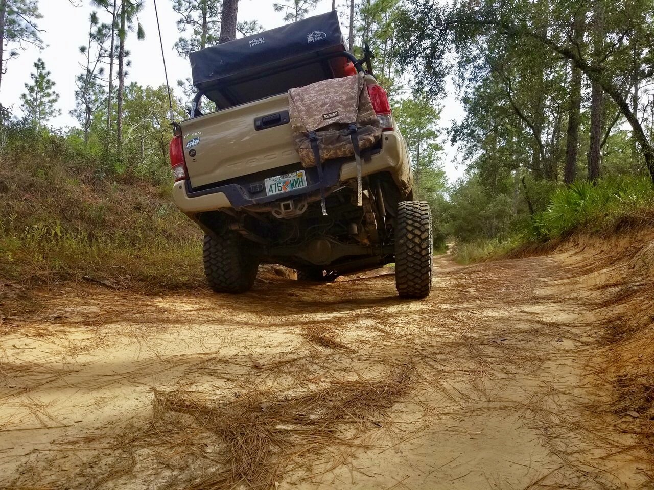

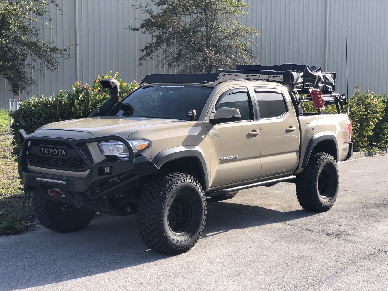

    35’s on 3". Likely gonna go to 37s soon.
    37A8607E-0DB7-4368-AF4D-AF6C7EC043D3.jpg 4BD9AF57-AD46-46BE-8AE4-68D8F3991FFF.jpg C866448E-7EBA-47C7-843D-152F8D4AF182.jpg

    WAIT....you have 3'' lift in the front and you didn't chop the fenders? Did you just limit the up travel or you rub?

    No fender trimming, BIG cab mount chop, and lots of positive caster. Wheelers super bumps up front. The 2nd pic is full stuff up front, no rubbing.

    If I come down hard it will rub, but that’s pretty rare since I don’t haul ass when wheeling. Slow and steady is the name of the game.
