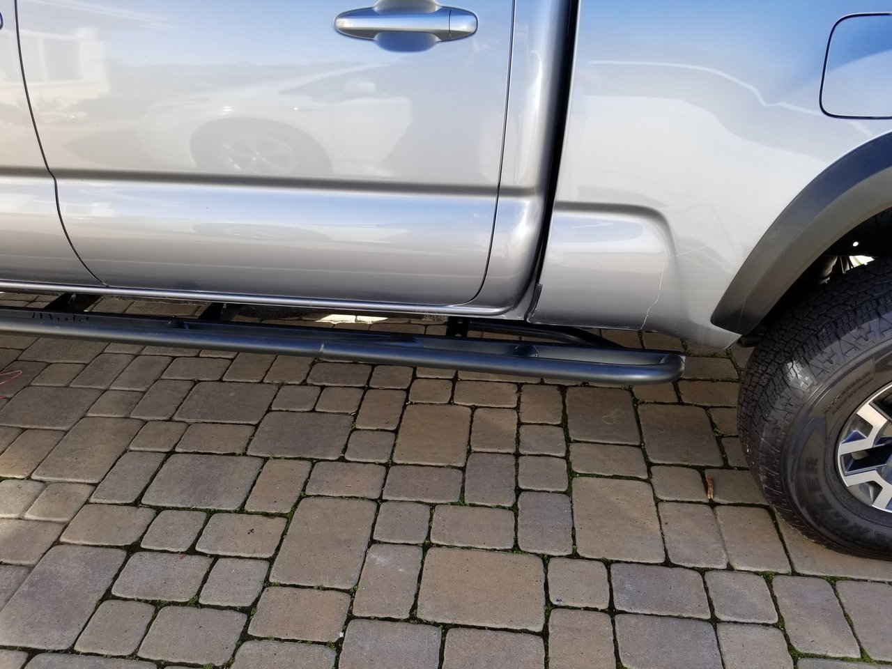

    Sliders arn't too bad...if you look at the picture I attached, you can see that cab has 1" lift and bed at stock height

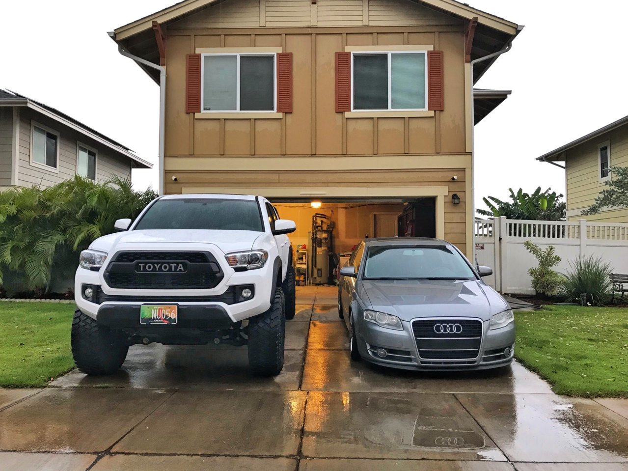

    This is perfect! What's that lift matey?

    Looks like a 6" drop bracket lift.

    Ah, I see that now. Thanks mate.
    I'd be scared of a DB lift.

    Yeah, it’s the BDS 6” coilover w/dsc suspension lift. No need to be scared.

    6" DB list and the LCA are still flat? Is that a normal 6" DB lift?

    Db lifts lower the lca mount location to keep good lca angles for tall lifts.

    Yes it keeps the cv axle angles straight.

    For some reason I was thinking 4" was the LCA straight and 6" pushed the LCA down.

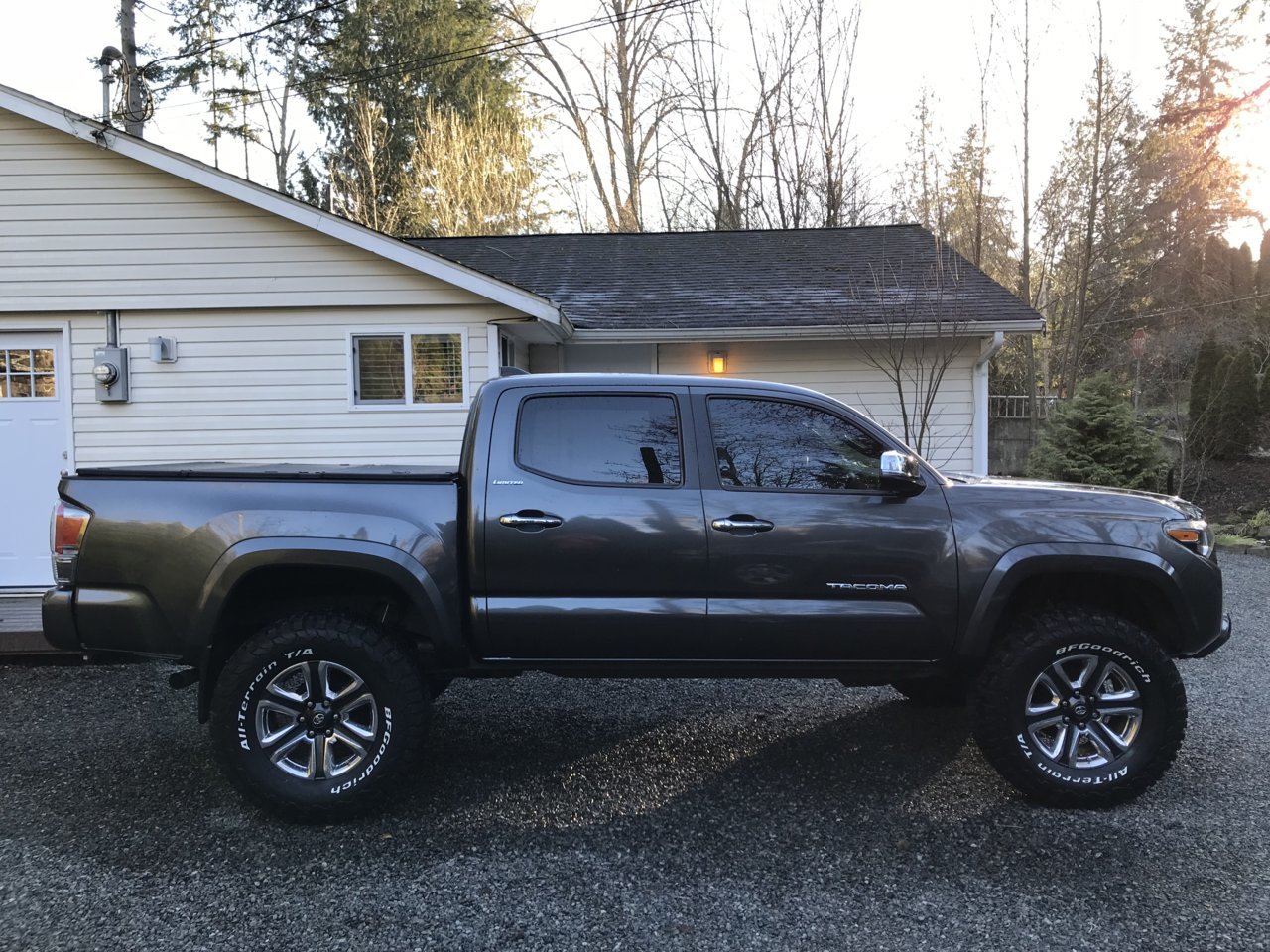

    Front Suspension: OME 888 front coils (~2 inch) Second gen Bilstein 5100’s set on second notch (~.85 inch) SPC Light Racing UCA’s camber set all the way forward Rear suspension: Wheelers 3 leaf progressive AAL (~1.5 inch) Toytech 1.5” blocks Bilstein 5125’s Wheels/tires: Stock limited 18x7.5’s ET+6mm 1.25” spacers BFG KO2’s 35x12.50r18 Cab mount/ fending liner trimming: Couple hours with the angle grinder and some rattle can to seal it up No Rubbing with the front air damn and mud flaps removed.

    Trim the fenders at all?
