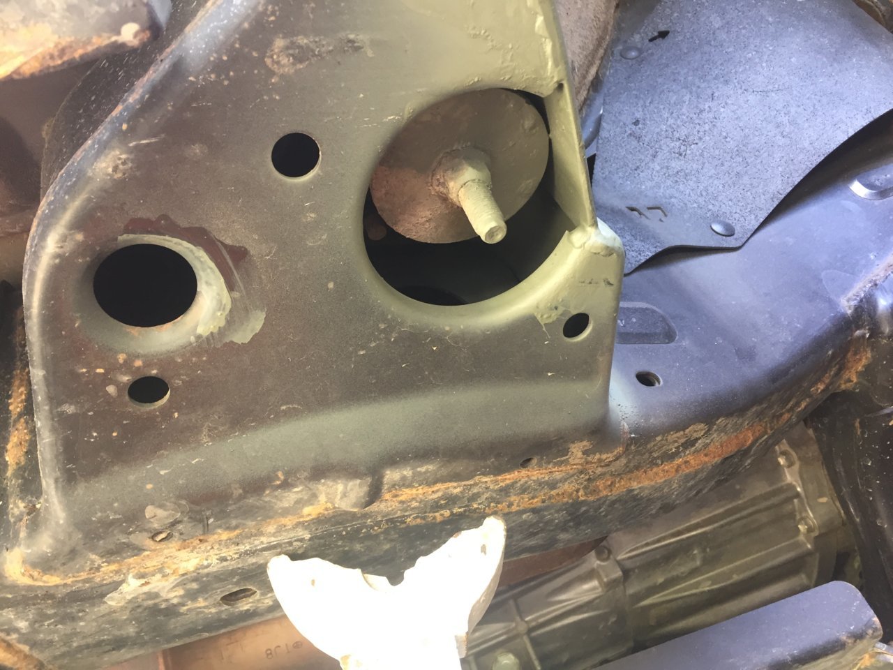

    That opening is huge. Need to match the rears now

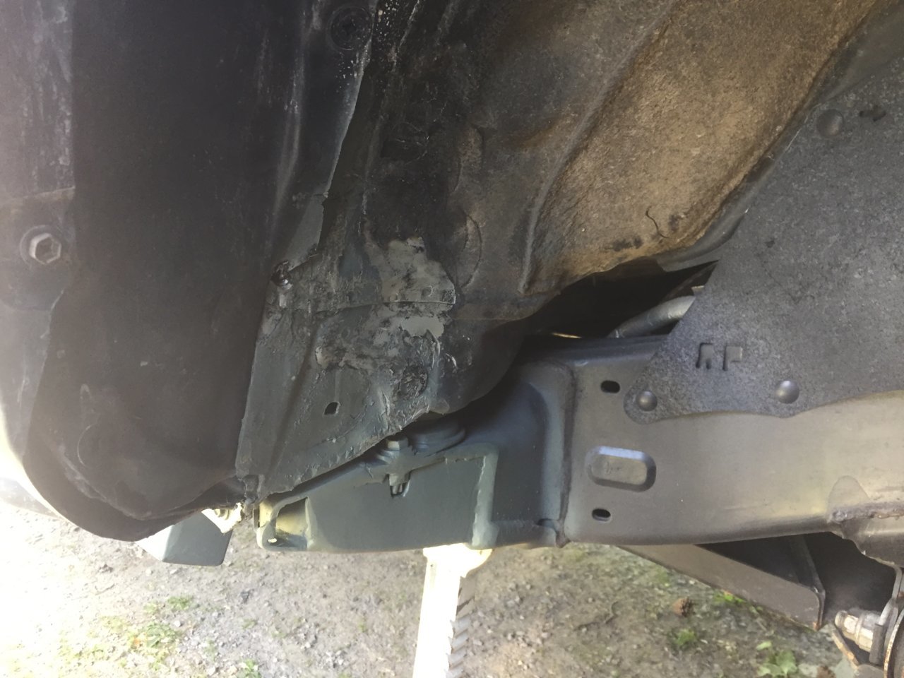

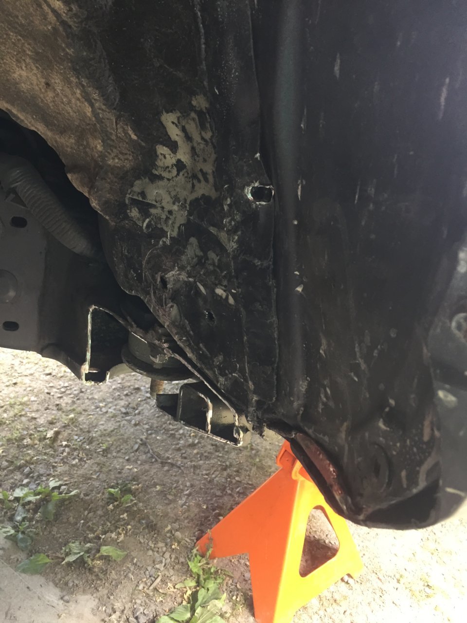

    Big tires

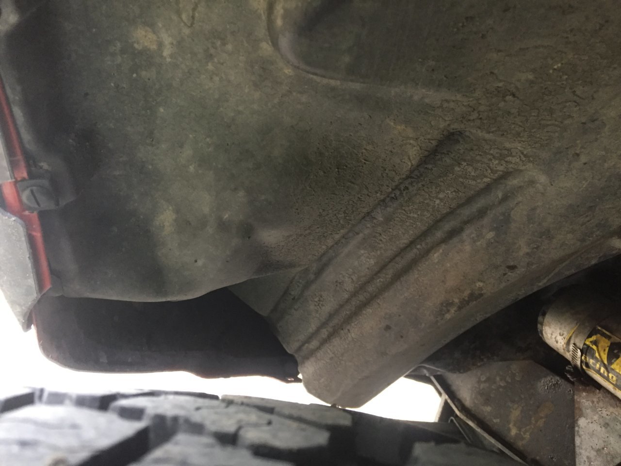

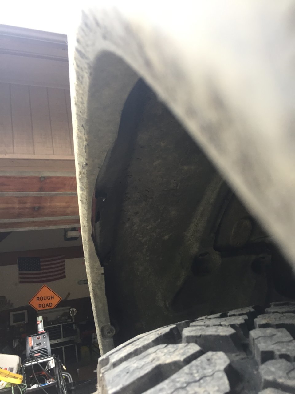

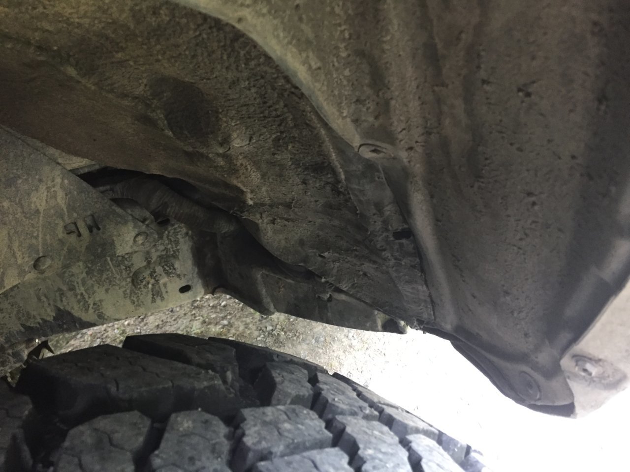

    Still need to try pushing the alignment forward more(higher caster) but for now she slightly rubs at the cmc, frame, UCAs(SPC Light Racing) and some plastic but it’s not bad at all. Only when heavily flexing and turning does it rub.
    Pulled the CO to see what needed trimming but when I thought it was 95% clear at full travel it rubbed like a mo-fo on the ground. Damn rubber bushings. Had to cut and sledgehammer three different times before I was happy with it. :frusty:
    Bent the pinch weld out and was able to tuck the liner behind it. The liner in the front was trimmed inside so I could pull it forward and re connect it with a new hole. SSO slimline bumper has a bracket to support the lower plastic bumper ends and liner which helps hold it forward. Also trimmed the inner fender flares at the top, front and back. At the top I re connected the liner with a zip tie and pulled out the fender a little. I also have super bumps with spacers.
    The rear fits perfectly without any trimming but I have B110 shocks that are quite long.

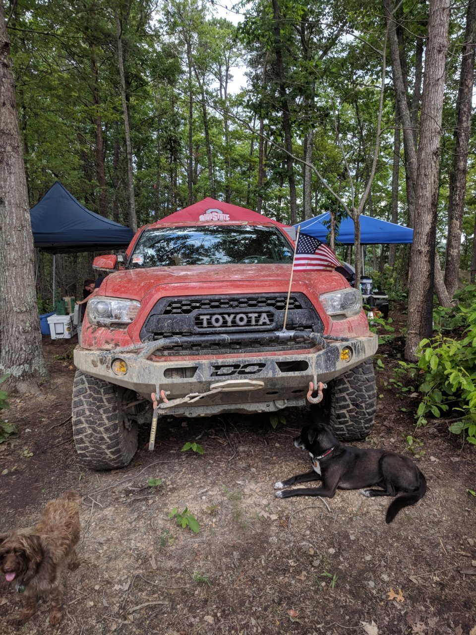

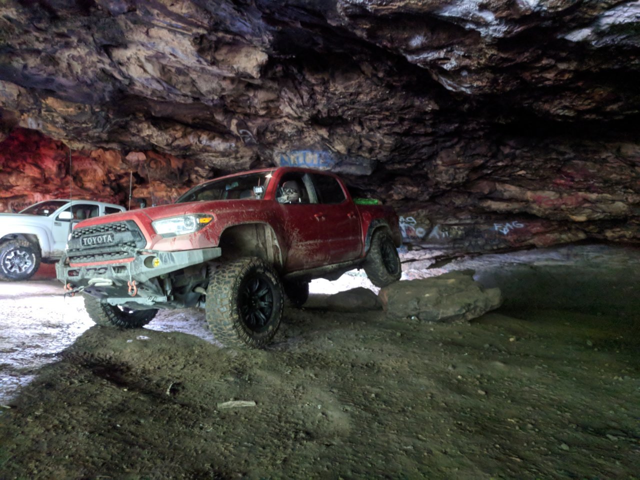

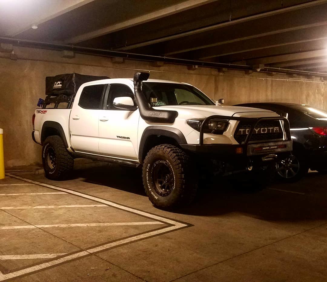

    Just wheeled for the first time on the dirties. Some slight rubbing on more extreme drops on to the front suspension (I.e. nosedive into a hole then having to drive back out), few good stuffs at full lock, but probably 80% of the time it was ok. Til my alignment got jacked from bouncing off rocks lol

    Also this:

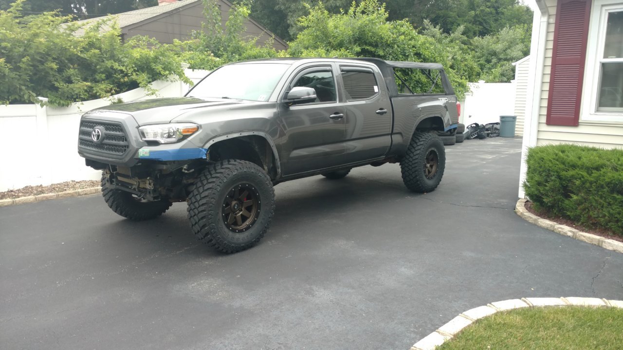

    how bad do you rub man?

    After a massive cmc and some SPC control arms I don't rub at all at ride height. I'll be pulling my COs to clearance the fenders for wheeling

    What did you end up setting your alignment to +4 caster?

    SPCs are set to the 3.75 position, and my alignment specs are at 2.4 degrees

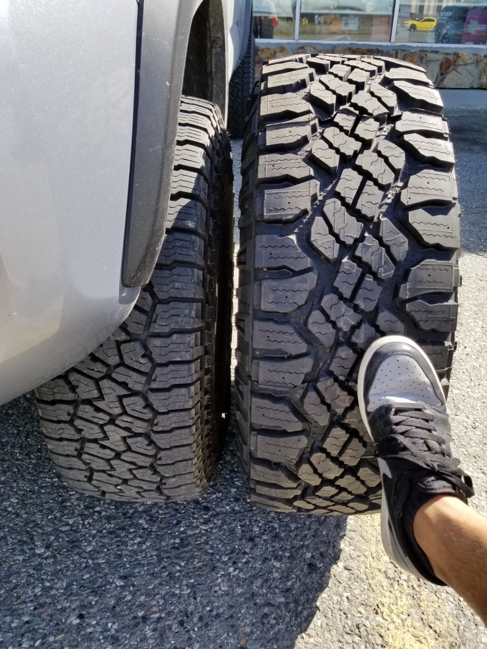

    Staying tuned to this thread, hanging with some guys on 37’s and 35’s got me looking into 35’s as an option.

    what tire is that?
  19. Aug 30, 2018 at 4:19 PM
    #459
    Catfish21
    Catfish21 Well-Known Member
    Dec 18, 2015
    #172515
    1,997
    Stockton, Ca.
    Trd off road 4th Gen
    Goodyear Duratracs
