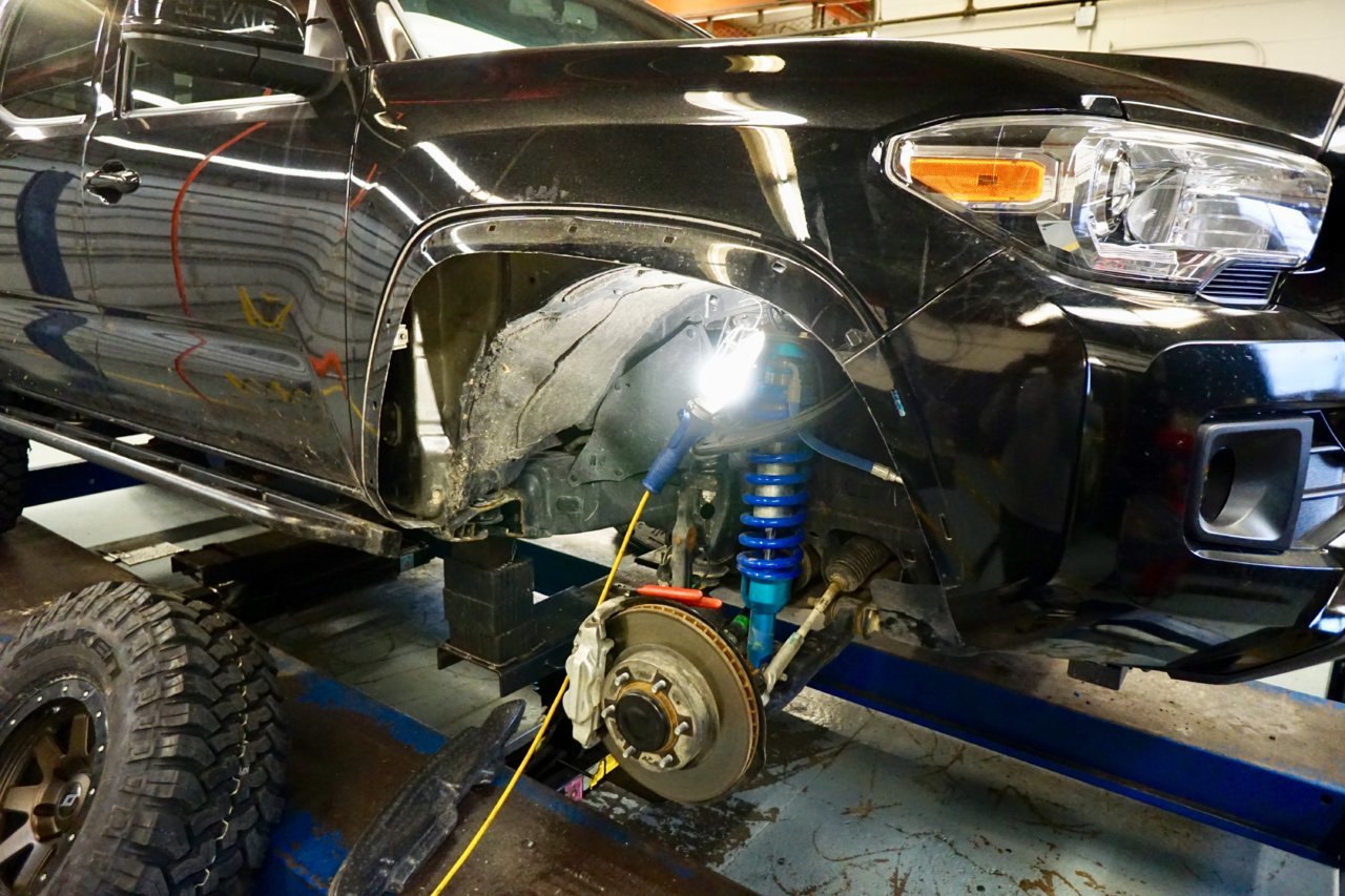

    @90yota Thanks for the pointers regarding working these fenders via IG. Still trying to find the sweet spot, then gotta dial in the alignment.

    Not a problem man! Let me know if you have any other questions. I miss my kings were that blue. Mine are weathered.

    Thanks boss, appreciate it! I’m sure after this winter, the Kings will likely be the same color as your set.

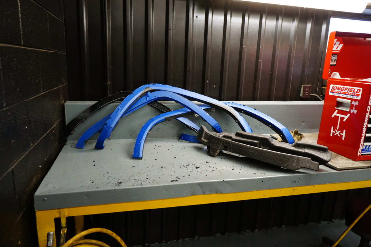

    The aftermath of getting the truck drivable.

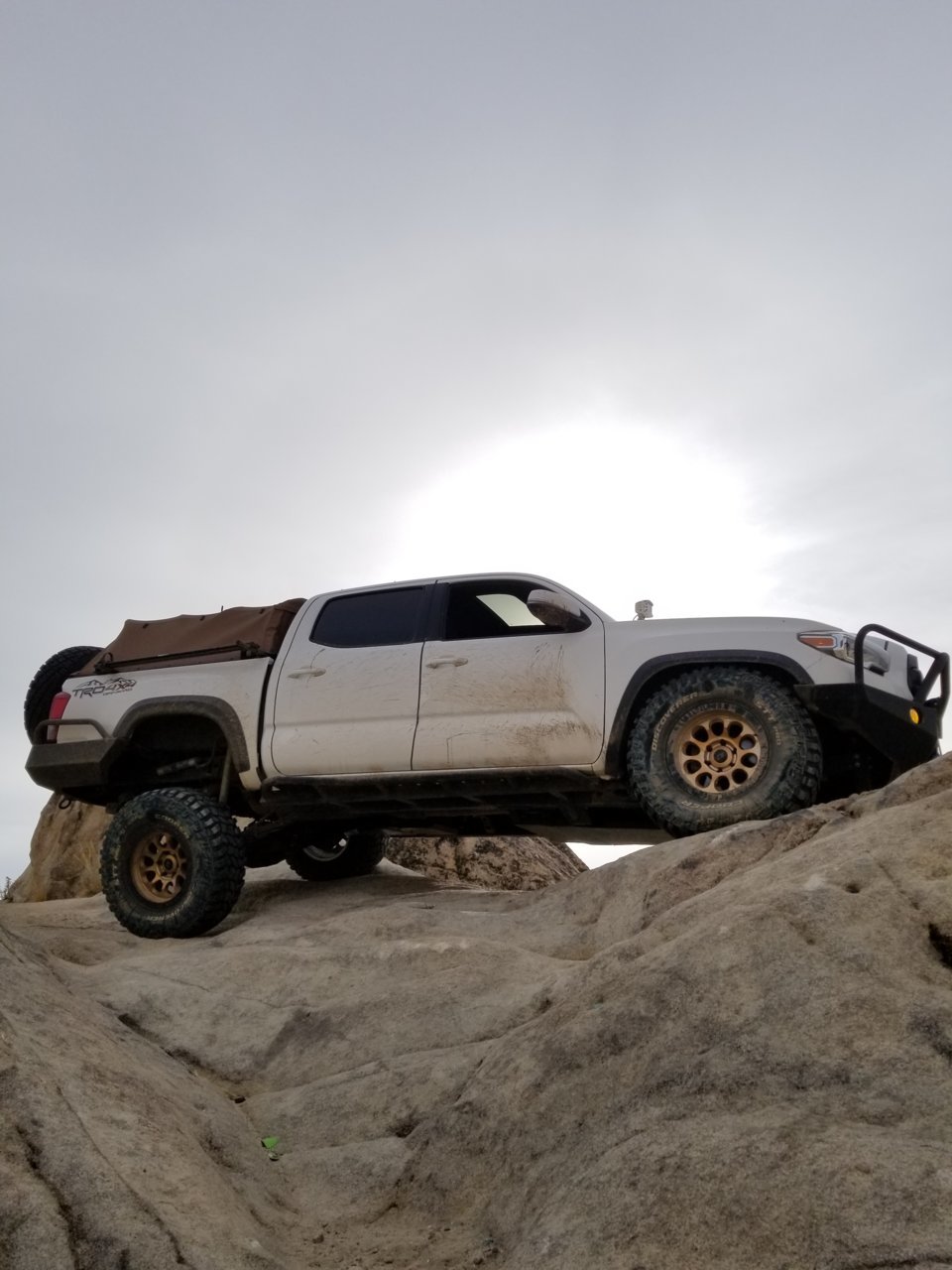

    6” BDS with Fox Option in the rear. 35x12.50 K02s with a 17” Method NV 305. MBRP 3” catback
    35x12.50s

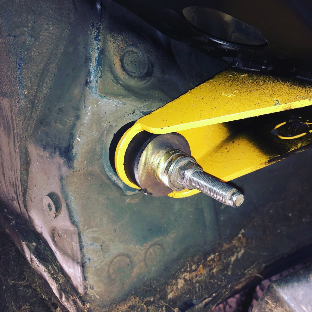

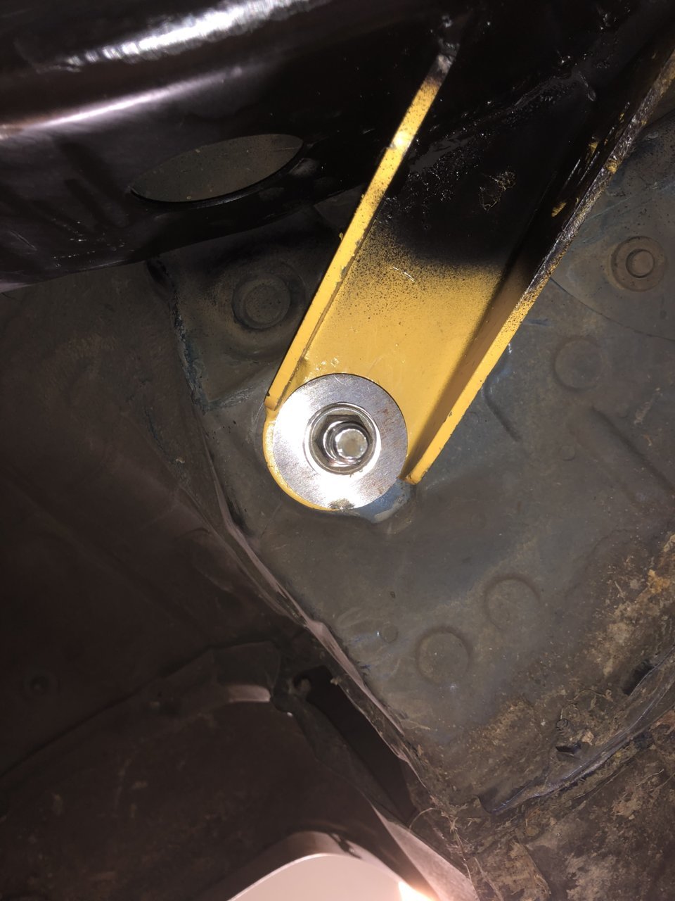

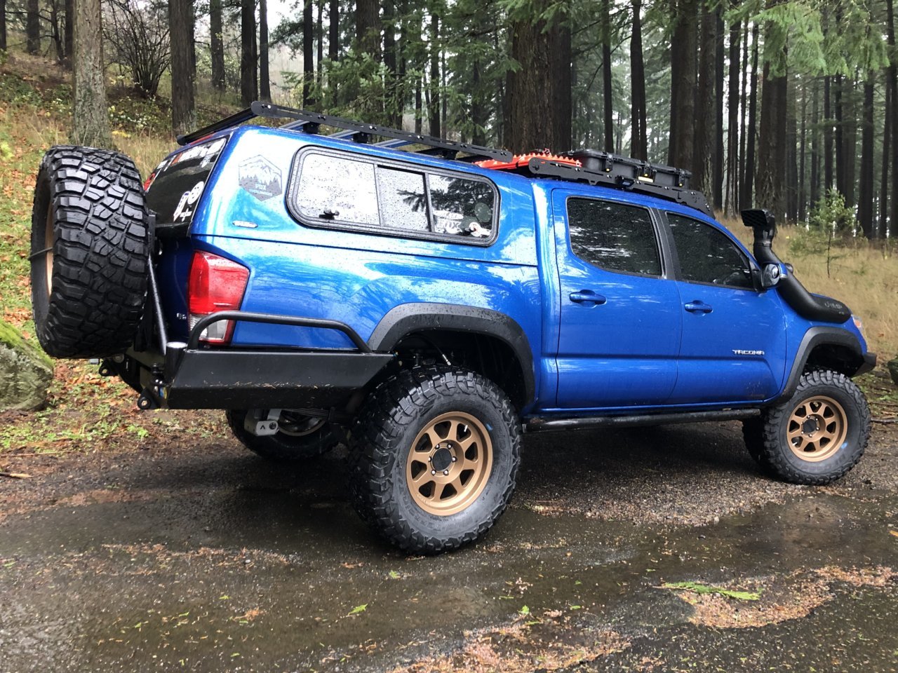

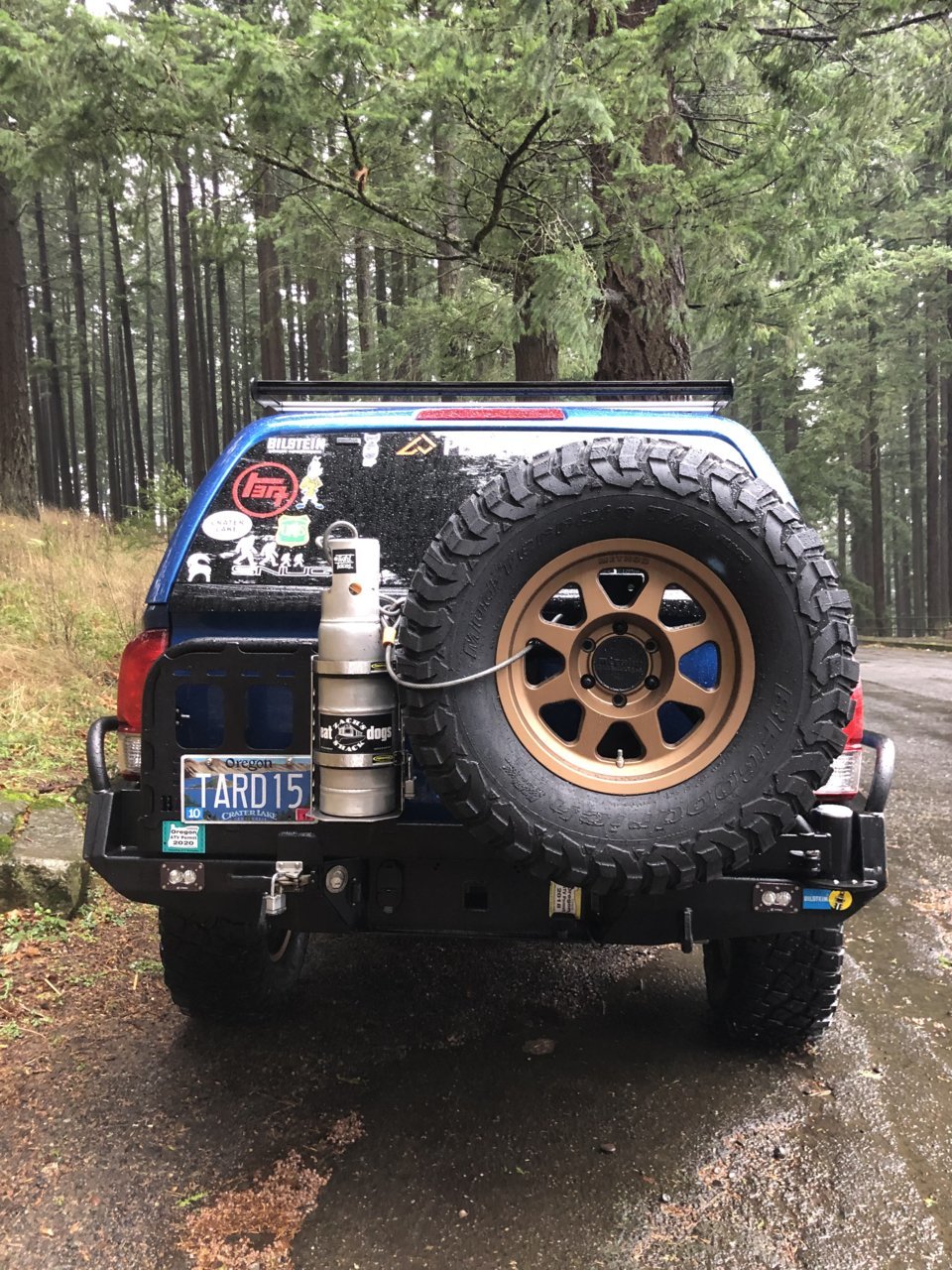

    Still have fender trimming and firewall bashing to do. Fender liners will be fun. I think they are needed. I am thinking of keeping the liner tabs on the fenders and sort of cutting around them and bending them in. I hope I can maintain some mounting points. Spare even fits well on the back but I did have to move the propane tank over some.
    The BFG km3’s were 34 1/4 inch tall on these 17x8.5 33psi. These wheels are zero offset and I am running 1 1/4 inch spacers currently. I had read the bfg run smaller than other 315’s. Not sure if that is the case as I did not have others to measure but I am happy they are no bigger than they are now.
    Alpine designs cabmount relocation gives lots of room. Firewall is the issue now. 74518038-ADFB-4881-AEF7-C9A079429A40.jpg7E11A46B-584F-4346-969D-252B6ABCC2F7.jpg
    F7CE822C-FA26-4EF2-A4F2-75F2382B58DF.jpg C4487A7E-3574-40D2-A1D2-7AEC15D6E529.jpg

    How was the install? The site is pretty minimal, but is it pretty straight forward - hack off the old and weld this in? Any install pics? Thanks man :thumbsup:
    Also when I cut my liners, I made some relief cuts, pulled them up and screwed them into the fenders where the flares covered. . Just gotta patch the cuts afterwards
