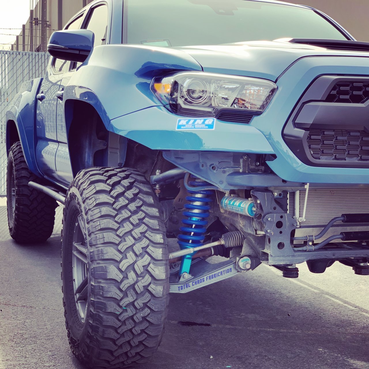

    TOTAL CHAOS 3.5 LT RACE 18'S TE37 PROGRESSIVE
    35x12.5 Falken MT01 and stock gears. Holding off on gears to see if magnuson will offer a supercharger.

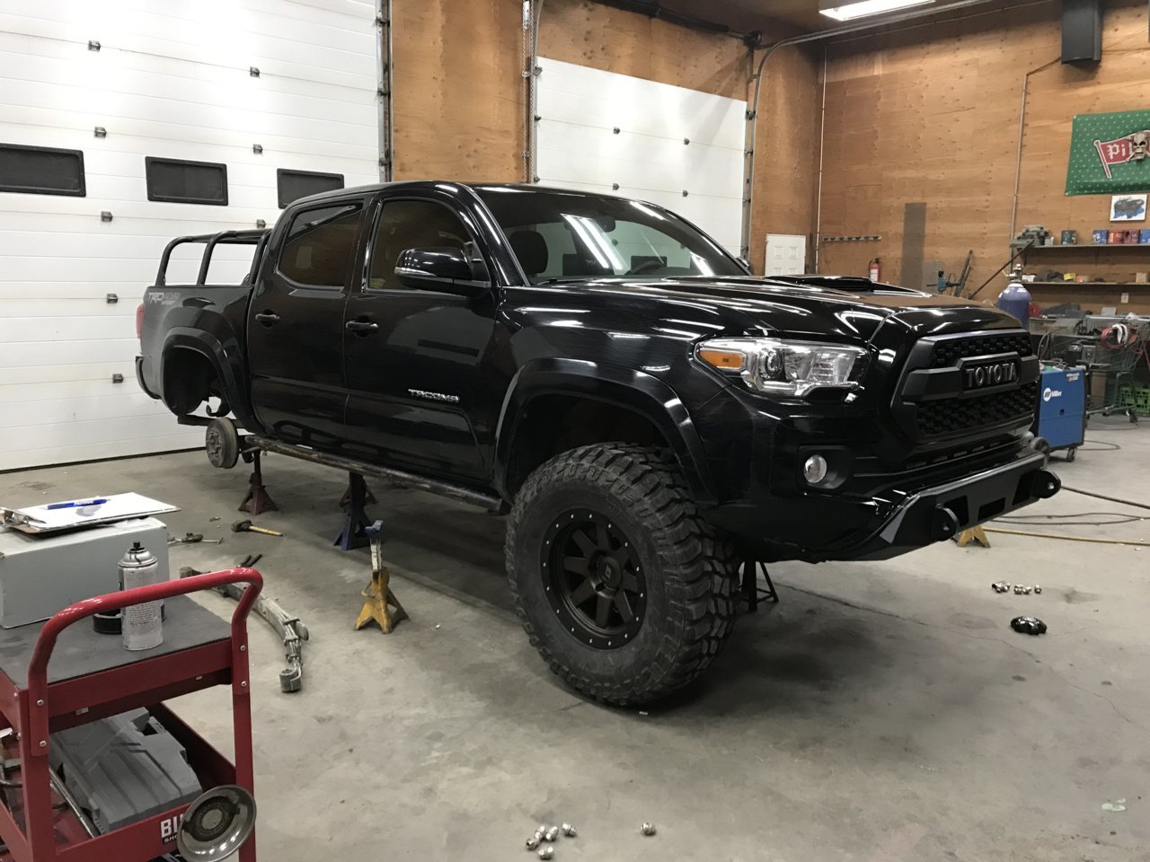

    So I joined the dirty five club too. 315/75/16 on SCS F5 16x8 -25mm 3.5bs

    Perfect man. 315's on a 3rd gen long beds is the perfect setup proportionately IMO

    I agree. I’ve always felt the truck didn’t look proportional....until now

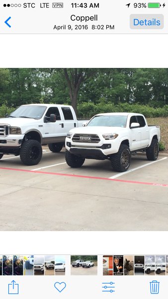

    Can you please give me details about your wheels and tire?

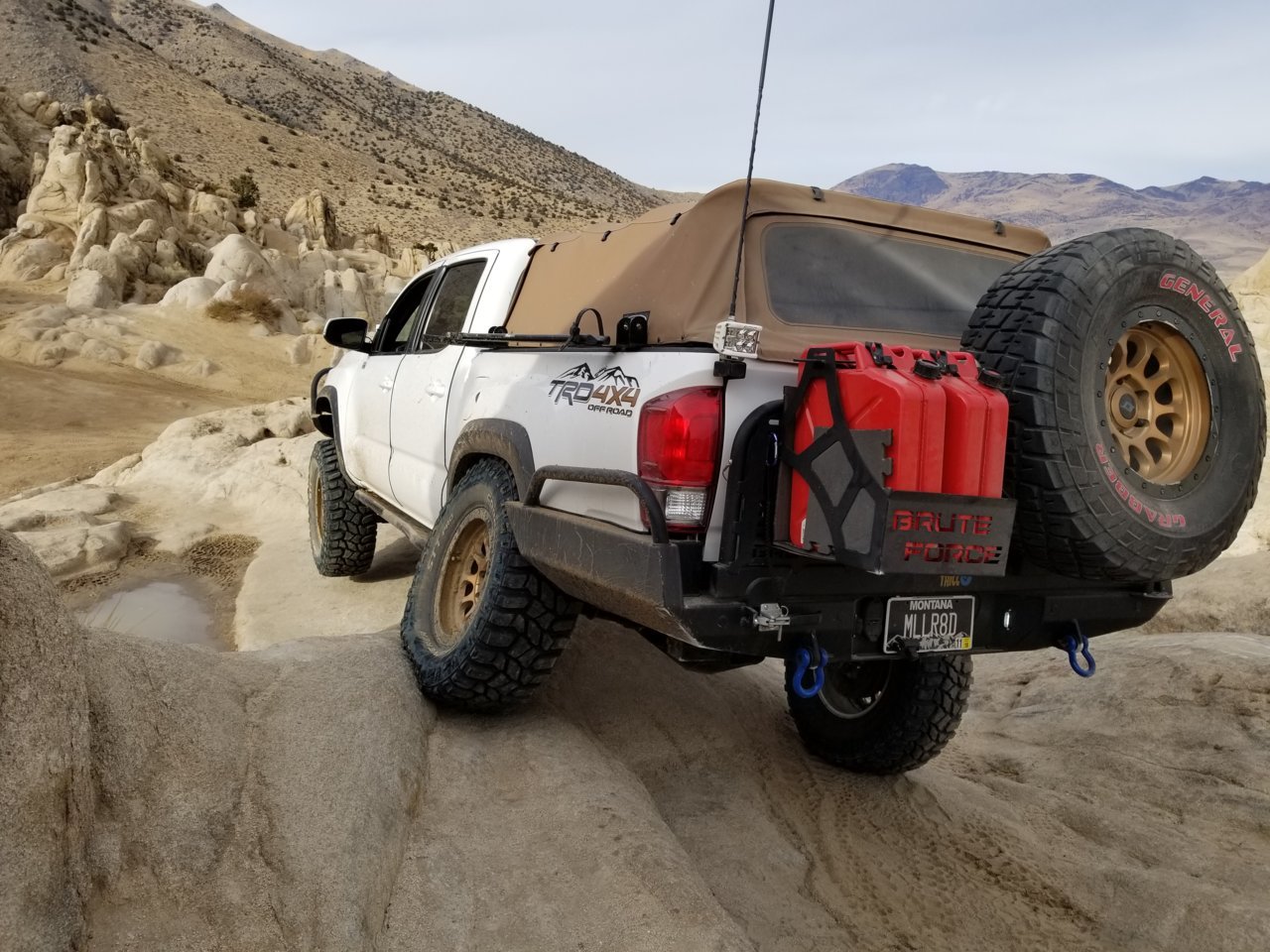

    Steel and 37s
    Haha that’s a throwback! He’s SAS’d on 40s now
    KENNY and 90yota[OP] like this.

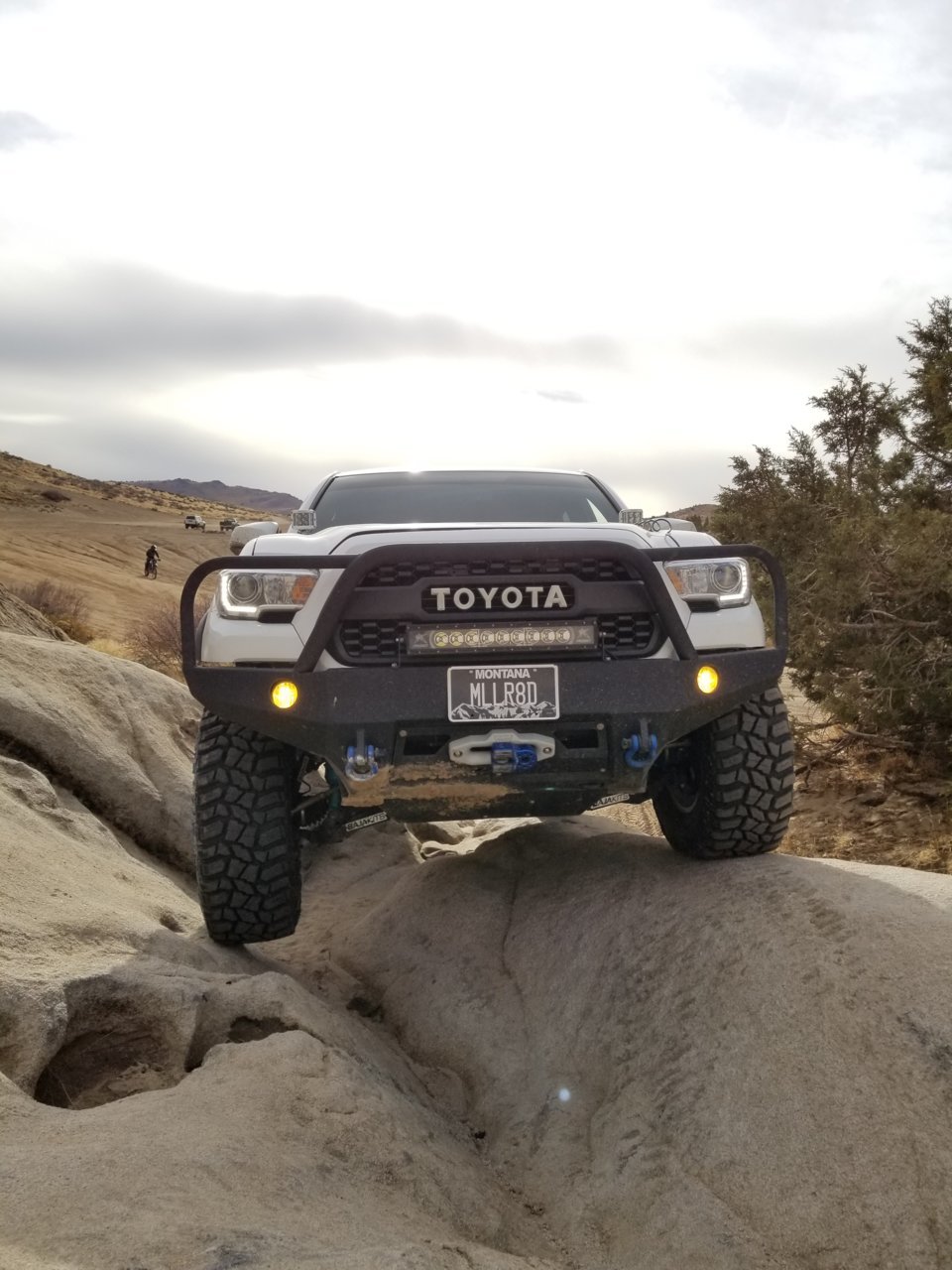

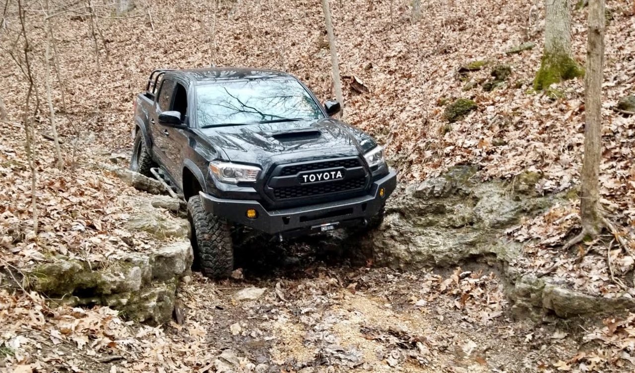

    First experience with the new tires wheeling, still gotta do some fine tuning and swap out the oem bump stops. Cab mount is no longer an issue for the moment.

    Did you have to trim anything in the rear?
    Did you leave your inner fender out in the front or did you find some way to keep it in?

    I haven’t trimmed the rear, last shakedown run didn’t have any issues, something I may revisit. As for the front, took 2” off the fenders/flares, and took out the liners. Gotta figure out a snorkel solution, or someway to keep the air box clean with the liner gone

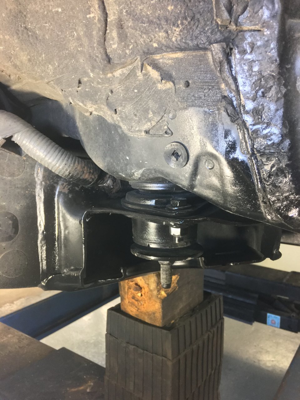

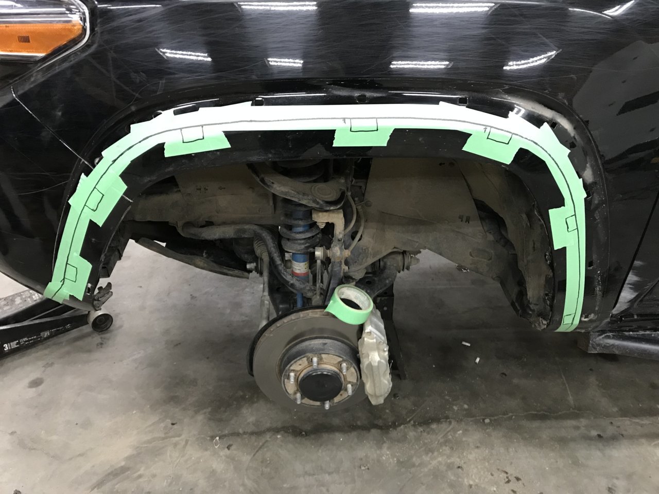

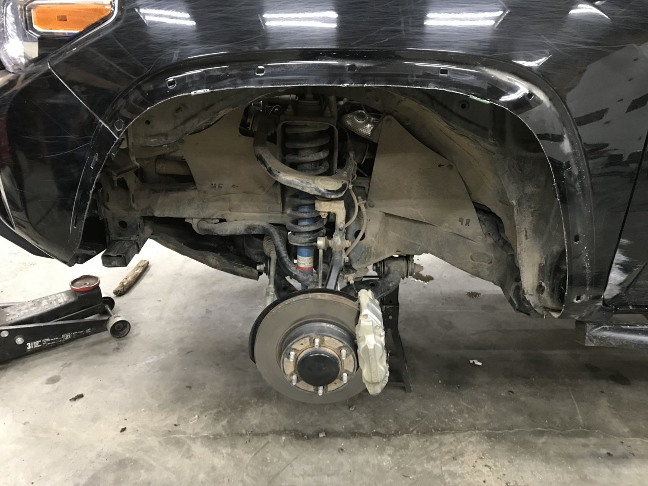

    Started the process of fitting 35's under a 2" lift last night. So far so good, other than the tire rubbing on the control arm I don't see any major issues.
    I'm trying to retain the inner fenders, so this is my solution. I'm cutting little tabs that I can fold over and ziptie the inner fender to the tabs.890.jpg
    First crack at trimming, I think I'll do a bit more because this will all be hidden by the flare anyways.
    Cab Mount Chop and more inner fender shenanigans to come!
