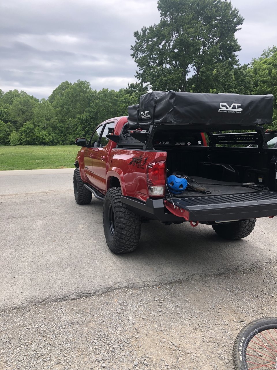

  2. May 29, 2019 at 5:43 PM
    #702
    Yotaaa91
    Yotaaa91 Well-Known Member
    Oct 20, 2017
    #233622
    145
    CA
    2017 SR MT
    Anytime brother! Did you paint the “Toyota” on the trd grille white? Looks clean. I want to slap the trd grill on my SR, just not sure if it’s as simple as all the guys doing it to their SR5s. At least I don’t have to deal with the tss.

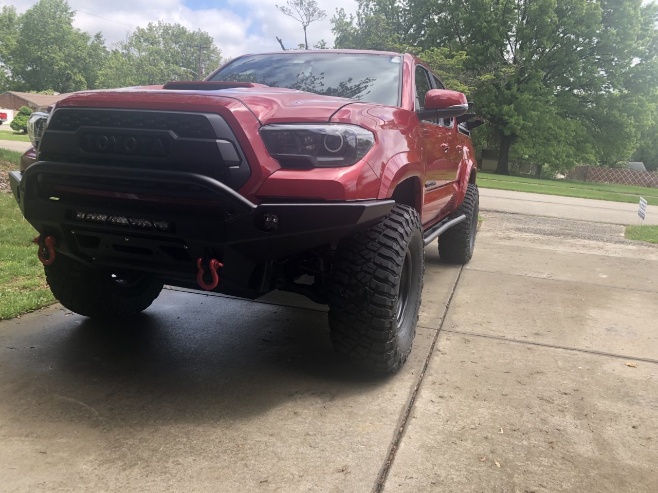

  3. May 29, 2019 at 8:10 PM
    #703
    kennethalan
    kennethalan Well-Known Member
    Jan 3, 2017
    #206476
    907
    Michigan
    Inferno TRD Off-Road 4x4
    King Total Chaos Dakar SCS Ray 10 315/75-16 STT Pro
    It’s that simple. I promise. A few screws and some clips.
    I didn’t paint the letters. They’re vinyl I installed.

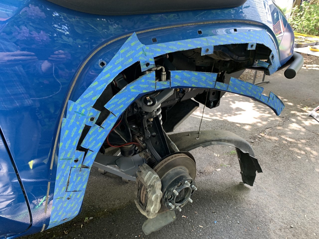

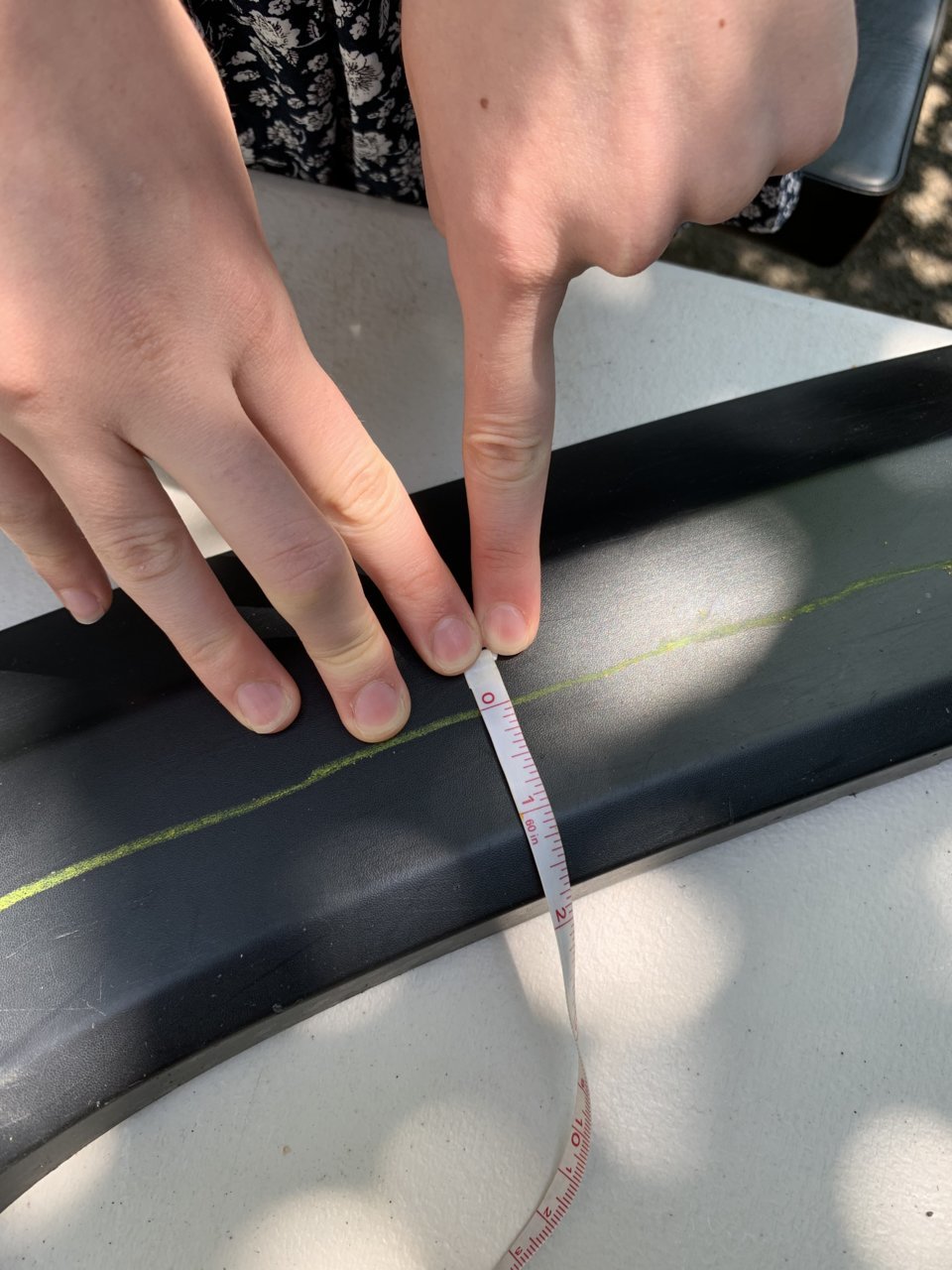

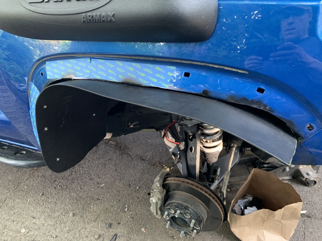

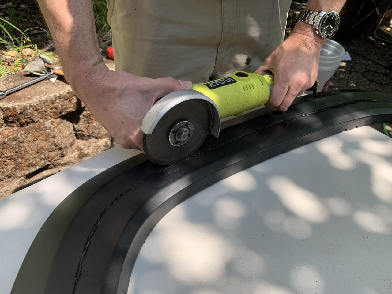

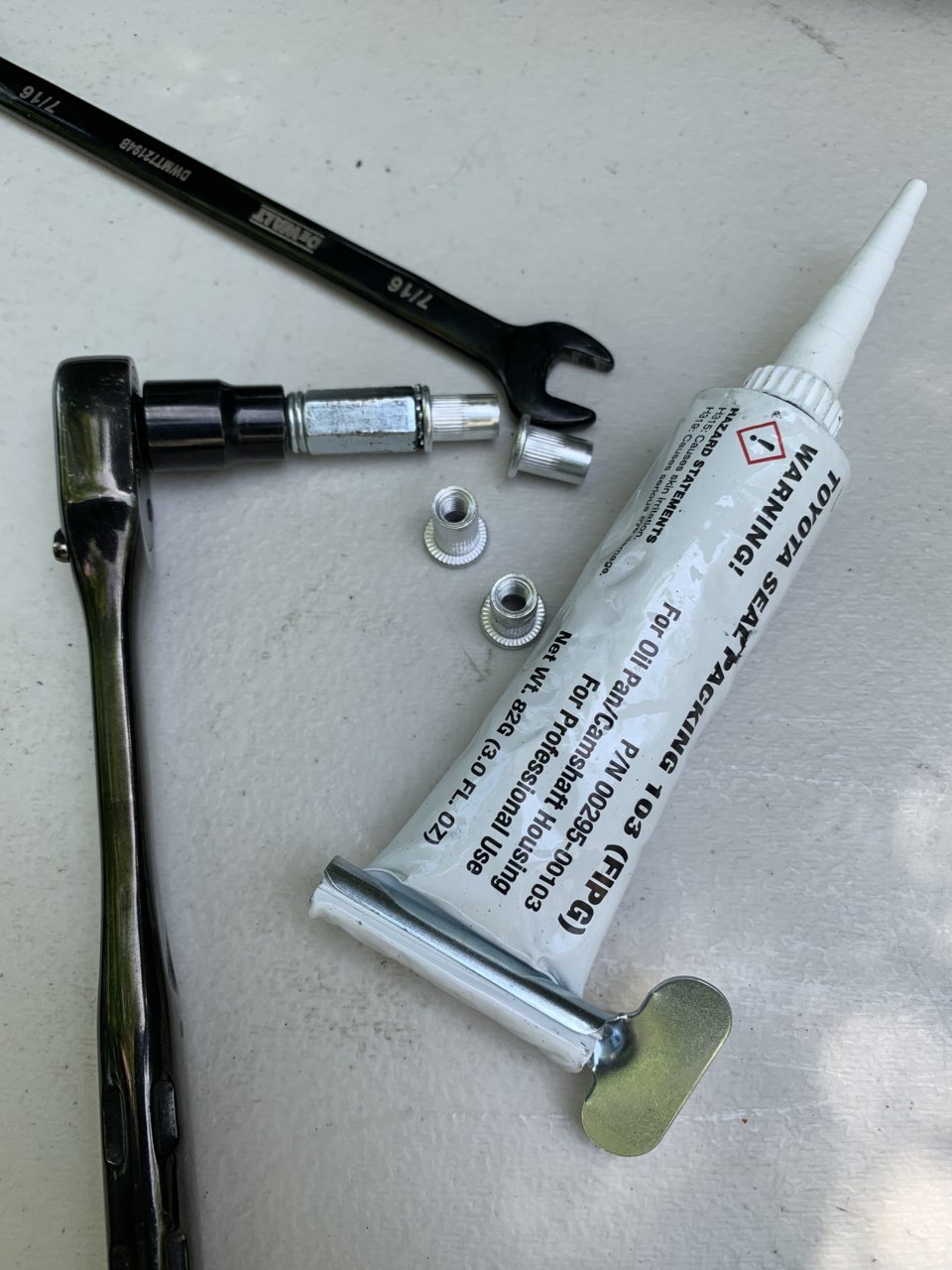

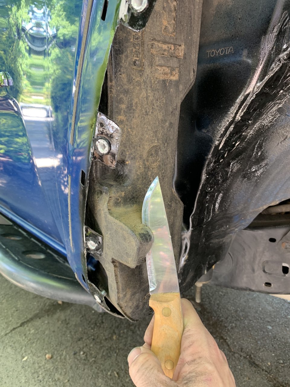

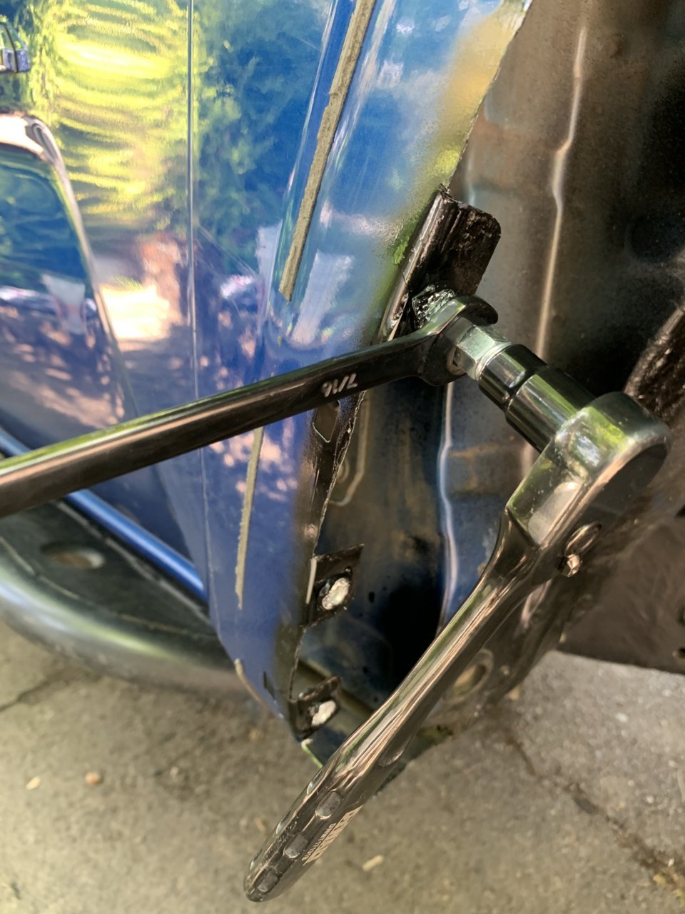

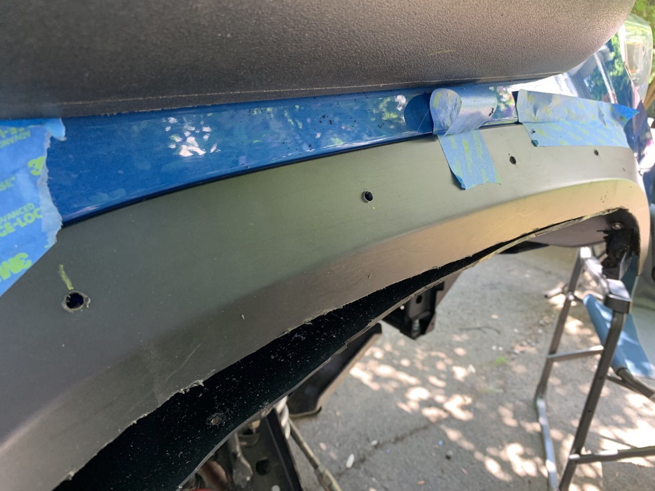

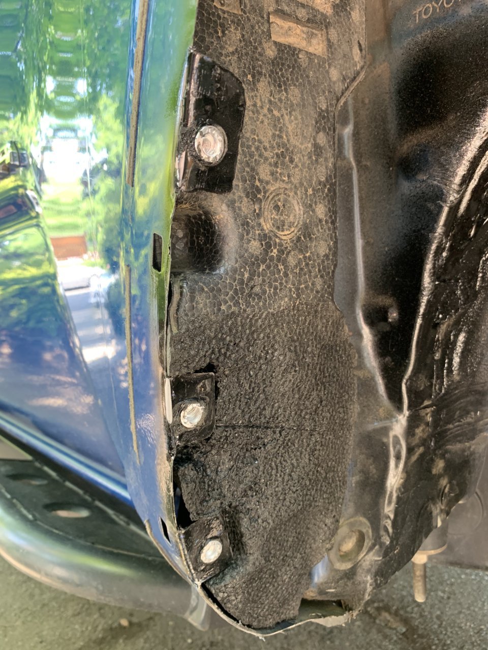

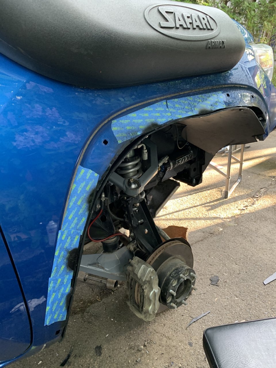

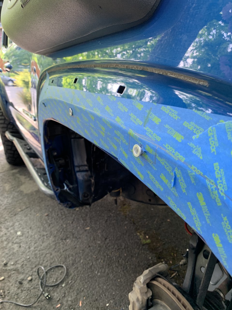

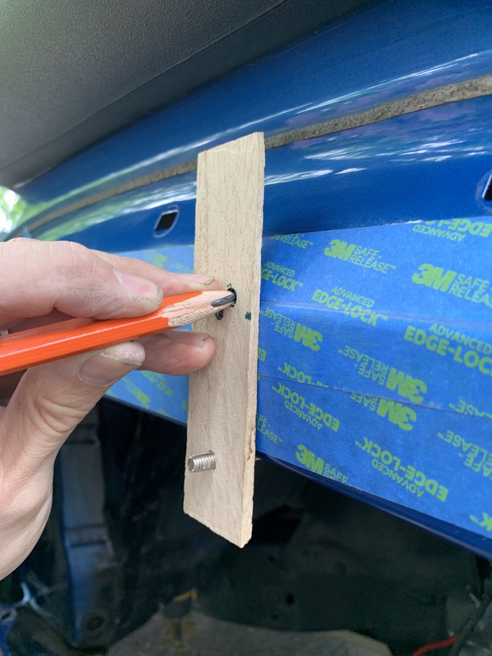

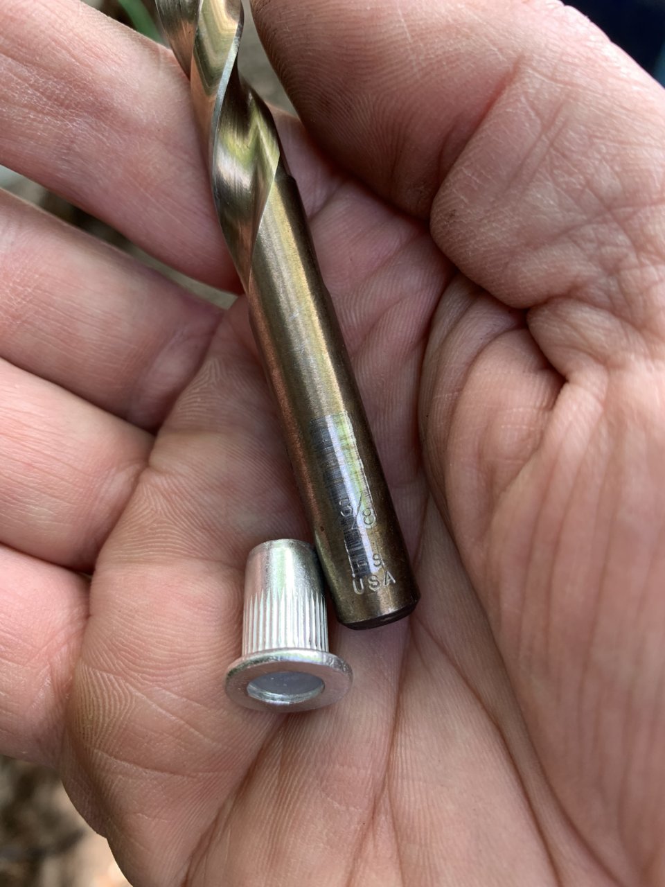

    Fender trimming and new fender liner install. You should get a very good idea of how I did it with these pics. It is a long long process. Took me 2x full days. I will post final pics later .
    Steps not shown:
    Lots of heat gun work on the new liners.
    Heat gun work on the foam insert after trimming it.
    Mount the plastic fender guards and drill thru those. No need for rivnuts as you can get to the back side to mount those.
    I used a flapper wheel to do the finish work. Also the new liners..they need to stick out and get trimmed back to get it all lined up right. This may not be the case for all but you have material to work with.

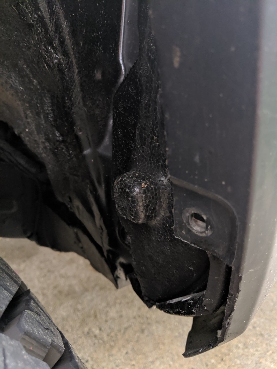

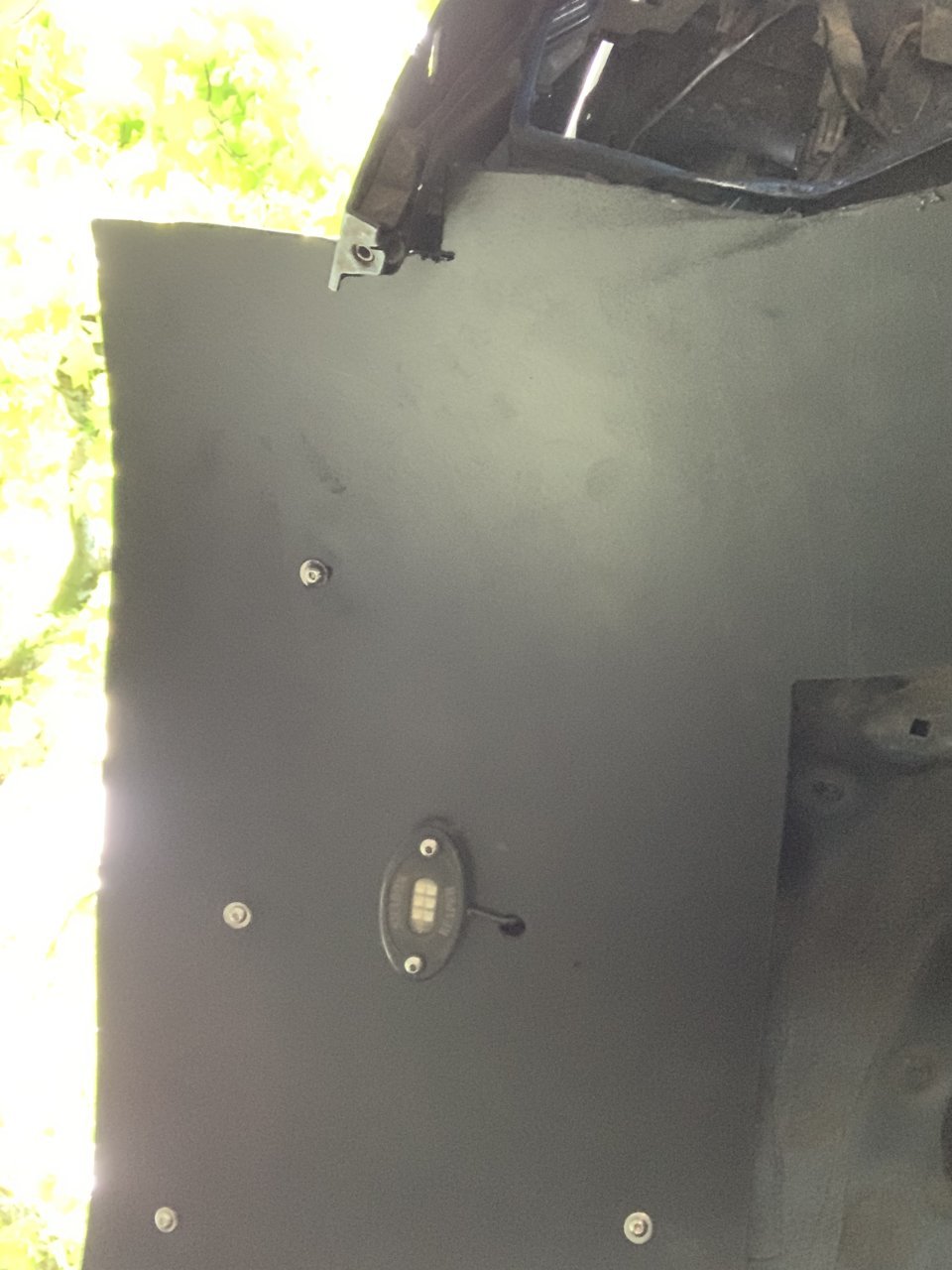

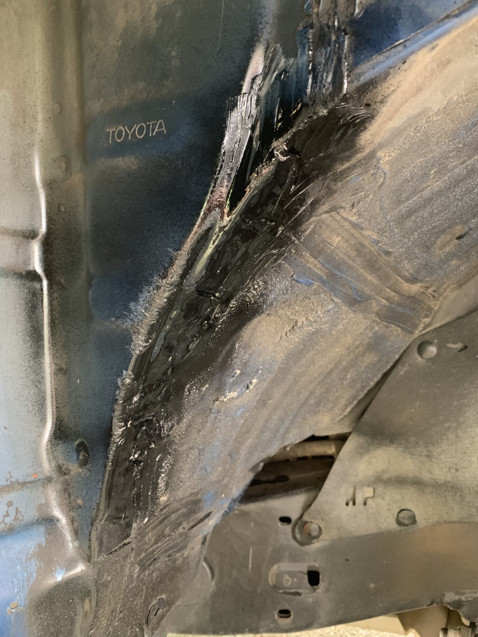

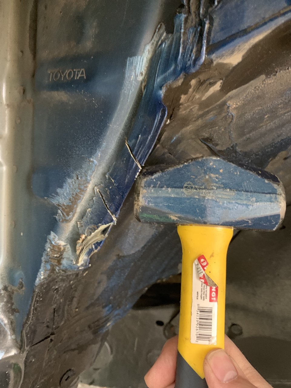

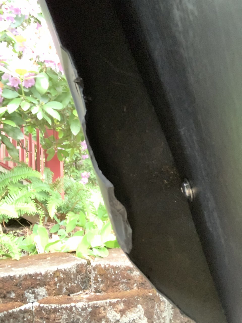

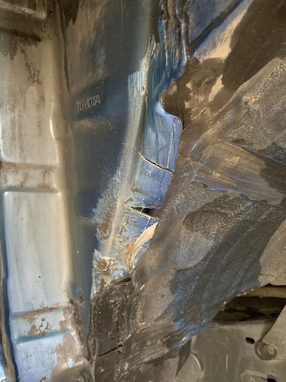

    Misc pics from the process above.
    The third pick shows how much I trimmed off the fenders. That’s the inside of the fender guard before I cut it236923F1-0B7D-4B12-805C-CC3C2F3C18B8.jpg E25ECAB5-1240-4107-ABFF-EF5DE28285FD.jpg 0DCDCF3B-2695-41AE-BB33-CF909E570CAC.jpg AA43DFE7-D014-44CB-B6B6-55AAB714360A.jpg 31D31464-793A-4B97-B752-0EC870566F47.jpg47D612B0-C262-4D4D-8BBF-119CBBACC2AE.jpg

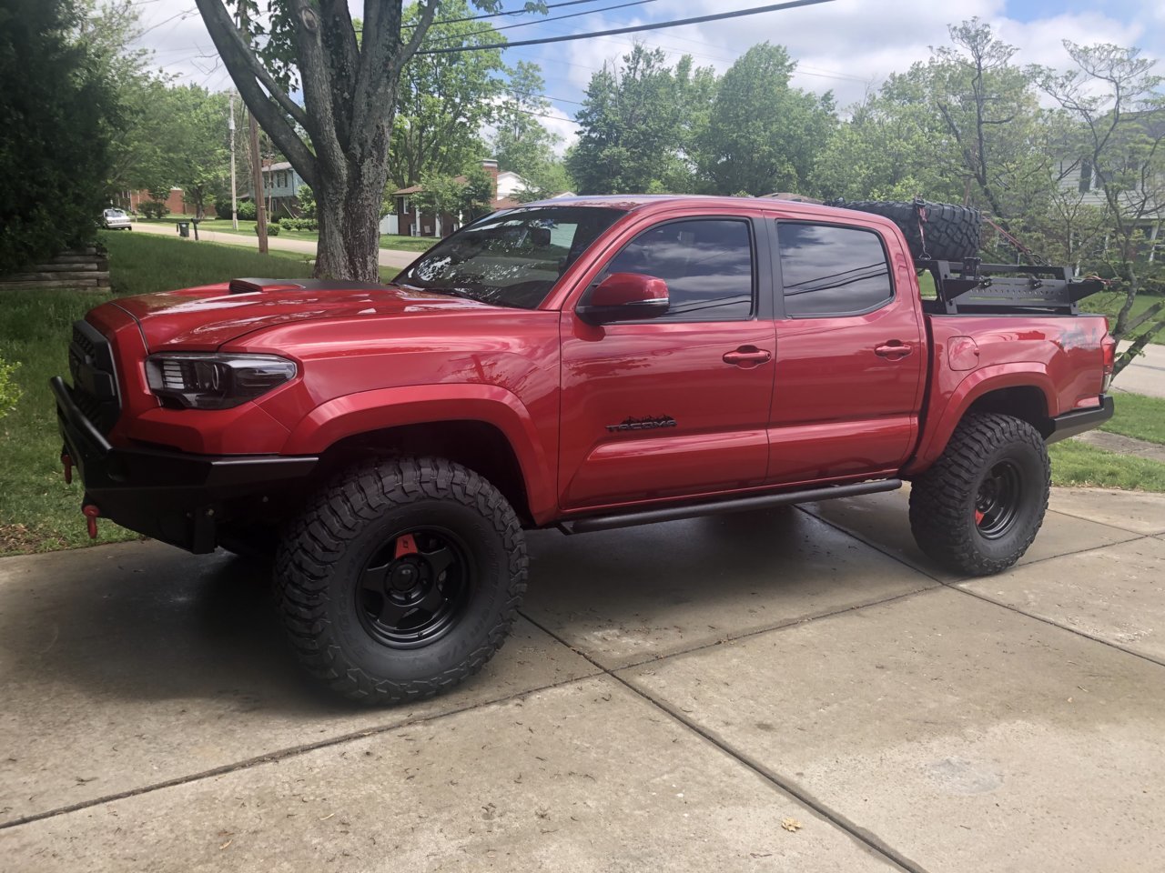

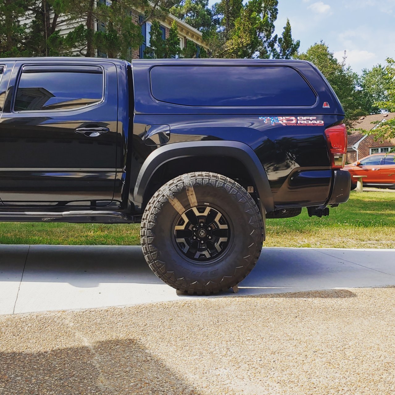

    Plastidip front grill and badges Bilstein 5100 shocks set at 0 OME 888 coils Lights Racing UCAs Headstrong AAL TRD Pro Wheels Matte Black BFG KO2 275/70/17 Rocky Mounts DriveShaft SD KB Voodoo Bed Rack ECGS 8 in clam shell bushing Custom Bedside Decals TRD MTB Edition CBI front bumper CBI rear high clearance bumper CaliRaisedLed 20 in single row bumper ARB CKMA12 Air compressor
    3B562C5F-3234-4A13-B4EE-E210C2A7E791.jpg 1DEC2D2B-37CF-483A-95BE-DAD0D120E004.jpg 50AA5748-2F0E-407A-B990-71241796F8C0.jpg
    315/75-16 km3. Scs f5 16x8-25

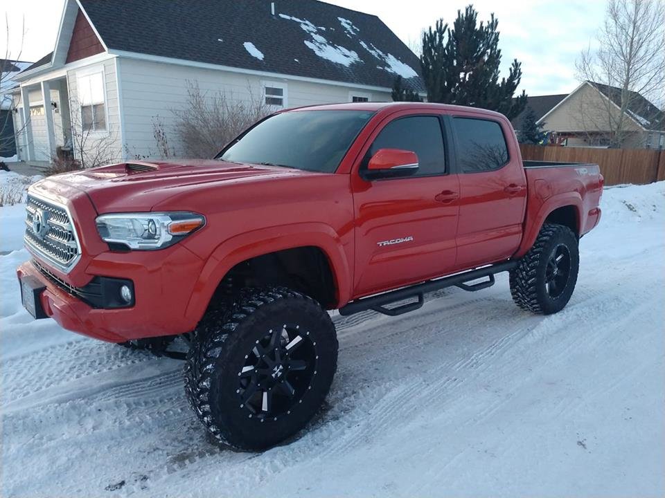

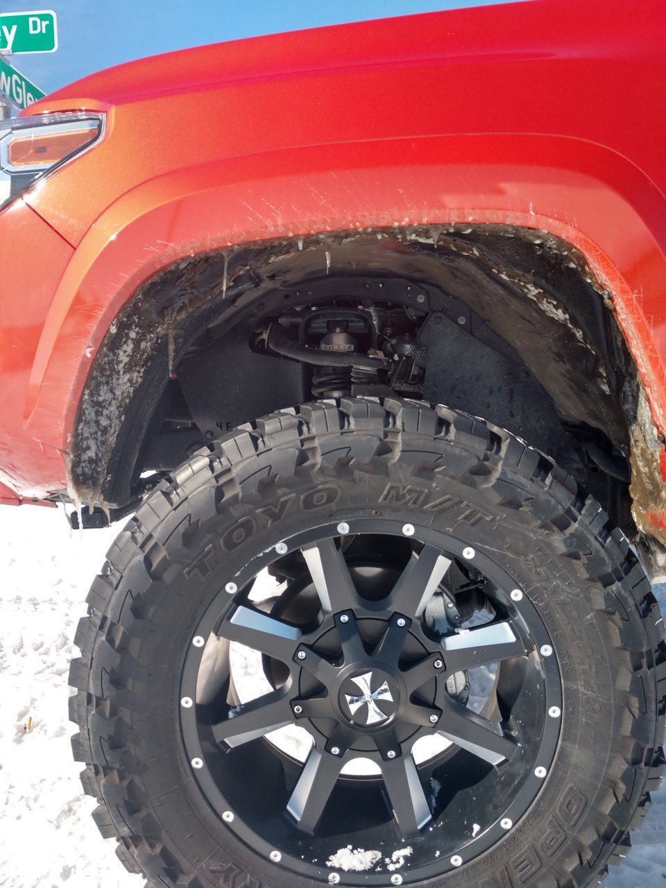

    2016 Tacoma Sport Custom
    2016 Toyota Tacoma Sport 35x12.50R20LT TOYO OPEN COUNTRY M/T TIRES 20" CALI OFFROAD® - 9100 BUSTED Satin Black Rims with Milled Accents FABTECH 6" lift and Dirt Logic Shocks PREDATOR Side Steps
    2016 Tacoma Sport - no rubbing but i did munch one of the standard factory mud flaps backing up on extreme incline. I think it was pushed into the tire while backing up and got stuck in the tire tred so still no rubbing spots as of yet.

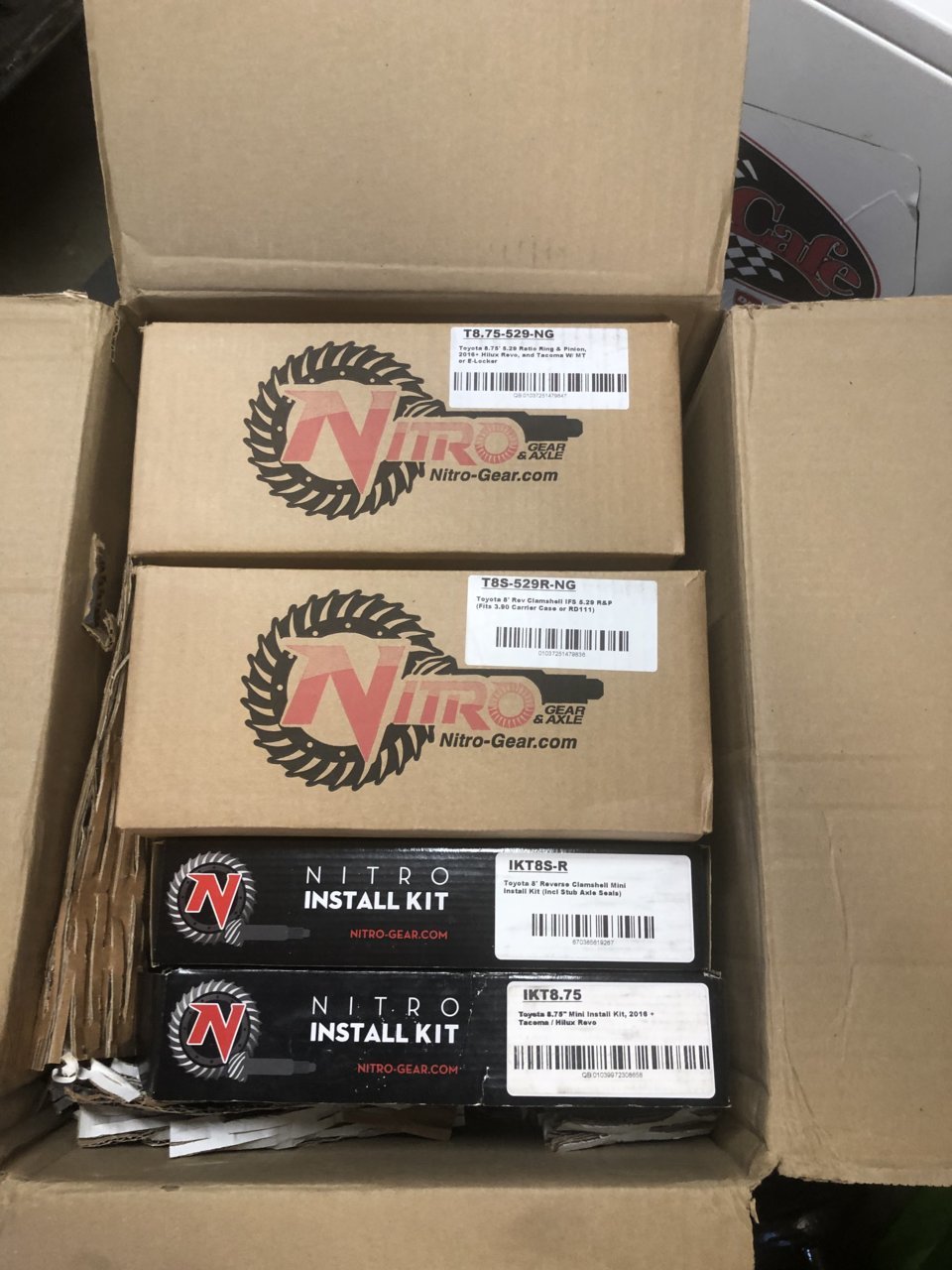

    That’s what I’m doing. I was unaware that my truck was rarely going into 6th. 7A45E4E7-2729-49BB-BB17-E7E22A5636FF.jpg

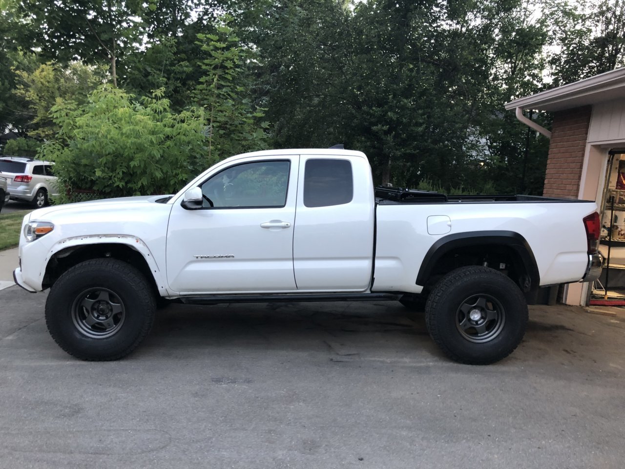

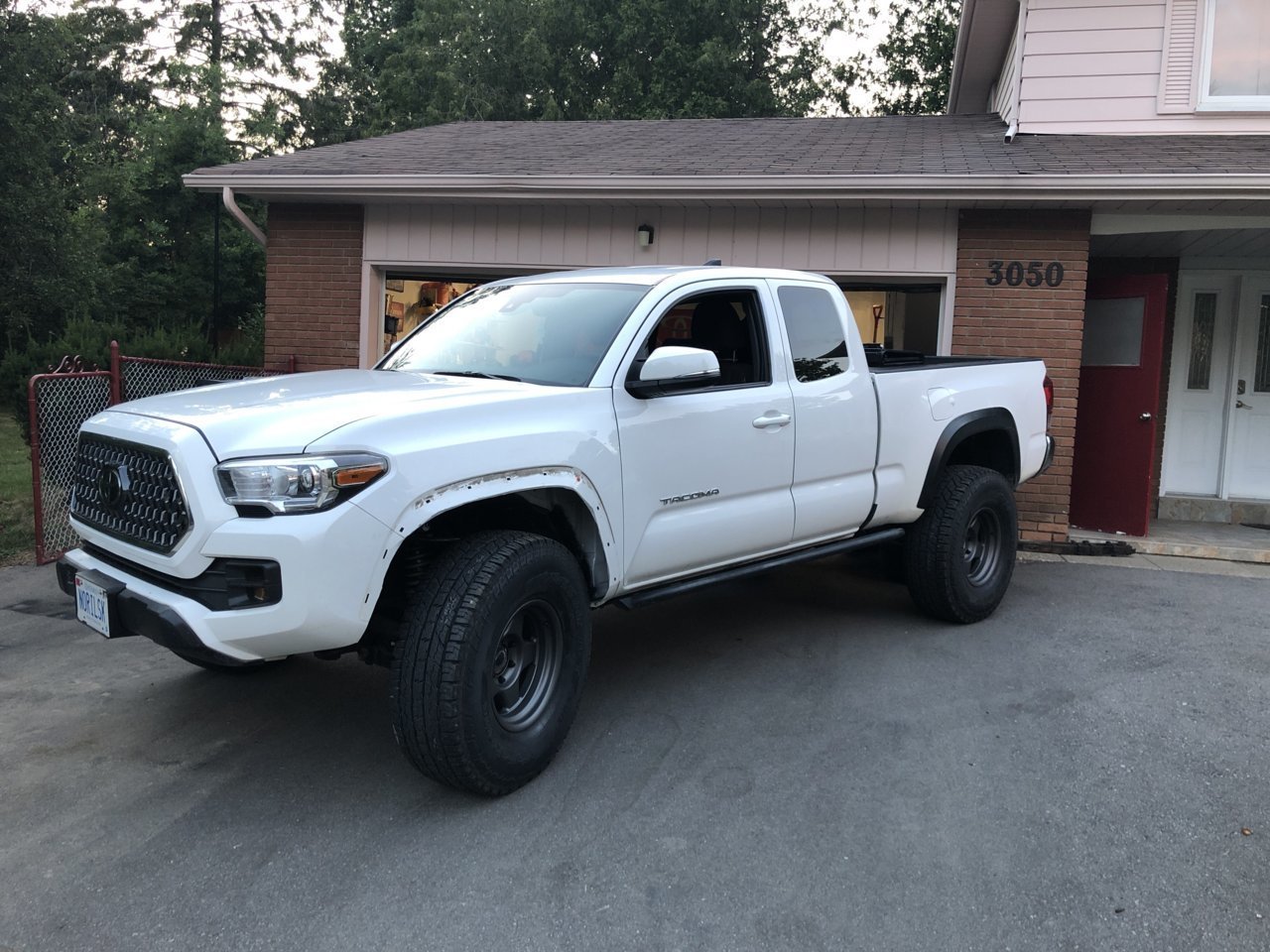

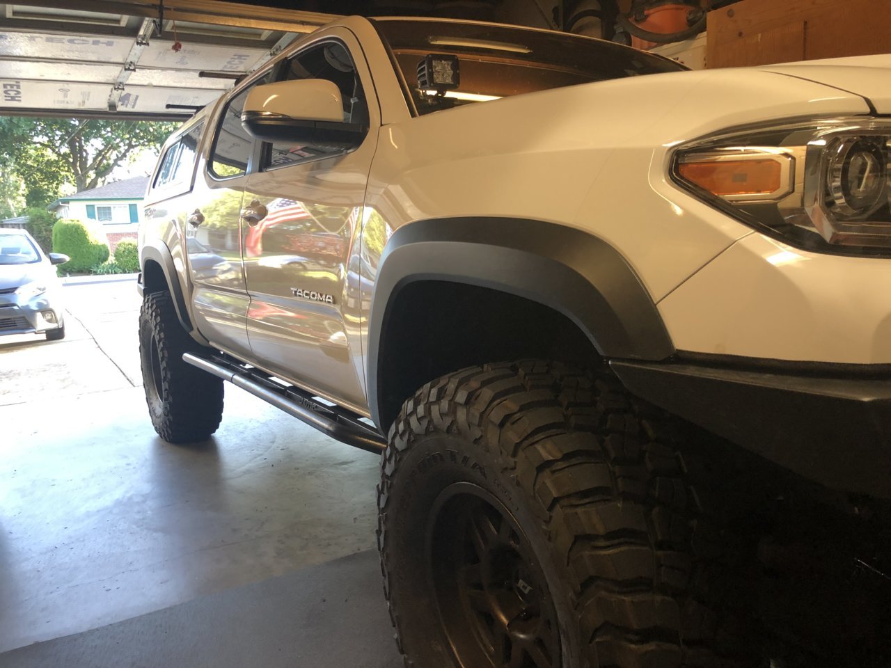

    still plenty work to do ahead, but they fit and no rub (after chopping all that's possible) with 1” front lift on stock UCA and icon RXT leafs at the rear.
    next is to trim plastic fenders
    new uca
    gusseting, reinforcing, visual fix, mud flaps etc

    going to keep it naked? or are you chopping the black fenders as well?
