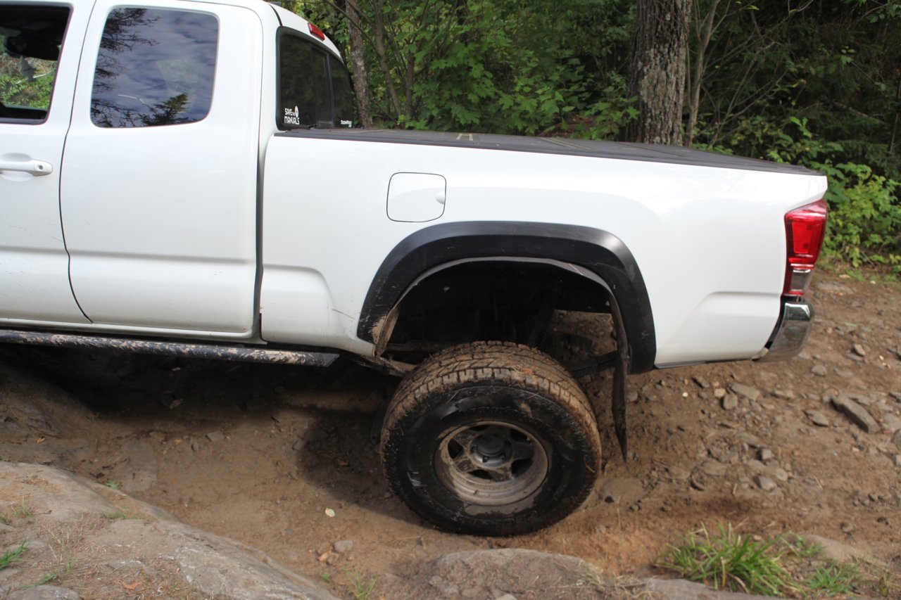

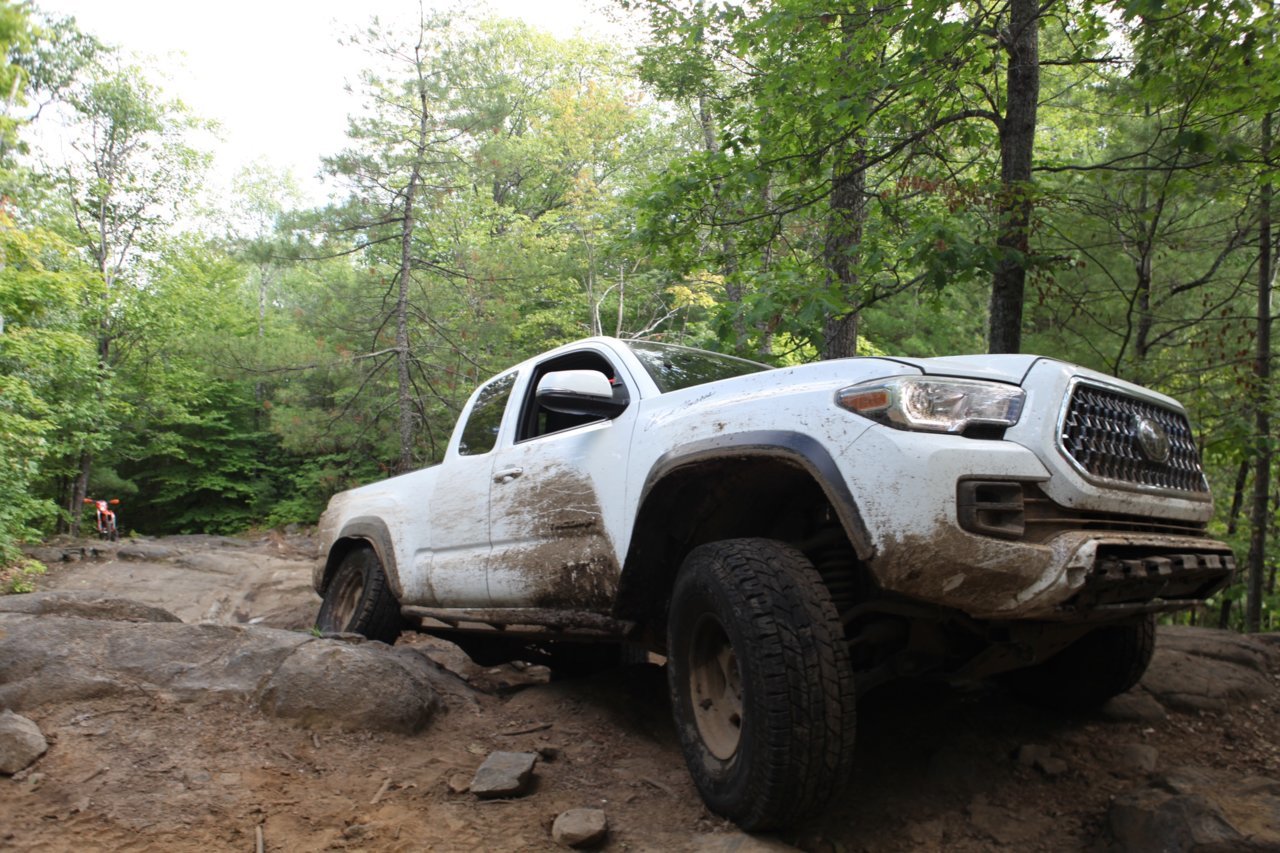

    :sawzall:
    I also plan on attaching rubber fenders (or whatever they are called to minimize spraying myself/others and giving a reason to get pulled over)
    Plenty of little things ahead!
    Surprisingly driving with MT stock gearing (4.30) ain’t bad at all.

    only thing i would suggest is getting some fend-x liners. it will keep your wheel wells clean. yeah its summer but i know in canada it does snow a bunch. I installed mine last october when it first started to snow in AK.

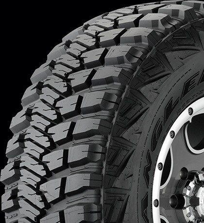

    Anybody try this tire yet? Its a tall skinny "35" 275-80r17. In all my research I never saw this tire before getting my 315s.

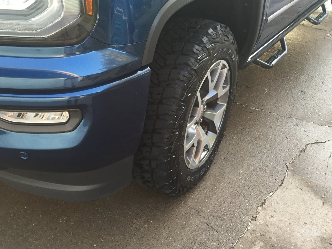

    I ran MTR on a Sierra here in MT. Had no issues great all around tire 275/65r20F62646C9-A47C-4E01-8AE5-3E4A6ACB83E1.jpg

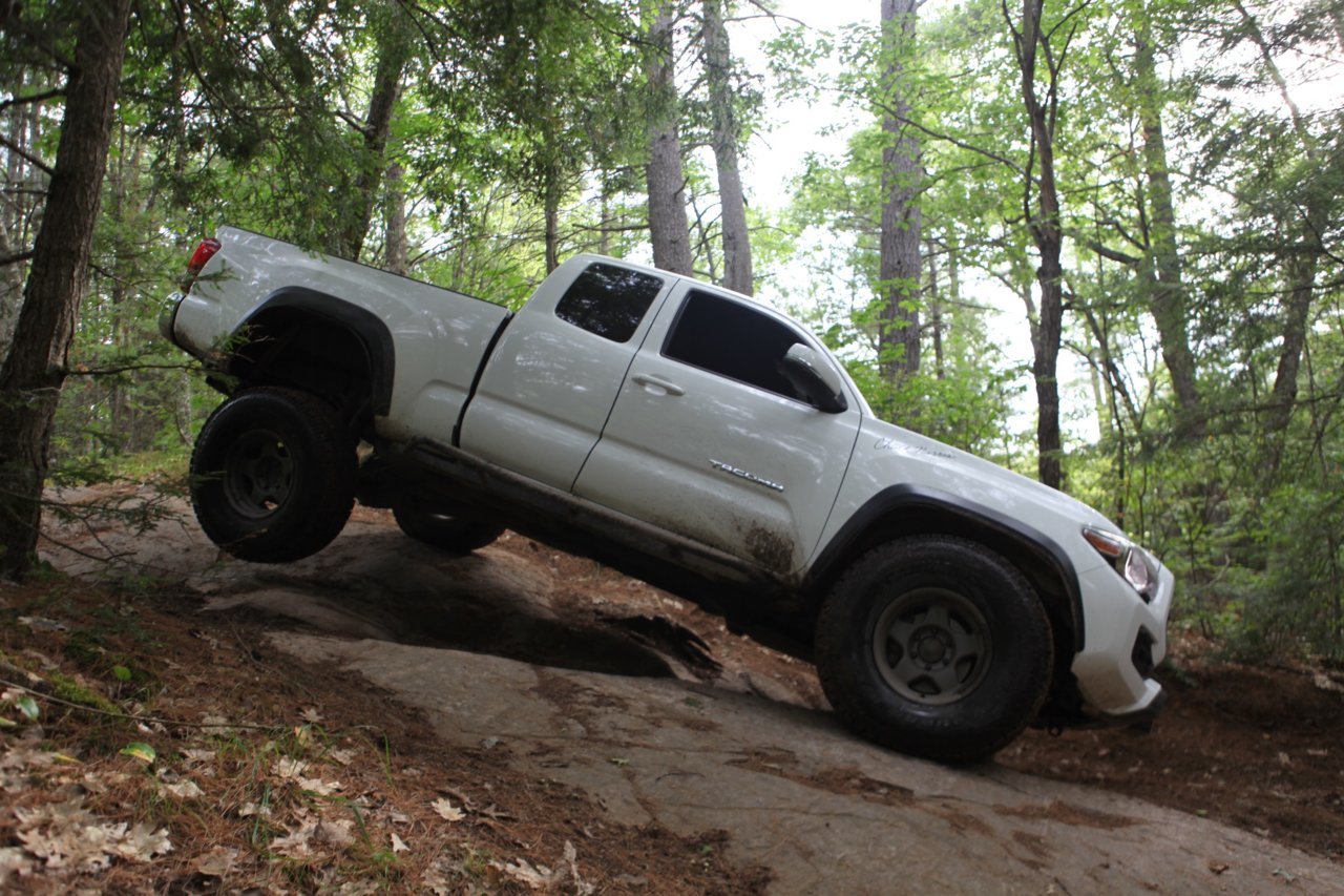

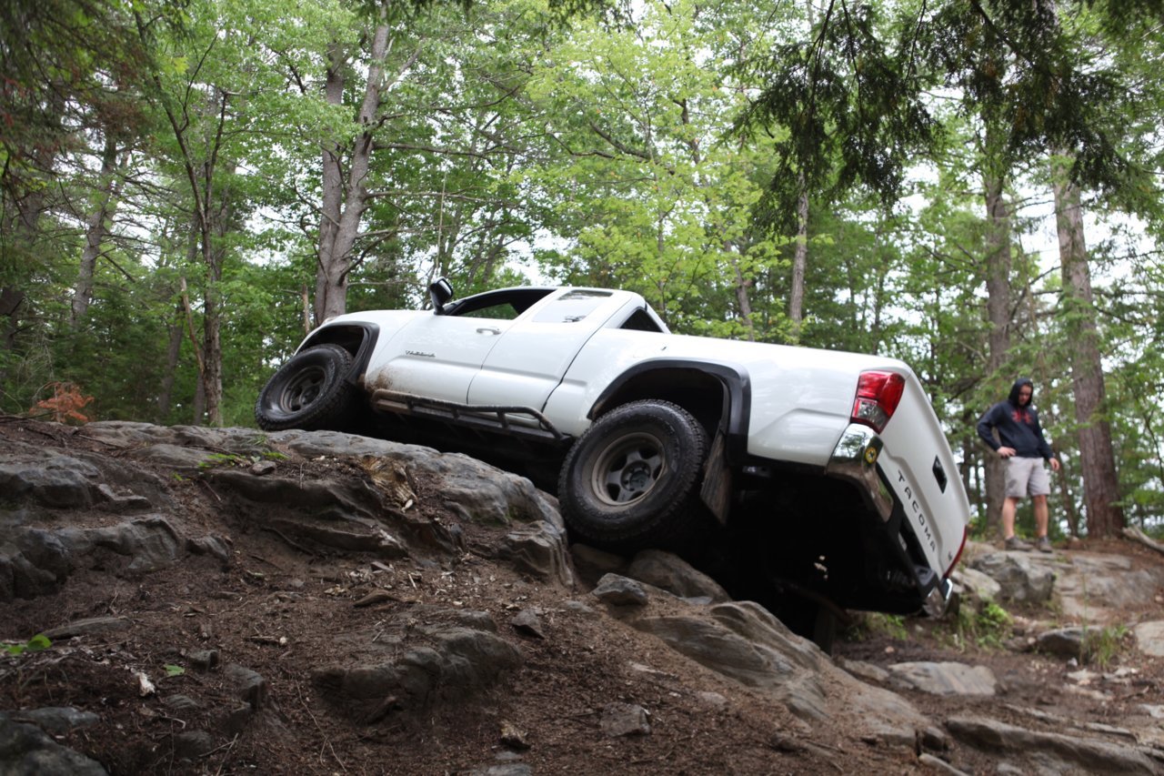

    35s feel small, I need 37s... /s:anonymous:

    Plans on armor in the future?

    for the front I am still waiting patiently for a Marlin’s bumper.... :censored:
    https://www.marlincrawler.com/armor/front-bumper/2016-tacoma-front-bumper
    bed is dented to a point of zero fucks given about rear past the cab.
    I still have to do cab mount relocation, replace my 1” lift at front with 2.5” and little things around.
    Also possibly rear disk conversion, this is second time I bent drum shoes and springs, they just don’t last with me:anonymous:

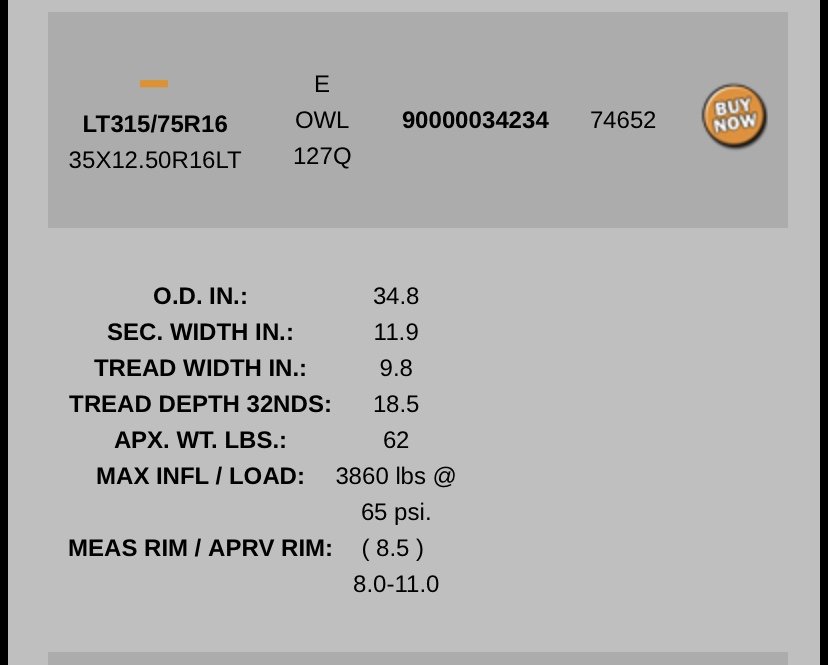

    Do you guys think I’ll be ok running a 35” tire with these specks and the stock Off-Road wheels? I know it’s a 7” wheel but the tire is only 11.9” wide so maybe it’s possible? Figured if I could I’d throw a spacer to clear until I can save up for some wheels with an 8” width.

    If the approved rim is 8” min I would not put it on a 7” rim.

    I was hoping it would suffice as a poor-man’s beadlock lol.

    It would be more likely to slip a bead the opposite direction

    Dam, I Need 2 new tires and figured I’d just jump to a 35 instead of buying 33s again. I was hoping the stock 7” wheel would hold me off a few paychecks lol. Oh well.

    I mean if you’re just gonna street it until you get different wheels you probably won’t have any problems

    Tyler from Tacoma3g has his on stock OR wheels.

    He does! I was talking to him and said it’s worked very well for him. There’s also someone on the 17pro wheels on that forum. So I will proceed with 35s on the stock wheel and see how it goes! lol. Time to start chopping everything off to make them fit!
