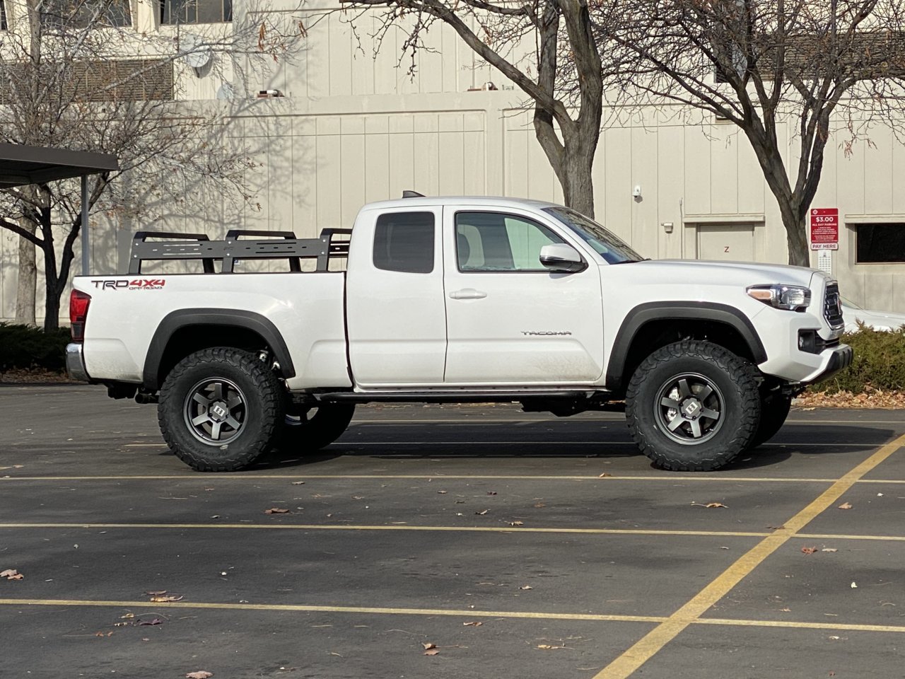

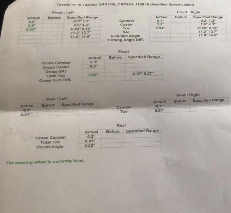

    I’ve got Camburg ball joint UCAs and here are my numbers with 1” lift up front, I had to trim 2” so far and there is still rub in reverse and at full lock on driver side. 3” lift coming next month, so I wonder what numbers i’ll get then.

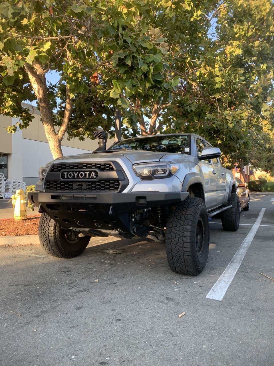

    I did a thing. Hopefully
    Moar clearance.

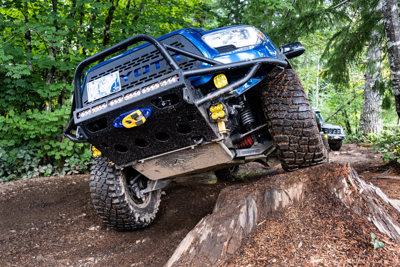

    :thumbsup:
    is that G-class behind you?

    Yap my buddy Kit. Fun times.

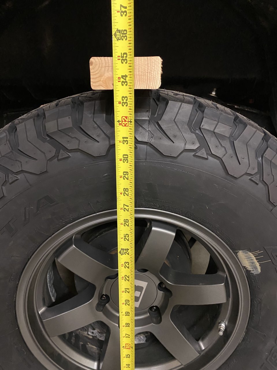

    Sorry for the bad photo. I read somewhere in this thread that a few of you installed Wheelers Super Bump stops. Did that eliminate rubbing on the fenders without cutting the fenders? So far I’m clearing everything else with CMC and trimming, probably because BFG KO2 tires are smaller diameter than most in a similar size.
    315/70r17 BFG KO2, 17x8 Level 8 wheels 0 offset, Bilstein 6112 on 5th setting.

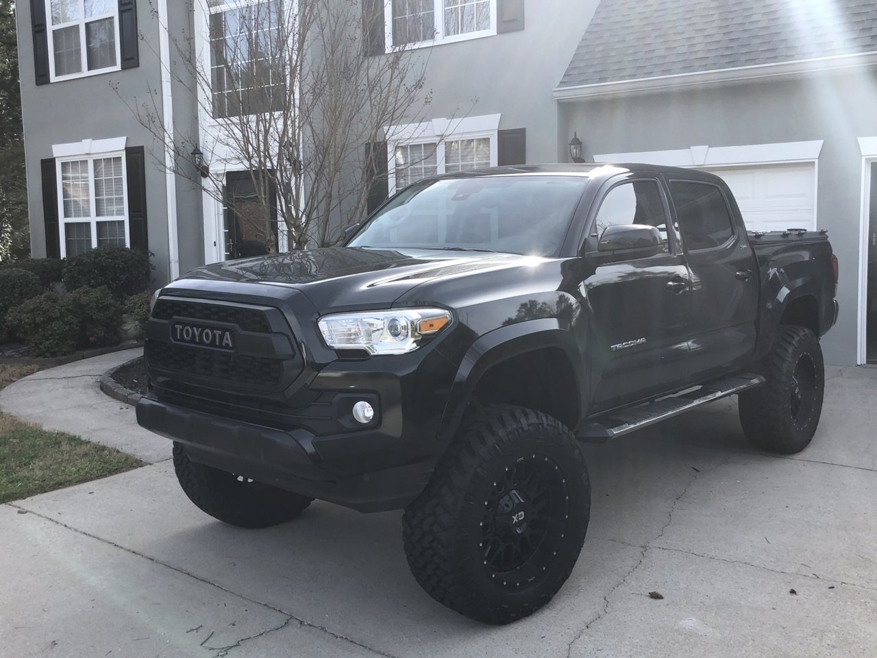

    Yo

    The super bumps did not help me with the rubbing issue. I still rub. Need a deeper cmc, I had cut mine originally for 33’s. The super bumps just helped from preventing bottoming out.

    Thanks for the answers. My CMC is clearing the tires, I was worried about bottoming out. I ordered the Wheelers bumpstops.
