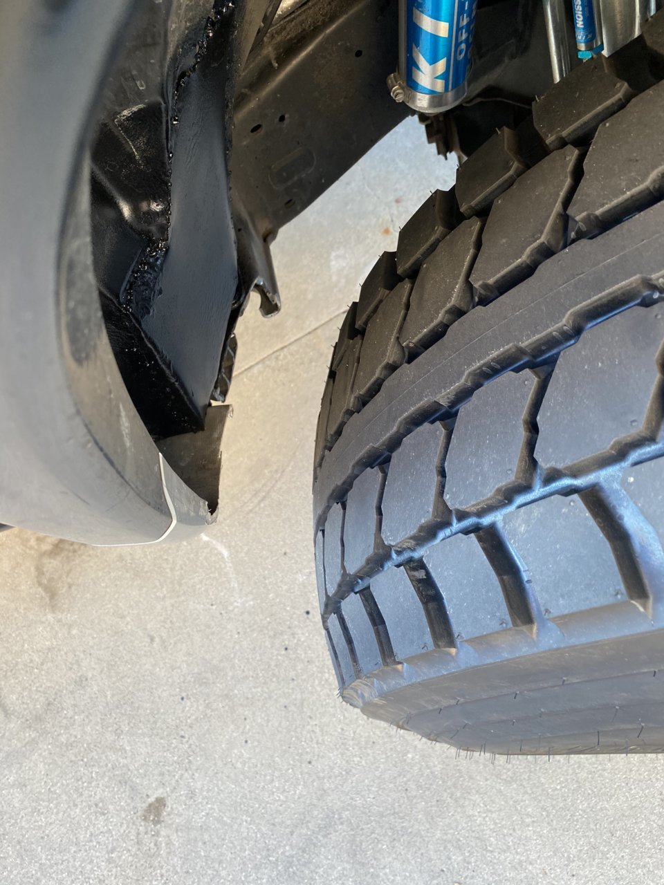

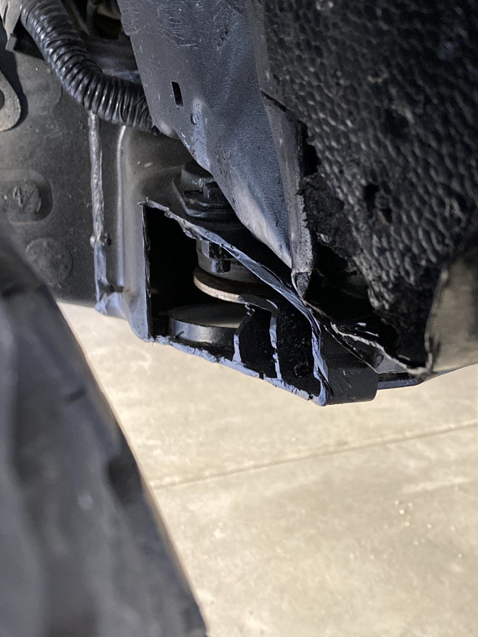

    Will do.
    I just did a big cmc. I don’t rub now after alignment.

    Nice that looks like the correct angle too. I had a shop do mine and they said they do them all the time. Come to find out they don’t and long story short they cut a lot but I still hit. So I am done messing with it and am going with the lil b relocation.

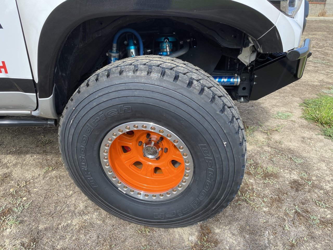

    47637E58-9CBD-48F1-85CA-B38614BADA7D.jpg Ok here is 37s with the wheel well moved backE9F19138-CB30-42D7-A597-7E18F3CEC2FC.jpg

    I take it you have LT? Doesn’t look like you had to tub too far back. Looks good though

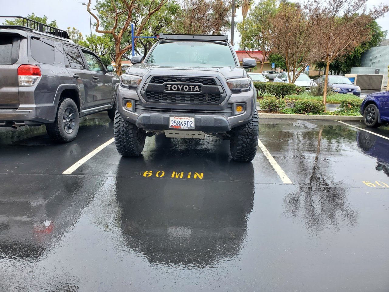

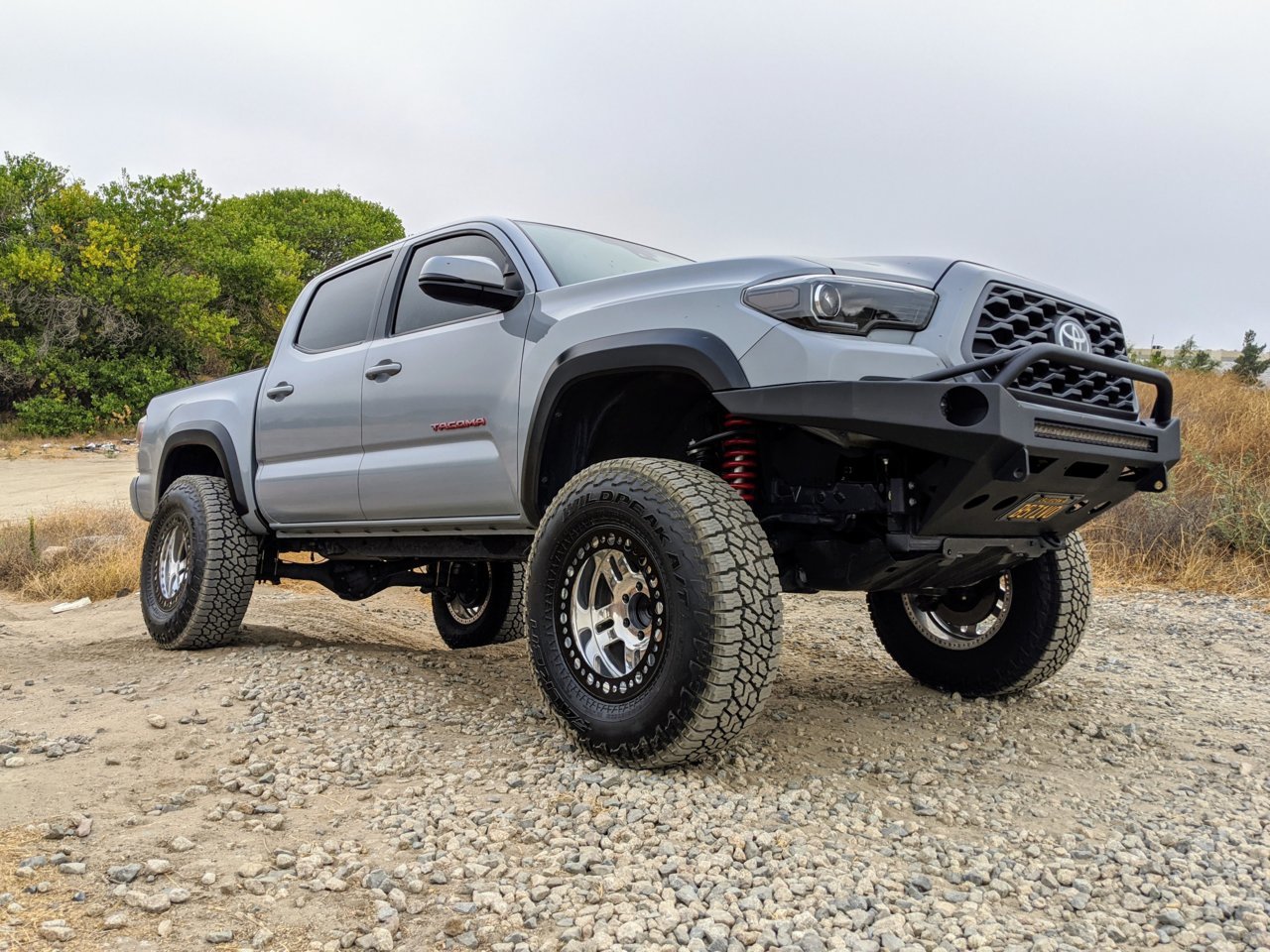

    35x11.5 r18 (285/75r18) on 18x9.5 -30mm. Barely rubs, little more fender liner and pinch weld and I'm in the clear.

    I didn’t even realize this was a common “35” size. I’ll have to check into them. I’m on skinny 33’s and would like some “skinny” 35s. Do you have more pics you’d be willing to share?

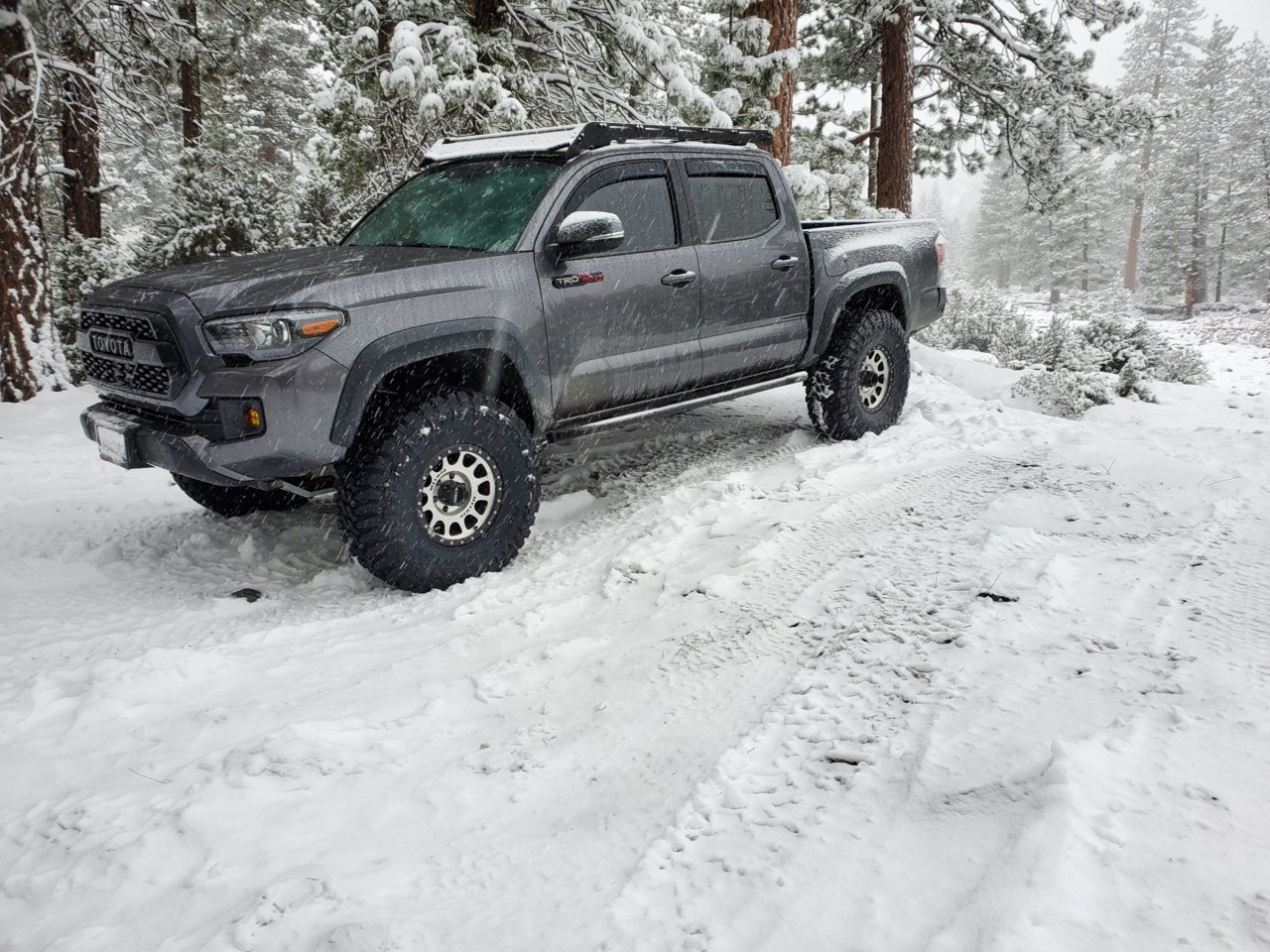

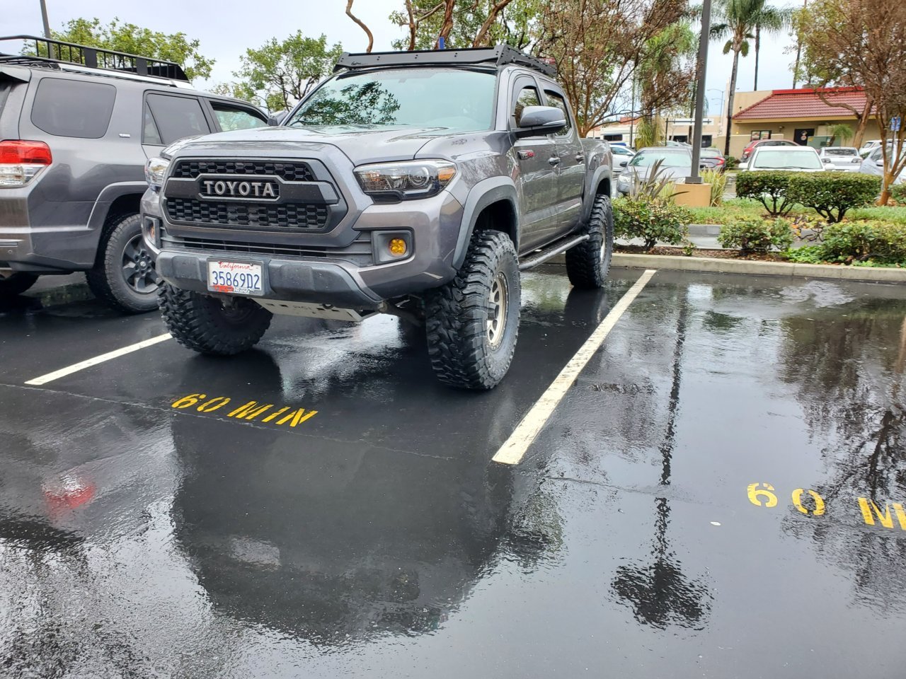

    Sure. I like them. Not as bubbly looking as the 315/12.50s, lighter, cheaper and way easier to stuff.
    FYI I had wheels powdercoated since.

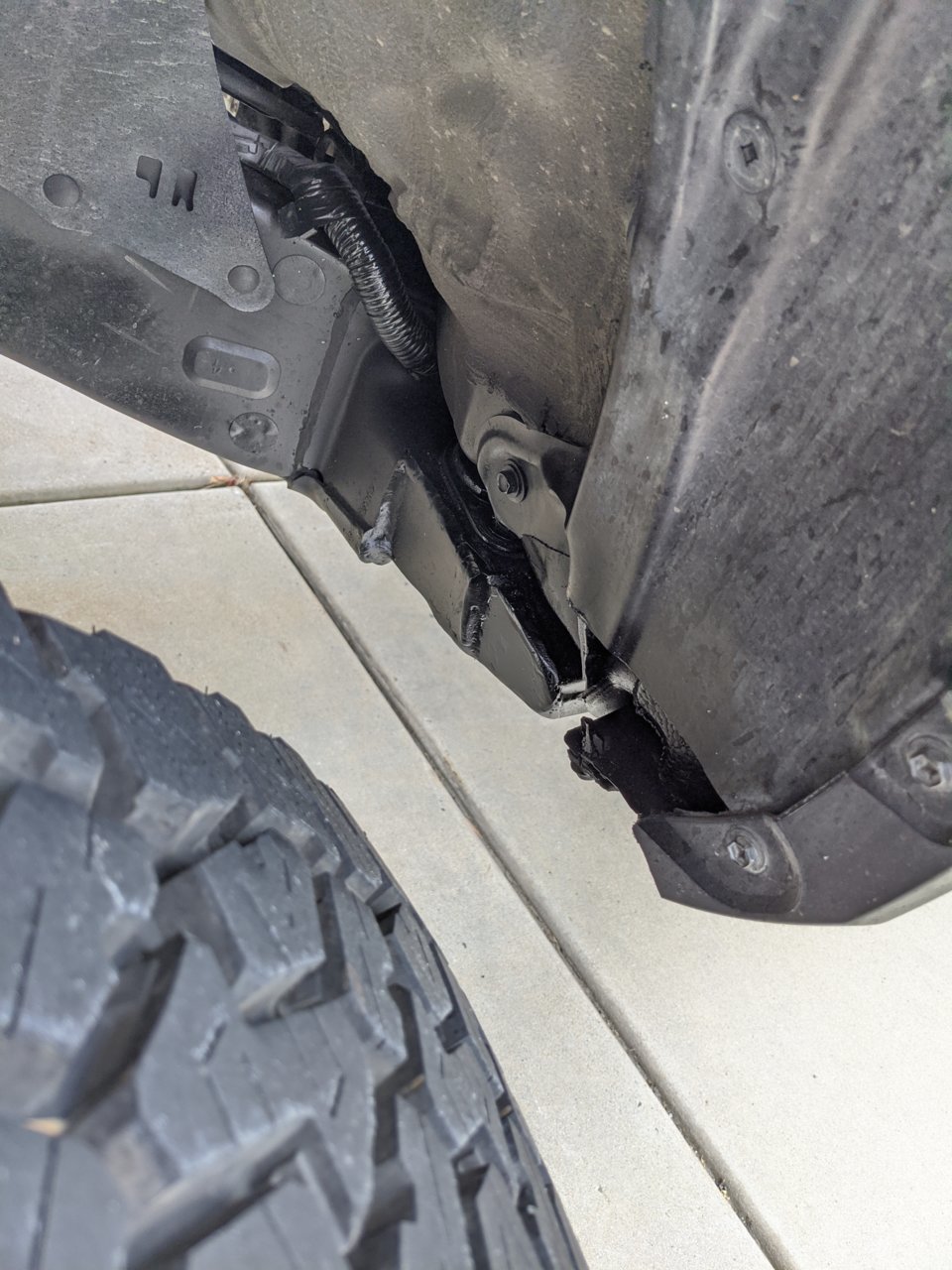

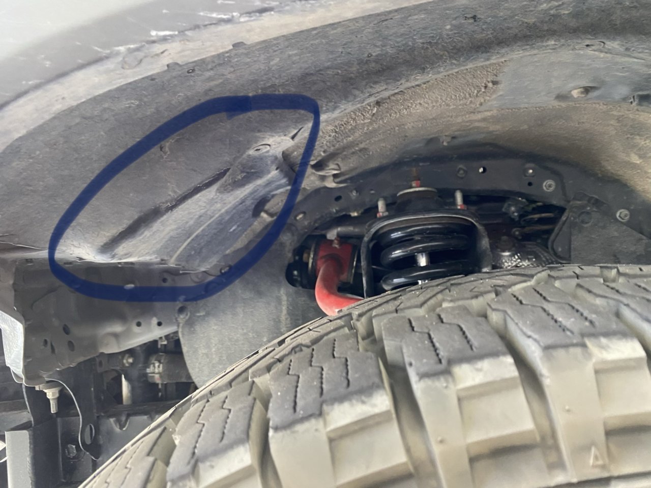

    Still rub here with 3/8” bumpstops
