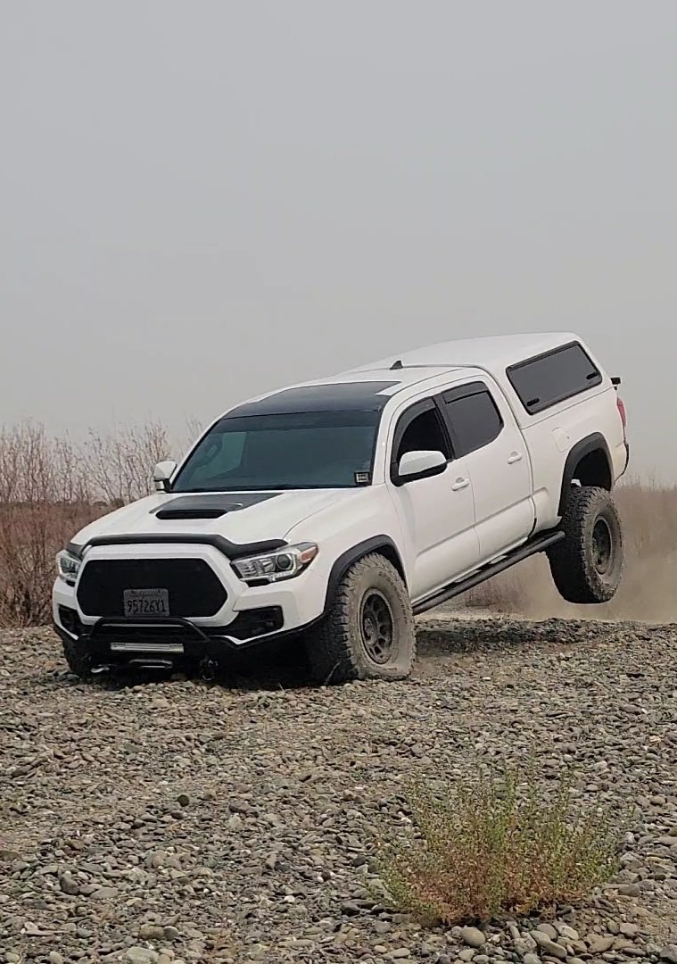

    Using every inch of avaliable room for my 35s. They do hit the upper inner fender. VideoCapture_20210807-181855.jpg VideoCapture_20210807-123600.jpg VideoCapture_20210807-181831.jpg

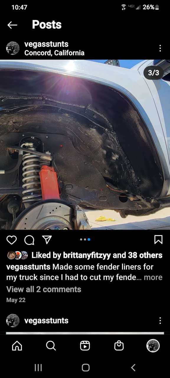

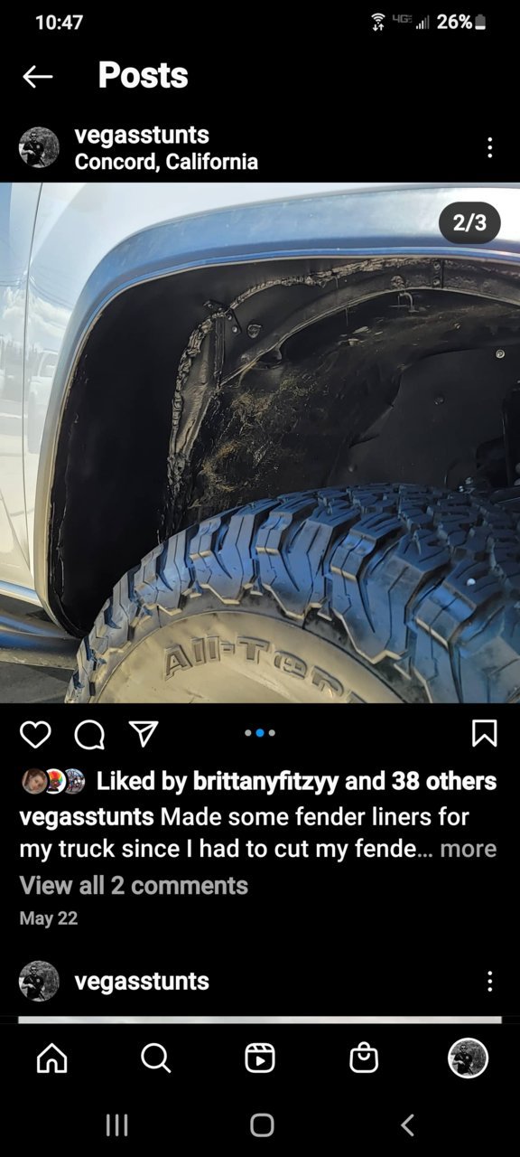

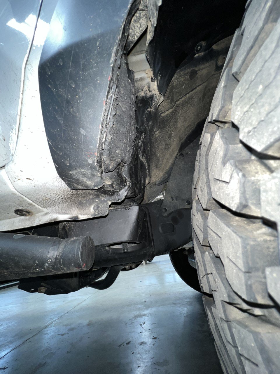

    I’m assuming most people in this thread have relocated their body mounts? Or is everyone rocking the obliterated stock mount like me and slightly rubbing?
    @Vegasstunts I've seen a lot of people doing the flare trim lately but nobody around Pittsburgh seems comfortable with giving it a shot haha. Any words of wisdom? I’d really like to keep the liners or replace them with aftermarket after the trim. Been looking around for a thread dedicated to 3rd gens with cut fenders/flares

    I had to make my own inner fenders. Wasn't to hard. Just time consuming. Screenshot_20211223-224740_Instagram.jpg Screenshot_20211223-224744_Instagram.jpg

    Just a cmc for me, but I have my LCAs pushed all the way forward to where I needed to trim my high clearance CBI front bumper. It only rubs a tiny bit at full stuff and lock on my passenger cab mount, but when I move the wheel forward even more from my UCA it should eliminate that (means more trimming of the bumper though).

    I relocated the cab mount after a chop and am still rubbing the firewall/wheel well. Already hammered it back about 1.5", I'll probably hammer it back more after the winter.

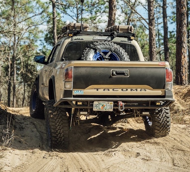

    What rear bumper is that

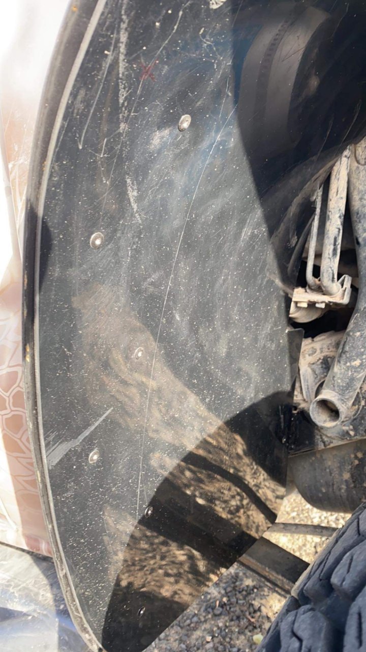

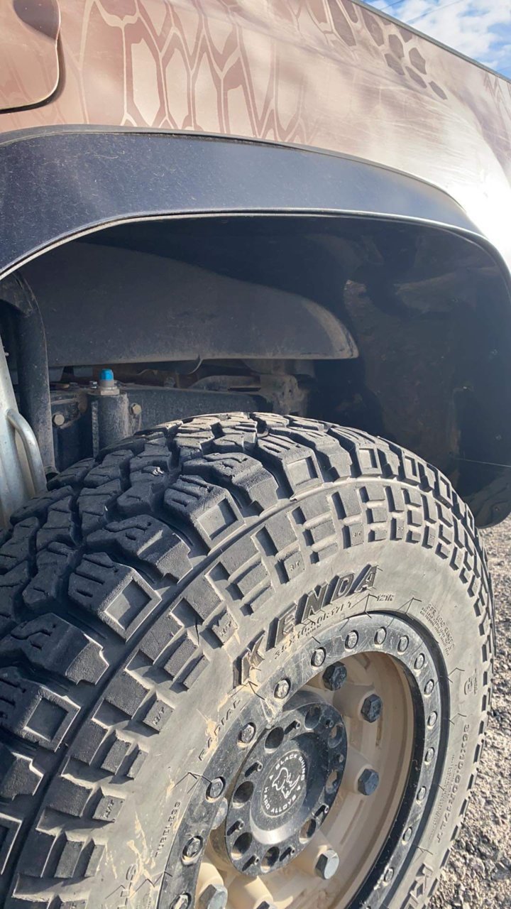

    Kends 35's which are a smallish 35. Cab mount relocate. Fenders cut up ~2.5" and then custom 12ga flares to add about 2" of coverage to help with rock/mud throwing. Custom heavy poly inner fenders
