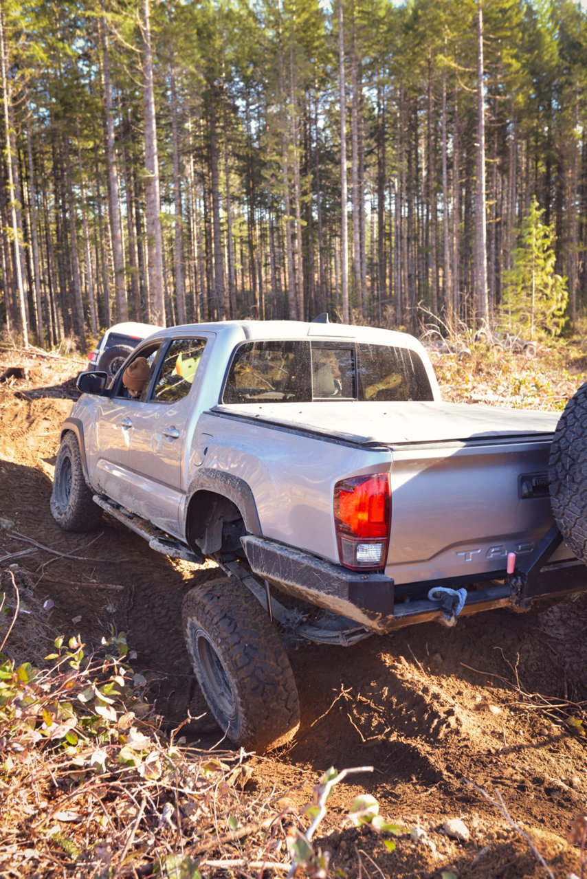

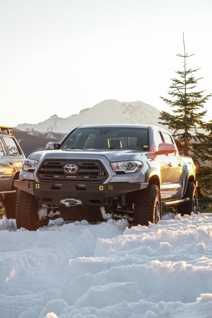

    Latest pics since getting my fenders trimmed by @greenEFSI
    Zero rub now.

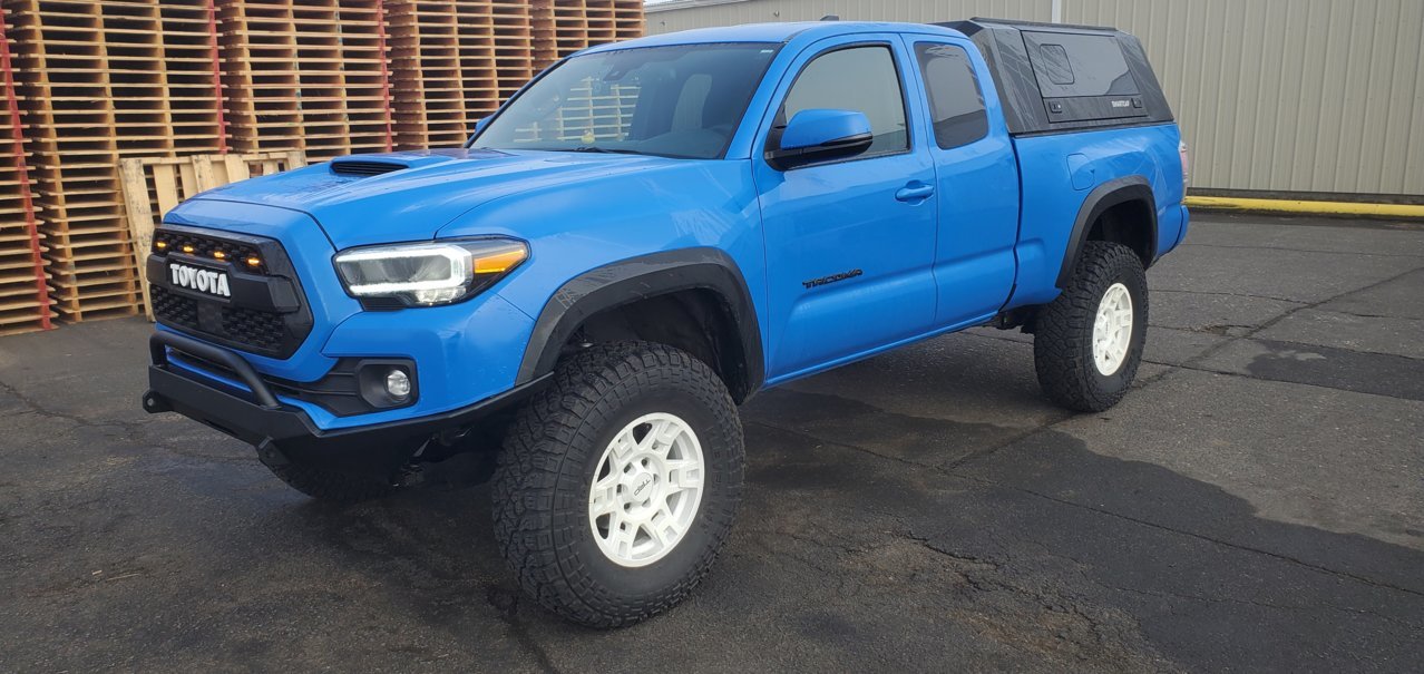

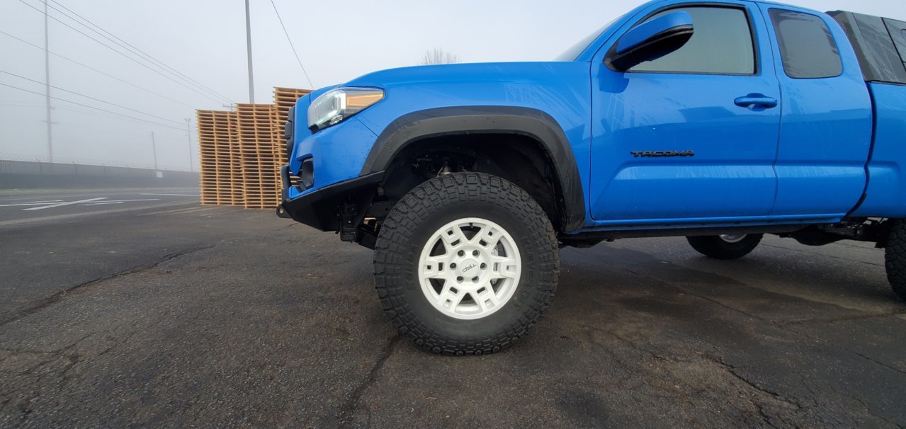

    My pavement princess in her natural habitat.

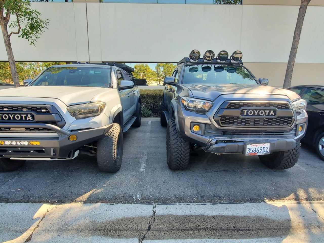

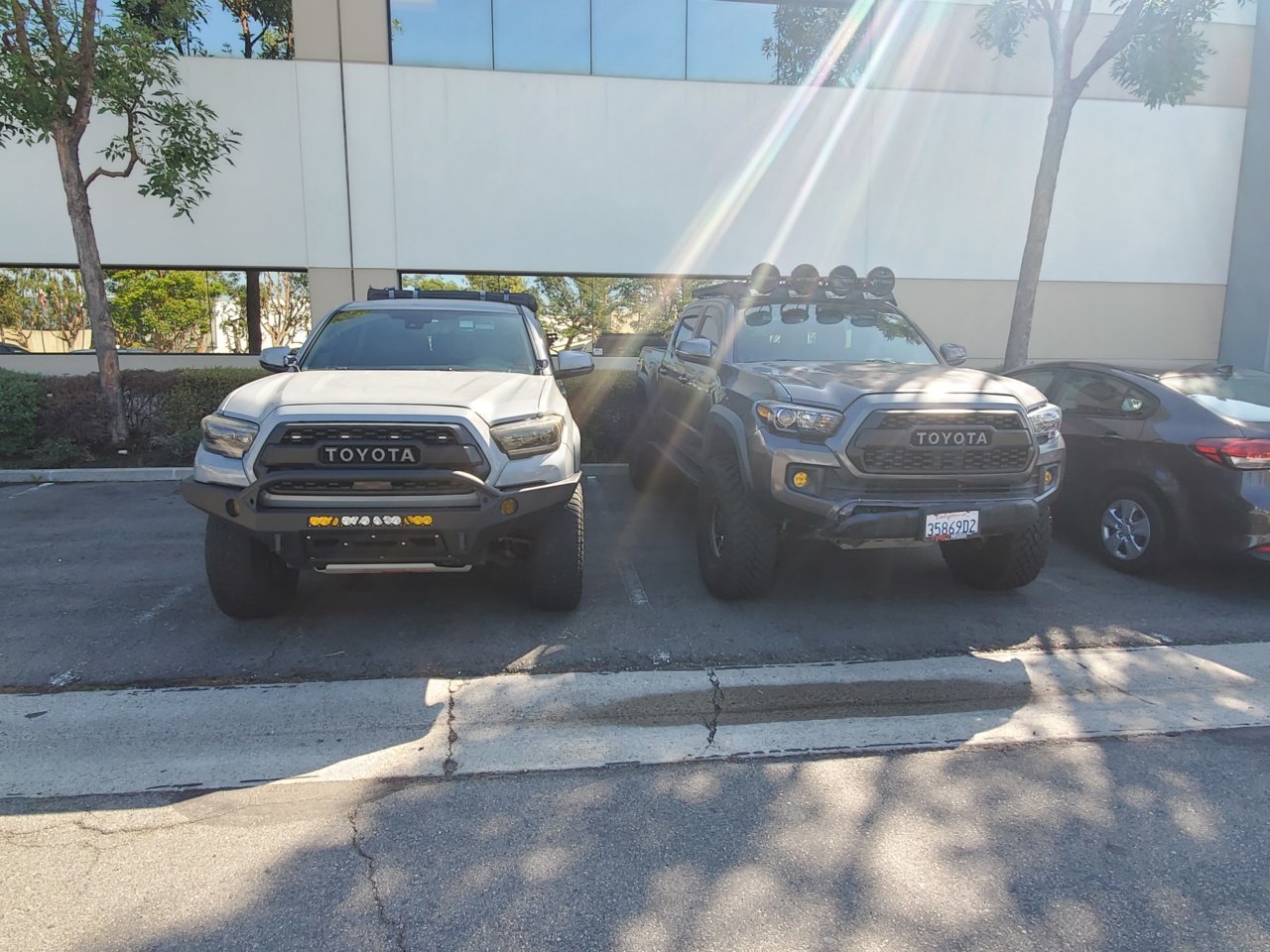

    2.5 Kings w/resi Adj. Total Chaos Upper control arms. IG: Cement_runner23
    35s is where its at :drool:

    Damn we have an almost exact suspension set up!
    Whereabouts in socal are you man?
    Going to Gorman later today.

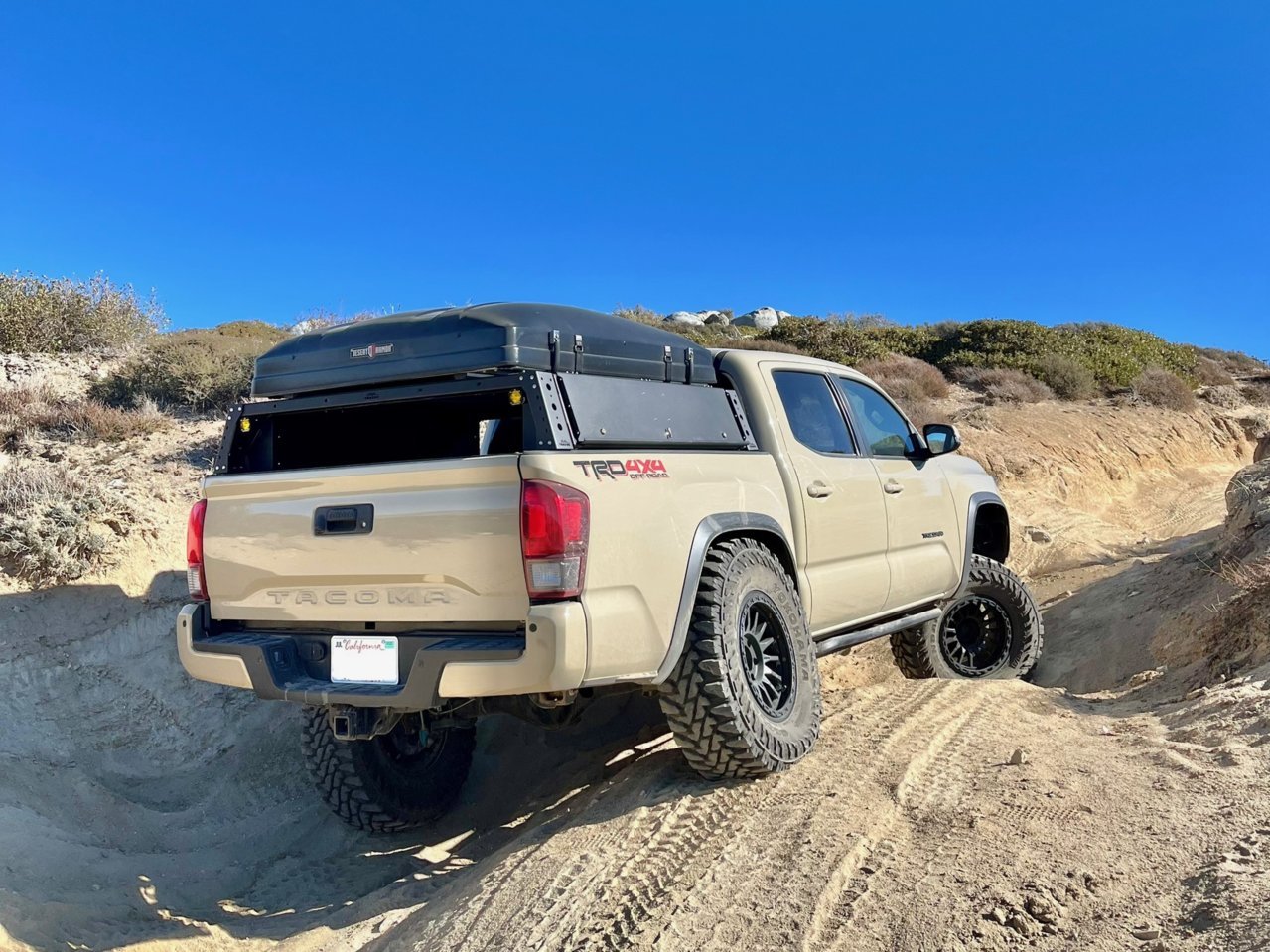

    Extended 12" Kings in the rear?
    Either way, that flex looks awesome :D

    Just regular ol' extended travel Kings in back. I'll eventually go 14" with relocated mounts and +2 LT up front, but it's pretty capable already.

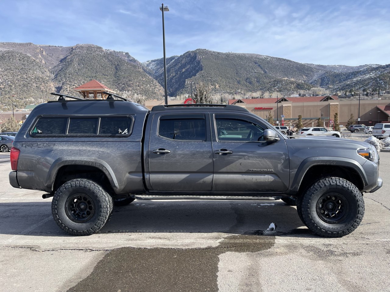

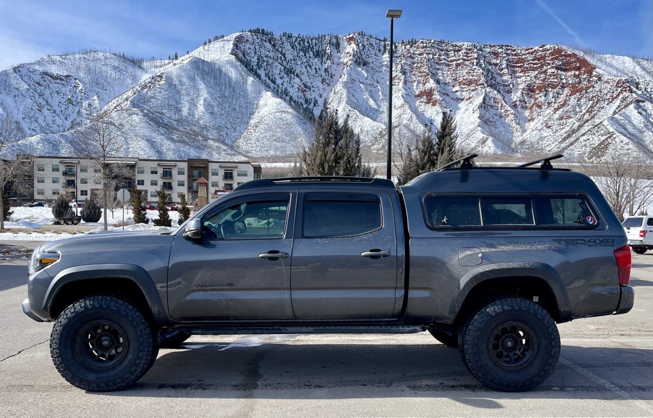

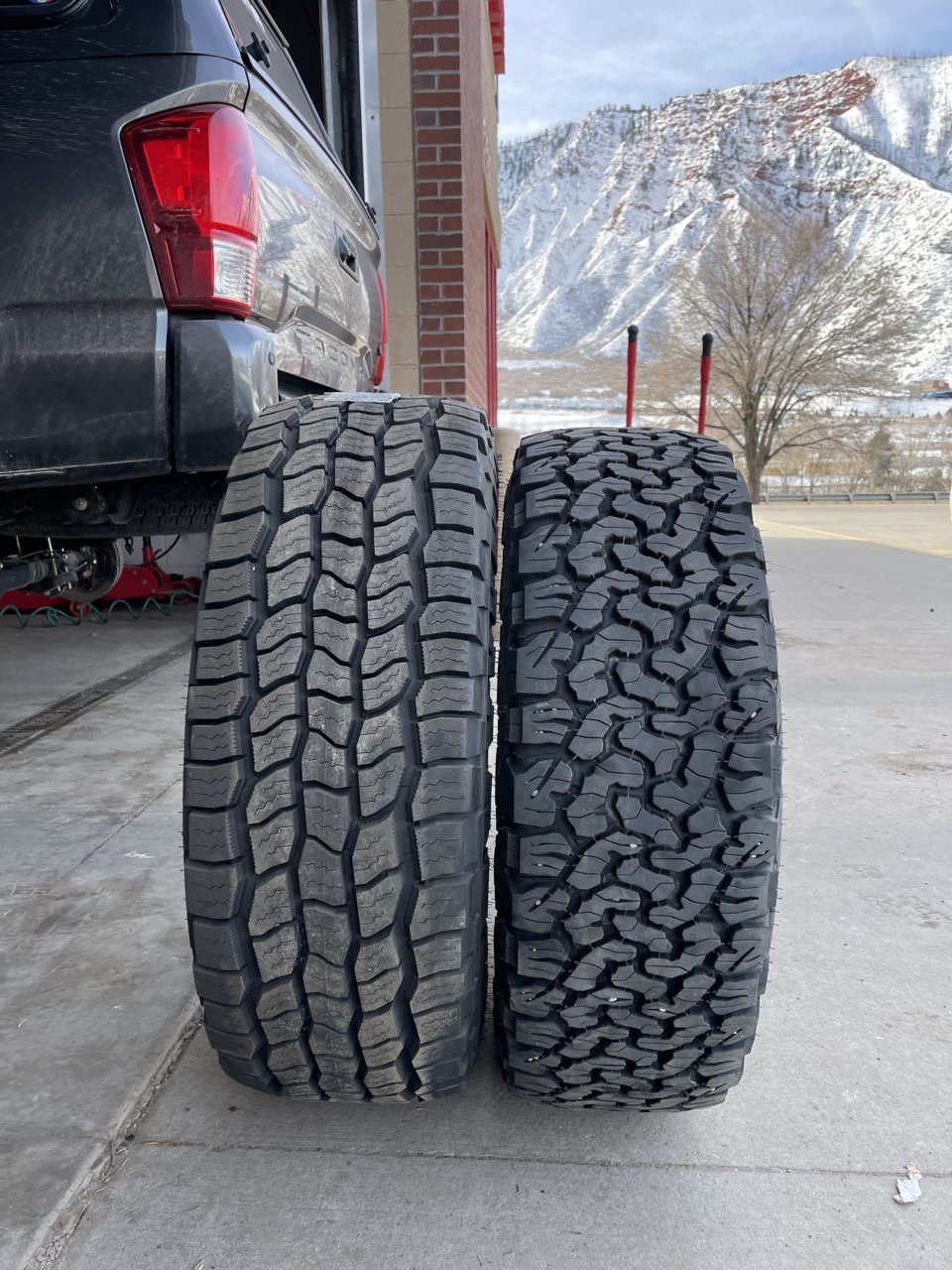

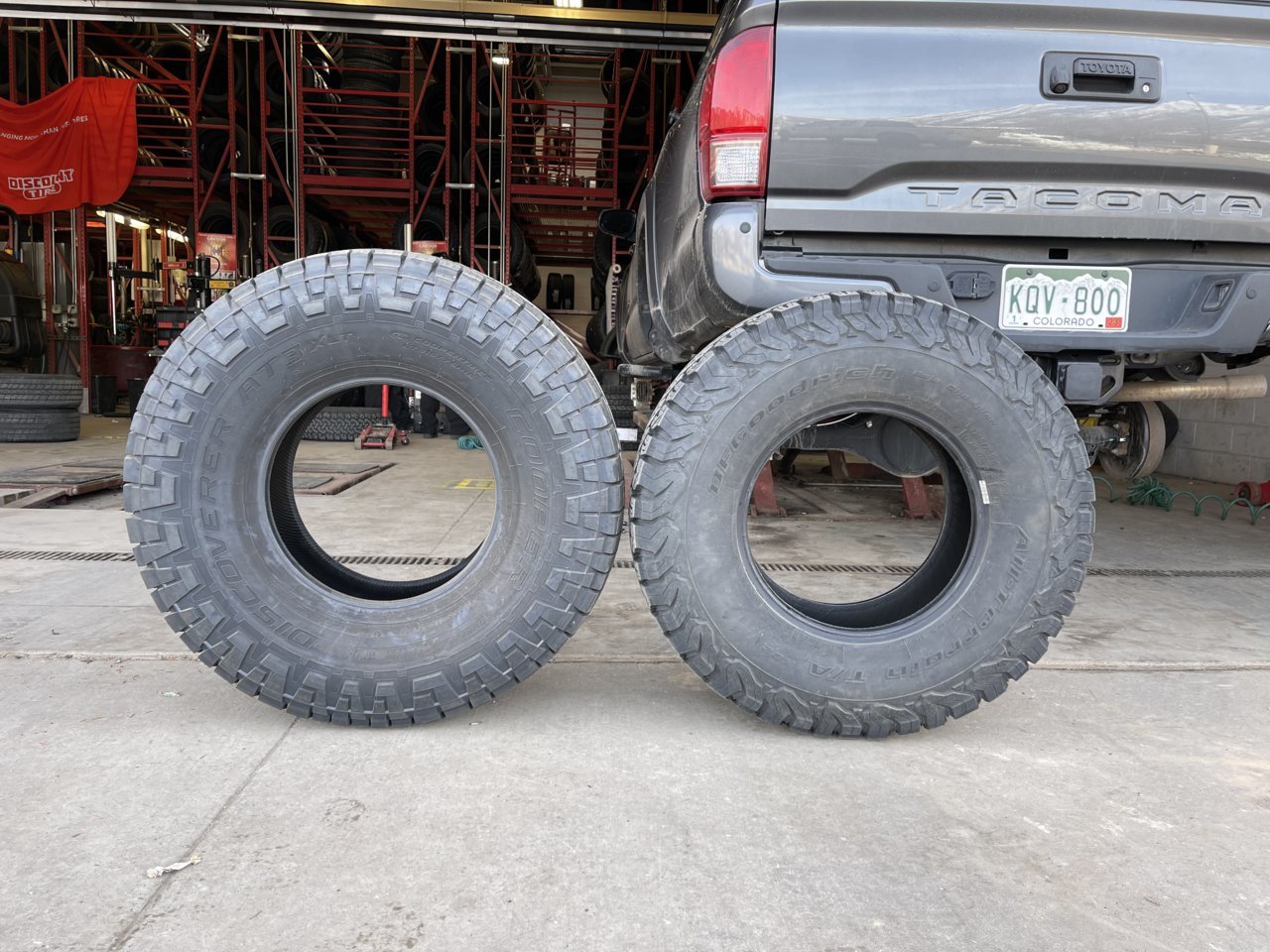

    285/75R16 to 315/75R16 4453B5F9-44F1-4C2A-ABE9-29C3BF0F2833.jpg 522A8EF3-00CF-4C39-B21B-20D236CA1D19.jpg D4B96D65-3D5A-4695-B36D-189AA1D6EFE2.jpg BA821054-8C5A-4130-9211-61C8F1154342.jpg
