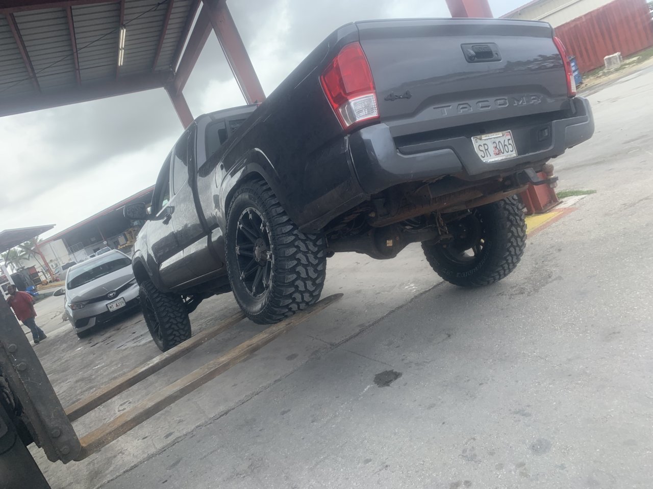

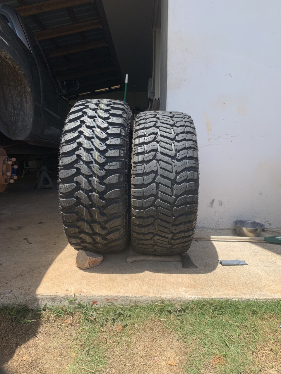

    2016 Tacoma Sr5
    35x12.5r20 vs 305/55r2066B1267C-F328-42AE-ACFE-567CFC4262E1.jpg2D0A1874-47B6-4FE2-A21F-95144C8D081E.jpg

    :eek::eek::eek: 20s!!!

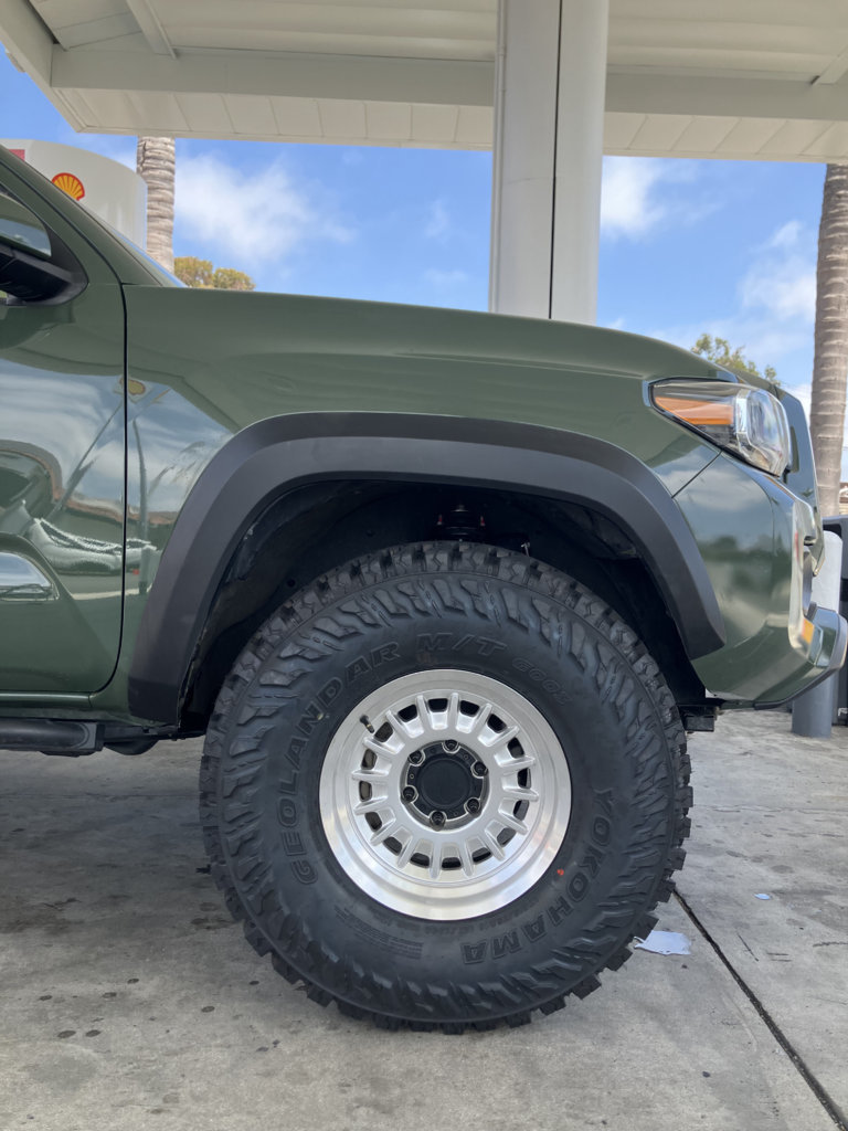

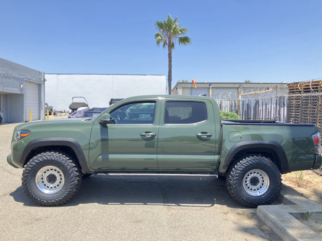

    2022 Army Green Tacoma TRD Off Road
    With 0 offset wheels I am not rubbing the fender flares but unfortunately at full compression I am rubbing the top of the inner fenders. I was wondering if anyone has experience with resolving this? I want to avoid tubbing or cutting out the whole inner fenders and replacing them with the JD Fabrication option. I was wondering if something as slight as a 1/4" spacer on the duro bump stop would resolve this? I would hate to limit my up travel but it seems I have no option.

    Haha I agree with you! I love the look of a meaty sidewall. 35 inch tires and 16 inch rim is a match made in heaven.

    Beat it with a sledgehammer until it no longer rubs. 1/4" spacer probably won't cut it.
