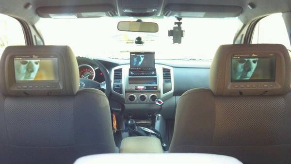

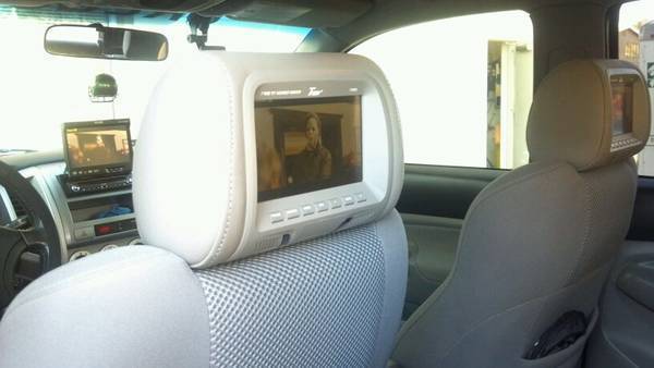

    what kind of headrest monitors do you have? they look great!

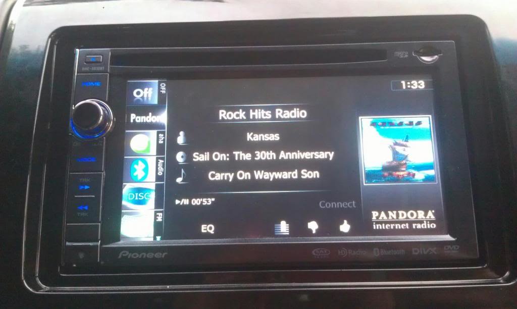

    Updated my Pioneer X930BT to the newer firmware on the X940BT today and gained new maps, AND native Pandora Radio functions via my bluetooth connected Android :) I love this radio!

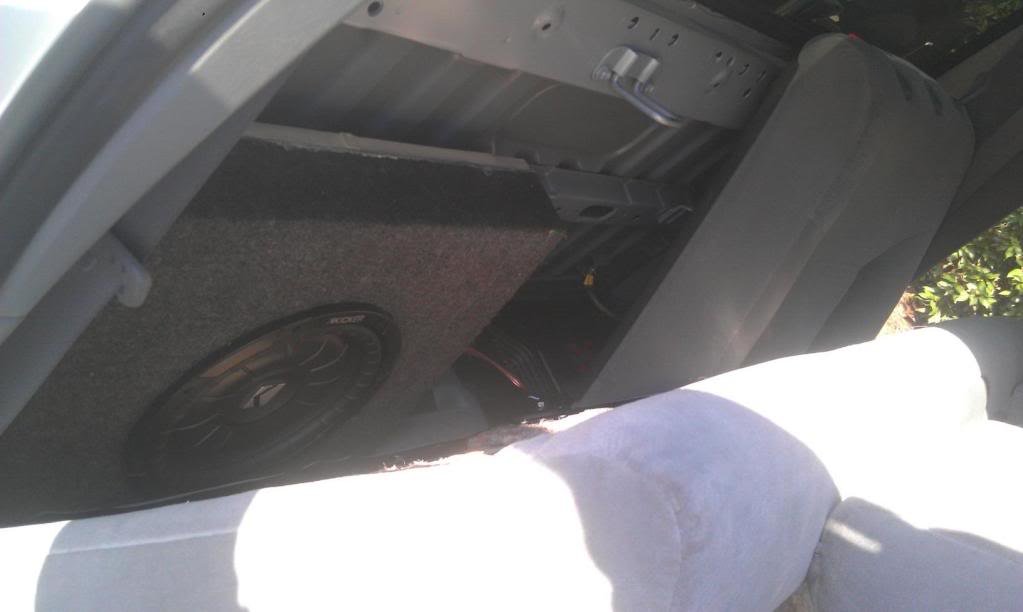

    After that I pulled my sub box out from behind my rear seat. It's been making a horrible noise, like the sub was bottoming out... So I pulled the sub out of the box to take a look and see if I could see anything physically wrong with it. The sub looked fine, but upon inspecting the box I noticed that I had literally blown it apart!!! The Kicker CVT 10" in it moved so much air it popped the back of the box completely off on one side despite the staples and glue the box was put together with... So I ran some 2" screws into it and resealed it, put the sub back in it and reinstalled it into the truck, and I'm SO glad that's all it was and not a blown $80 speaker, LOL. Sounds AMAZING again!

    How does the garmin based navi work on your pioneer unit? Is it similar to the portable gps units? I have read you now have to pull over to input navi choices?? Im trying to decide on a replacement for my factory hu in my 08. Time to get out of the stone age and get some good sounding tunes! Been looking at the Pioneers and Kenwoods because they both use garmin navi data.

    Actually, the navigation in the X series like I have is Navteq, not Garmin. Before I had this unit (or the Pioneer D3 before it), I was using a stand alone Garmin GPS unit, and I really came to like the Garmin navigation, but this Navteq power navigation seems to perform equally well. In my opinion, better than having to use a cell phone's GPS via Google Maps or something. Use to always piss me off so bad because I would be trying to use the GPS on my phone going somewhere where I've never been, and right when I get to a point where I have to make a lot of turns onto roads, someone calls me and I get lost...
    If installed by the book, they don't allow you to mess with he navigation while driving, nor do they let you play a DVD unless the vehicle is in park... However, with Pioneer units, it's EXTREMELY easy to bypass for FREE just by moving a wire in the harness and grounding it.
    If you go with Pioneer, check out the AVIC411 forum; TONS of helpful info in there about pretty much any Pioneer double din radio, as well as how-to's on hacking and modifying them

    What flip-up head unit is this?

    It's a VALOR....I went cheap because I kind of went past the days of having $4000 systems in my rigs...:D
    Valor ITS-703W - I got it for $155.00...been working excellent for 5 years though ;)
    I miss my expensive loud as hell systems but with kids now, i have to wait until I get extra cashola for me then I will build it up:cool:

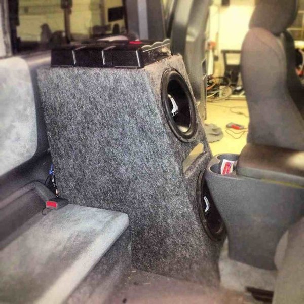

    Access cab sub box I built. Two 10 inch JL's. 760 watt amp. Fun fun

    dammm... is the box ported? is the amps below the window line how much power? full setup break down and where did you get the seats?? I wanted to do something exactly like this but settled for a box and not a custom mold.

    The box is ported through the center console. And I'm not exactly sure on everything that is in there. All I know is you can't breathe in there and it turns quite a few heads! If you want answers to your questions you can contact my brother on his instagram @onthegoaudio He can answer any question about this truck. I'm just whoring some pictures around for him.
