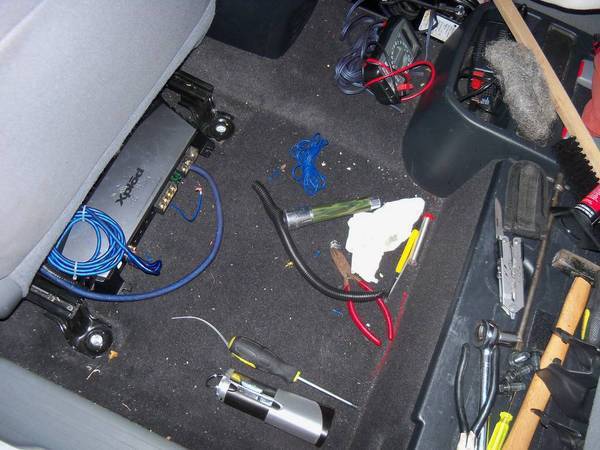

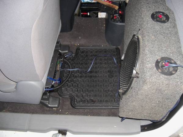

    Decided to upgrade my stereo with equipment I had in ye old chevy blazzer. Had this hooked to a 12 inch JL in a ported 1.5 X 2 foot box. This old setup would pound very nicely, disturbing the peace style if one was so inclined.
    This time I use a 10 inch Cerwin in truck box.
    A bluetooth deck, and mono amplifier 330 watts...

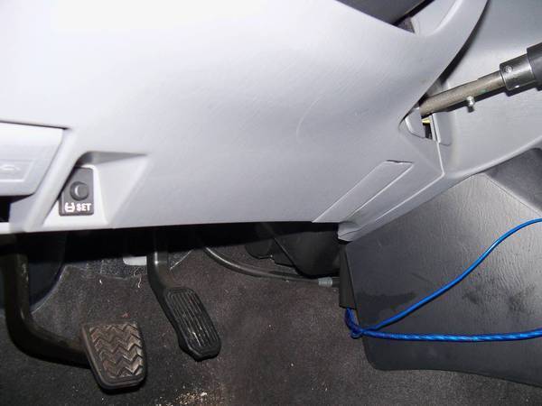

    Ran the power through the boot nearest to battery. Then along center console with the remote and RCA stereo. No line noise when running system:bananadance::bananadance: yes!
    Removed the seat to fit the amp in, snug as a bug. Grounded to the seat bolt.
    Used an old Cerwin 10 inch in a ported truck box. I am 5'11, when i put seat in proper position this hardware is hidden.
