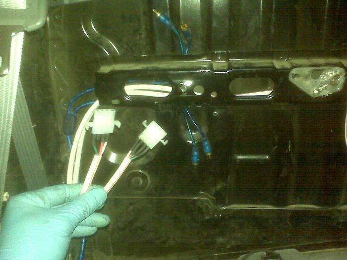

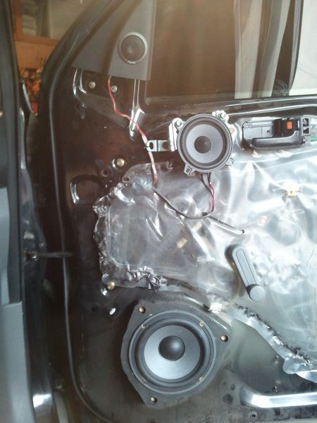

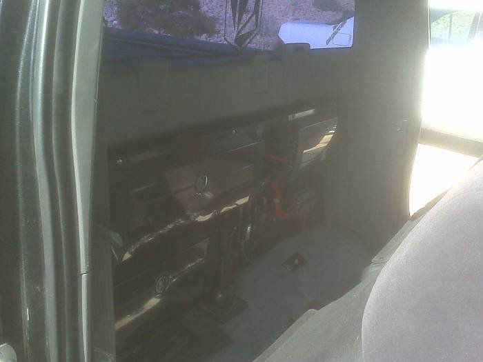

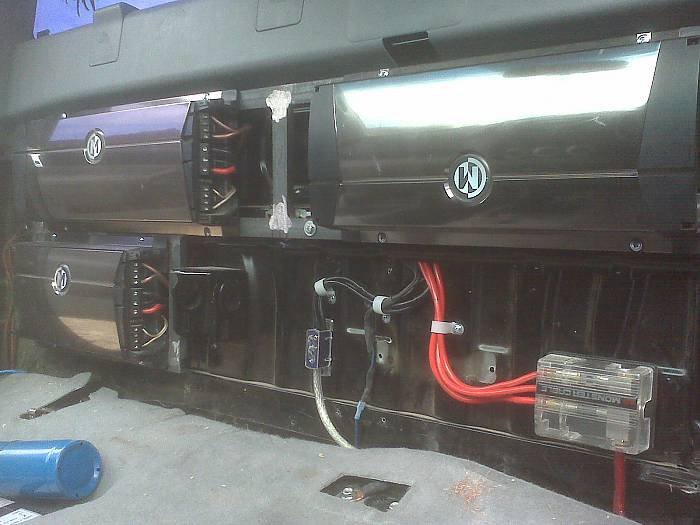

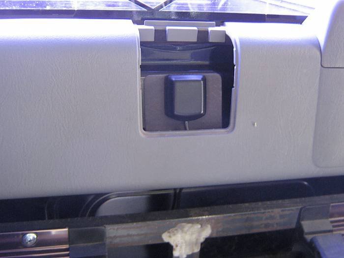

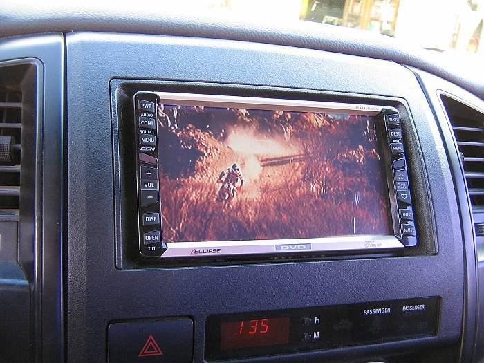

    Dont know if I posted up in here or not with my install, have had the amps since 2006 and the Eclipse since 2009, the rest I have acquired along the way.
    Headunit:
    Eclipse AVN-6600 GPS/DVD w/ Ipod in glovebox
    Speakers:
    Focal Polymer 3-ways
    Sub:
    Polk DB SVC 10" sealed box
    Amps:
    1) Memphis 300 runs the mids and highs bi mono to exclude lows and tuned at the amp
    2) Memphis 200 runs the lows bi mono to exclude highs tuned at the amp
    3) Memphis 1100 runs the Polk DB SVC
    Wiring:
    Monster 4 channel
    Monster 2 channel
    4-14ga for the lows/mids
    2-14ga for the highs
    2- 8ga for the sub
    4ga from the bat
    8ga from splitters to amps
    connectors to line lows/mids separately at amp locations
