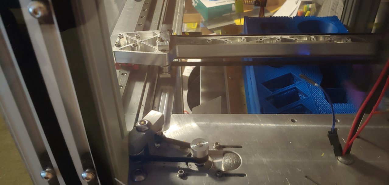

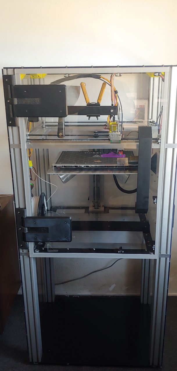

    2008taco
    2008taco Well-Known Member
    Mar 4, 2011
    #52323
    2,831
    chris
    san diego
    The top half is 0.1mm. The bottom half is 0.2mm. Print time is looking like 60 hours at 250mm/s.

    #190
    2008taco
    Mar 4, 2011
    #52323
    2,831
    chris
    san diego
    I couldn't find a machine that met my requirements. The reliability of Chinese printers takes drastic hits when you go large. So I designed my own. Bertha is 250 lbs of cnc machined beauty.

  13. Jul 19, 2020 at 8:22 PM
    #193
    2008taco
    Mar 4, 2011
    #52323
    2,831
    chris
    san diego
    There is not one thing I can point to. It is an accumulation of many things. Weight in and of it's self is a really big one. With the exception of the extrusions in the corners, the rest of the frame is solid 3/4" thick aluminum. Machined flat to within 0.0005". It is assembled 100% metal on metal. 0 plastic gussets/brackets in the frame or motion system. The idler pulleys ride on shafts held in precision reamed holes so they will never move. All the axis move on linear rails. The cross bar is a precision machined cross bar. That's just the big things, I could go on and on and on about all the little things. Quality pulleys, belts, motors, electronics. They all add up to big results. Eventually I'll throw a bowden setup in her and see what she is really capable of. That will probably wait until the tool changer though.

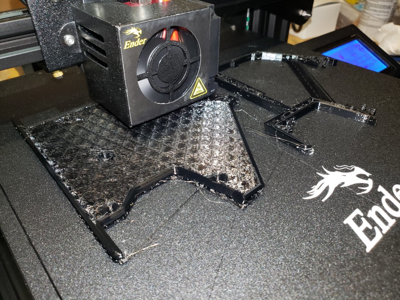

    Sorry for n00b spam, but this is the only forum or type of social media I use.
    I got an Ender 3 Pro the other week, then got it assembled and working well with PLA. So far so good...
    But switching to PETG is going really poorly. I keep trying different temperatures and print conditions, but I'm getting stringy prints where it doesn't look like enough material is being extruded. Even the top and bottom layers appear porous, like a lattice instead of a solid plane. The sidewalls are printing okay, but aren't properly connected to the infill, or to the top and bottom layers. I'm also fighting poor adhesion, poor strength (vs. PLA), and the printer randomly developing an offset partway up each print. It seems like the main problem is that my printer isn't extruding enough PETG per volume of the print, and I can't figure out how to change that.
    Do any of you have suggestions for improving this type of behavior? For what it's worth: I have already swept reasonable temperatures (225-245) and print rates (20-60 mm/s). Next up will be trying again with the fan completely off. I am using Cura to generate the gcode.

    2008taco
    Mar 4, 2011
    #52323
    2,831
    chris
    san diego
    More cooling fan, more infill, and from there I would increase extrusion multiplier. multiplier differs between types and brands of filaments.

    jowybyo
    jowybyo Well-Known Member
    Nov 19, 2013
    #116863
    6,092
    Joe
    Baltimore, MD
    '14 MGM DCSB Postrunner 4wd Conversion, Debadged
    I use 0% cooling when I print PETG. You probably need to calibrate your extruder. When I went from PLA to PETG, my extruder steps needed to be adjusted a lot.

    mk5
    mk5 Asshat who reads books
    Mar 15, 2018
    #247373
    1,504
    SoCal
    '05 access cab 4x4
    Thanks guys! "Extrusion multiplier" is exactly what I was trying to describe. I think it's called "Flow" in Cura. I'm going to try a new run at 120% flow.
    Is guess-and-check the correct way to calibrate the extruder, or is there a more formal process?

    2008taco
    Mar 4, 2011
    #52323
    2,831
    chris
    san diego
    Measure 100mm from the end of the Bowden tube, mark filament with a sharpie, extrude 10mm. From there you can measure what didn't get extruded and do math, or guess and check until it is correct.
