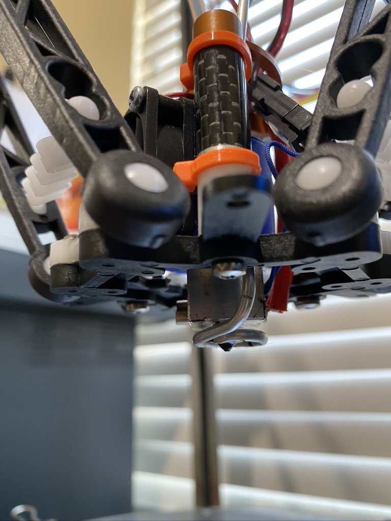

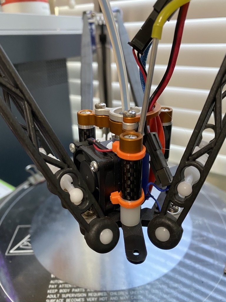

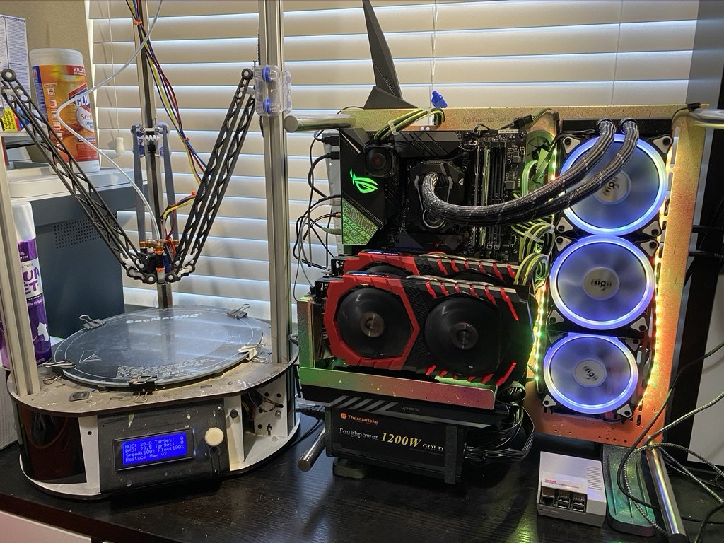

    Not really a printed part but I FINALLY got around to installing a part "blower" on my super modified Rostock Max. It's the loop looking thing around the nozzle. I put small pin holes facing down and it runs up to a small air pump. I can adjust airflow in real time via an external potentiometer and within the printer software when creating the gcode.

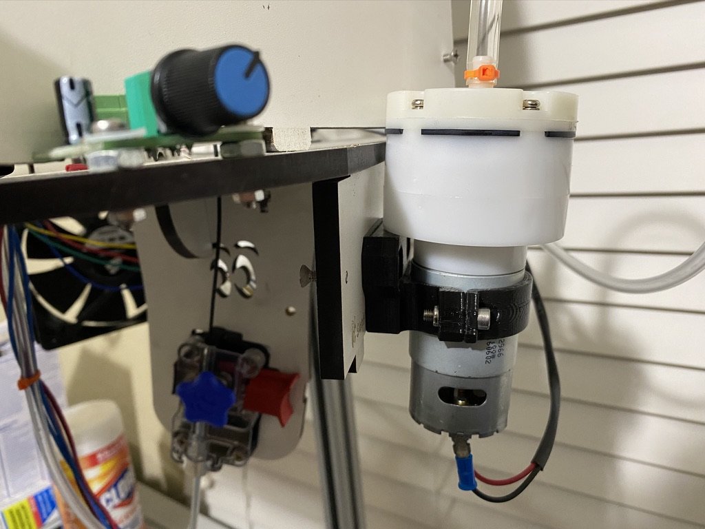

    That's interesting, what kind of air pump are you using?

    I originally used an aquarium pump but then went to this. It's technically considered a vacuum pump but it works well in this application.
