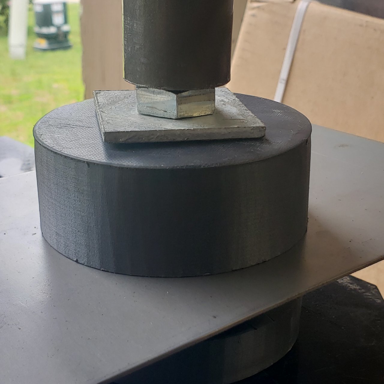

    Used carbon fiber nylon before, pretty tough stuff...

    I've yet to actually play with any filled filaments. How is the surface finish?

    The Obj file was exported at the wrong settings so it had a bit of a faceted outcome. But it was far smoother than I expected.

    are you forming sheet metal with that CF reinforced PC?

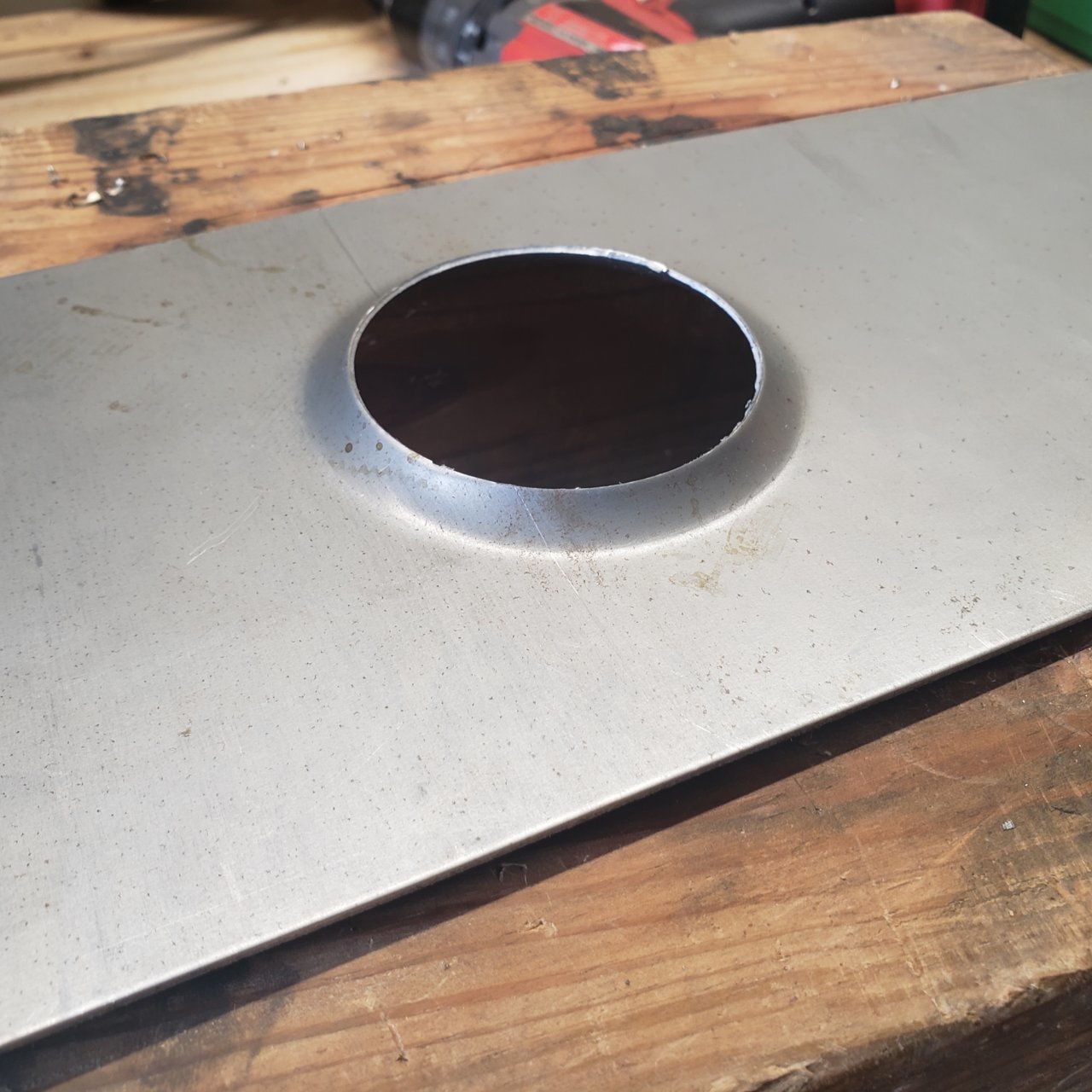

    yes that is a 2" dimple die in 16 gauge mild steel.

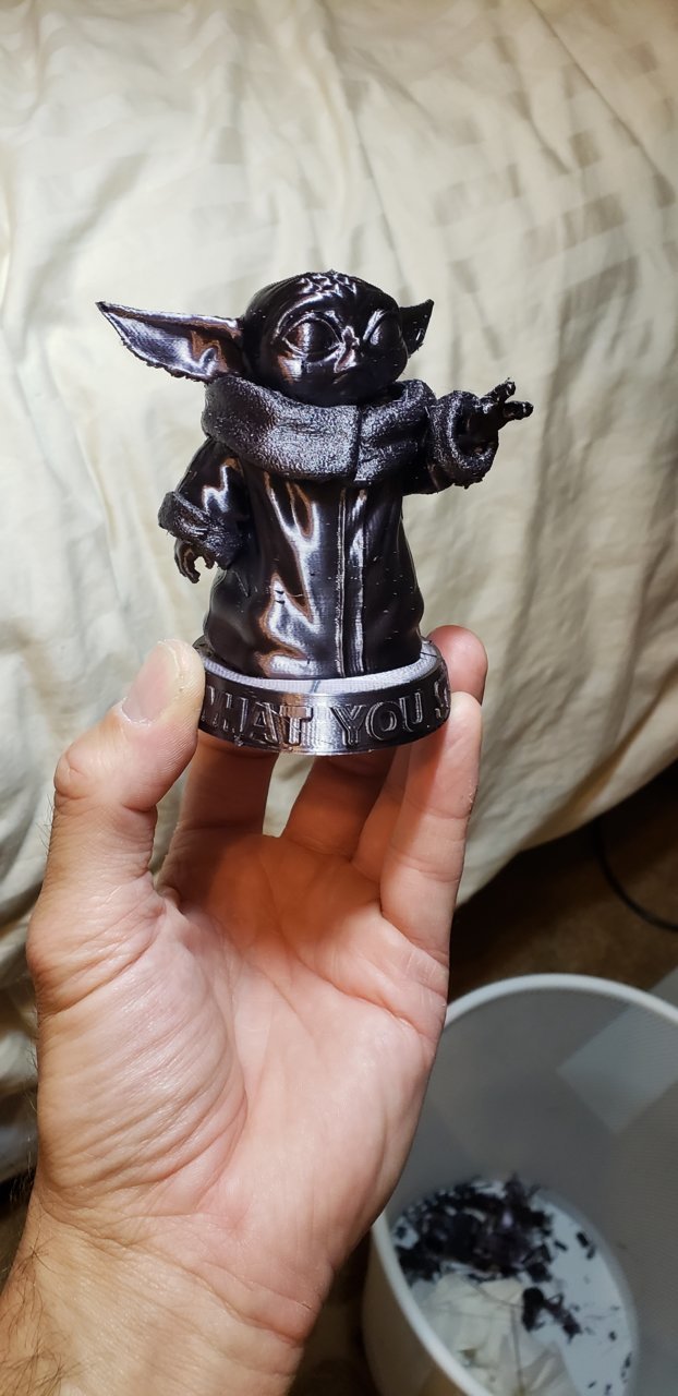

    over here I'm just learning and learning. Just did this print for my 4 year old. PLA Silk. I'm on a Quidi 3D Max. Quite stoked on it.

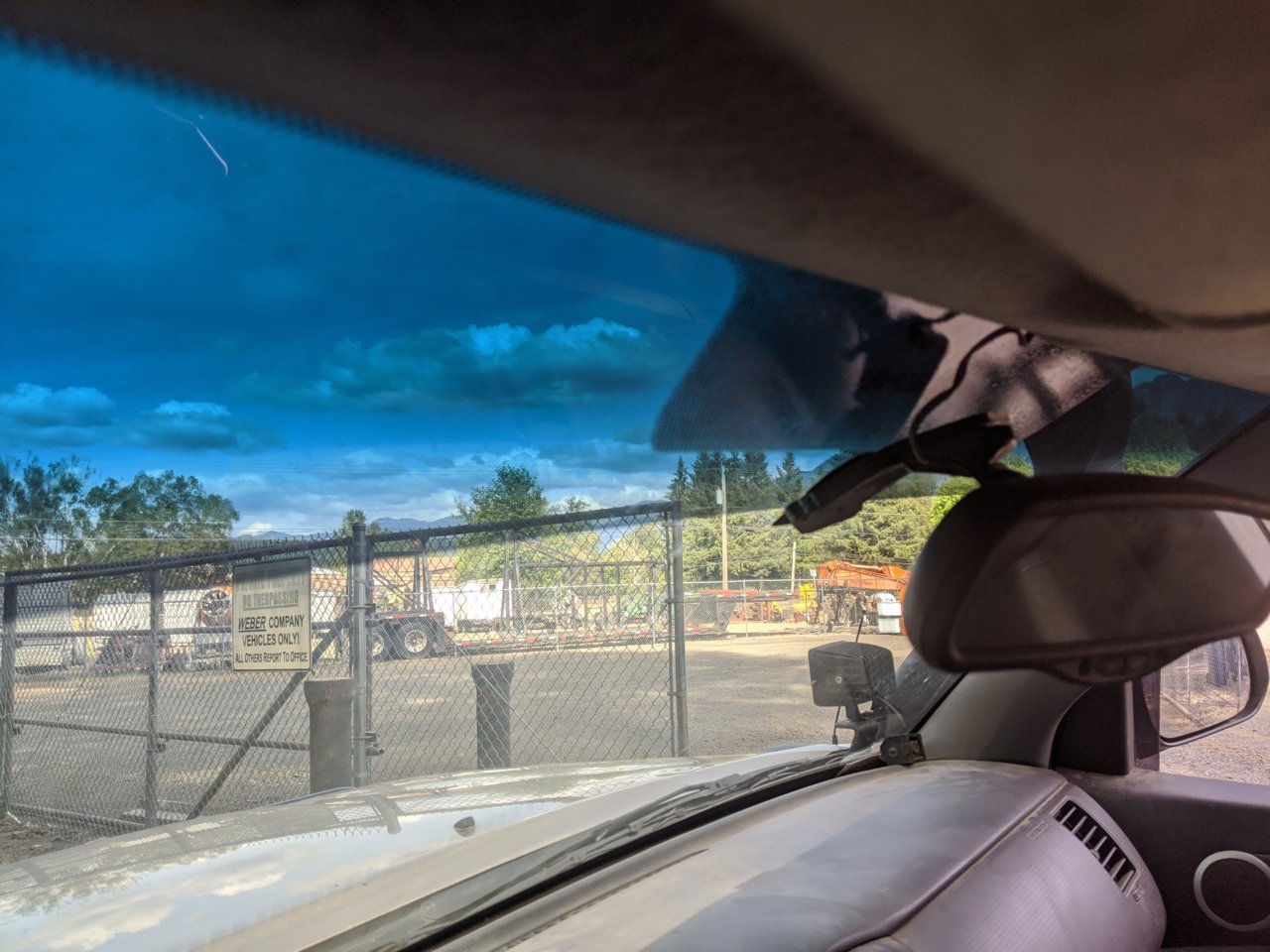

    So this was printed using PETG with 20% infill, would printing it solid make any difference? Temps locally have been in the 80's, but I imagine in cab temps are much higher. Or is my solution to use ABS?
    If it's not obvious, I'm referring to my rearview mirror risor

    Abs or Asa should fix that. Petg will probably sag like that even if printed solid. That's what's nice about petg, great layer bond and flexibility. Abs is more rigid, but will snap sooner.

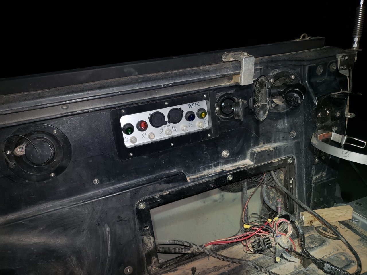

    Got my switch panel installed! (At least physically)

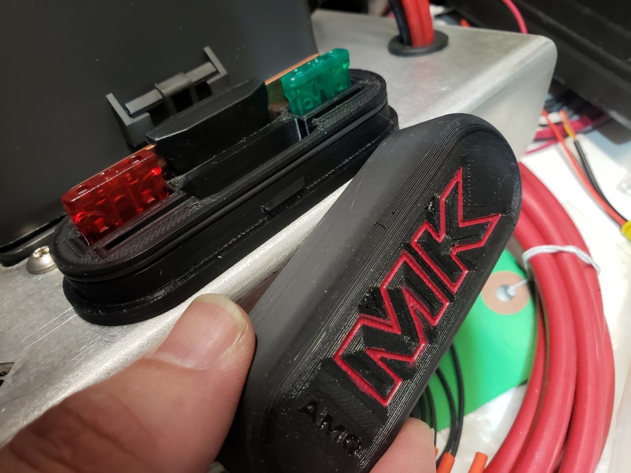

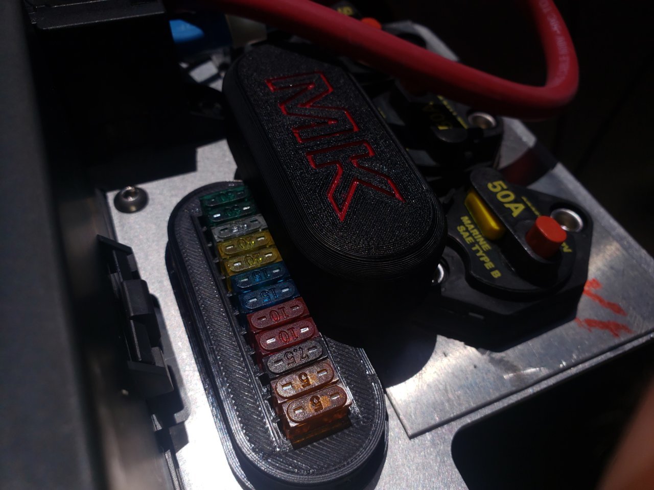

    Also made these stupid spare fuse holders to take up the wasted space on my new underhood panel:
    That's just red paint brushed into grooves in my part, not anything fancy with the print.
    And no, it's not the mainstream designer's emblem. It's my own. And I'm not about to change it for a no-talent ass-clown. Why should I, when he's the one who sucks?

    i like that switch panel

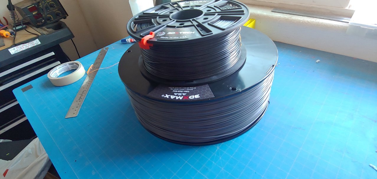

    Filament finally got out of Fedex purgatory. Got to figure out a new roll holder... and then I'll print a console in this. Dark grey ASA.
