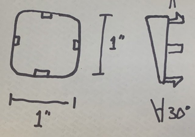

    I am looking to make some footwell light holders for the rear seat. Here is a rough idea of what I’m looking to do:9075F729-4F94-475F-B2CD-89086F2FE0AB.jpg
    Basically it is just a wedge that I will drill a hole into (or could probably be printed into it) that can snap into the seat hinge on a 3rd gen. It’s only going to hold a tiny light, but it may get kicked every now and then unintentionally, so not too thin. Would like to do three of them. If it turns out good, this will be an easy way to add footwell lighting if you have the Meso puddle pods already, so you might be able to produce them for other people. I can get more detailed drawings with the corner radius and more precise measurements if this is something someone would be interested in?

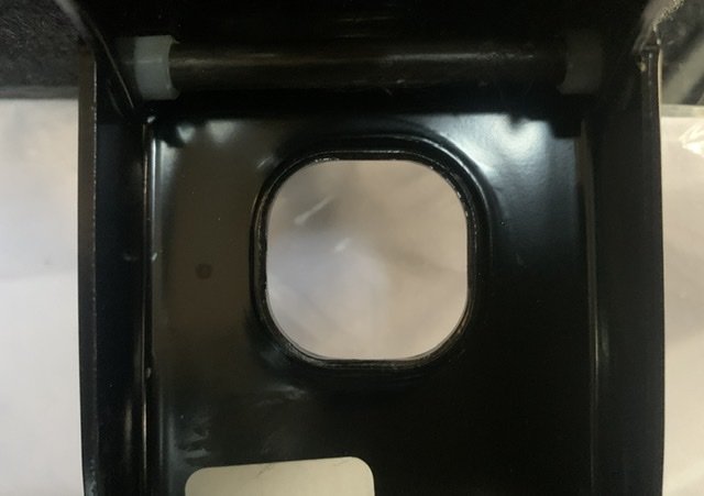

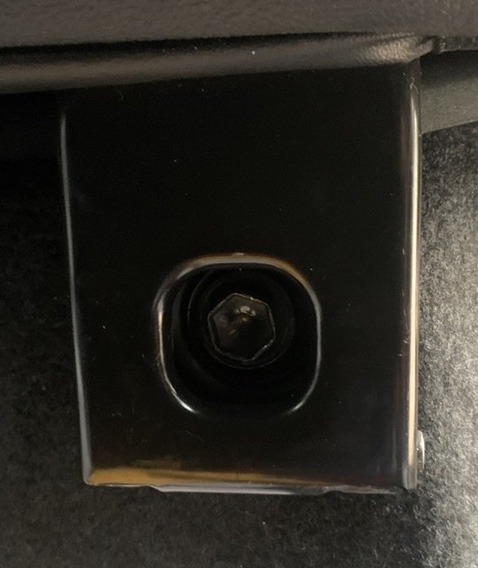

    Do you have a picture of the spot you want this to fit in? I have a 2nd gen and I think it's got holes/square cutouts in the hinges, but I'm not 100% sure if they'd be the same.

    7698DD15-C88F-4100-B512-9ADB5BF73B4E.jpg A5F9A593-7E46-431A-945C-887A4E63E118.jpg
    they can be a little bigger and mount to their far if that’s easier

    Seems simple enough.
    Do you have an example of what kind of light you'd want an opening for?

    You'd want it printed with the hole in the design. If you were to drill that hole out, you'd see what all the infill is inside, which isn't as strong as having a wall as the hole.
