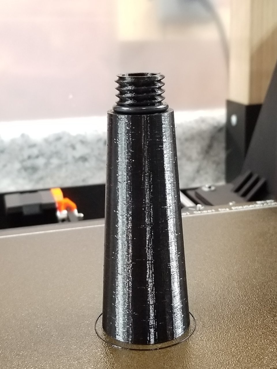

    So this wasn't for the Tacoma, but to solve a stupid Honda EU2000i portable generator oil spout design. Every time changing the oil takes half an hour mostly due to cleaning up the oil that goes everywhere since they made the spout so short it ends inside the case. Finally found it had 3/4-10" threads so I sketched this up in Fusion360 and printed out in PETG. Stuck an O-ring on for a good seal.

    That's terrific. I am a CAD newbie - and I intend to teach myself to operate fusion360. Can you recommend a good place to start?

    You must have that printer dialed in pretty well to get threads to fit.
    I’ve printed some parts requiring internal 1/4-20 threads, but just made thick walls & tapped them afterwards.
