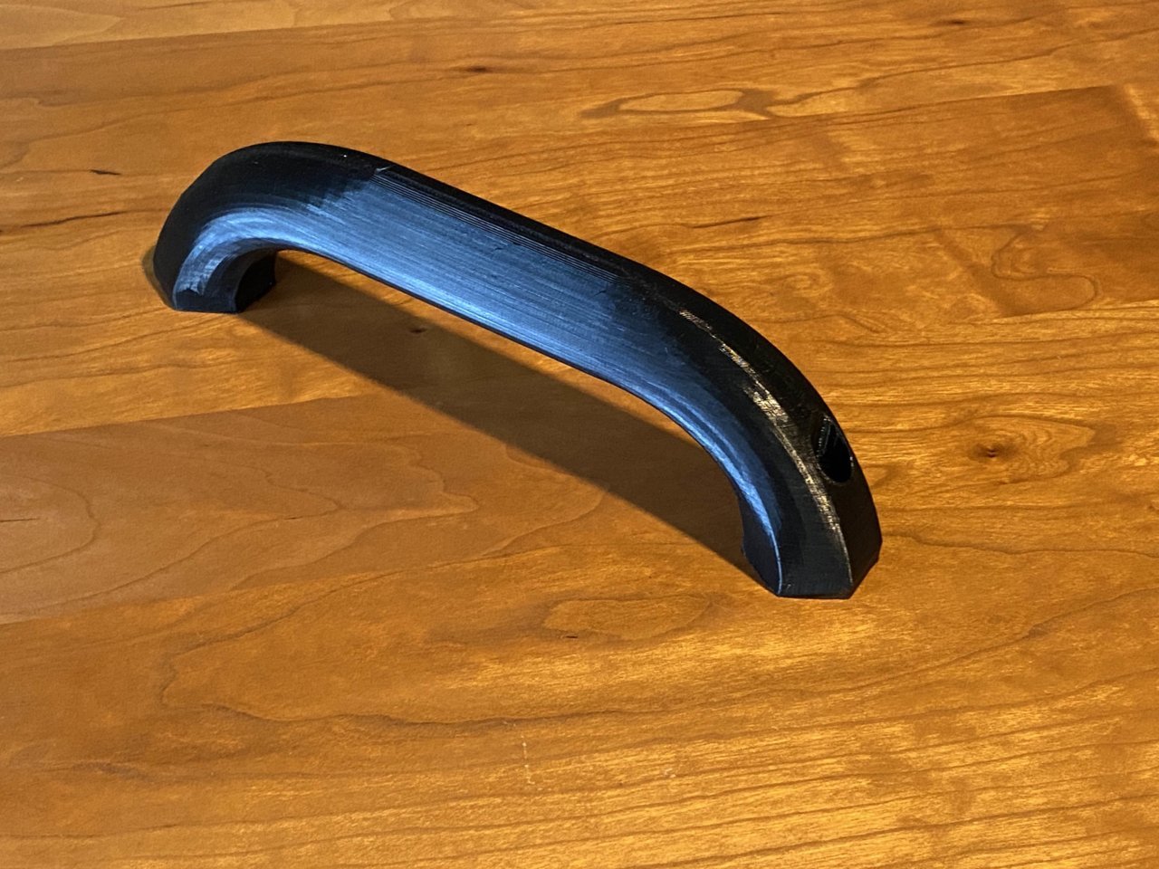

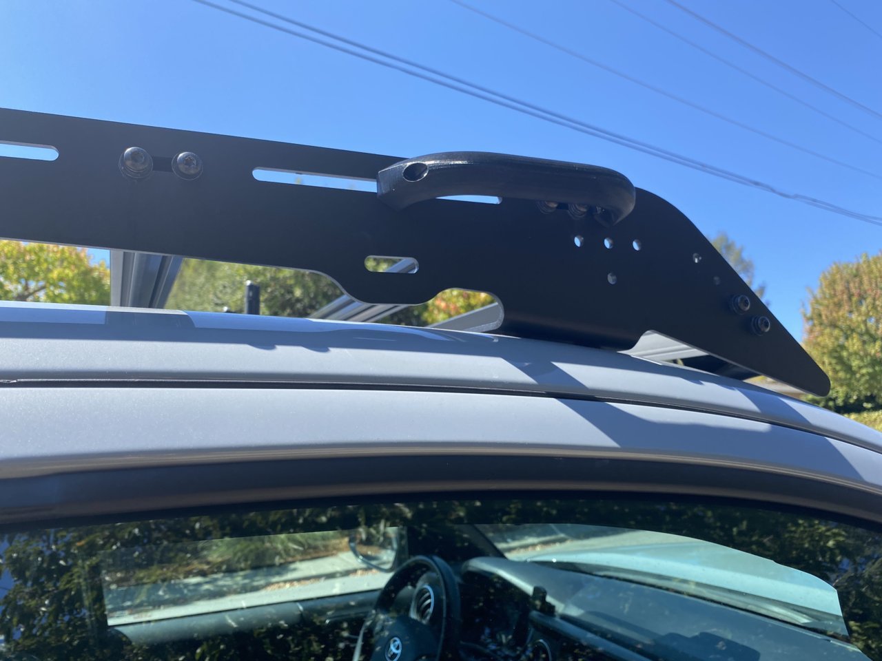

    Grab handles for Prinsu rack.
    I hope these PETG bad boys hold up. So far so good.

    Should hold up decently. I made some mounting brackets out of PETG for small area lights for my roof rack that held up just fine for at least a year in direct Southern California desert sun.

    If they're a thicker object which those handles appear to be, they should be just fine in the sun. I've made some L-brackets that where less than 1/4" thick and after a couple days in the sun they started to warp, it seems to be all about shape. The sun is also very direct and hot where I live so it might not be something you have to worry about in other regions.

    Petg should be able to withstand about 140 degrees. It will fade in the sun. I've seen it happen in under a month. The other downside is it is not rigid. It will flex and sag over time.

    If you guys haven't looked into ASA for outdoor parts definitely check it out. Way better than ABS or PETG.

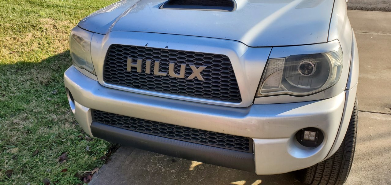

    So, in this pic the lower grill, "HILUX" logo, turn signal covers and fog light surrounds are all 3D printed from ASA. I've also done a 3rd brake light cover from clear petg, door speaker adapters, custom shift knob and a magnetic surround for the oil filter. I'm sure there is more I'm forgetting. Working on making a flip key fob that fits my aftermarket alarm remote.

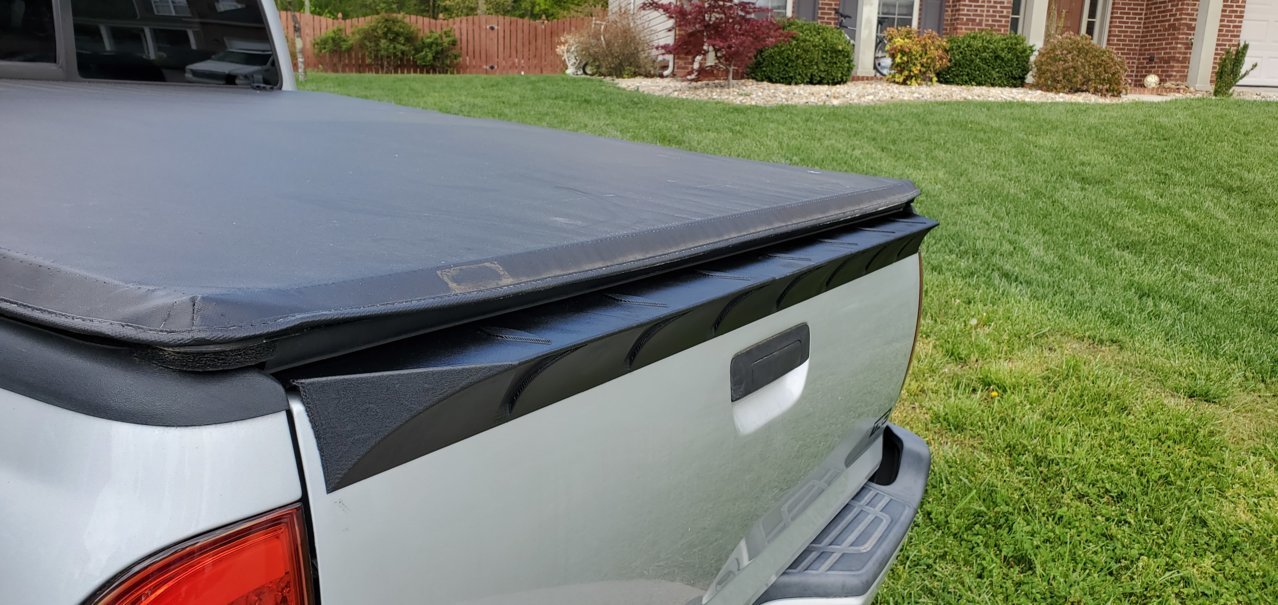

    Also did a tailgate spoiler when my old cap got damaged

    How many pieces did you have to print the grill and tailgate top in? Currently experimenting with different ways to join parts with multiple pieces.
    Or do you have a huuuge printer?

    The grill was 4 parts and the spoiler was 5. The grill is ASA so I used acetone to "weld" them. The spoiler is petg and I used pins and epoxy to join them. No huge printer...yet. Just a CR-10S.

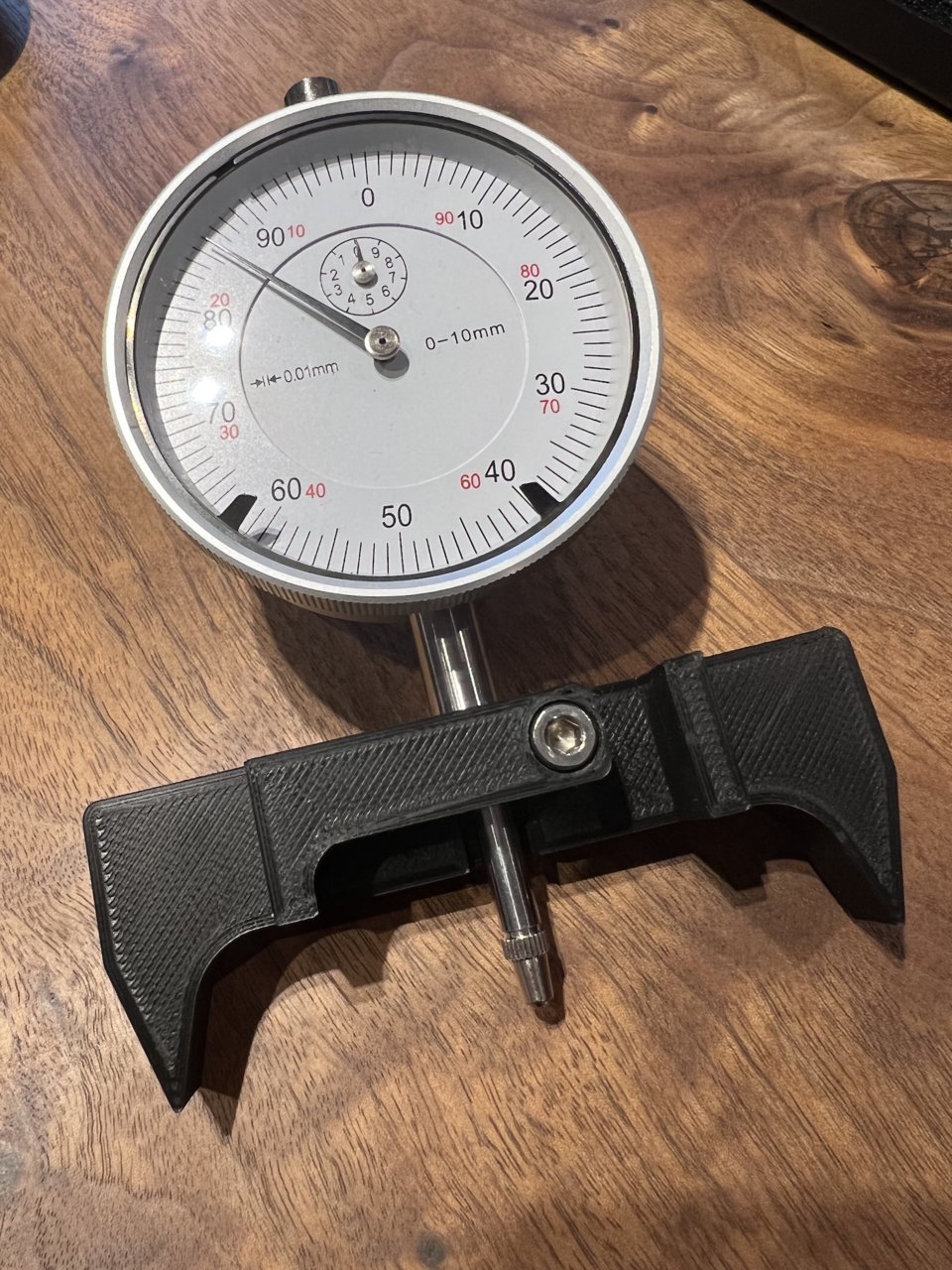

    Printed this yesterday - i was tired of trying to pull big radii off various parts of the truck. Thought, there must be a cool tool for this but at $250-600 - not happening. $30 dial indicator (mcmaster) and now i am pulling big radii to my heart's content. I would like to eventually cut one of these on the CNC and engrave the conversion chart on the back - we'll see.
    This all started because I am making a little platform for use w/ phone for getting the camper level: https://www.tacomaworld.com/threads/zs-approach-utility-build.464628/page-10#post-26305106
    I did not realize that the center console is crowned in both directions. Proof of concept below:

    Great idea for the radii gauge!
