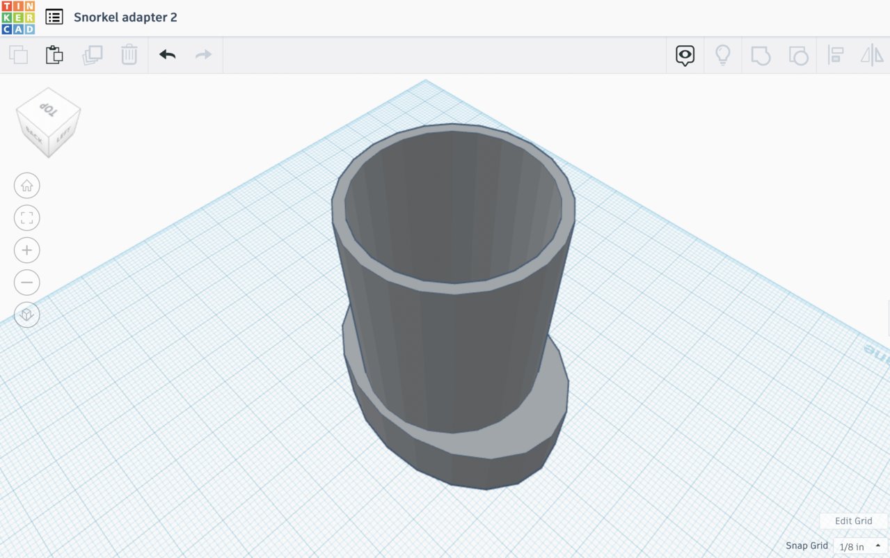

    Custom designed an oval>round adapter for another TW member's Skylone snorkel setup

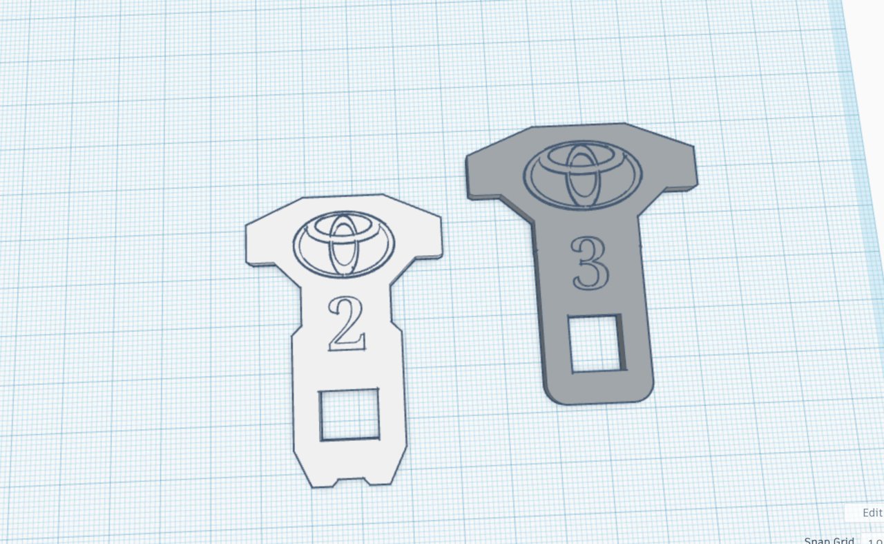

    Printed some seatbelt silences for my 2nd gen (2), my wife's '20 RAV4 and 3rd gen Tacomas (3)

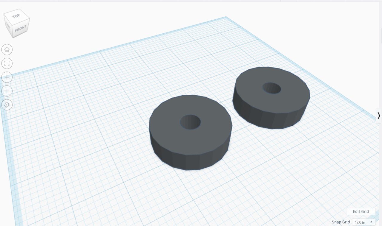

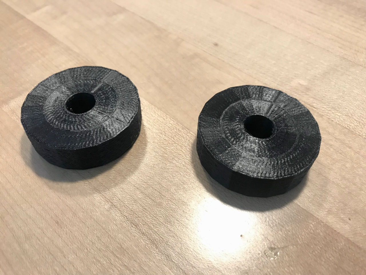

    1/2" rear seat "jackers". Ordered official Desertdoesit front jackers. No way I'd trust ABS in the front!

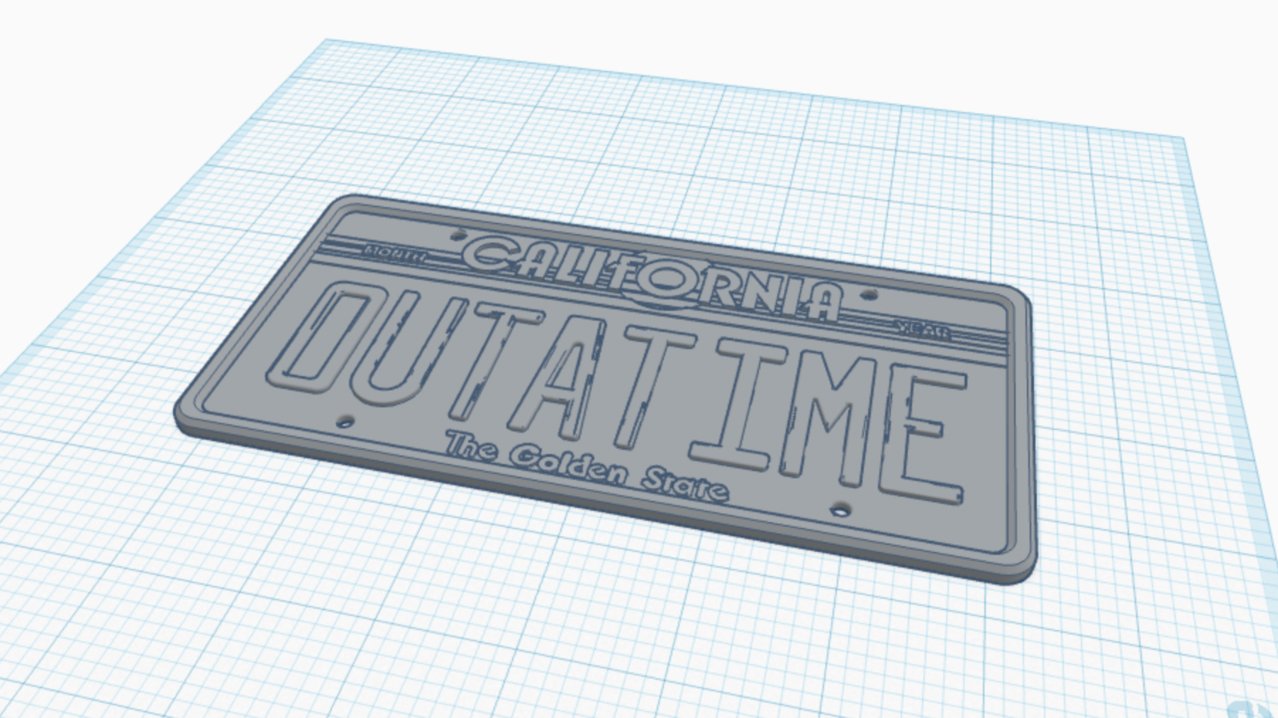

    Shameless downloaded Back to the Future xmas gift for my bro

    I am not sure what cad software you are using but you should be able to decrease the angle tolerance when making your STLS, so your parts come out more like circles rather than sided things.

    I've only used TinkerCAD (I'm a 4th grade teacher that picked this up to teach elementary kids how to 3D design) for designing and I slice everything with Qidi software since that's the printer I'm using. While I feel like I'm finally starting to understand how to tweak settings for more successful prints, I know there's still so much more to learn, especially with smoothing out round models. Someone turned me onto Cura for hopefully better slicing, but I'd love to check out a better free/moderately priced CAD program if you know of one.

    That is awesome to hear kids are learning such a useful skill at a young age. I personally use solidworks mostly because I use it at work. You may be able to get an educational license for free? Not sure but a great alternative is Fusion 360 and that is completely free for hobby use. I also use Cura if you have any questions with it.

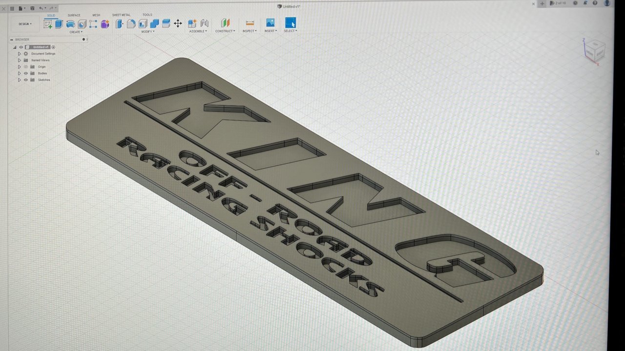

    Created this in Fusion 360. I’ll probably need to fillet this and convert it to t-spline before it creates an acceptable print. Once my queue opens up, I’ll post the outcome.

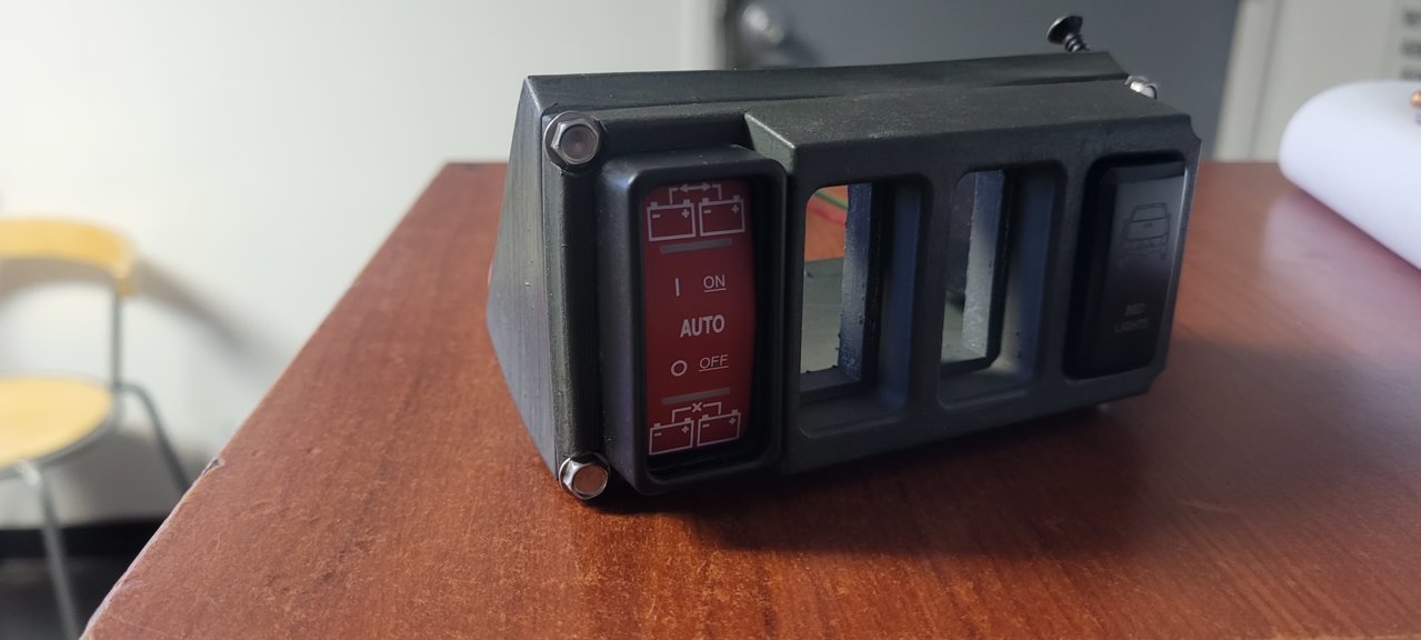

    Overhead switch housing.
    I'll see if it actually works once I cut the headliner and install it.

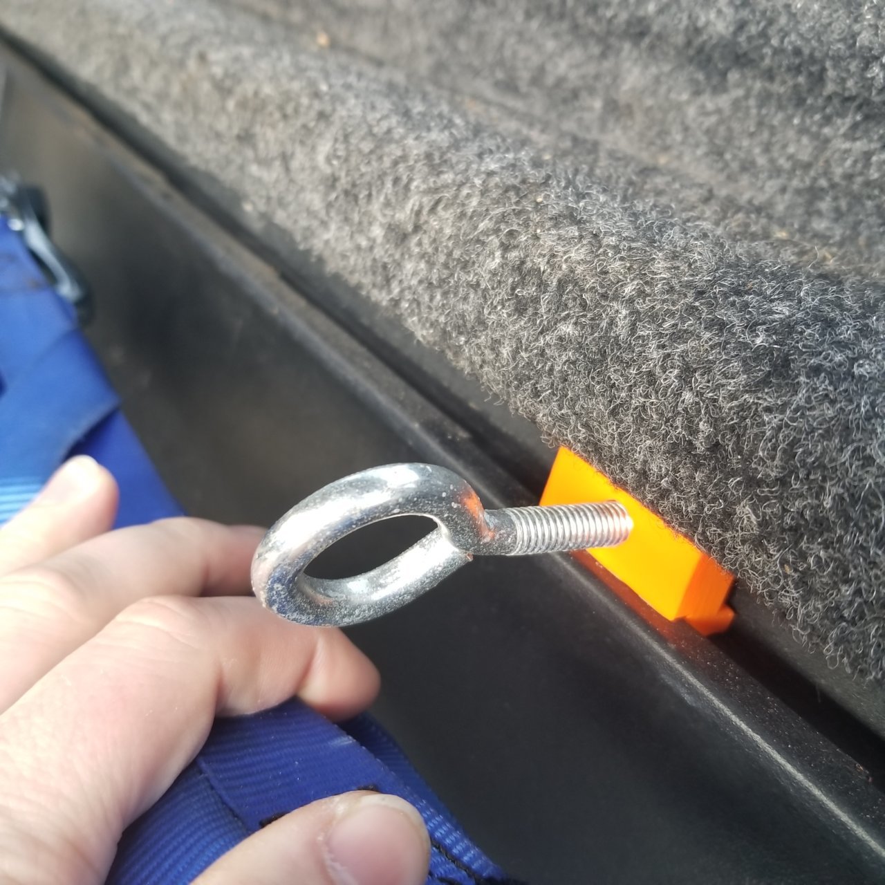

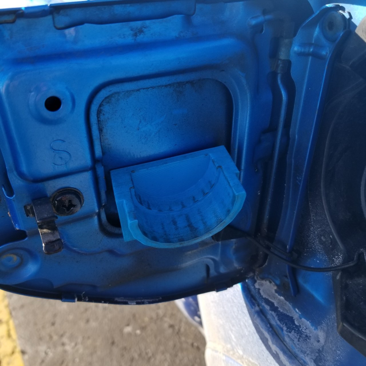

    I've seen this thread a few times but just never thought to take pictures till now. I've had the cap holder and tie downs a little over a year. 2 of the 4 tie downs broke but the cap holder has been a champ. I made both out of PLA on a Prusa Mk3s but cant remember layer height or nozzle size though.

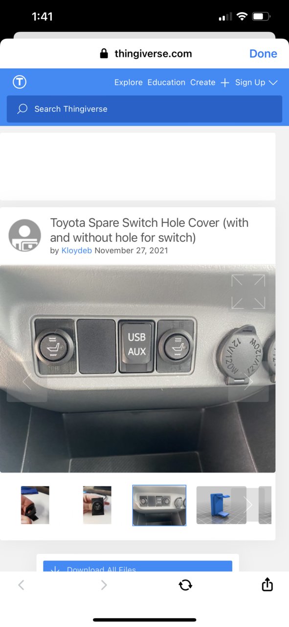

    Anyone able to make me a custom 3d printed switch for the left of the steering wheel to accommodate this on off on switch? This is what i’m looking for

    Willing to share the STL for the 2nd gen seat belt silencer?

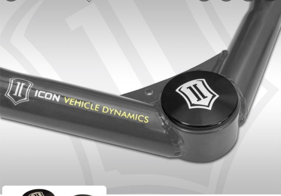

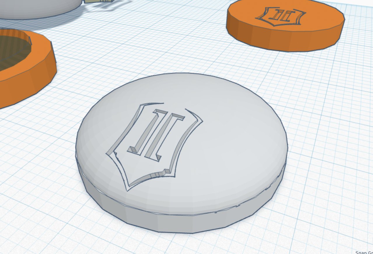

    You ever get this going?? I'm curious because I just grabbed up some delta joints and thinking of covering them up haha
  19. Feb 26, 2022 at 6:43 PM
    #579
    AdrenaliNate
    AdrenaliNate Call me Nate
    Jul 7, 2008
    #7799
    146
    Simi Valley, CA
    13 DCLB TRD Sport
    ICON Stage 3, 275/65-18 BFG T/A KO2, 18" KMC Monsters with custom caps, Access Lorado tonneau, Wet Okoles, AMP Research Powersteps, LED bed/hood/steplights, Fuseblock, ABS kill switch, Banks Pedal Monster

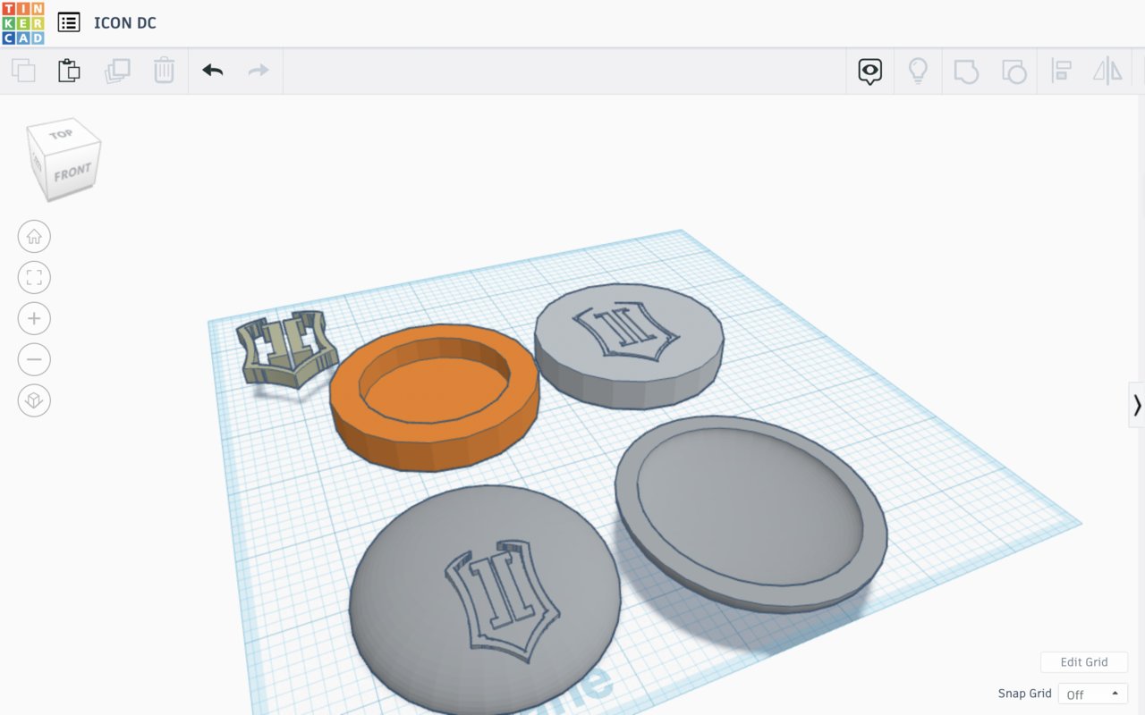

    Sure did! Made them a little taller to clear the top of the uni-ball. Was in a rush to test them so I just hot glued them on :anonymous: Lost one but the other is going strong lol
    Need to use epoxy or something like the 3M rings that ICON uses next time.
    I'm going to print another set soon so let me know if you're interested. Shoot me a DMScreen Shot 2022-02-26 at 6.40.29 PM.jpg

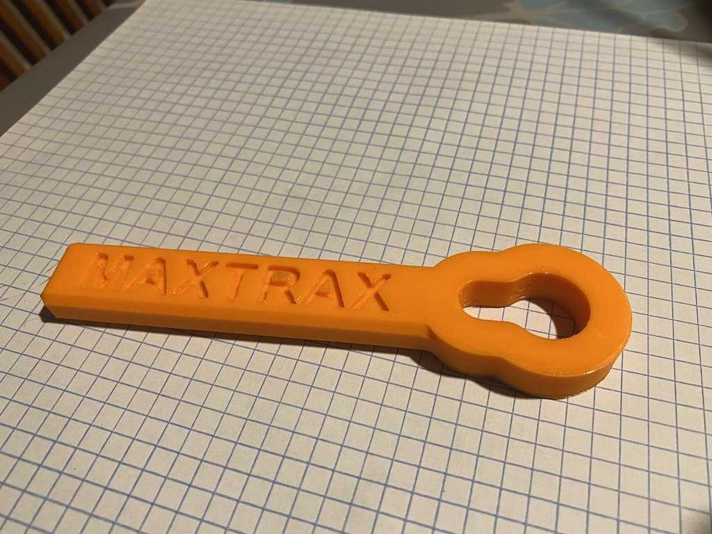

    It's always a struggle for me to get my maxtrax mounting pin cams to turn. The trax have to be perfectly flat, and even then I find myself needing to grab some channel locks occasionally to get 'em rotated.
    I decided to make a quick tool to get some additional leverage that my fingers can't provide.
