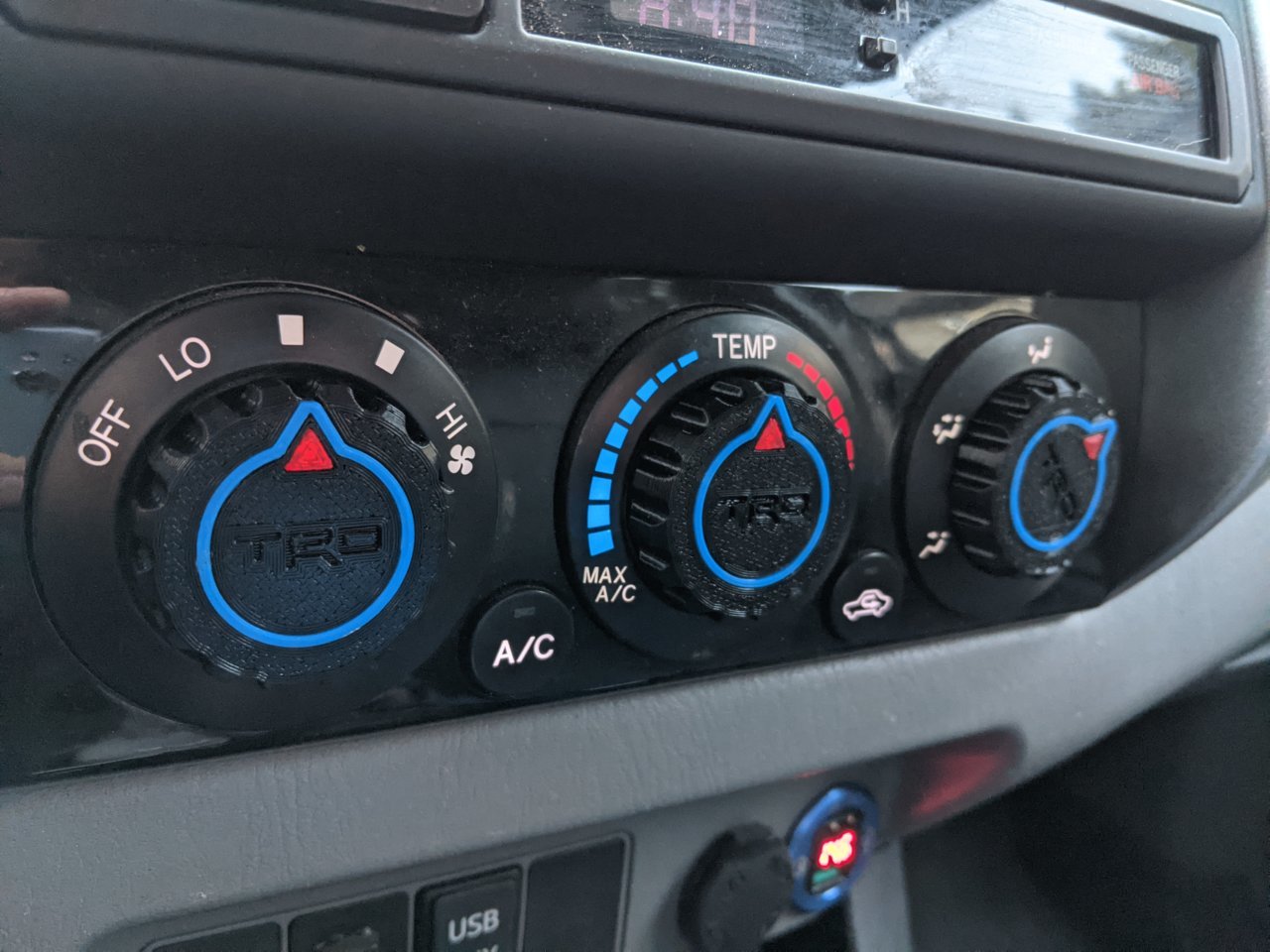

    First version of some HVAC knobs I designed and printed. The different colours are separate prints glued together. The next version will be a single print, if I ever get around to printing them.

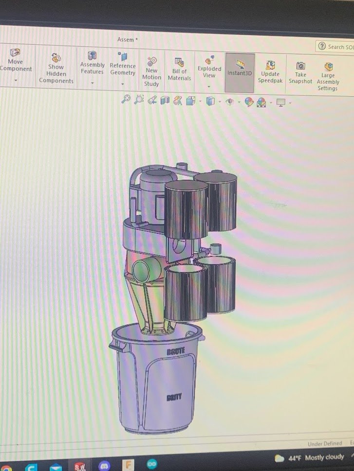

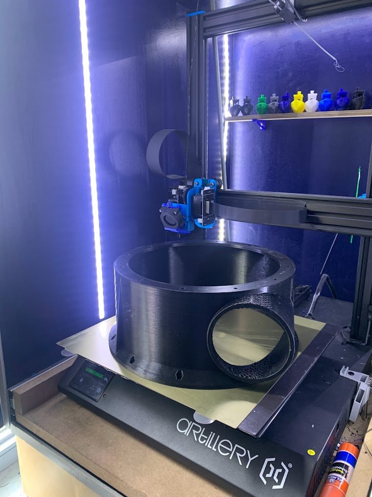

    Not exactly relevant to tacomas but I started printing a cyclone for my dust collector. First really big substantial part is really cool, its about 12" in diameter.
    JG9l9qNj9nqHAryLtcE4KNub08w1_NA-bWULw6yM_568345fbbe5c81ef0d2247162edc6a23fe80b509.jpg
    The design.

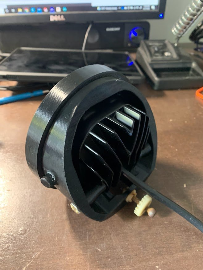

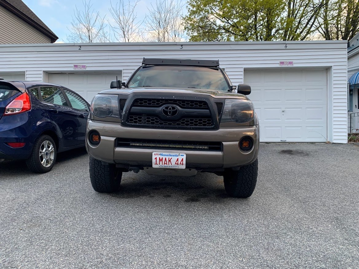

    V2 of my printed fog light bezels.
    _n4Cx0Z5yDRIkcGLe4Nnp-GBAckIUqKAEt0PBJtL_c062185f5239b00dc85cb43e36c8365fd2bd66d1.jpg
    GLUBswSvEQQ3qLp9UQwbR7eeYBQ9kZvUsHfgyCZU_ff8a98384b0fbe5d910063000e9e8e55ad93174b.jpg

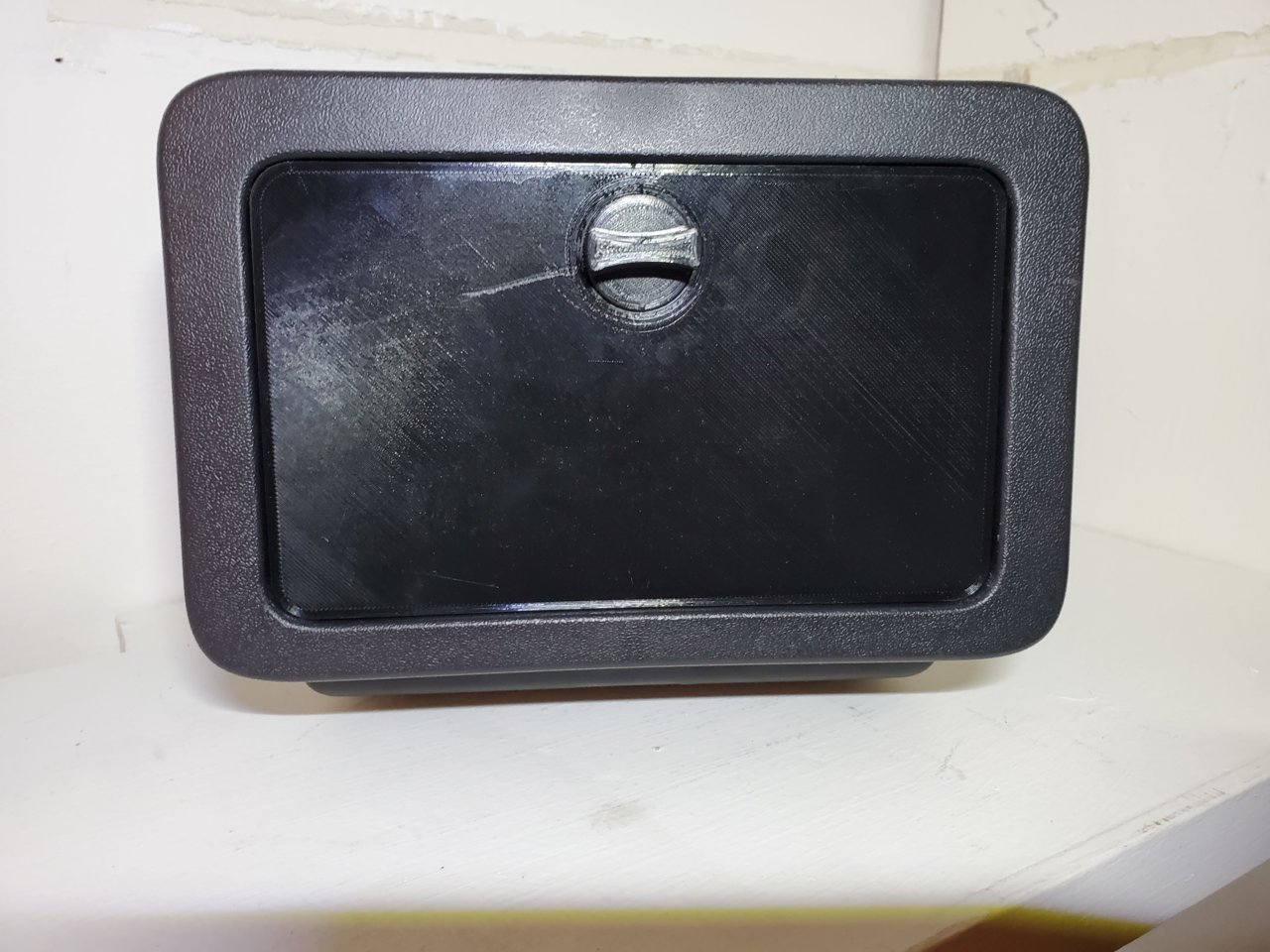

    I 3D printed a mount for my UV5R.
    Check it out and print it here:
    https://www.thingiverse.com/thing:4978600
    I ran my external antenna below the carpet and to the glovebox. The wire sits in the glovebox when the radio isn't in the truck.
    The antenna is a magnet mount and can be stored behind the rear seat.
    (wiring has been cleaned up since lol)

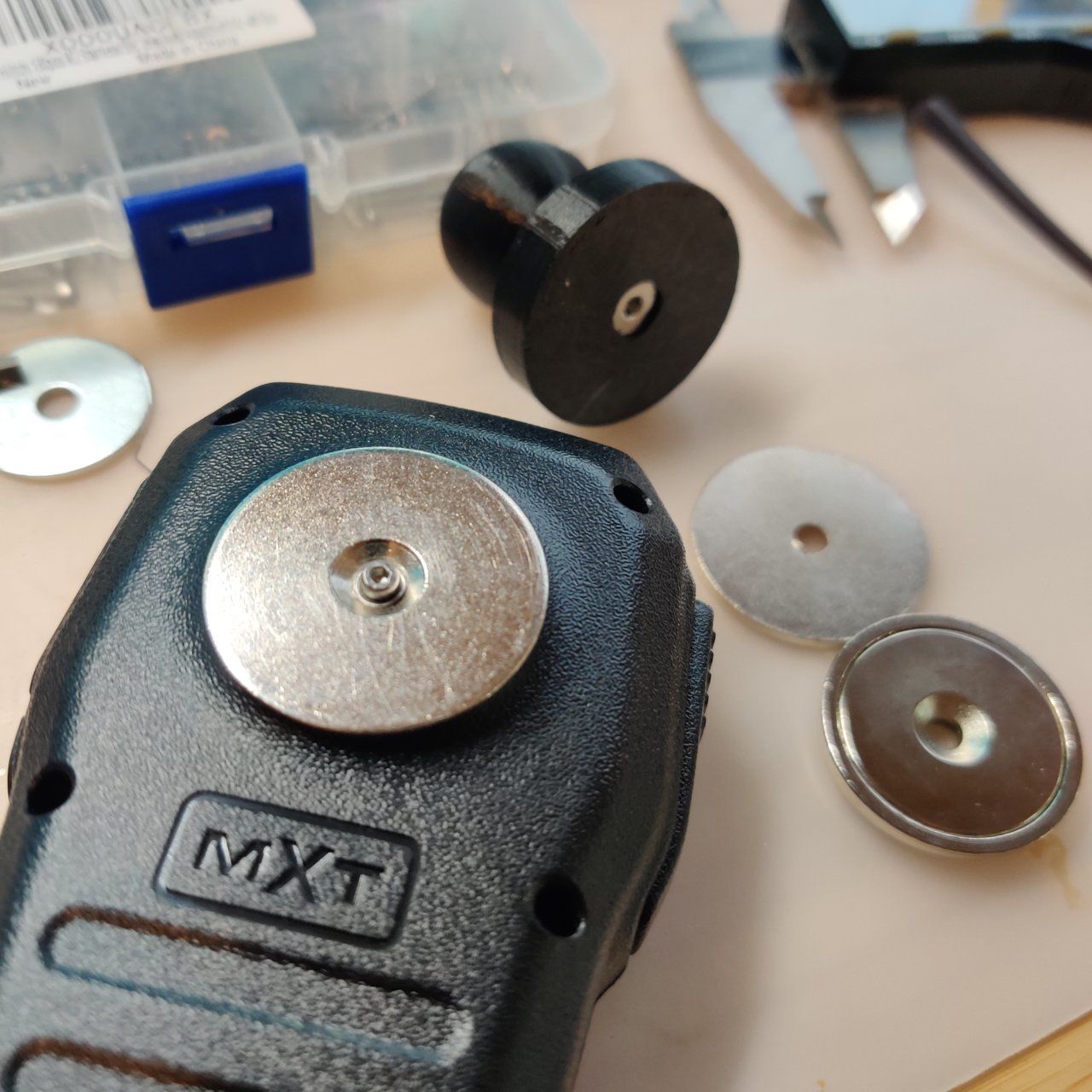

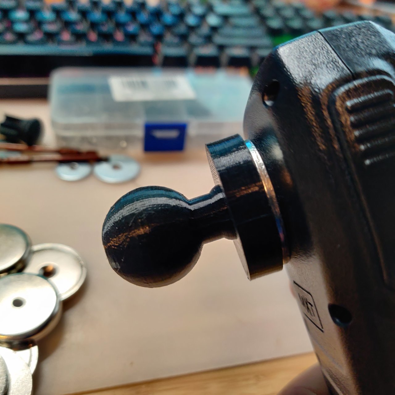

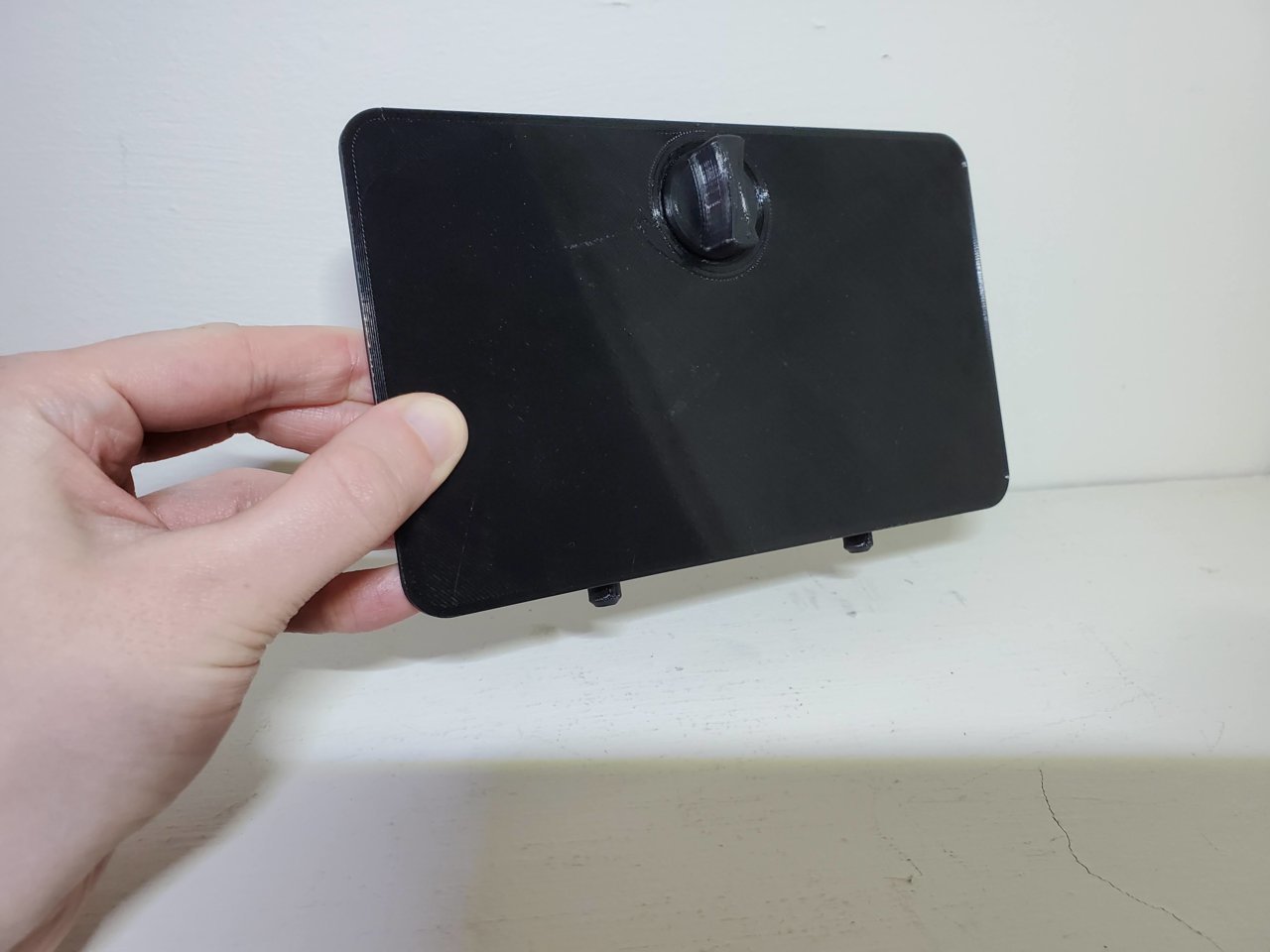

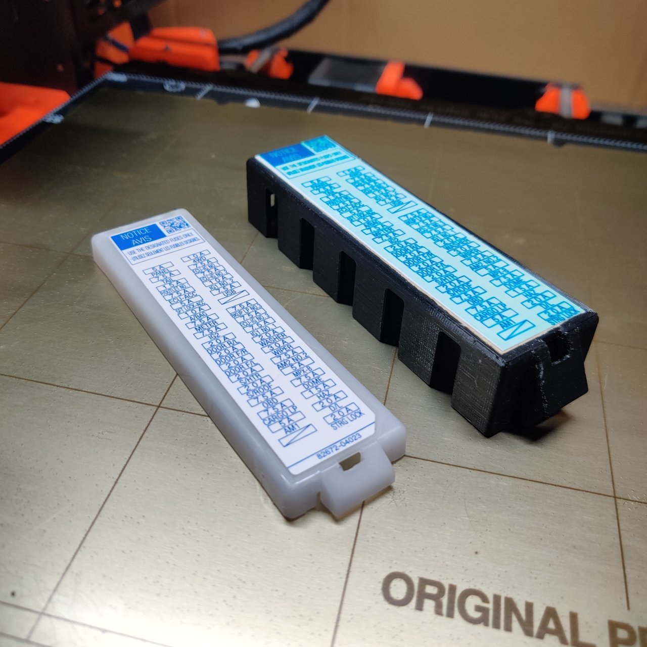

    Working on a few things,
    Magnet mic mount
    Extended fuse cover

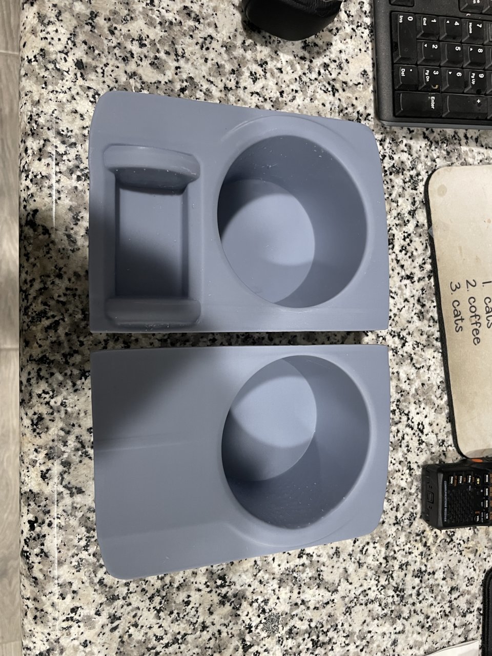

    Here is a cupholder I made for a 4 runner. Originally only had one space but after I 3d scanned the original I mirrored it to get the extra cupholder.

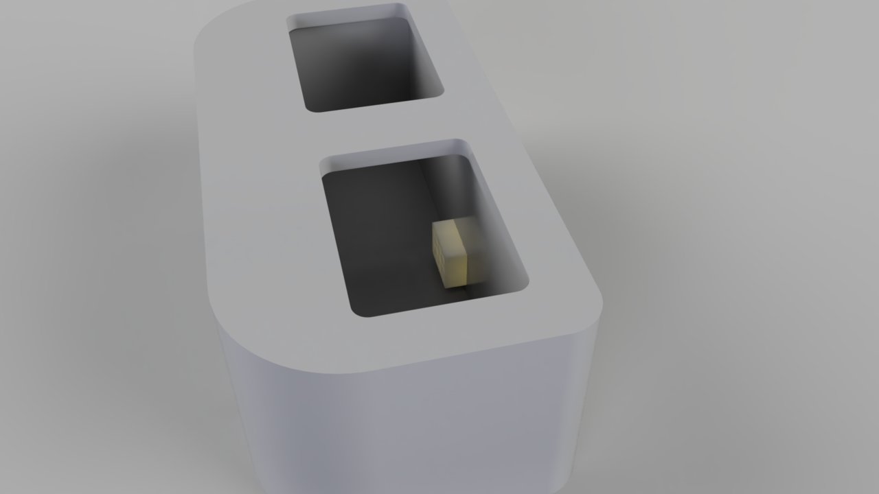

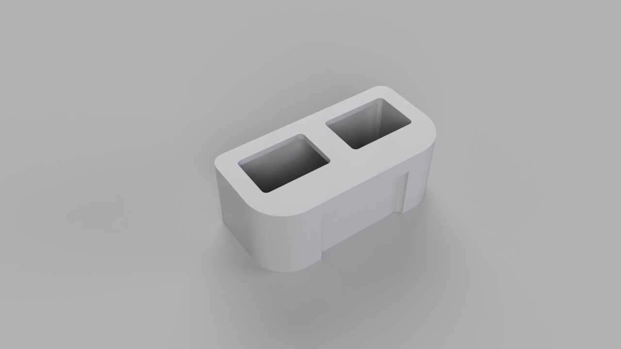

    Started prototyping a switch panel to fit into where the cupholder inserts go. Plan is to fit two sets of three toggle switches.
    edit did a bit more work but im awaiting for some parts to arrive to verify guesstimated dimensions render 0003.jpg render 0004.jpg render 0001.jpg

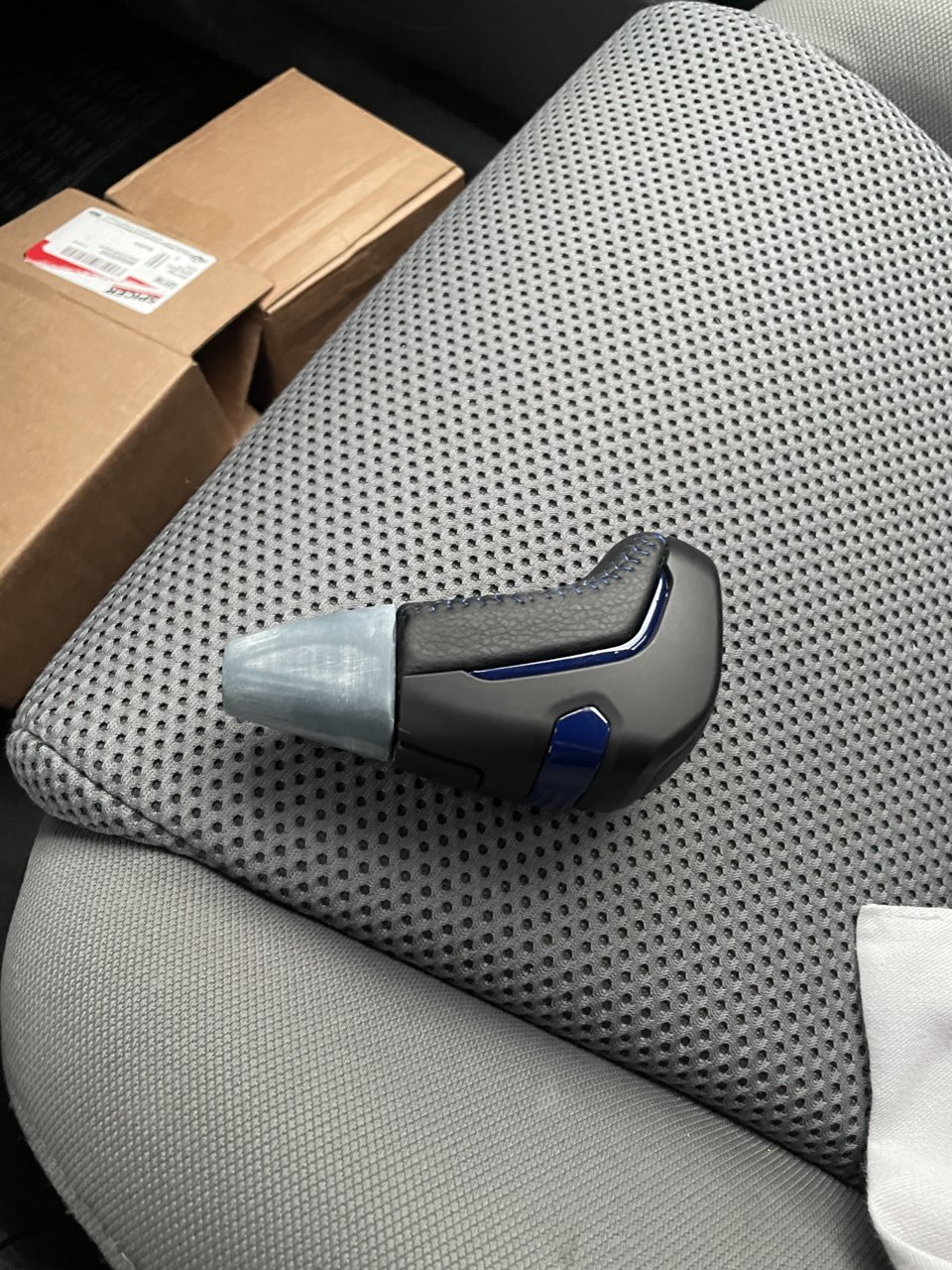

    Shift knob base for a third gen knob on a 2nd gen truck. Still have to sand and finish it.

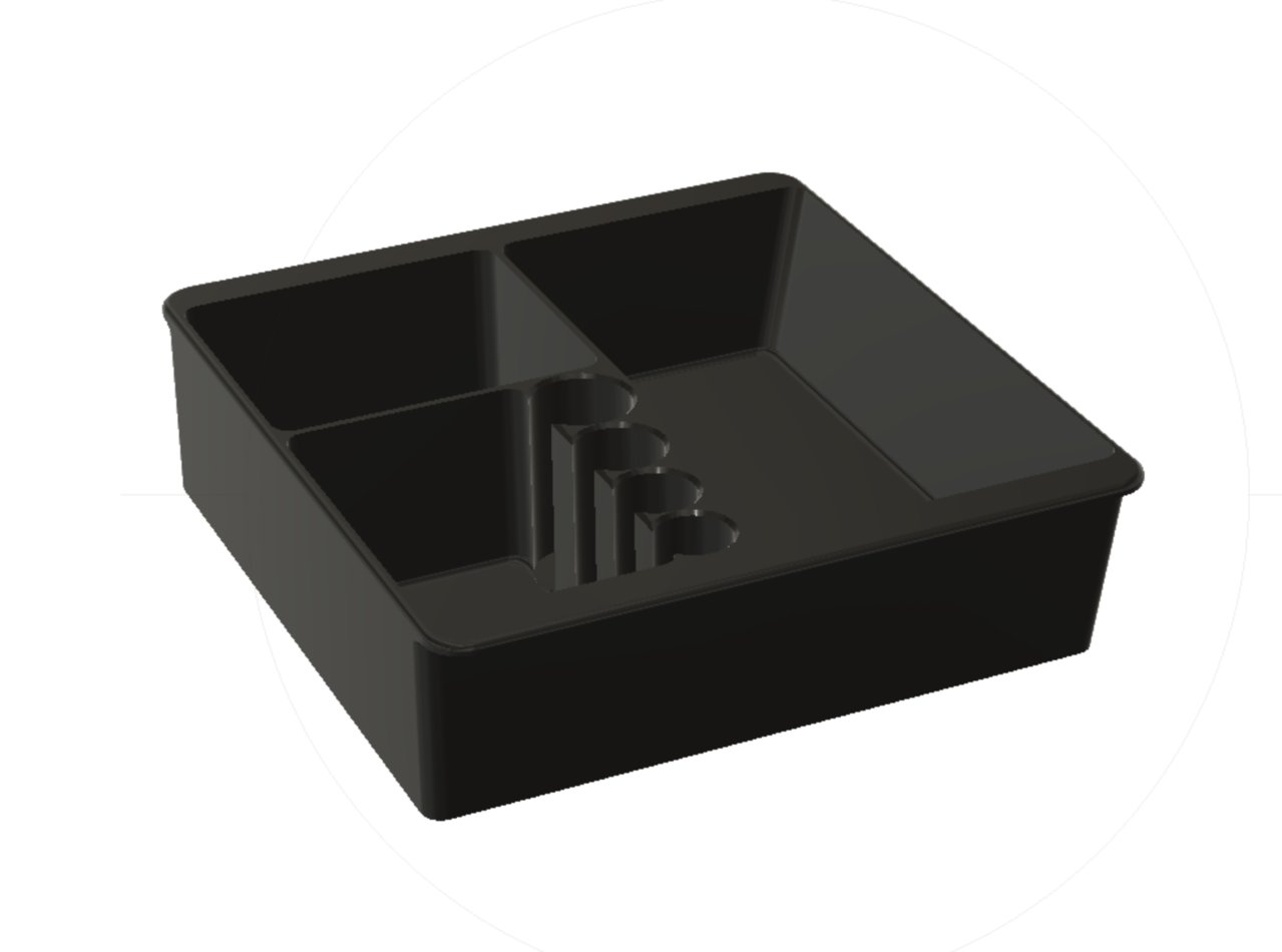

    Modeled a tray for inside the center console of the 3rd Gen. I printed it it PETG. Works well. If interested I can upload the stl somewhere. Will upload the a picture of it in the truck.

    Are you using bondo to cover the 3D print material?

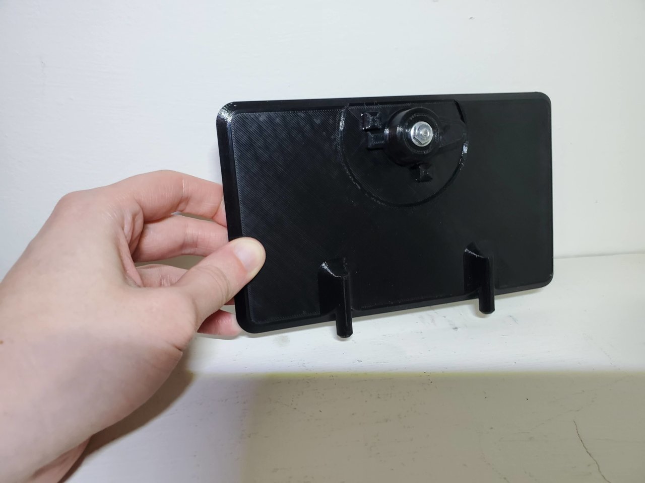

    I printed a magnetic phone mount.
    I used a vent mount and took it apart. I screwed the magnet into the 3D printed part.
    Hooks are for the charging cord.

    No, I use a resin printer. Printed the cupholder in two pieces and set it in the console to get the positioning perfect, then used the same resin and a handheld uv light to harden it. Essentially glued it together with resin. Then sand down the contours and primed it.

    Looked like this before I used the resin to glue it.

    Wow! That is great work! How long was the print time? Where the contours sharp/edgy like regular PLA prints before you sanded it down?

    Thanks. The printer has a high resolution so the edges are only as sharp or as dull as I want them. The original part was scanned so it matched the factory cupholder edges and other dimensions. Sanded down any edges that I didn’t like with 400 grit. The only problem I have found with resin printing is cheap resin is brittle and shatters. Good engineering resin that isn’t brittle and will hold up is $40-$200 a liter.
